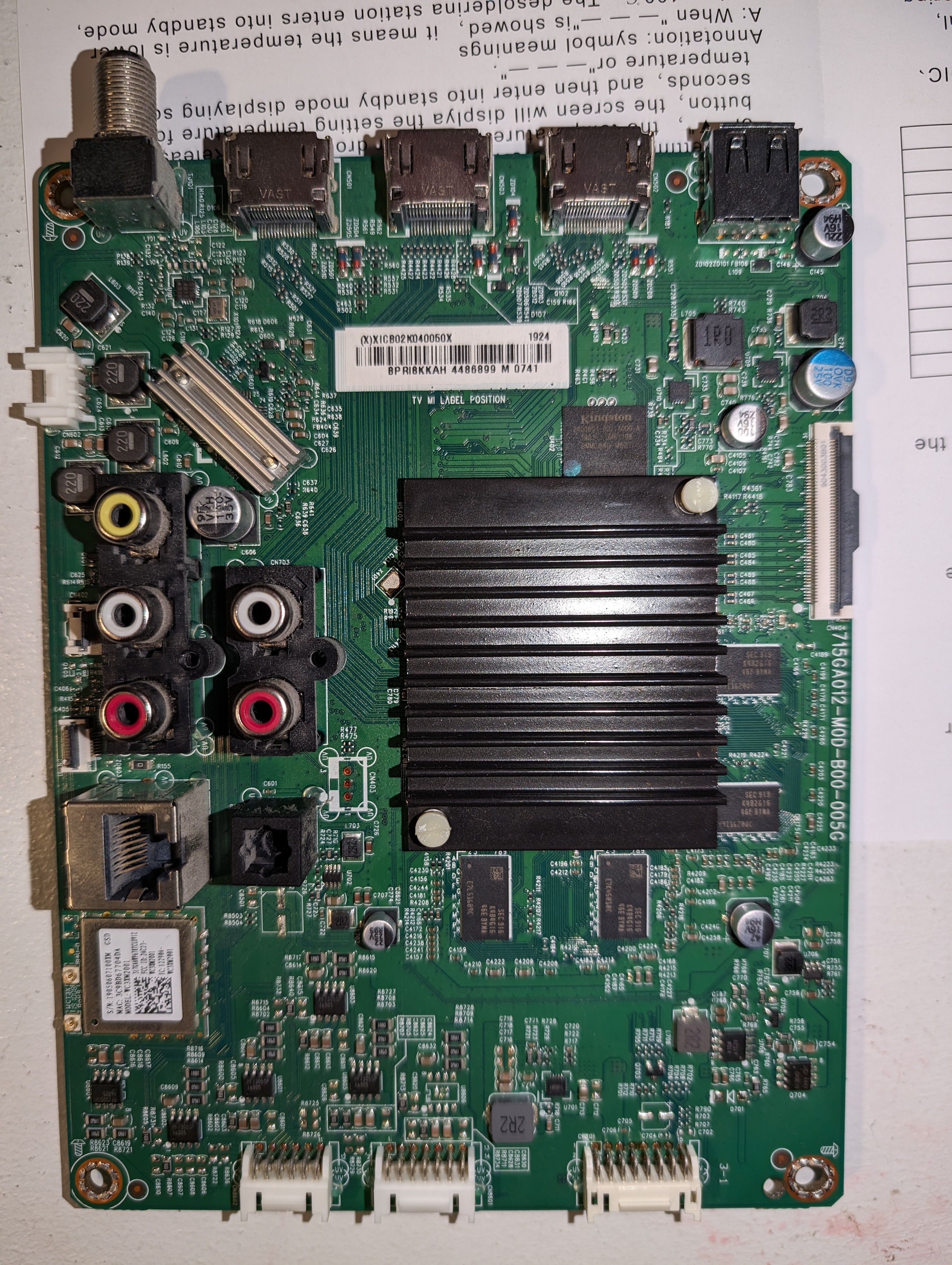

                  show me clear high resolution photo complete of the MB
                  • x_orange90_x
                    • May 2015
                    • 750
                    #29
                    Not the clearest but it's readable

                      MANN... i hate this way... yours TV under yours hand.... photo of yours original boards i could see issue for yours eyes and brain.. not to catch or discover..... ... good luck then.... go buy the same photo you uploaded ..
                      i never answer any post the owner just keep write and follow his mind.. its worthless...sorry.

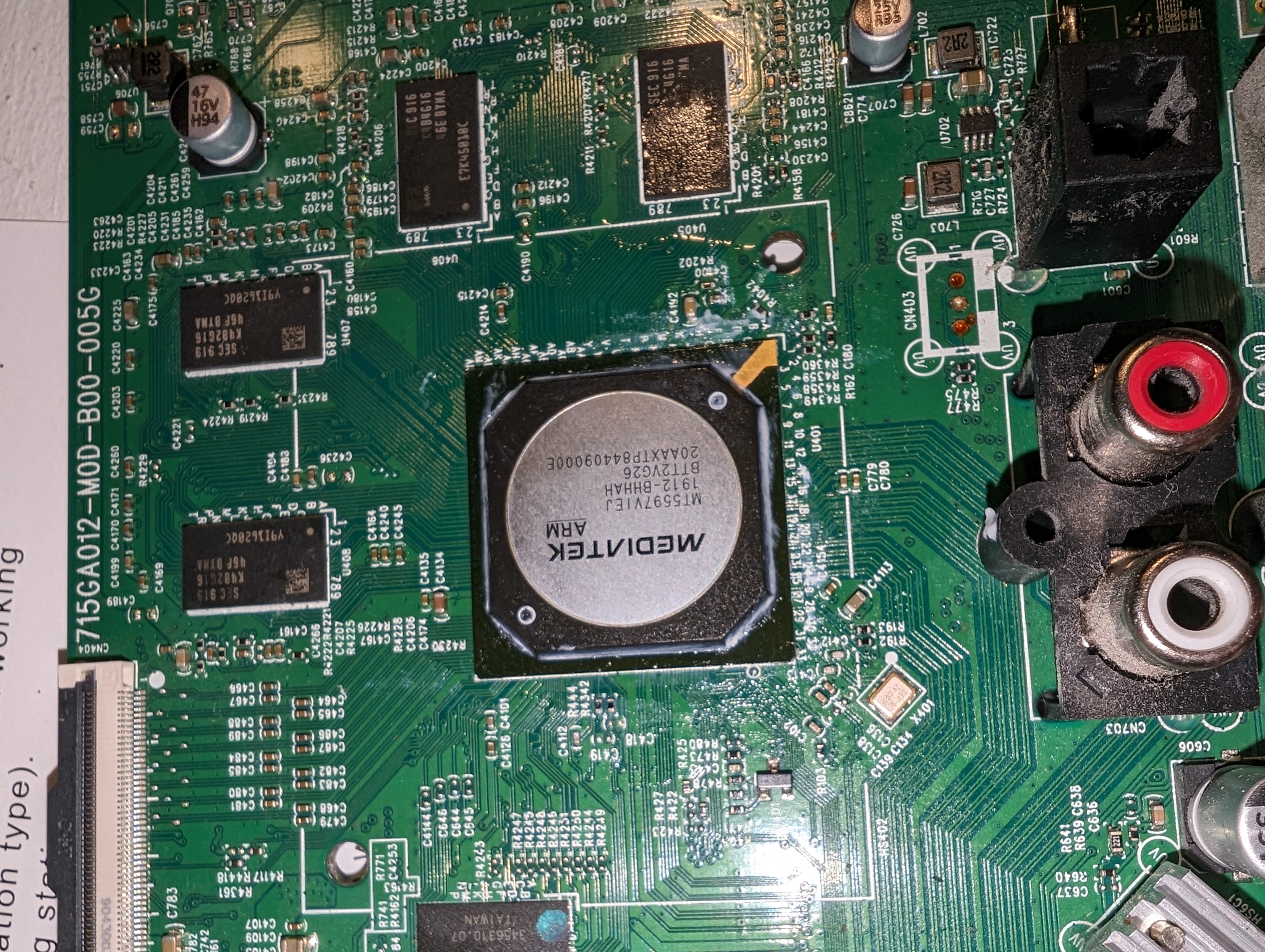

                                    Ok, that is a good picture there, now can you take off the black heatsink and post another picture? no more heating or cooling, which you already tried.
                                    • x_orange90_x
                                      • May 2015
                                      • 750
                                      #38
                                      Here ya go

                                          #40
                                          Test the little brown mlc caps around the mediatec chip, see if any are shorted, do the same for the eMMC, thats with tv unplugged. Also you can test those caps for voltage with tv turned on, see if you are getting like 3.3 and 1.8 vdc or so on them. Maybe don't run it too long with the heatsink off if the chip starts to get too hot.
