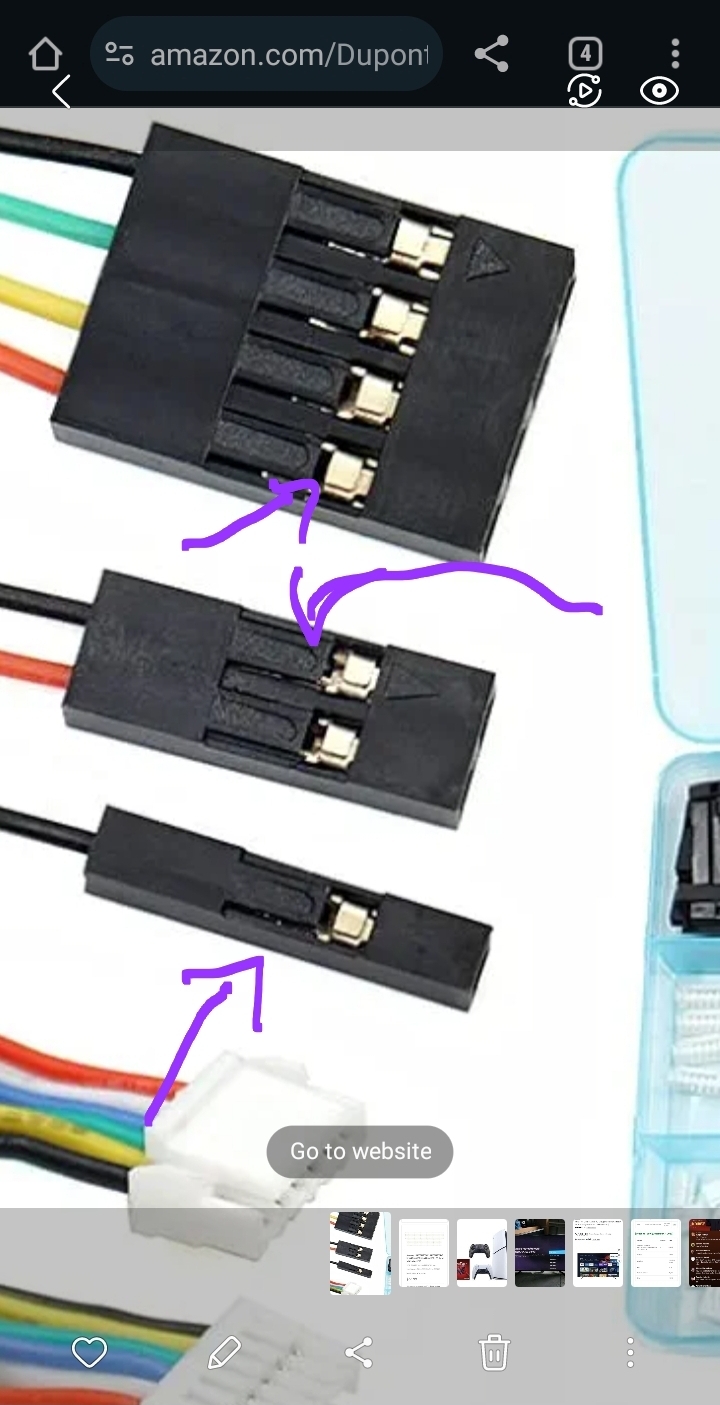

                  I'm not sure I follow.... How do I take a single pin out from the connector without damaging it?

                    And take the connector out, you lift the tiny tab with some tweezers or something and it pops up, then you pull the wire out.
