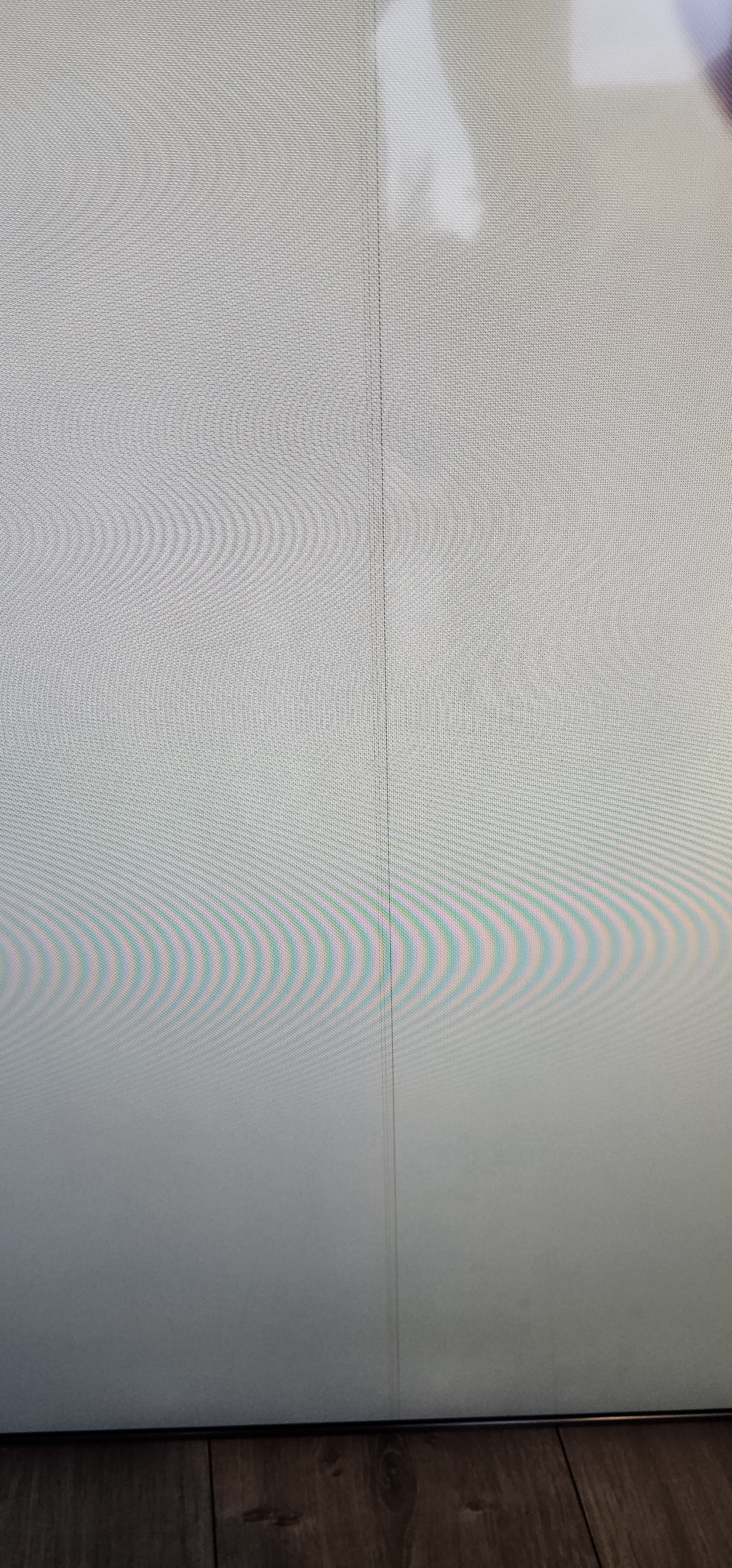

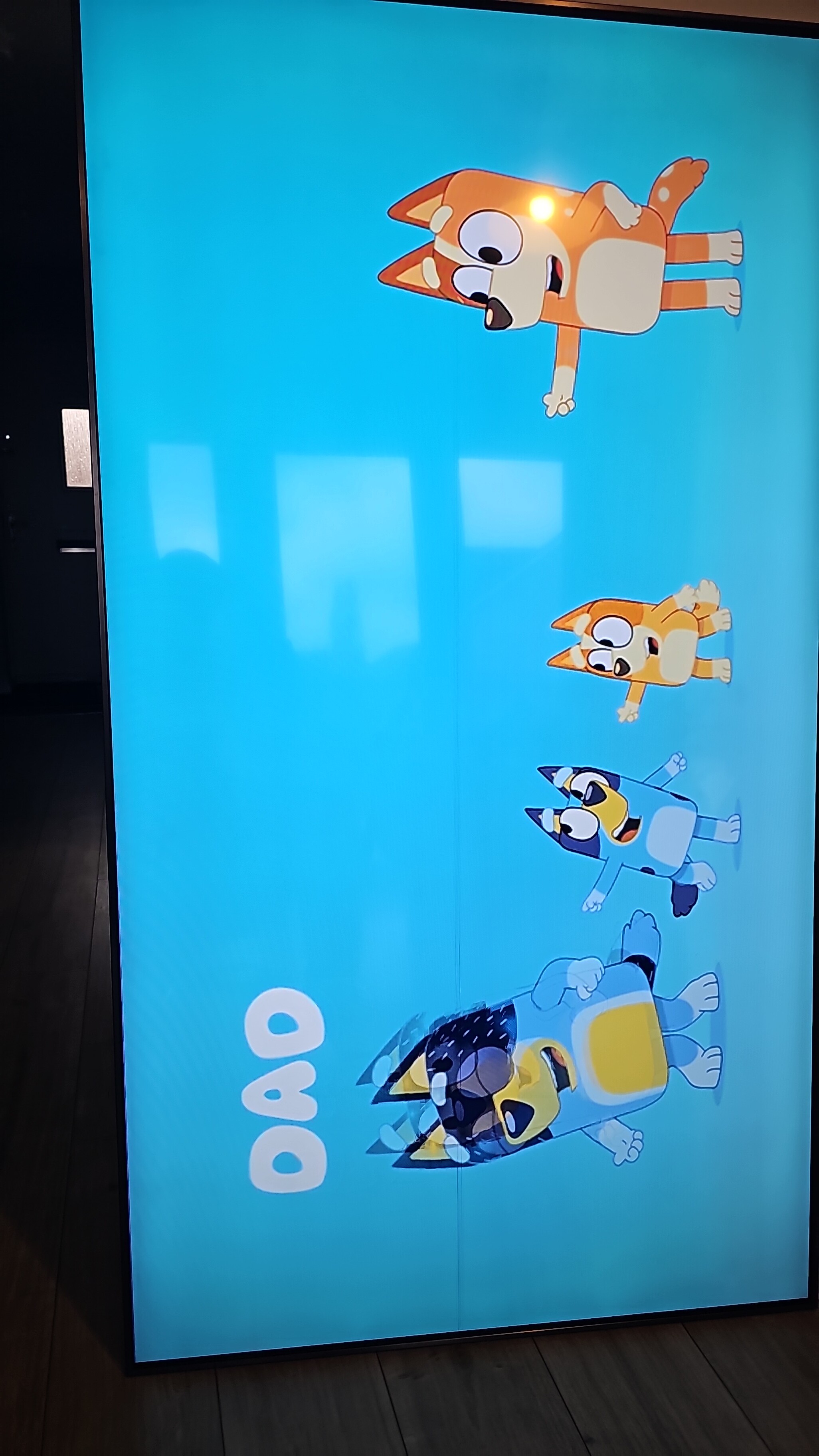

                    so ive managed to test it and filter it out to the left bottom screen board if i disconnect it ,it comes on missing a chunk of screen
                      Right, so try the tape "fix" if you have not already if no luck with that, might be a bad component on the panel driver board, post good focused pictures of them, the whole board.

                        yer i have its comes up with a line across the centre

                                      Got it back on with a slight few lines
