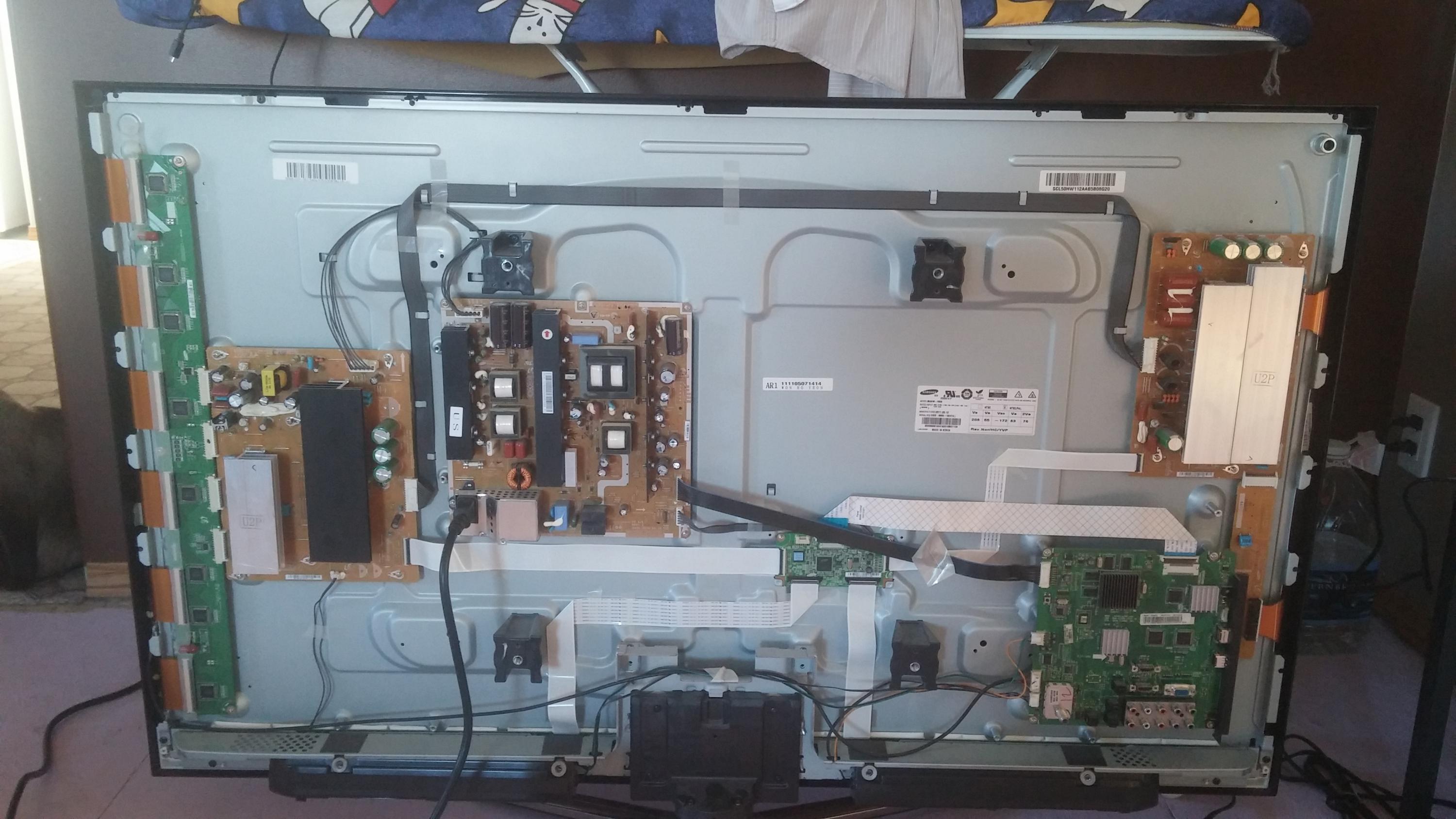

    Plasma tv was on loud pop wife says it shut down. When I came in the tv was lifeless. Unplugged it and waited a while. Plugged back in red standby was on. Tried turning the set on got a cycle of 5 tries where the relays click and then nothing.
    I have unplugged the x main board same relay clicks.
    If I unplug the logic board it will signal the tv is on plays the tune.
    Sounds to me like a short, where should I start?

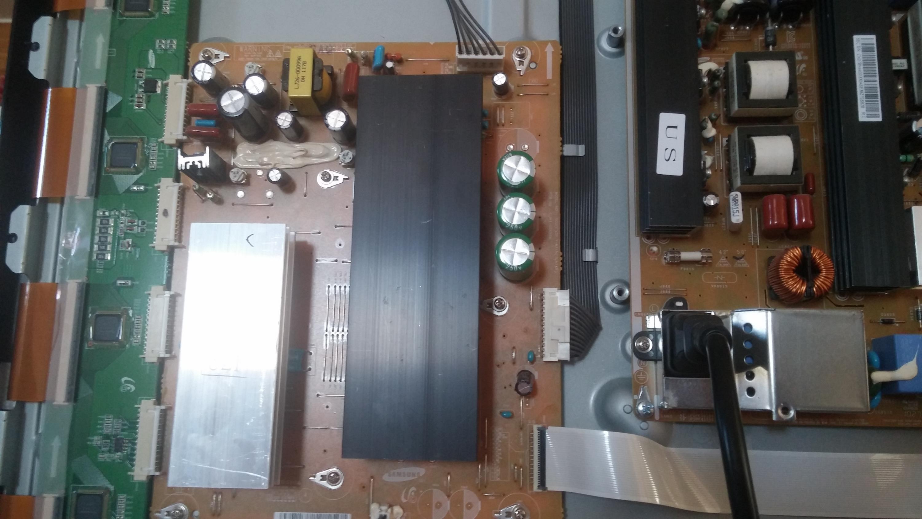

    Re: Samsung PN50C490B3DXZA power issue
    Have you tried isolating the Y-main?
      yes, but that in effect unplugs all other boards except the main... if I am understanding you right
      I am working on pics now
            OK, if you isolate the X-main from the Y-main what does it do? Startup tune?
              So if I unplug the X-main but leave the Y-main plugged in clicks...if I unplug the Y-main (vs,va etc plug) I get the start up. My voltages on start up are correct 206v on the vs.
              I am back to my original diagnosis of the Y-main shorted... am I missing something or am I on the right track?
                It is possible X-main is also bad. While rare, it is suggested on these panels which chain the energy recovery circuit (combined ERC) it's suggested to replace both boards simultaneously.
