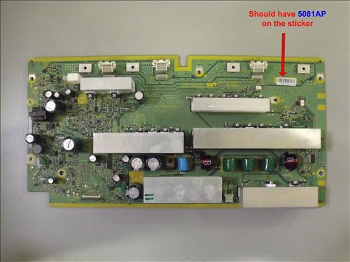

        TXNSC1MMUU = AP
        TXNSC11XEK50 = AW
        TXNSC1LPUU = AF

          With that Ebay listing, I can't make out the white sticker although I thought it was looking like AP.
          If that is a VT25 board it should be rev AK or maybe AY, won't suit yours as they are 3D versions and different.

                          How do I make sure I'm ordering the correct SC board? Looking at my SC board, where the AW/AY should be, there's nothing there. So it just has TNPA5081 then a blank yellow rectangle, so I'm not sure how to know which one to order.
                            Re: Panasonic TC-P50GT25 Power Indicator blinks 4 then 10 times
                            white sticker. I expect 5081AP
