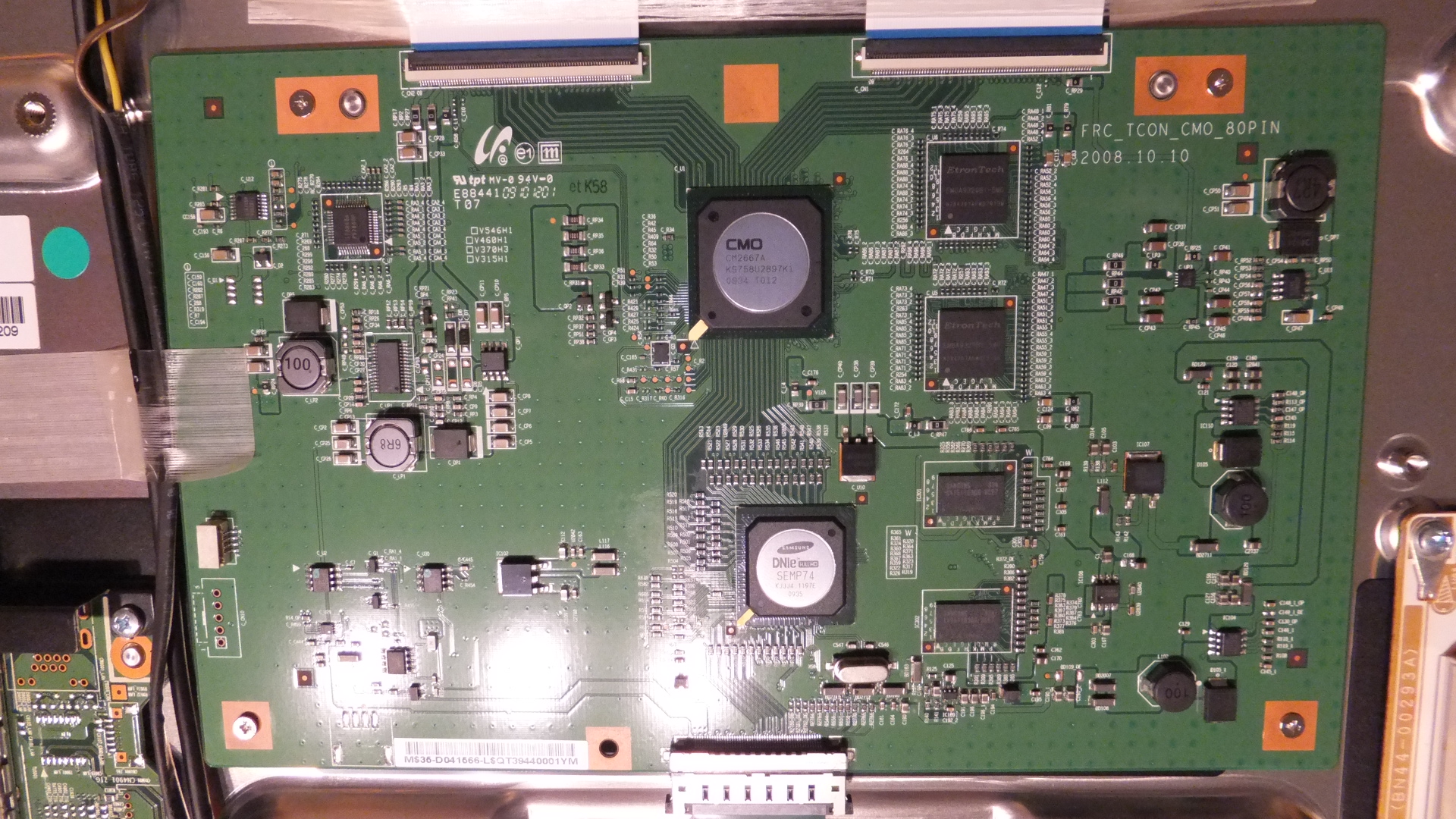

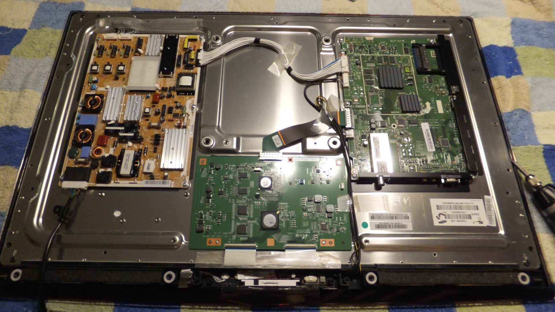

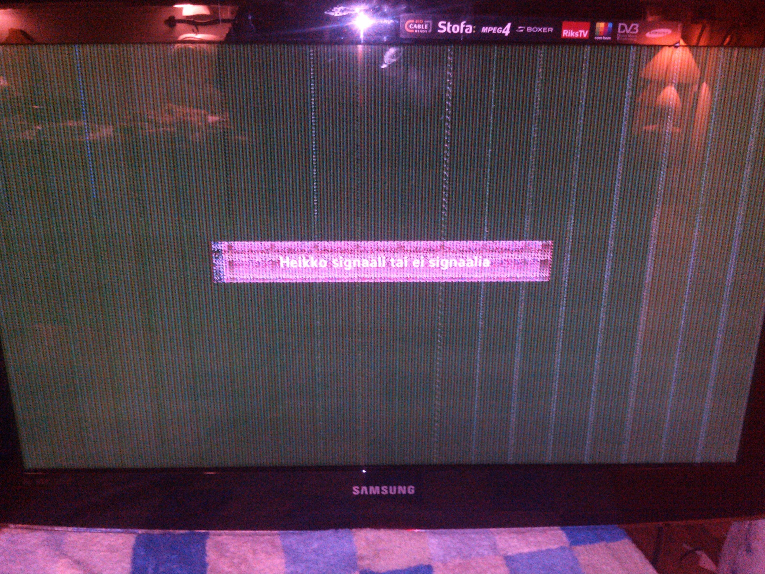

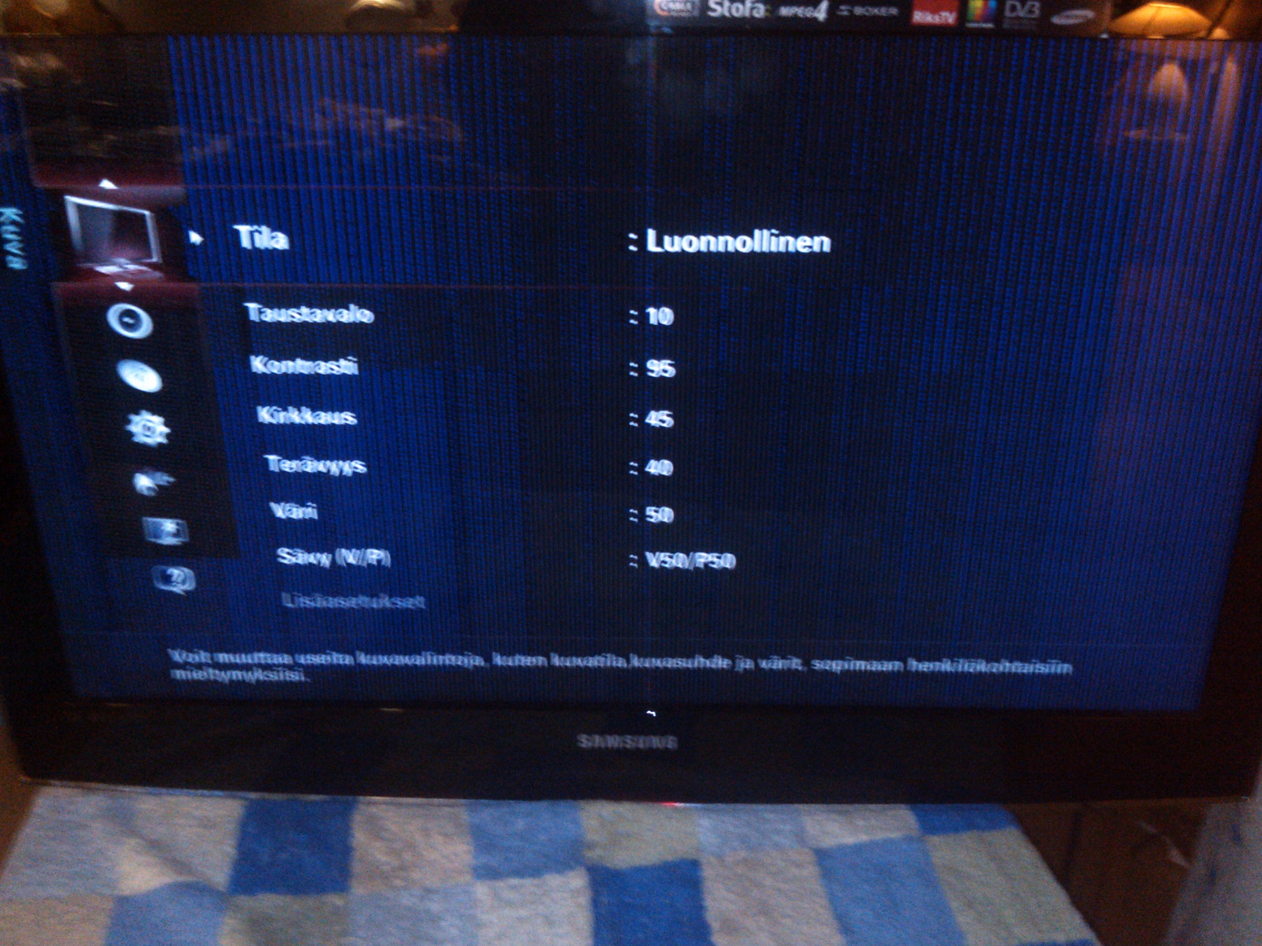

    Trashdigged this TV today, it's a fairly fresh model, from 2010.
    It worked perfectly for the first ten minutes.
    Then, all of sudden the screen was filled with vertical lines

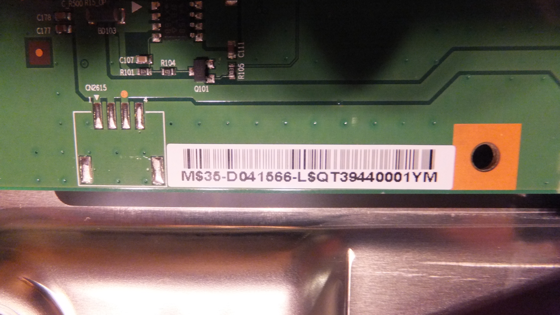

    Is it a bad TCON? TCON model is 35-D041566

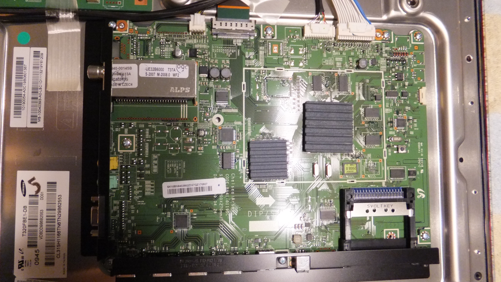

    Re: Samsung UE32B6050VW Vertical lines
    Put TV into standby
    Then on remote press INFO, MENU, MUTE, and finally POWER.
    Access Control > Test Pattern.
    You have three pattern selections (press left/right to move through each pattern, up/down for each generator):
    - FBE Pattern Sel: This is the main board pattern generator, the OSD is added on top.
    - FRC BeforeDDR: This pattern is generated on the t-con before the FRC converts the video (50Hz -> 100Hz, etc.)
    - FRC AfterDDR: This is after the DDR is used to process the video for the FRC.
    If the fault exists only on FBE Pattern Sel: main board
    If it exists on only the BeforeDDR or AfterDDR: t-con board
    Possibly, if you can narrow it down to Before/AfterDDR you could identify exact t-con fault.
      Thanks for your message.
      The lines appeared on FBE Pattern Sel and FRC BeforeDDR
      On FRC AfterDDR there were no lines.
      What would this suggest?
        Remind me, does the BeforeDDR pattern have any OSD?
        Sounds like t-con board, though not sure.
        You could try heating/cooling to see if you can locate the exact fault.
        • Jooo
          • Oct 2011
          • 222
          • Finland
          Used some freeze spray on the chips on TCON and the lines disappeared. Heated them up and the lines appeared again.
          Probably thats why the TV worked perfectly at first, because it was about -1C outside when I found it.
          Time to order a new TCON, thanks for your help
                Just a quick update on this: The original TCON was indeed the culprit. The replacement TCON was also faulty (ordered from FlatTVParts.co.uk).
                In the end I finally got a working TCON board and the TV works nicely. Also was able to find a used stand cheaply.
