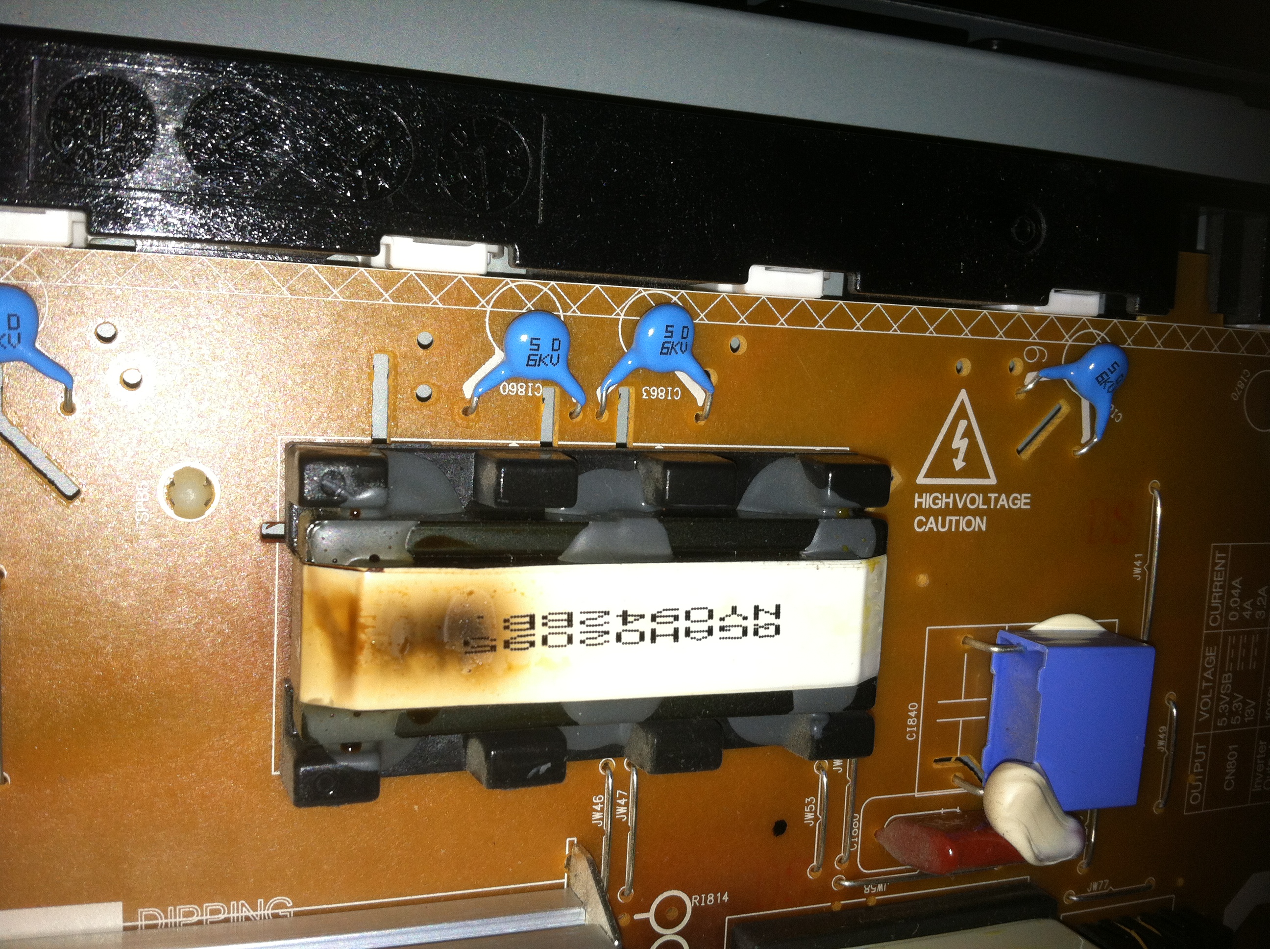

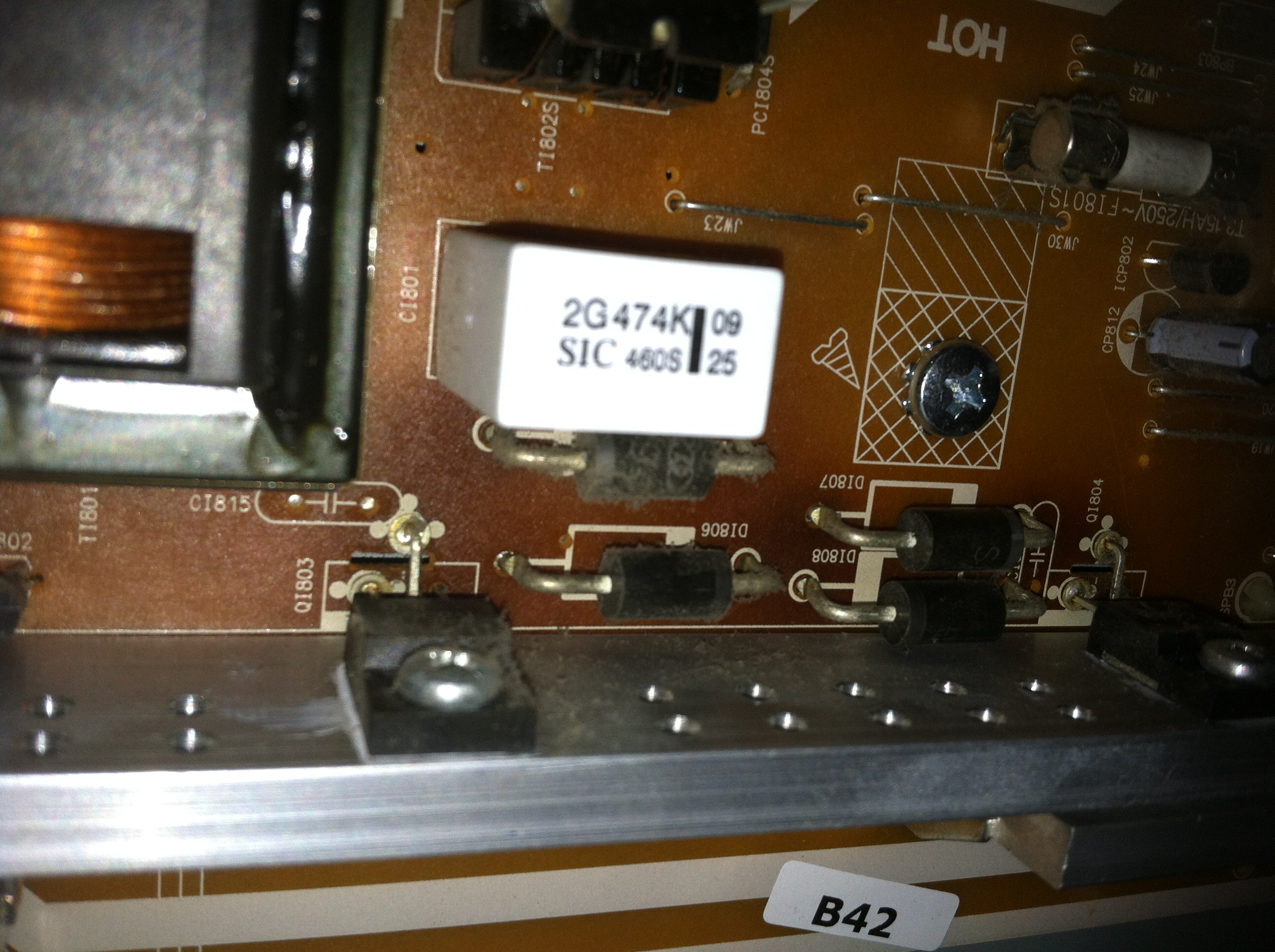

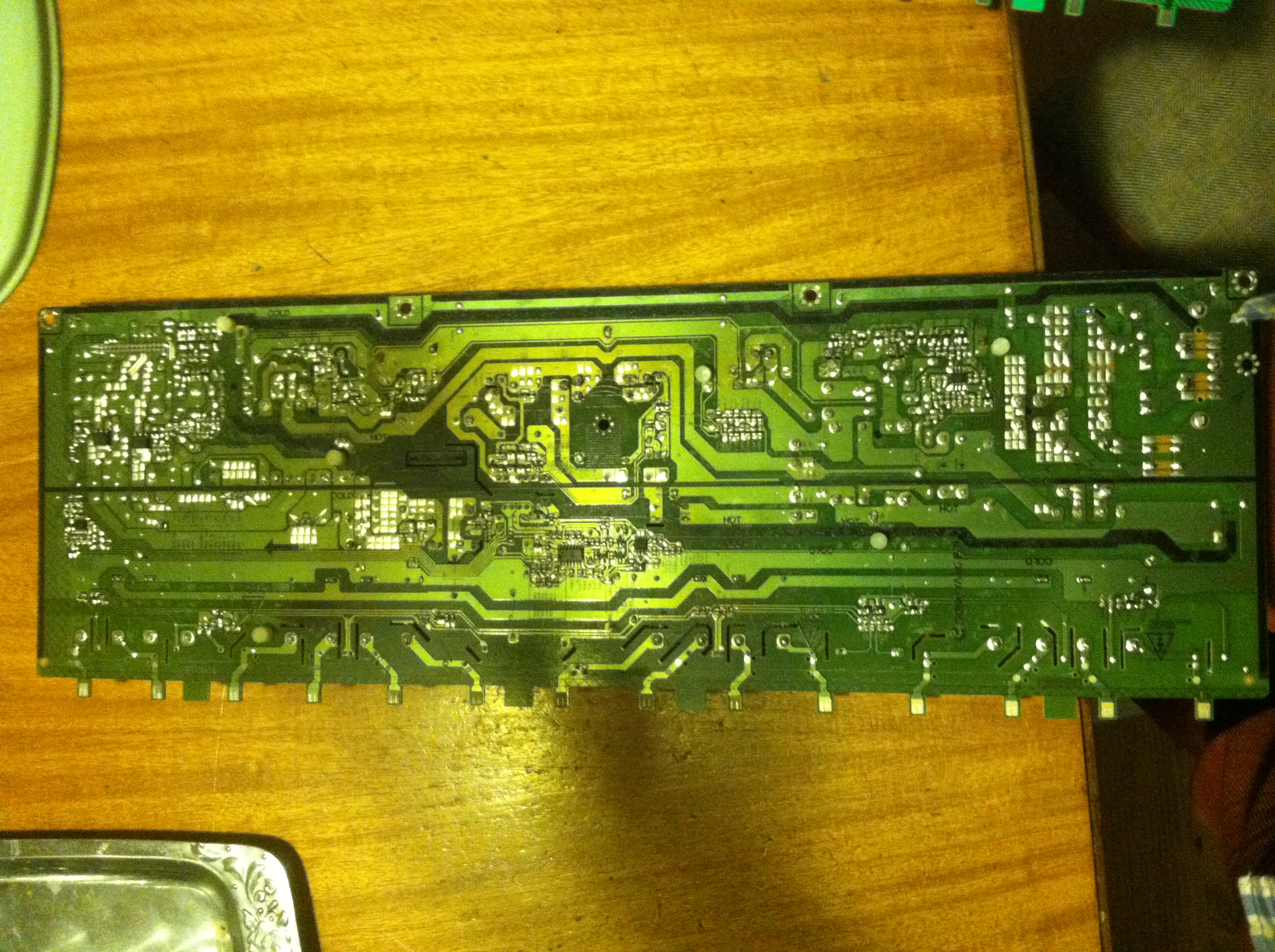

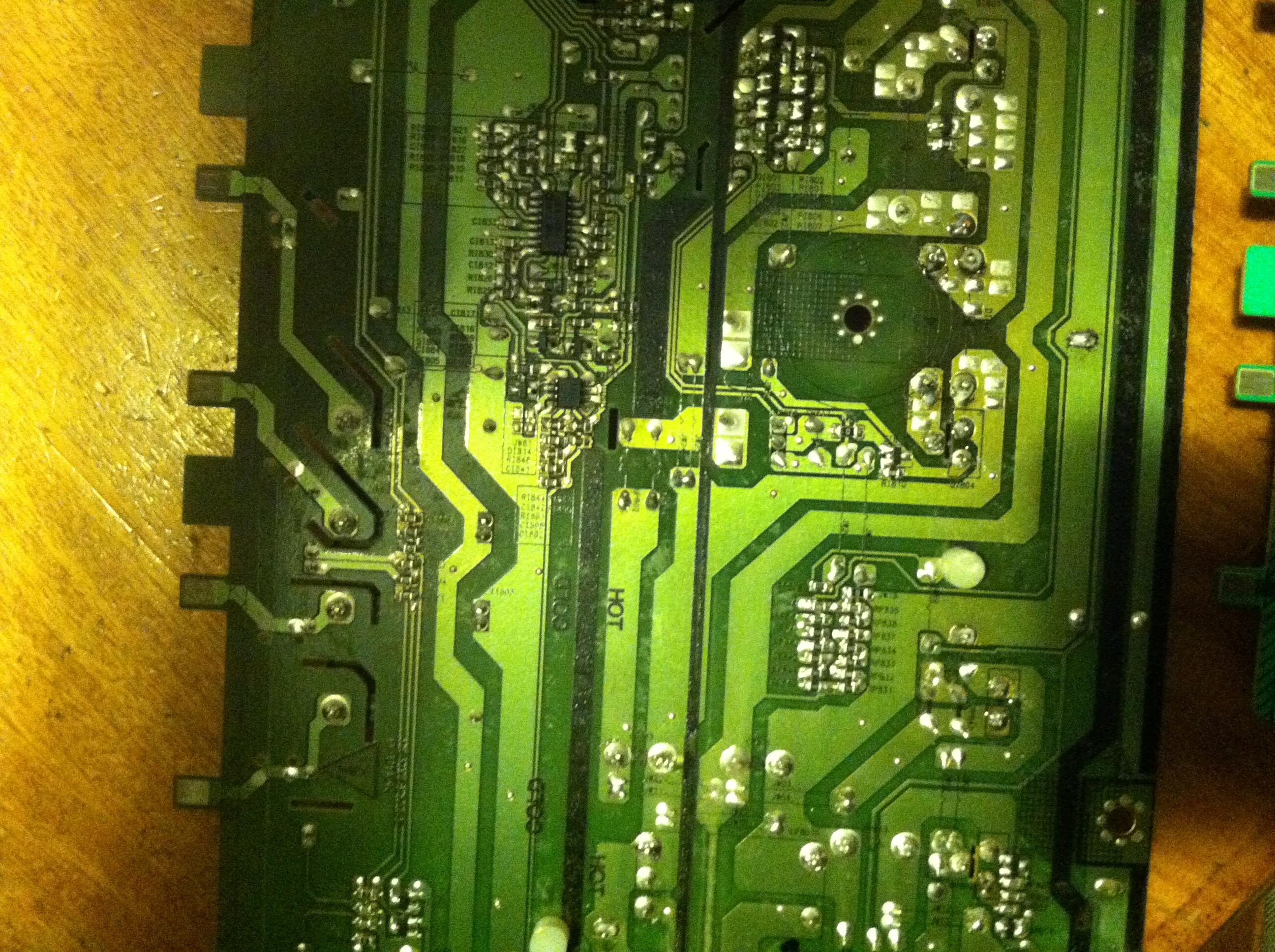

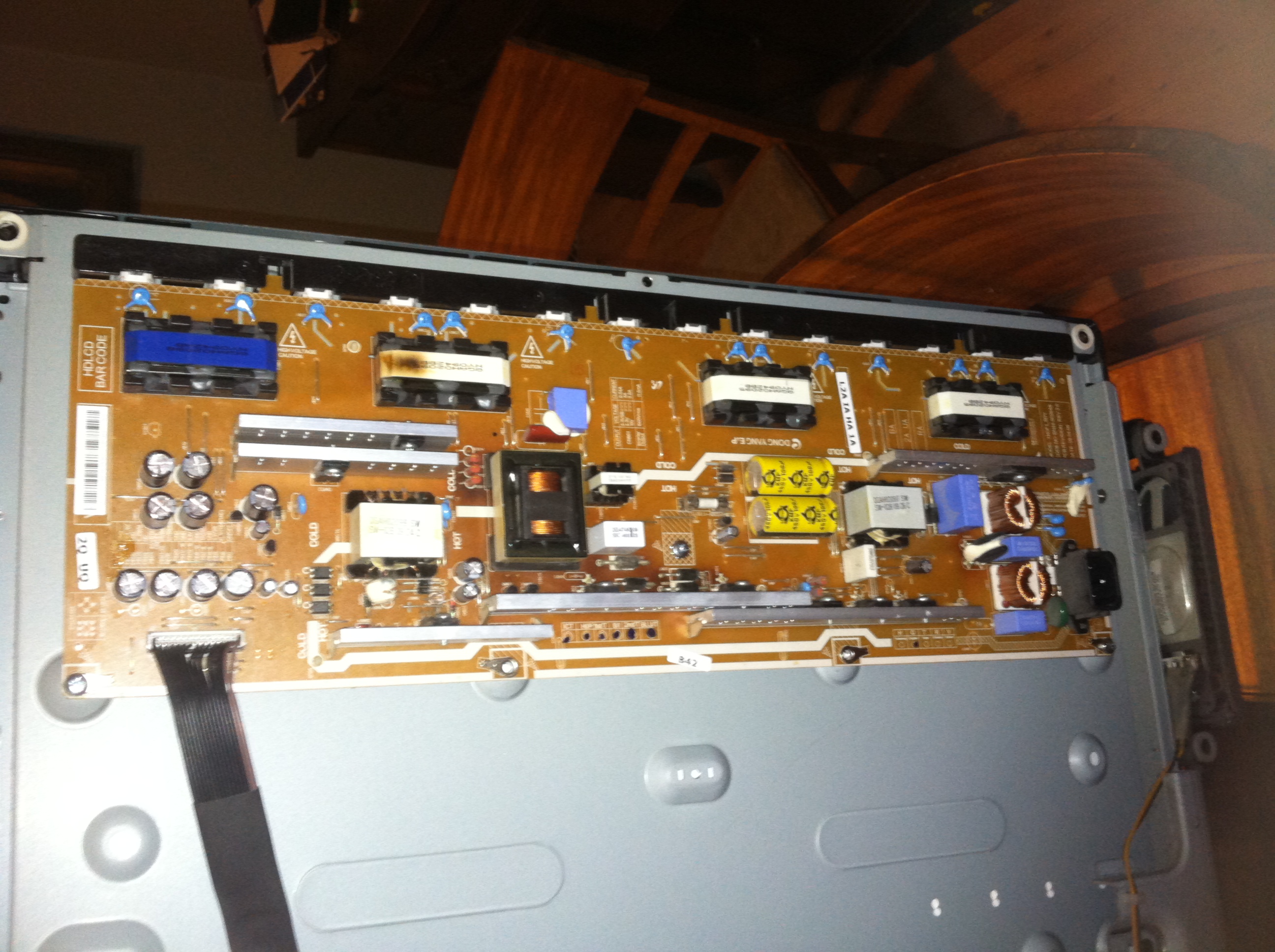

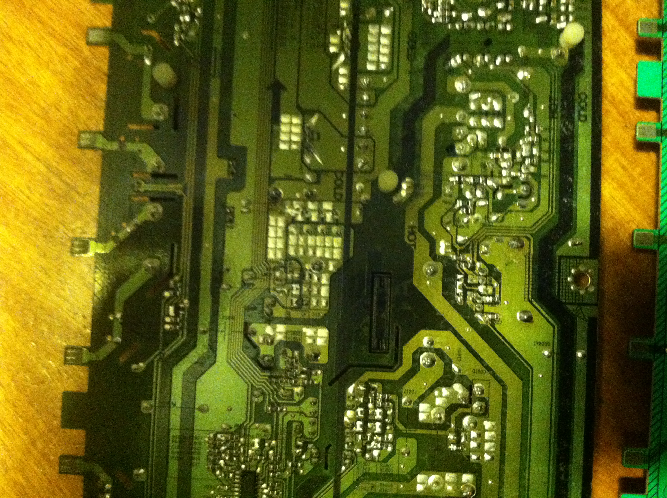

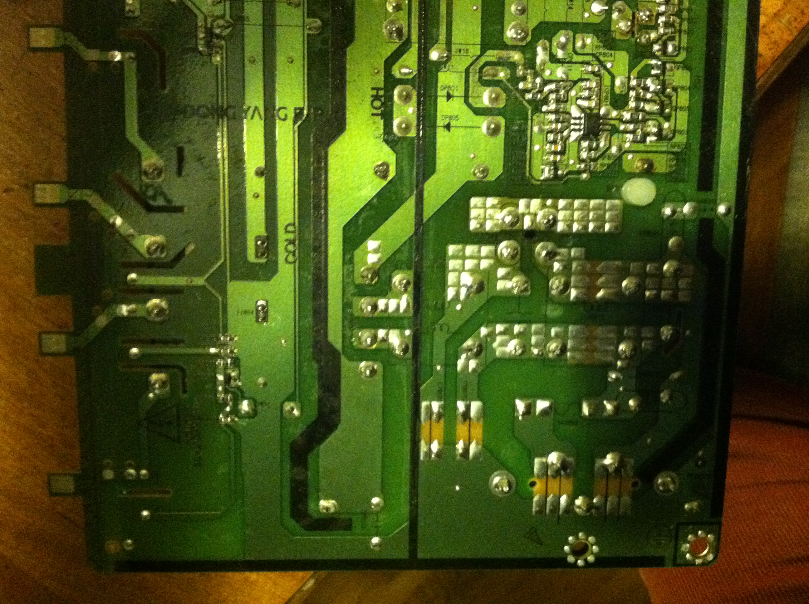

    Samsung LN40B550K1FUZA, BN44-00264B PSU Backlight Turning On and Off
    There is evidence of some heat and one of the inverter transformers has been swapped already. I also resoldered several bad/broken connections. The voltage at pin 23 of the connector to the main board (INVERTER ON/OFF) jumps from 0V to 4.3V and back to zero at a rate of about 60hz. After about four or five cycles, the backlights shut off, but the PSU stays on.
    I've worked on a set with a very similar PSU, BN44-00264A.
    https://www.badcaps.net/forum/showthread.php?t=29580
    I broke the screen in that one and traded the whole thing for RC parts so I don't have the board to swap in. However, I have the board that came out of it originally. It is missing the lowest transformer but has been reworked to still light the top twelve bulbs. The set powers on and stays lit but there is a dark band, as would be expected, at the bottom of the screen.
    I found this video...
    https://www.youtube.com/watch?v=PflyJ4H51Fg
    ...it looks like the burnt spot is likely due to a bulb or two going bad in the panel, which is what was happening in the other TV I worked on. Once I determine what is wrong with this PSU, I plan on fixing the bulb issue in this panel.
    Looking at the PSU, the transformer tests exactly like the other three on the board. No shorted or open secondaries. I guess it's possible that the transformer is heating up quickly and causing the lights to power off at which point it quickly cools and the lights come back to life.
    Would a bad transformer cause the INVERTER ON/OFF voltage to drop out though?

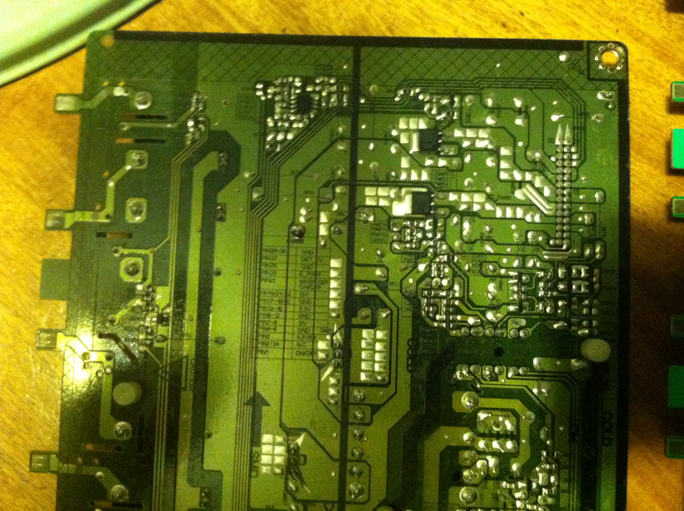

    More pics

      I just found this thread and it looks like the transformer could cause the on/off/on/off symptom. I'll throw a new transformer in there and see what happens.
      https://www.badcaps.net/forum/showth...ight=qgah02095
        Re: Samsung LN40B550K1FUZA, BN44-00264B PSU Backlight Turning On and Off
        That burnt out transformer winding, if it has a couple shorted turn, the DC resistance will not show up as bad, but if you use the ringer, it will probably shows as bad.
        Check the MOSFETs that drive this transformer for damage also.

          Unfortunately bud, I don't have a ringer to test the transformer. I went ahead and ordered one of the transformers. It looks like a fairly common failure on this power supply. I'll likely open the panel and check the bulbs out while I wait for the transformer to show up in the mail. Thanks for the tip on the MOSFETs, I'll check those too.

            Swapped out the bulbs with a nicer pair that I saved from the other set. Installed the transformer and it's working fine. Looks like another one saved.
