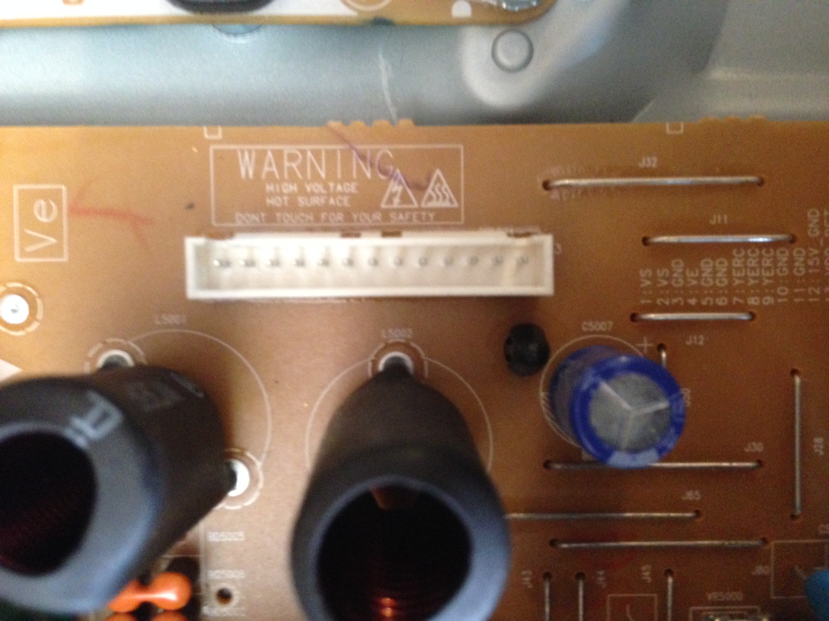

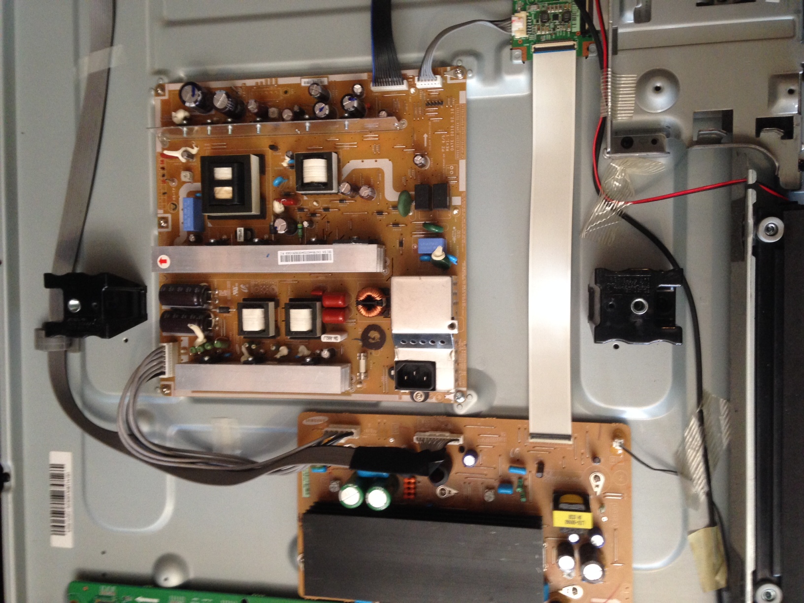

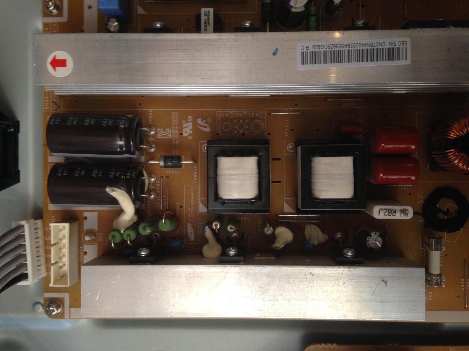

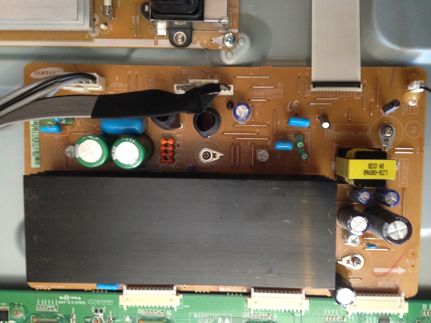

                        Here are some pics
                        When ysus is unhooked the tv goes into its normal start up.
                        when its plugged in again i get 5 or 6 clicks from the psu and then nothing.
