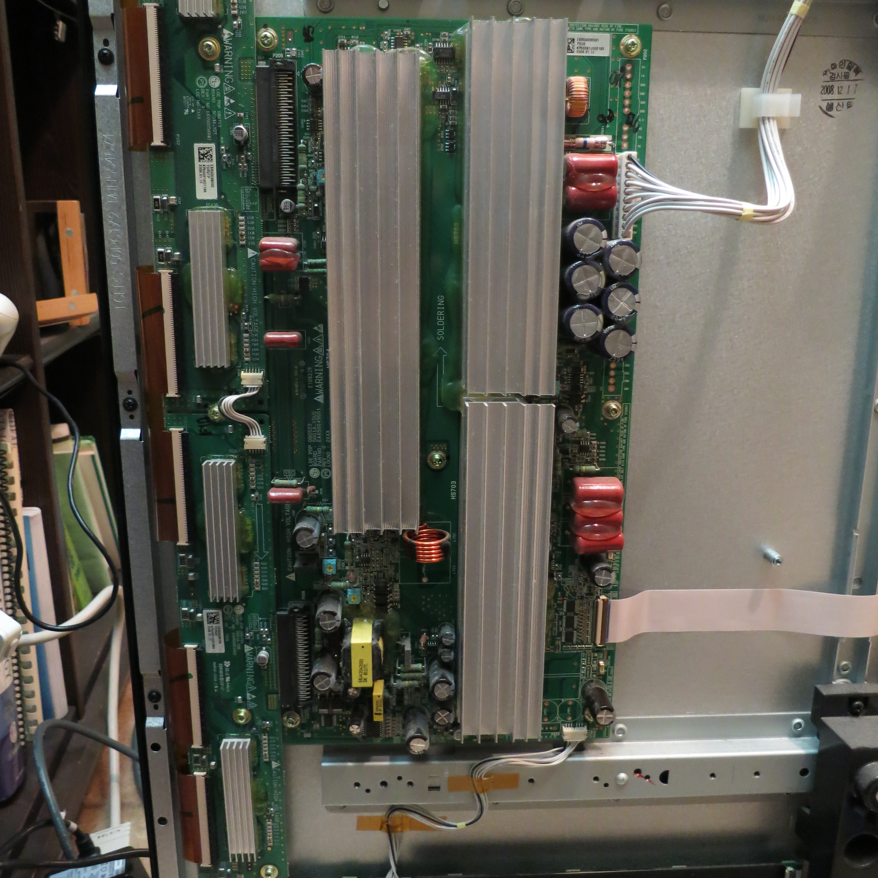

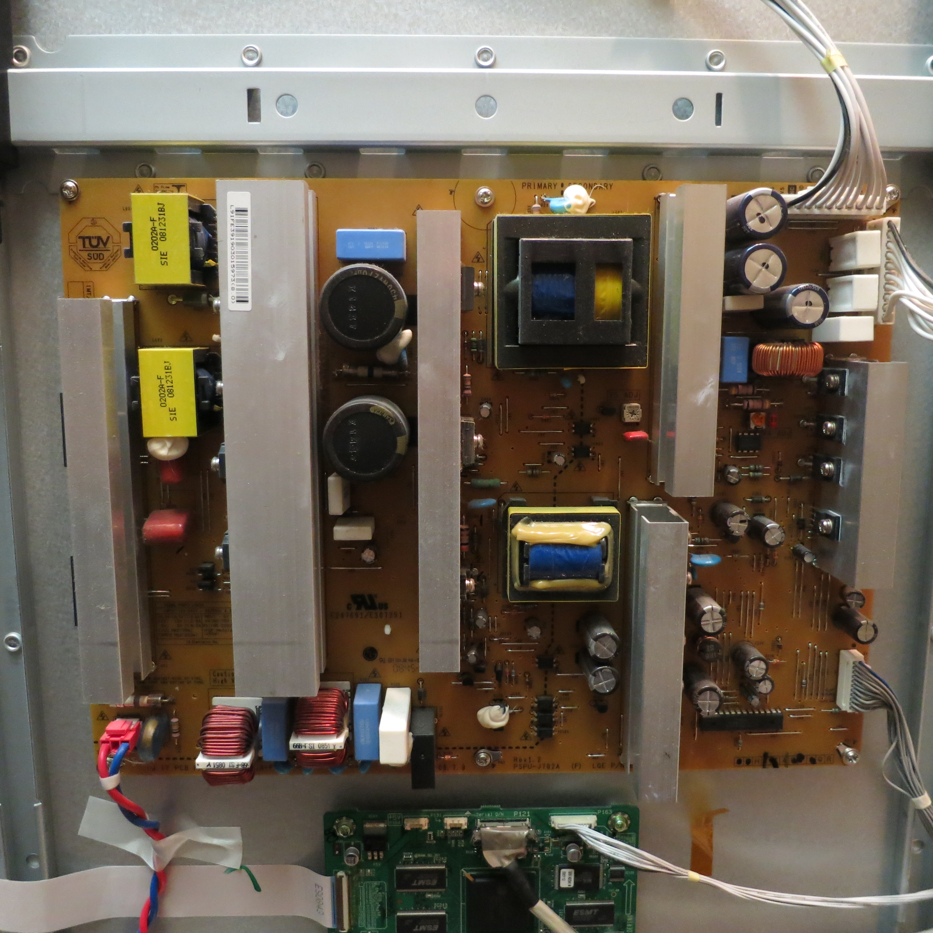

    So I am working on this tv , I'm pretty new at this stuff. The picture turned off and all I can hear is sound. So I figured it would be the ysus. I checked all the caps and they look pretty good.
    I disconnected the wiring to the logic board and then re connected them again. The tv magically worked again... For about and hour and now I am back at square one again. Would I be safe in thinking that it's the logic board that is causing the issue since I got a picture for a short point of time?
    Any input would be appreciated
    Thanks guys!

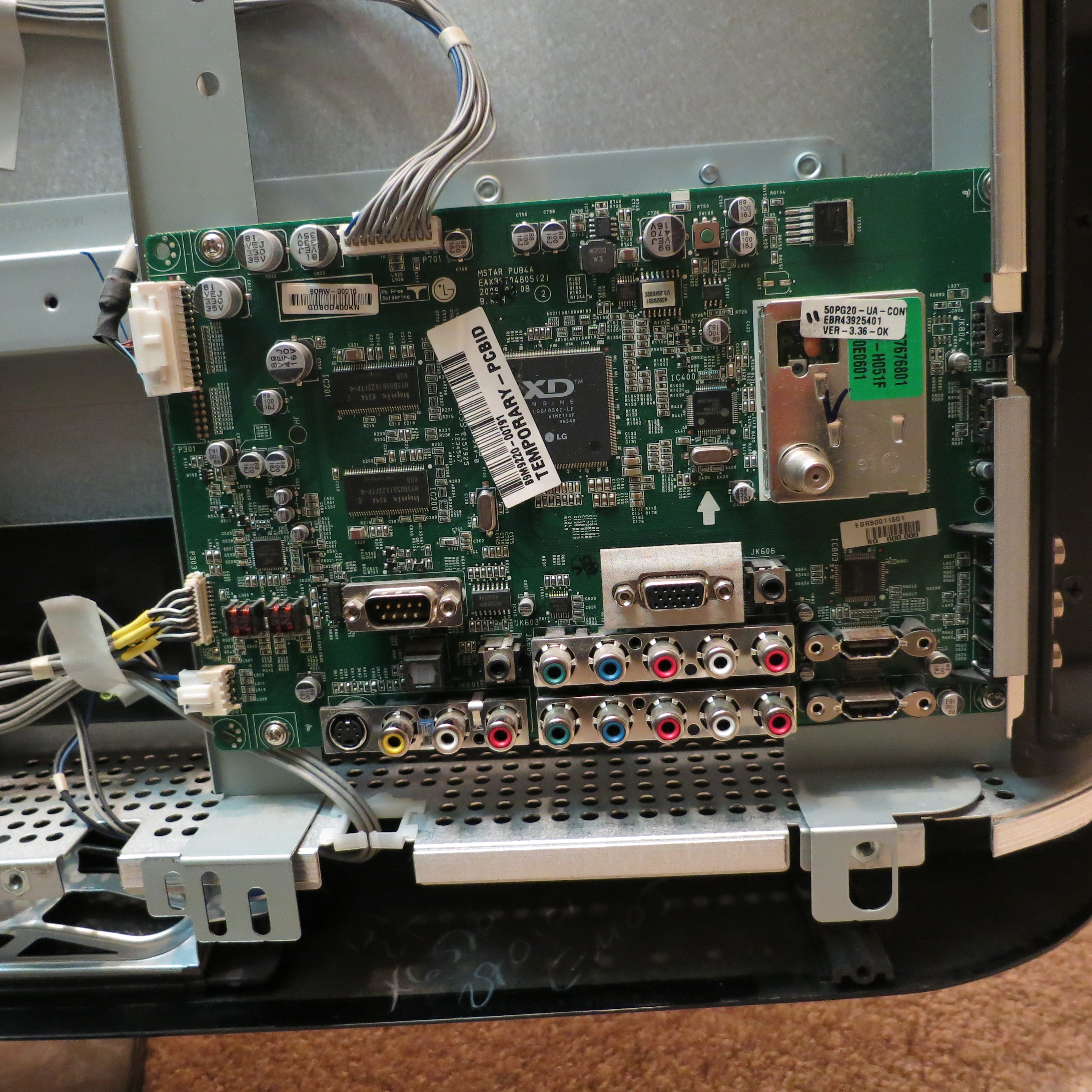

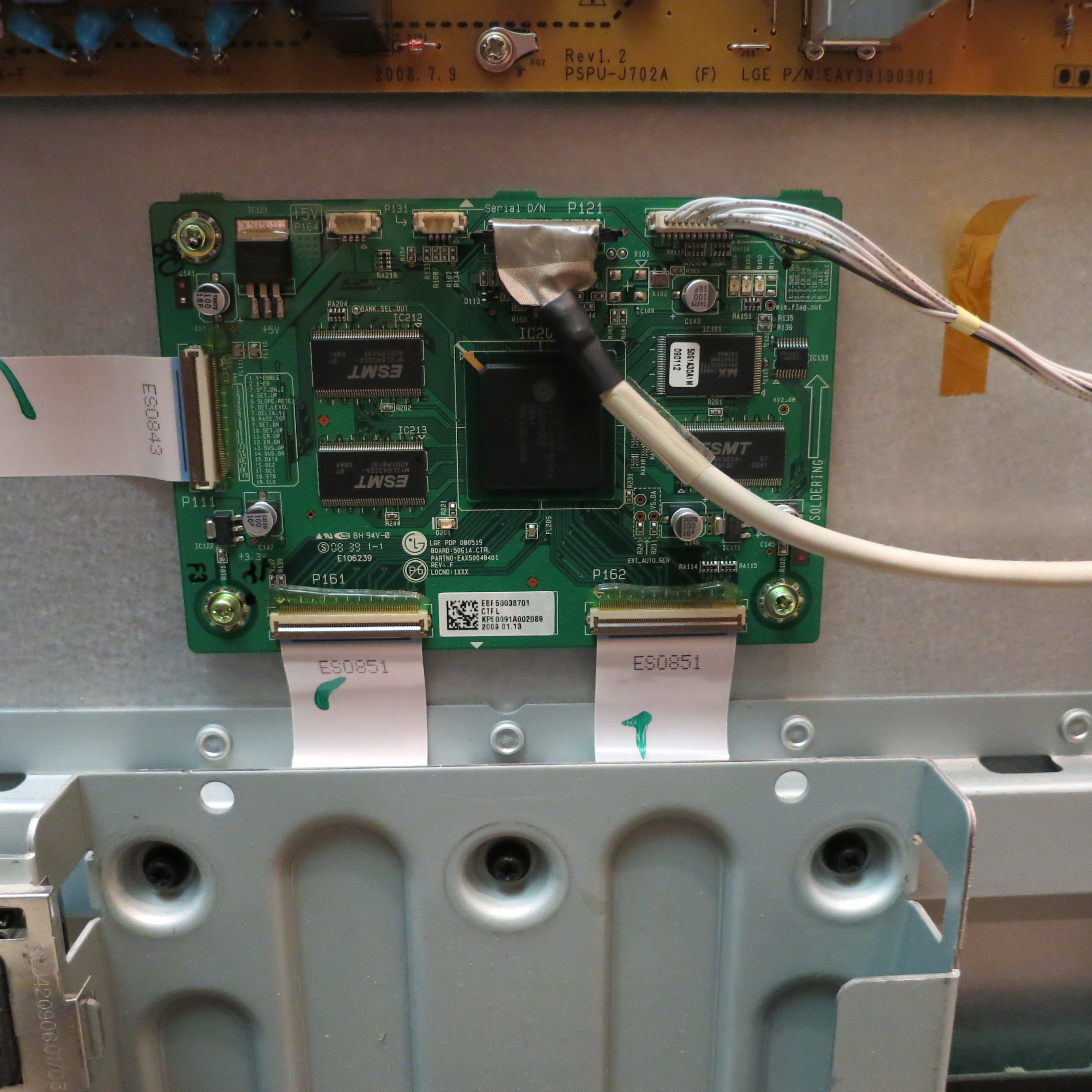

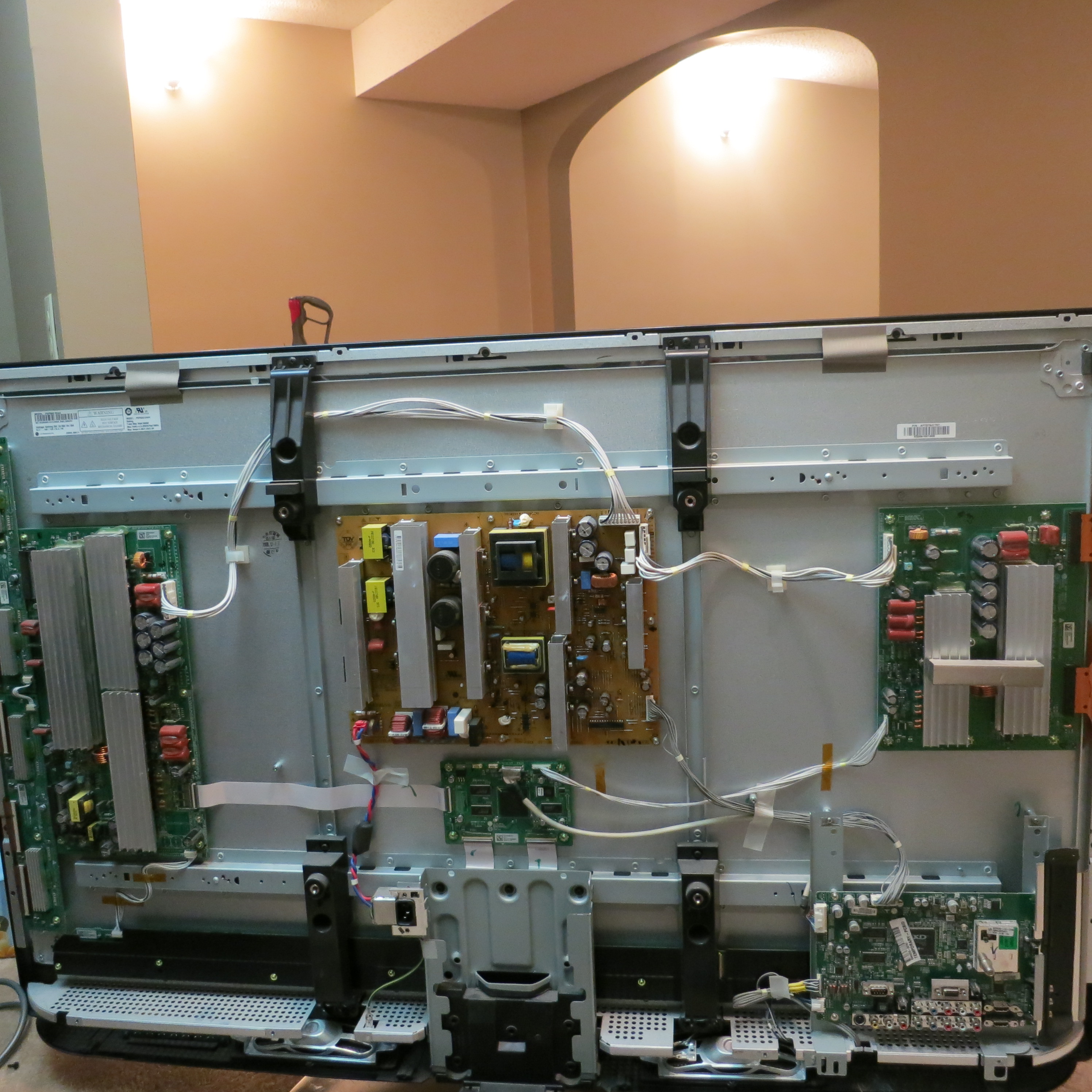

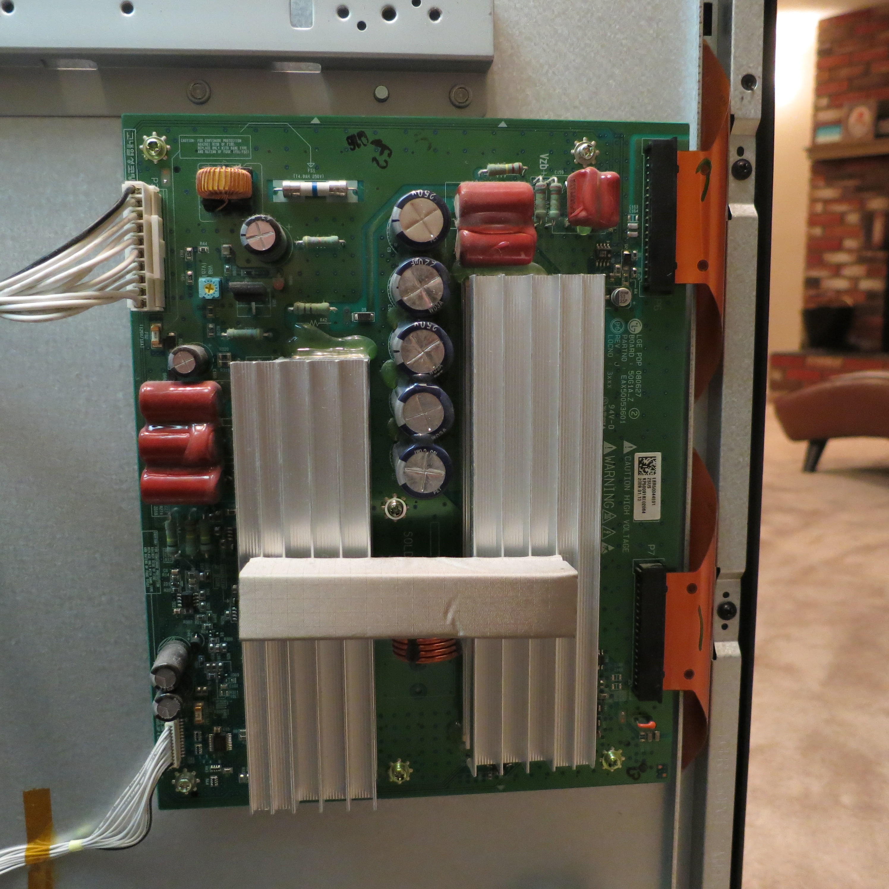

    I have attached some photos to look at.. i just find it so odd that it worked again for about an hour..
      Re: Lg 50pg20-ua

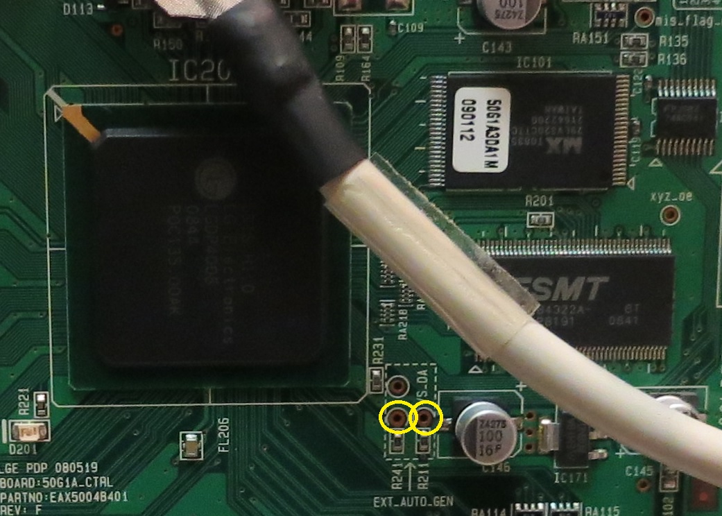

      OK - on this board: https://www.badcaps.net/forum/attach...7&d=1386118640
      Top most connector with silver shielding: unplug
      Two small copper holes, just to the bottom right of the "LG" branded processor chip, marked "EXT AUTO GEN", please place a wire jumper across them.
      Then turn the TV on. Do you get a sequence of test patterns?

        Do you mean these two?
          Re: Lg 50pg20-ua
          Yes

            Nothing happened when I did the jump... Any ideas?

              Check the VS voltage from the power supply. It's on the connectors going to the two large left hand and right hand boards. You need a digital meter. Expect in the range of 200 V.

                Hey there,
                I got 429.. so that would be .. 214ish Volts think there may be some issue here. It was the same on both VS pins.
                  Re: Lg 50pg20-ua
                  Make sure your meter is on DC volts, not AC.
