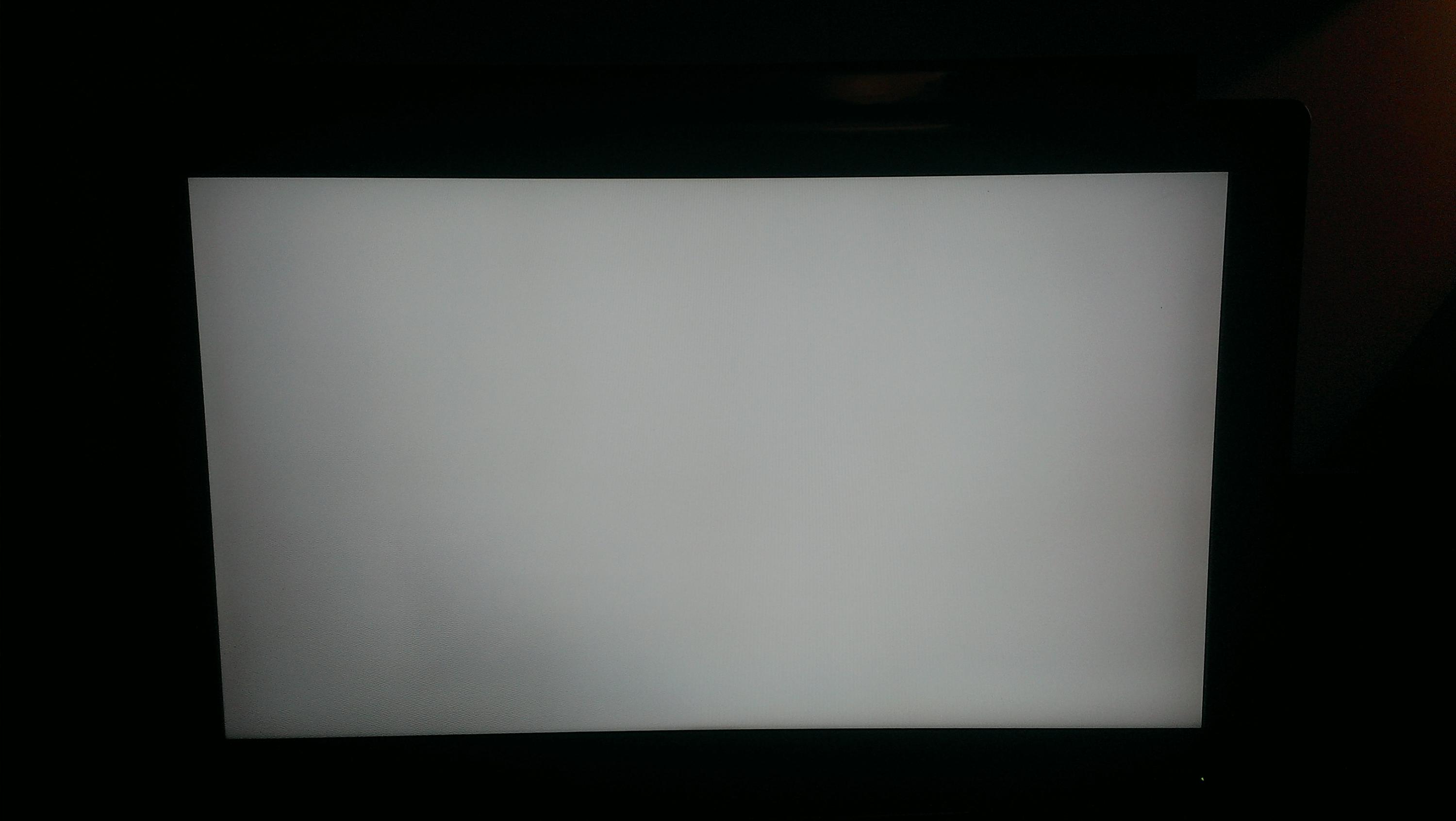

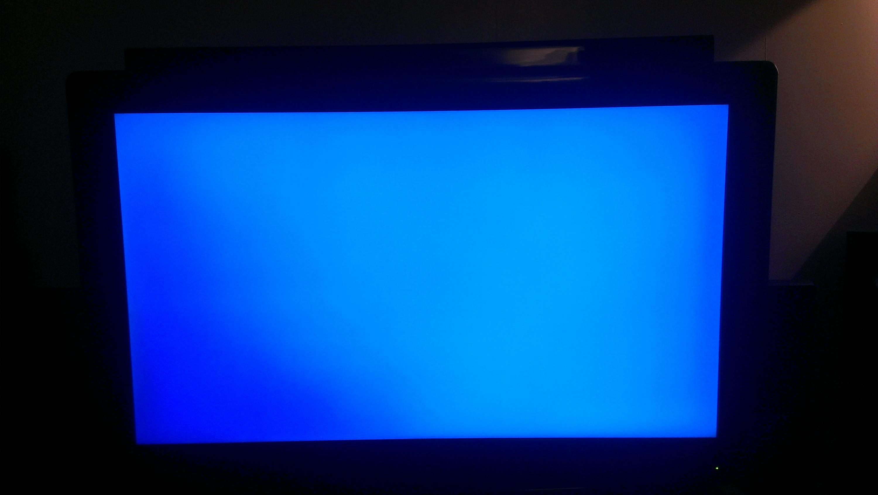

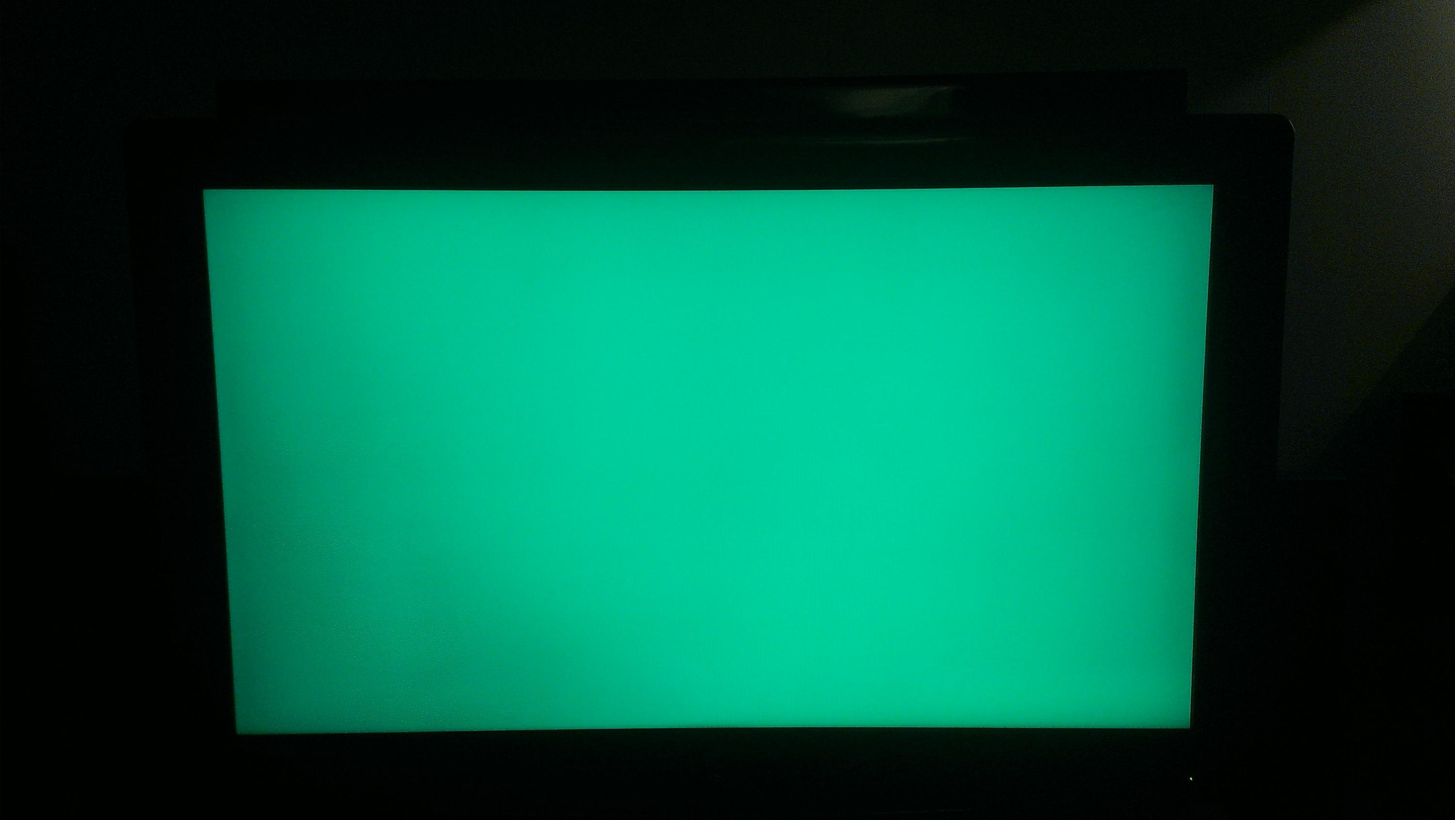

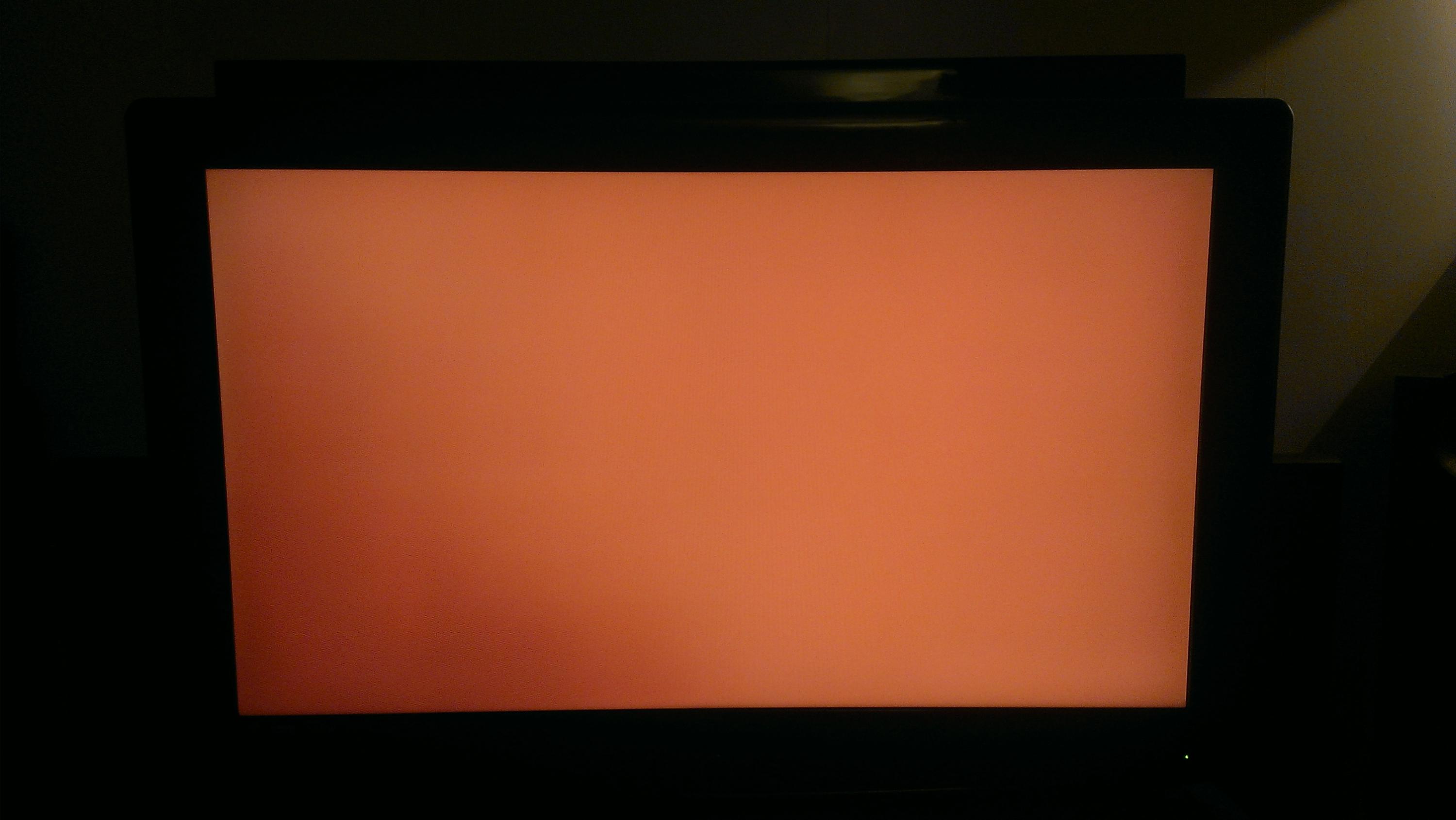

    i have 40 inch lcd, when i got the tv one backlight was cracked, now replaced.
    the backlights are working perfectly but the lower left of the screen is darker then the rest, its like the brightness or contrast is turned down in this area. at times it looks fine but in darker scenes it sometimes looks much darker than the rest. not a defined area just dark emanating from the corner. the affected area seems to radiate in and out as the screen brightness changes. I'm 100% its not the backlight, the diffuser, pressure on the panel, or anything like that. it seems to be the panel itself. its possible the tv was dropped. but I've never seen a panel do this before only sharp lines, cracks, physical damage that is obvious. its like the voltage is lower in this area or something. can anyone explain whats going on?

    Can we see a picture of the fault?
    It could be permanent "mura" effect. Though that is rare on 40" panels. It is common on 32", 37" and 42" Chi Mei and Chunghwa panels.

        I can't see any other part causing that. Looks like mura to me. What is model of the LCD panel inside and of the TV?

            Mura effect
            https://www.google.co.uk/search?q=lc...do%3B960%3B720
            Various types of mura can occur.
            If some signal were getting lost, it would affect a block region. The tab drivers drive rectangular regions of the panel, so you might get a whole block that's blank or in error in some way, but never a random region like that.

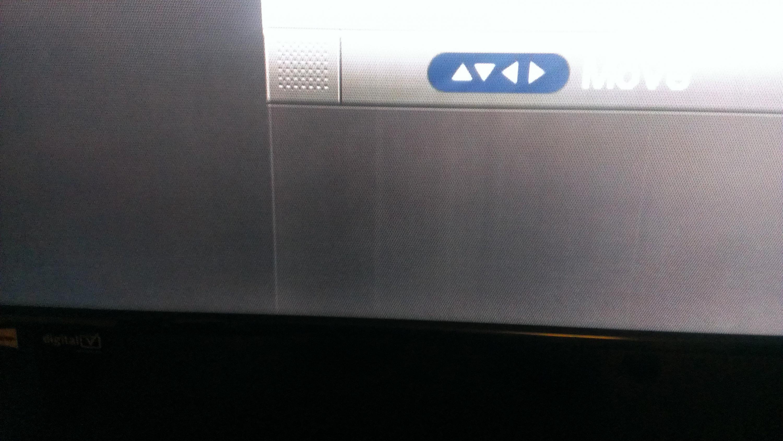

                    Re: mystery lcd problem
                    There is no way a main board or t-con board could cause such a fault.
                    Main boards process the video signal as a whole, faults typically render themselves as repeating error patterns which is -rarely- fixed to any obvious grid because they don't usually process the video as blocks but rather as pixel after pixel. T-cons rarely store video information (very old ones do) so any errors they cause affect one of their outputs such as a repeating vertical pattern. They also often process each subpixel as a separate pixel unlike the main board which processes 3 subpixels as one pixel (R-G-B: three subpixels...)
                    It's almost certainly panel. Regional defects nearly almost always are. There's a small chance that cleaning the diffusion layers could sort it, but from what you've described, you did this already? When I say panel fault, I consider the whole LCD assembly to be the panel (backlight + diffuser + LCD + drivers + frame) to be the "panel".
                        I'm sure its the panel also(the actual lcd)
                        it has an effect where light areas in the middle are affecting the area outside them to the edge of the screen, in this pic the white line that comes off the corner of the menu box, only the defective area has this not the rest of the screen.
                        what ever the exact cause ill put it down to being unfixable.
