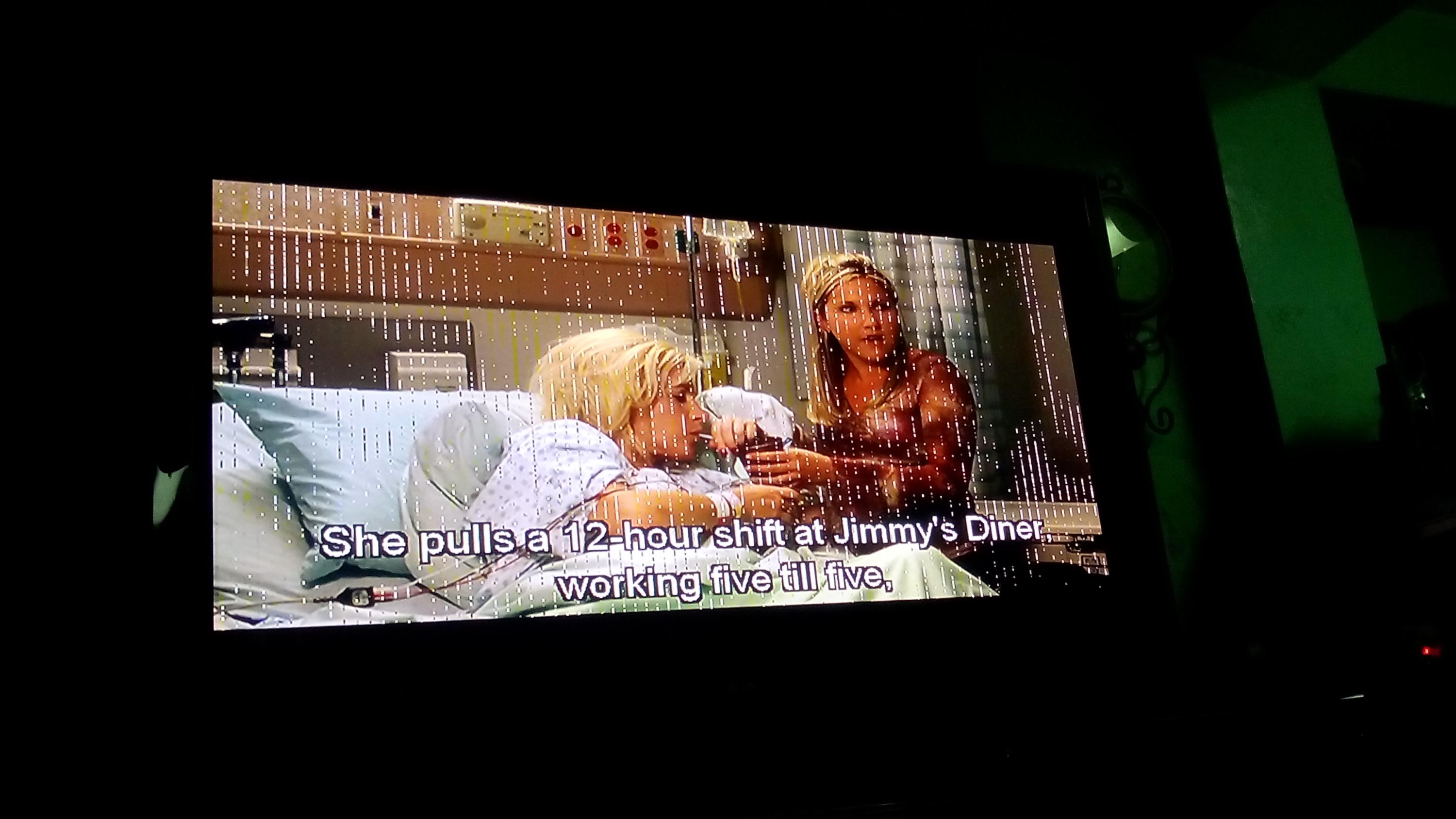

          I have an 8 year old 50" LG Plasma PC50. The problem I have seems similar but not exactly the same. Perhaps the solution is the same as well, so here goes..
          I attach screen with the problems showing. They are bright white sparkles that appear small and scattered at first then expand vertically to fill the screen then shrink and dis appear disappear. I have not been able to diagnose if they come when unit heats up after hours of watching as they just appear, whenever they feel like it seems. I've tested on all video sources and the problem seems universal. I placed a 1000w voltage regulator on the TV to see if it is from power fluctuations but no dice. At times the problem simply disappears for long periods (days) and the pic is perfect, then comes back in small doses or full blown unviewable pictures. The audio is unaffected as you can see the color itself is fine.
          As a backgrounder my local TV repair has recently replaced an IC and capacitor to solve a power problem (no power at all). That seemed to work out fine and two weeks later this new problem appears. The local guy has not been able to resolve this since. I dont want him touching it anymore for fear of further damaging 'one of the last Plasmas on the planet :-)'
          Any ideas? I'm not electronics repair guy but more than capable of rooting around the back if need be. Thanks in advance....

            Re: LG 50PS80 plasma: Moving rows/array of blue dots in black
            As a quick add on. When you see the picture problem you might notice some yellow streaking as well. However, those are from the way the photo was taken. The actual live problem, shows only white sparkles..
              What is the full model number of your TV?
                Its an LG 50PC1R.
                It was originally purchased in Singapore in 2006-07 I took it second hand in 2008 and no other problems experienced. Thanks.
                  Since the model of your TV is different to the one in this post (it's a completely different generation of TV) I suggest you start a new thread and if possible, include pictures of the problem.
