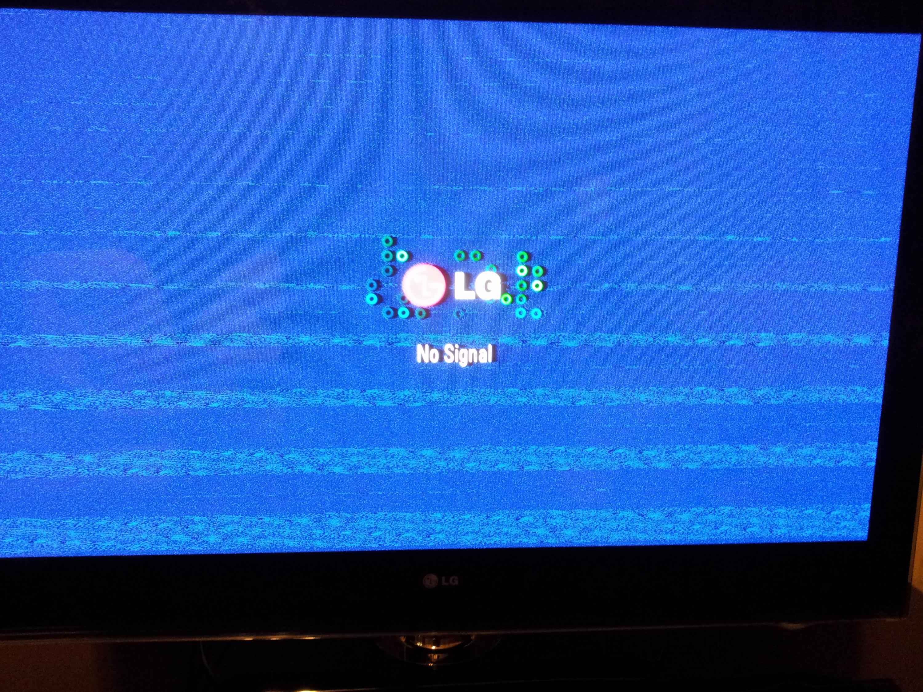

    LG 50PS80 plasma: Moving rows/array of blue dots in black

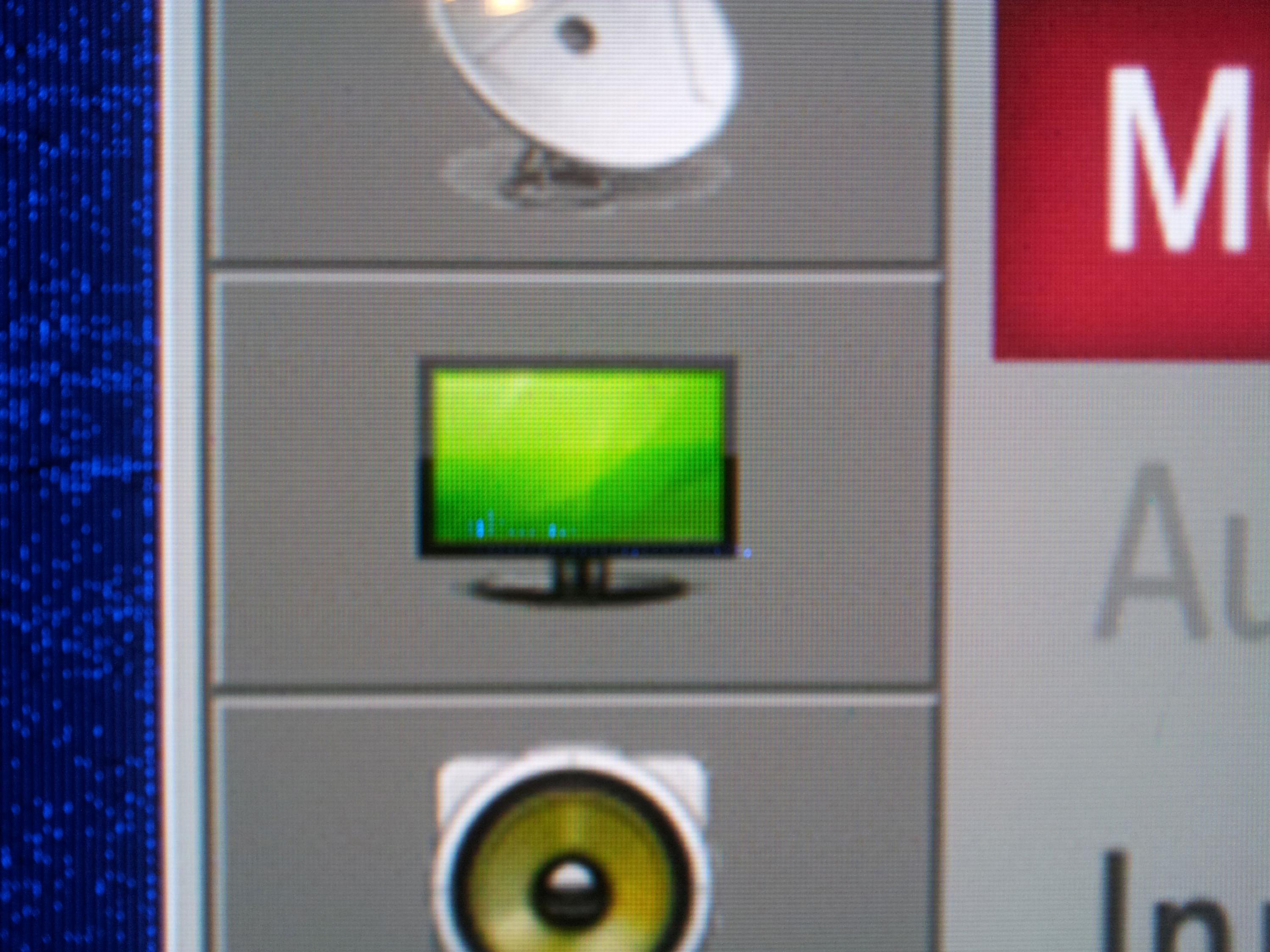

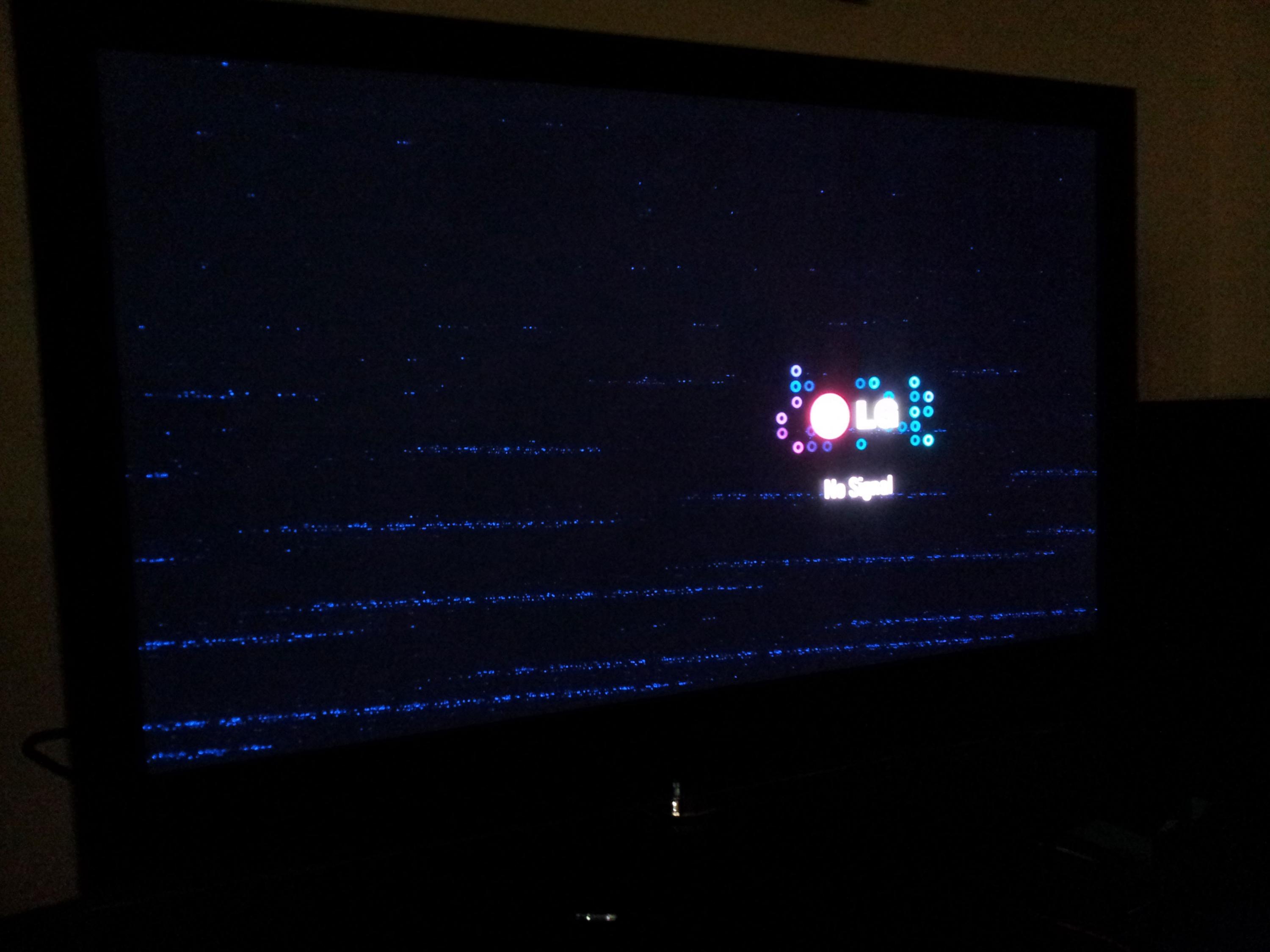

    My LG 50PS80 plasma, which is around 3 or 4 years old, has developed an issue. I was watching TV last night and noticed these cool bright blue dots in the black scenes on the screen and thought it was part of the show I was watching. It wasn't until the screen went full black that I saw this (see attached pic please) These blue lines are made up of little blue dots and the entire array of lines/dots is moving left and right all in succession. It's sort of bouncing left and right on the screen a few inches. I left the TV off overnight and this afternoon turned it on to find many more lines. The entire screen is basically covered with these blue lines to the point that black is no longer there. Has anyone seen this before? I'd greatly appreciate some input on which board to look at for an issue or is the panel failing? When I bring up a menu the menu looks great except that the reds are more pink than red and any black area has blue dots/lines in it.
    Thanks.
    Re: LG 50PS80 plasma: Moving rows/array of blue dots in black
    Looks like a control board issue. Probably not the panel and not too expensive to repair.
    Can you provide a picture of the boards inside the set? There is a quick and simple test which will show if the control board is bad.

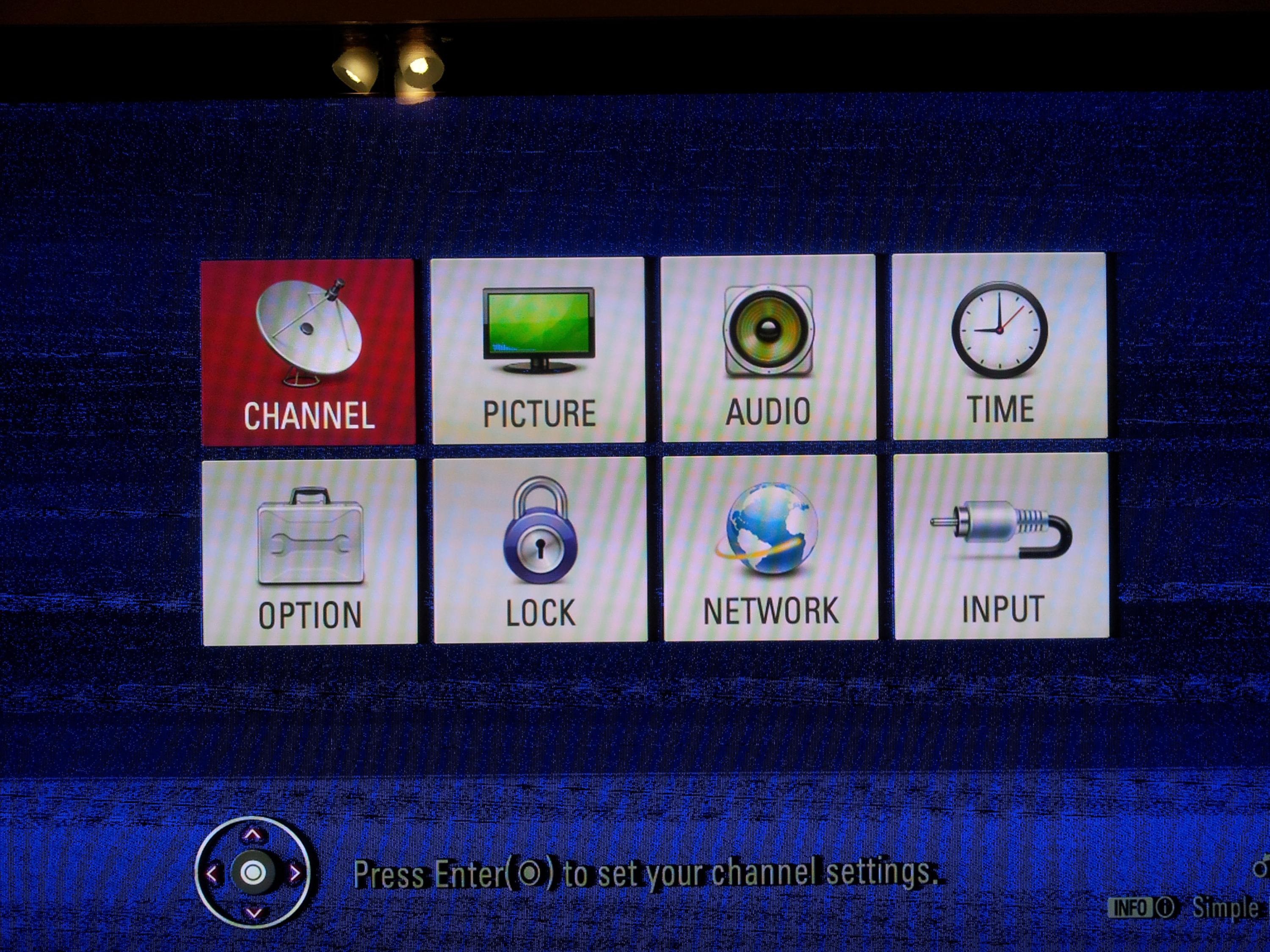

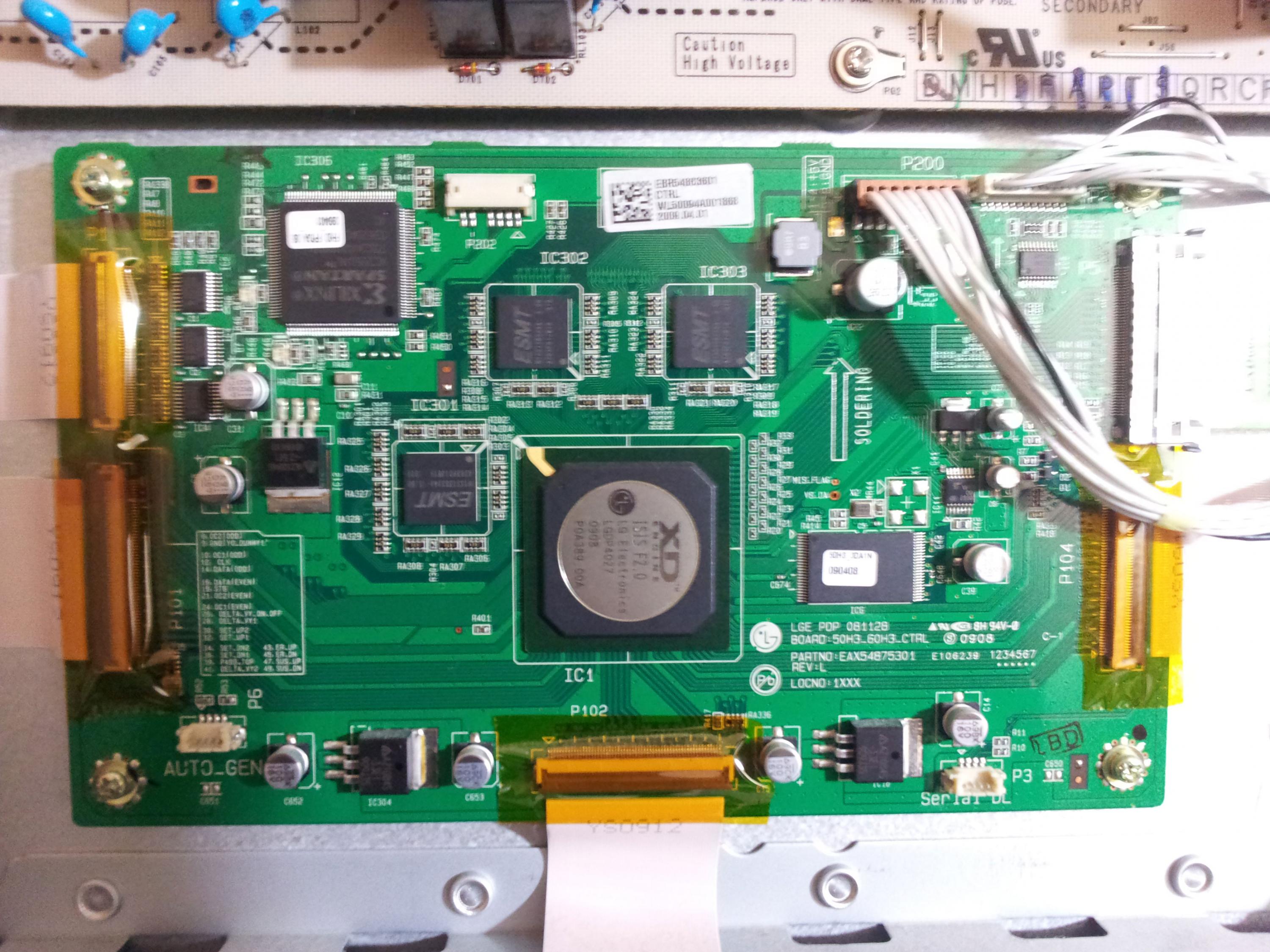

        So here are some photos of the TV as requested. First grouping shows the current issue.

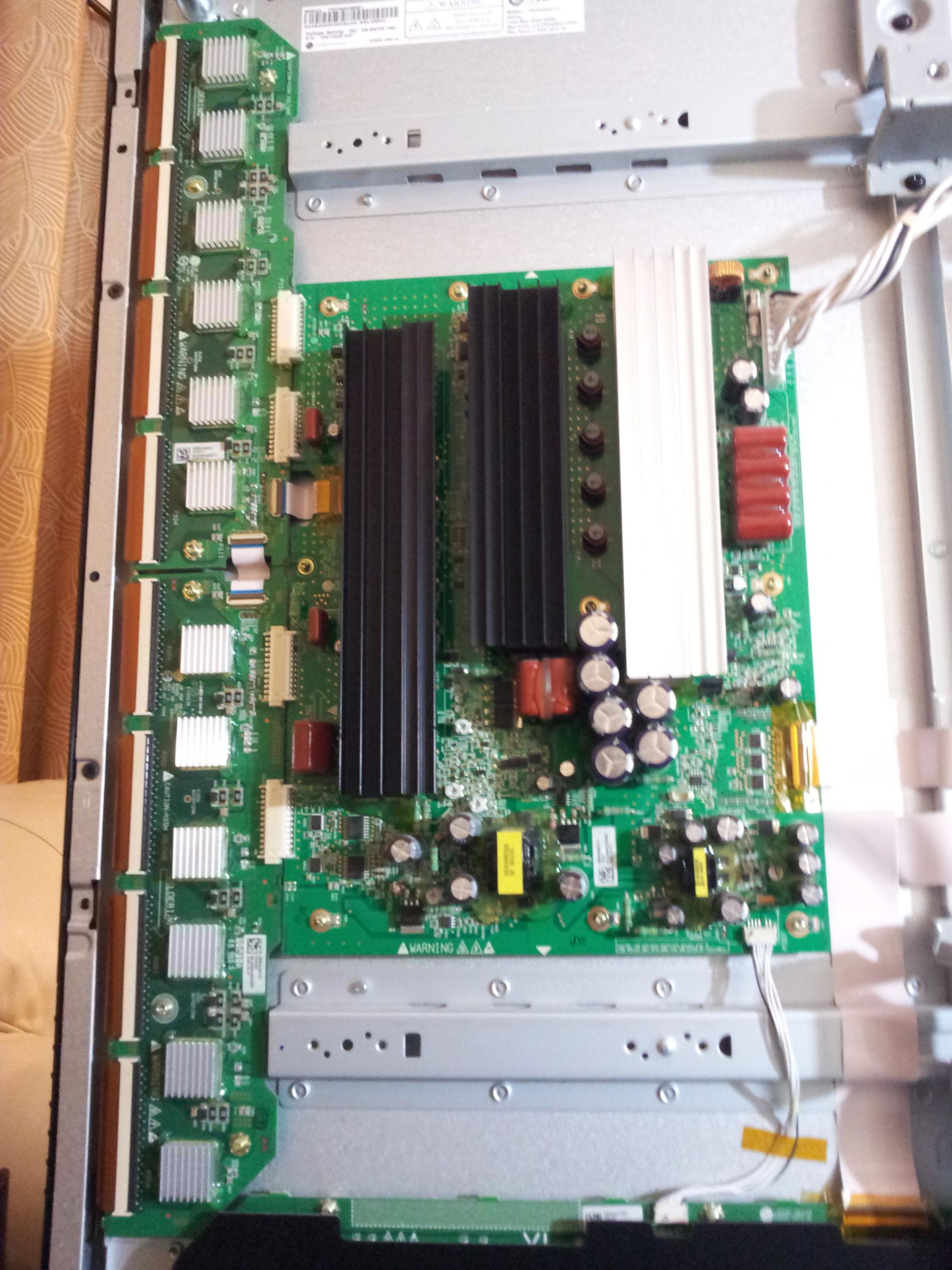

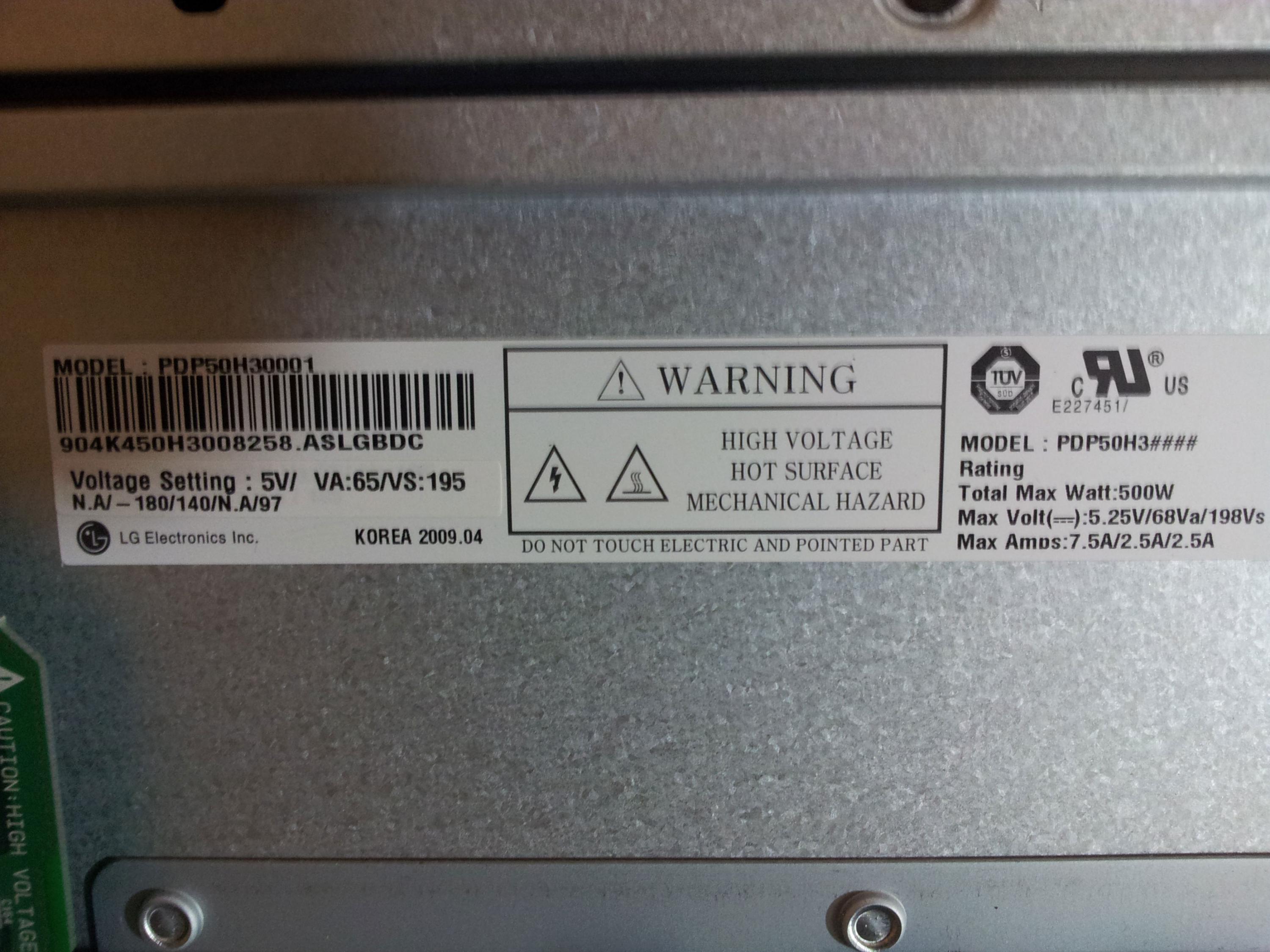

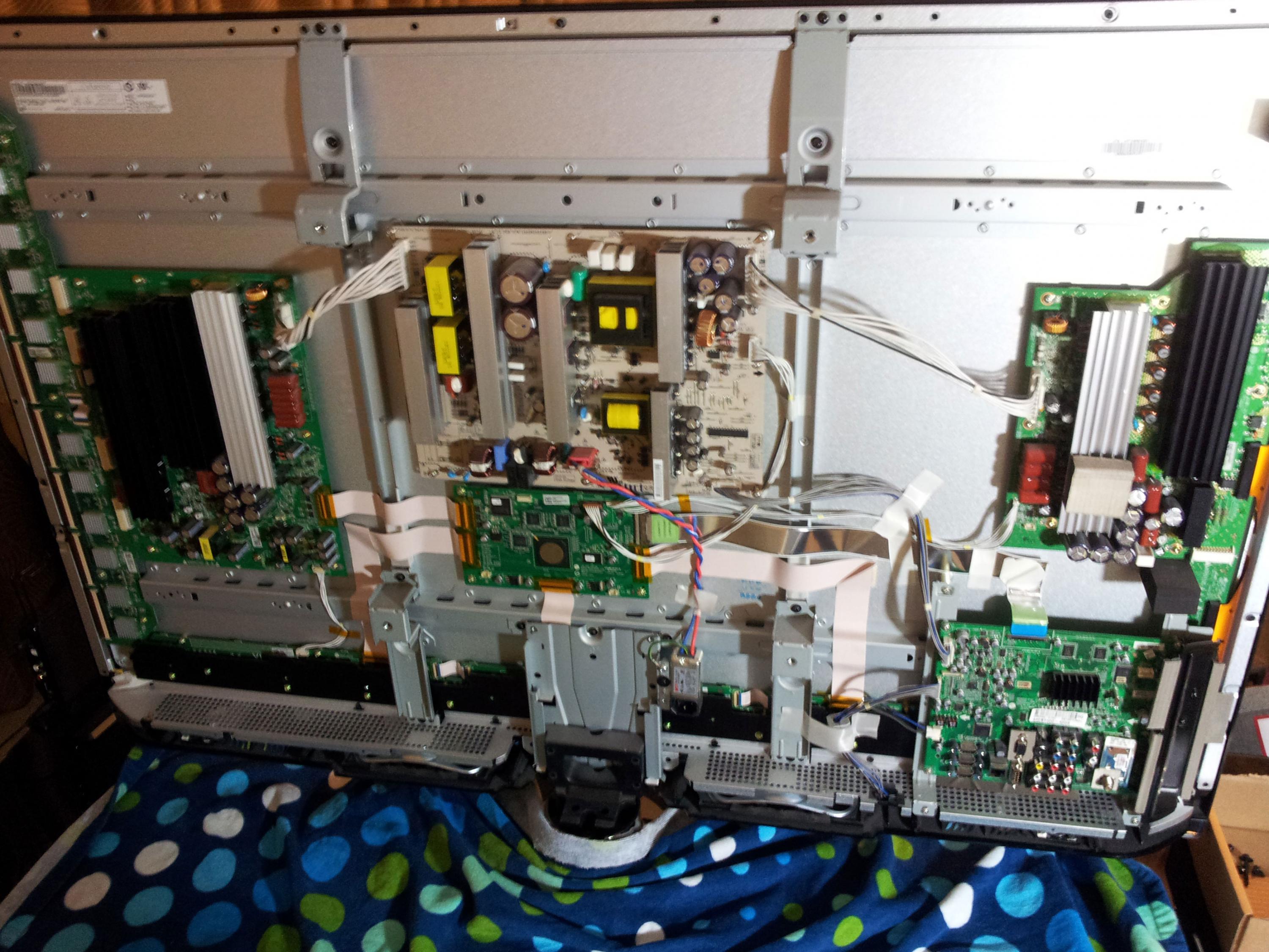

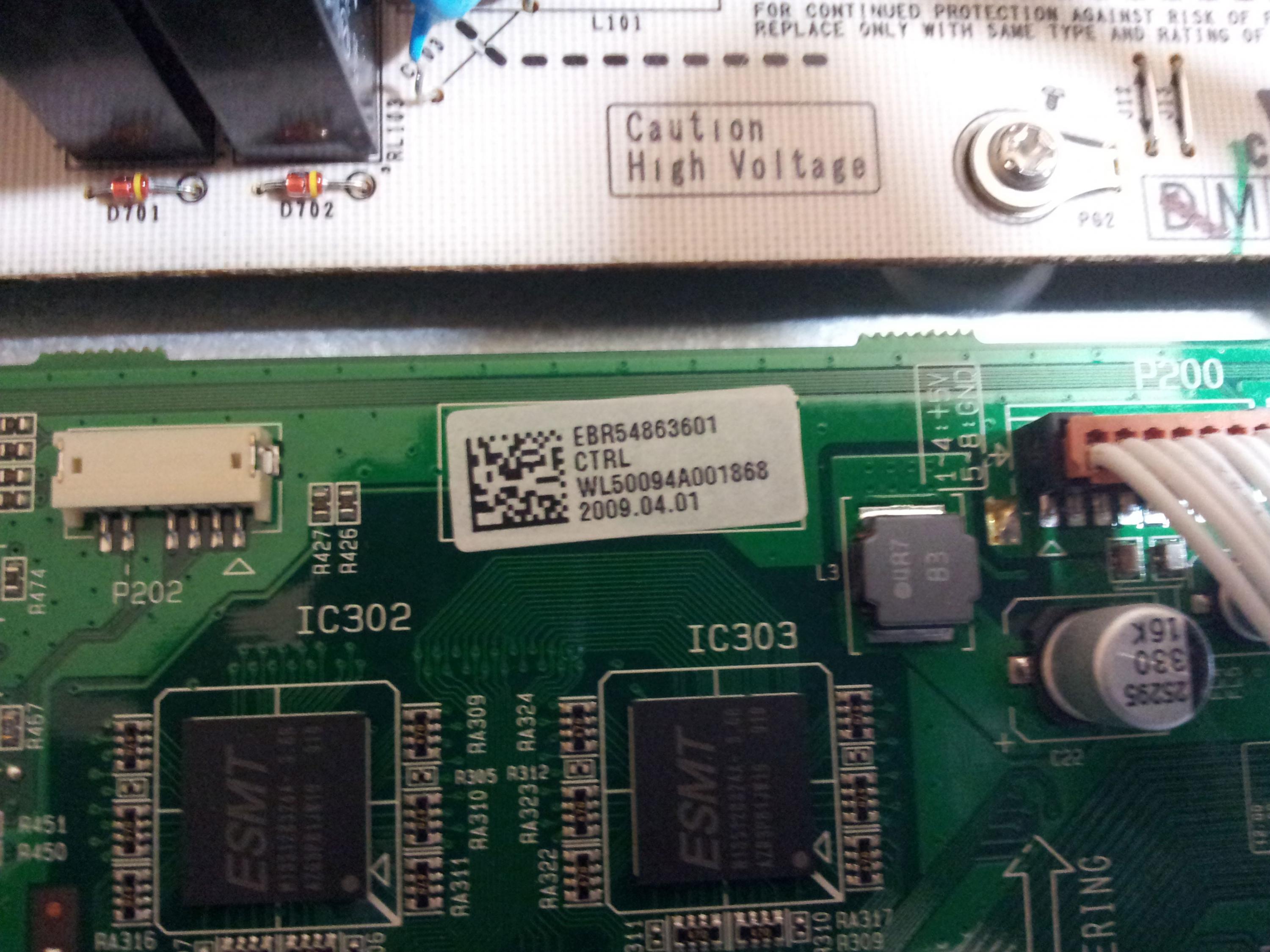

          And now for the guts: I located the logic board. Everything is nice and planted, cables are held in place with yellow tape. I reseated the cables and what I believed to be the LVDS cable, basically any cable that wasn't taped down. I powered up the panel and it gave me the same results. So now I'm uploading the photos and will wait for further tips. I might just try to locate that logic board online and purchase one. Let me know if I should be checking something else. I see that I can short pin 1 and 2 on "AUTOGEN" header on the logic board with LVDS cable unplugged according do a document I got off your website. looks like pin 1 is unmarked, but I presume it's from left end of the connector as is standard?
          Otherwise looks good inside - no puffed up caps, no burn marks.

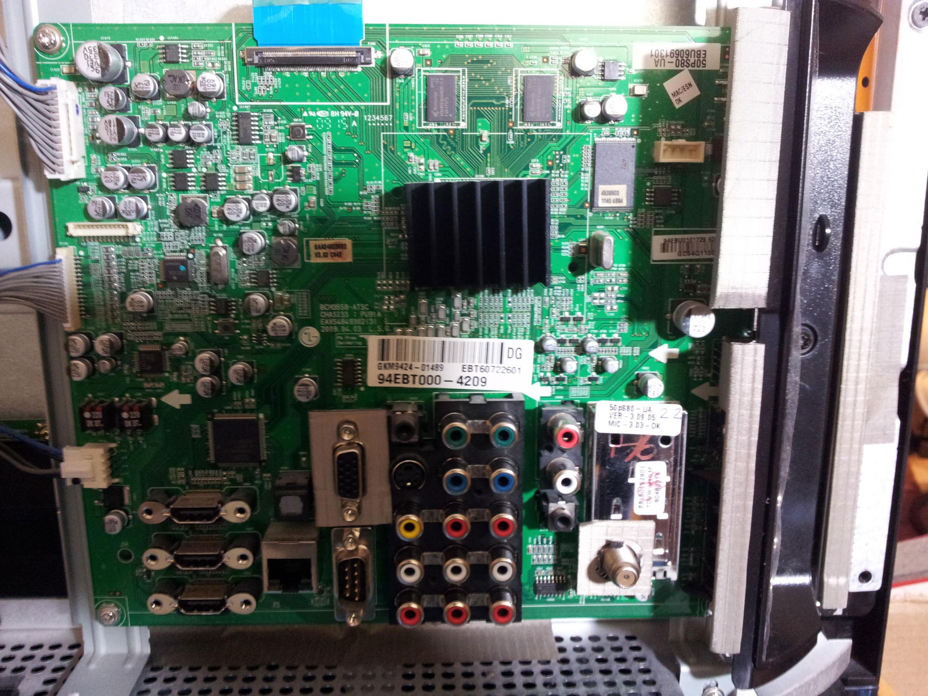

            So I just removed the LVDS cable between the logic board and the input board. I then jumped pin 1 and 2 on the logic board "AUTOGEN" and powered it up. The screen ran through it's sequence of test patterns and color charts/greyscale sweeps. Everything looked beautiful. I've never seen blacks so deep on this display and whites so crisp. Green and Red were flawless too. I let it loop 3 times. I never saw any issue with it. So at this point the logic board is OK and I need a new main board? Or do I have that wrong.
            Thanks for your help.
              Hah, looks like you found the issue. The main board, which is the board with the video inputs on it, is the problem child. (The control board is OK.) The control board will send unadulterated pure RGB to the display, with no colour correction. White is white, black is black. I'll bet the black didn't have green sparklies either?

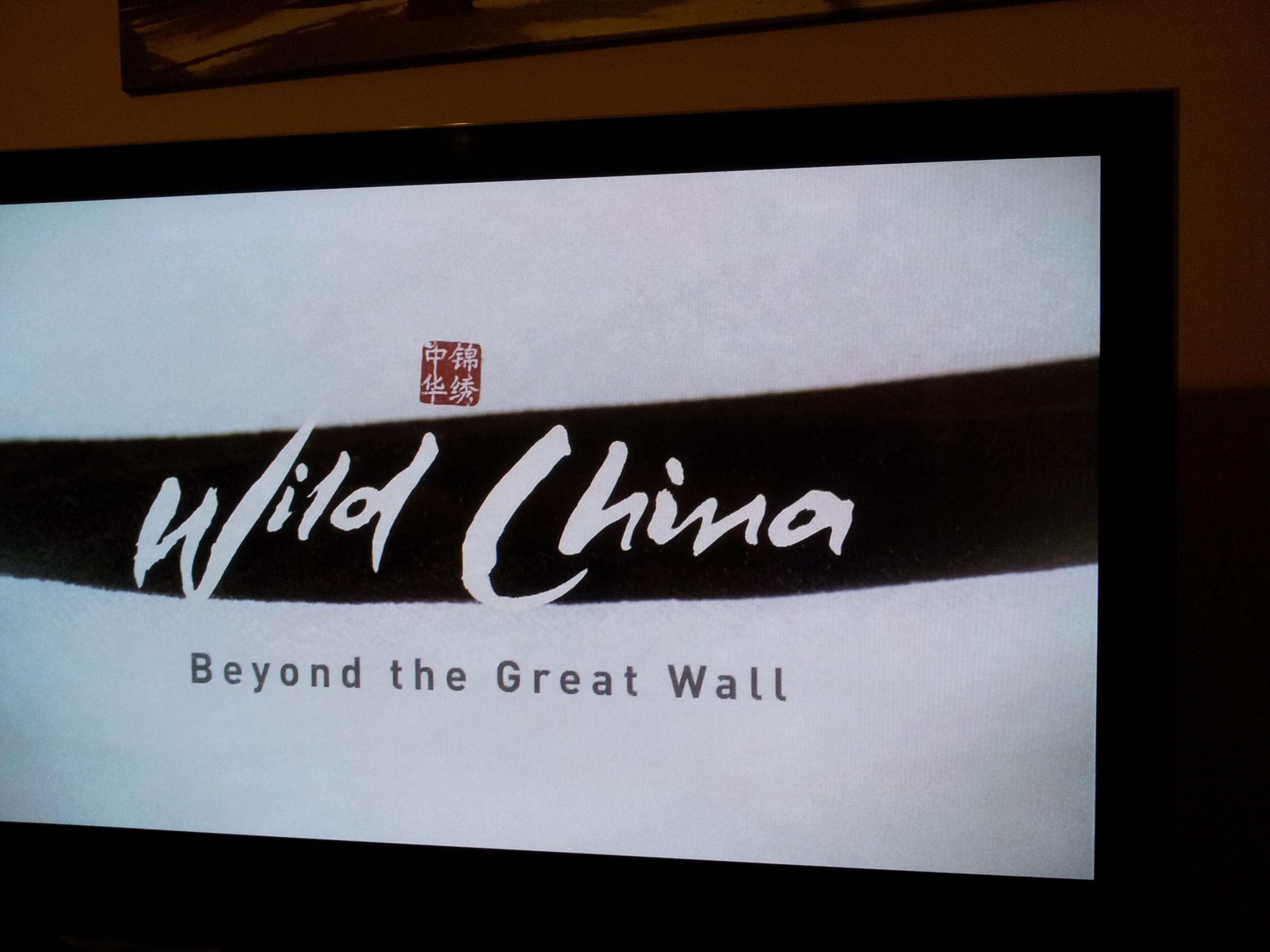

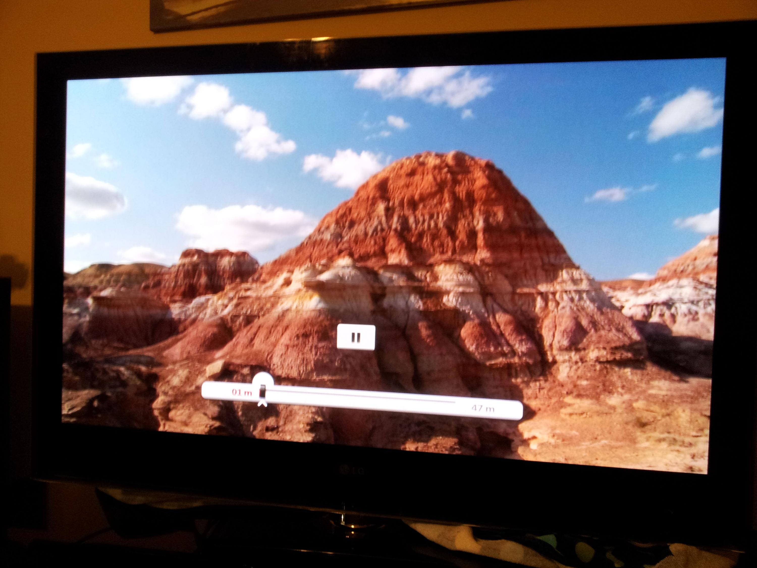

                That is correct Sir, the black was deep deep black with no moving green sparkles in it. Never seen it that black. White was clean white, color charts and sweep test patterns were all clean. RED was pure red, not pink. I'm ordering board # EBT60722601. I hope it's in working condition. Thanks for all of your help.
                  Probably on your old board the brightness was not set correctly -- just out of interest try turning that down, or the contrast down slightly on the old board before you replace that. (Won't fix the issue but will show if that is the cause.)

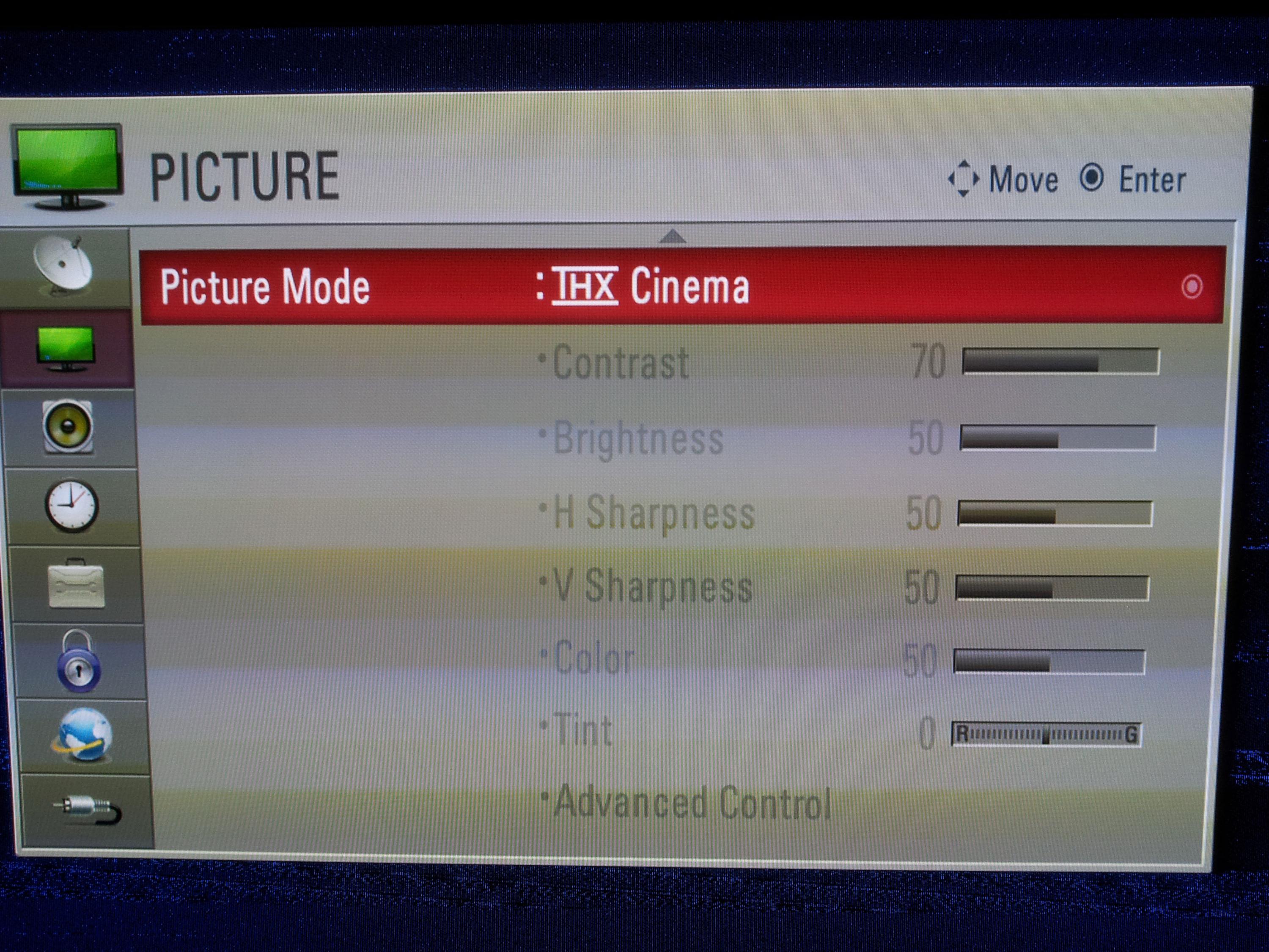

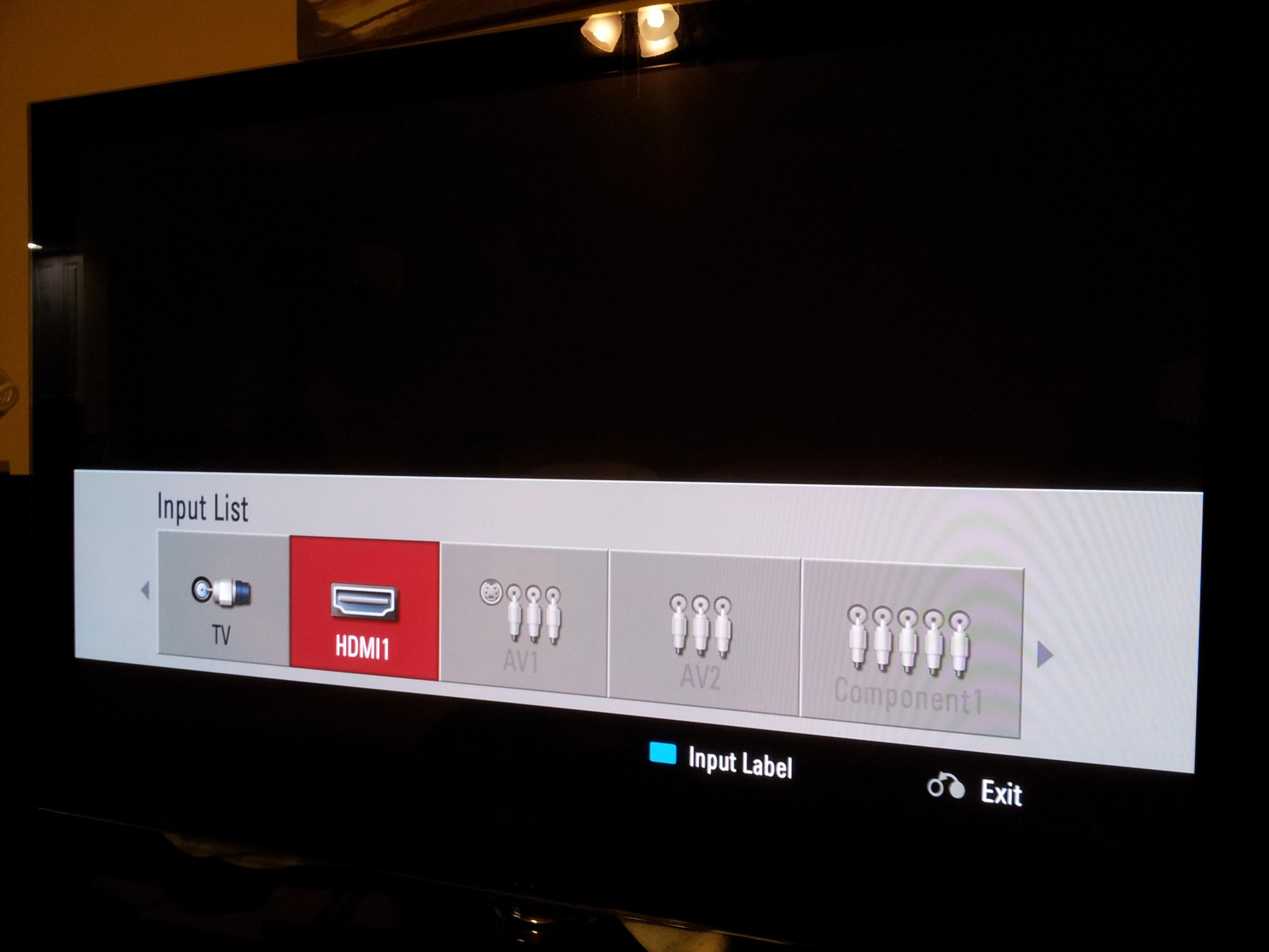

                        Good evening Tom, thanks for your reply, here is a snapshot of the current video settings for brightness/contrast etc. This is the setting I've been using since I got the TV new. Looks like contrast is 70, brightness at 50. I tried lowering the brightness and contrast. It made no difference where I set those settings. There was a subtle change in brightness/contrast but the array of blue dots was still burning strong. At this point I'm awaiting delivery of the new main board from CA. Should take a week unfortunately with snail mail. Photo is attached of the settings I've been using. Are they within spec? I don't think I was over-driving the display. It probably gets run about 40 hours a week or so. Mostly during football season. The white and grey banding that is seen in the photo is caused by my cell phone camera. It's having an issue with the screen refresh rate. It's not visible to the eye. -- As a side note, I rolled out my old Hitachi 42HDS52A plasma from storage. Nice TV, but it's only 1080i. It's from 2006 and has not been used in about 2 years. It's working fine right now, but as I was around behind the TV I hear a faint buzzing noise from the PSU board that fades in and out. Is that a sign of failing/dried up caps?
                        Cheers,
                          I was talking more of the green dots your set originally suffered from - typically lowering brightness to the point at which they go away works well. I can see the same effect on my Panasonic plasma when the brightness is too high though the dots are a mix of faint red and green.
                          It's normal to get a slight buzz from a plasma in operation that varies with picture intensity, so I wouldn't worry about it too much. The Hitachi is actually 1080p capable -- 1080i display but to the human eye that looks like 1080p. However, it lacks the correct amount of horizontal resolution, only 1024 pixels, making it equivalent to a 720p plasma released today.

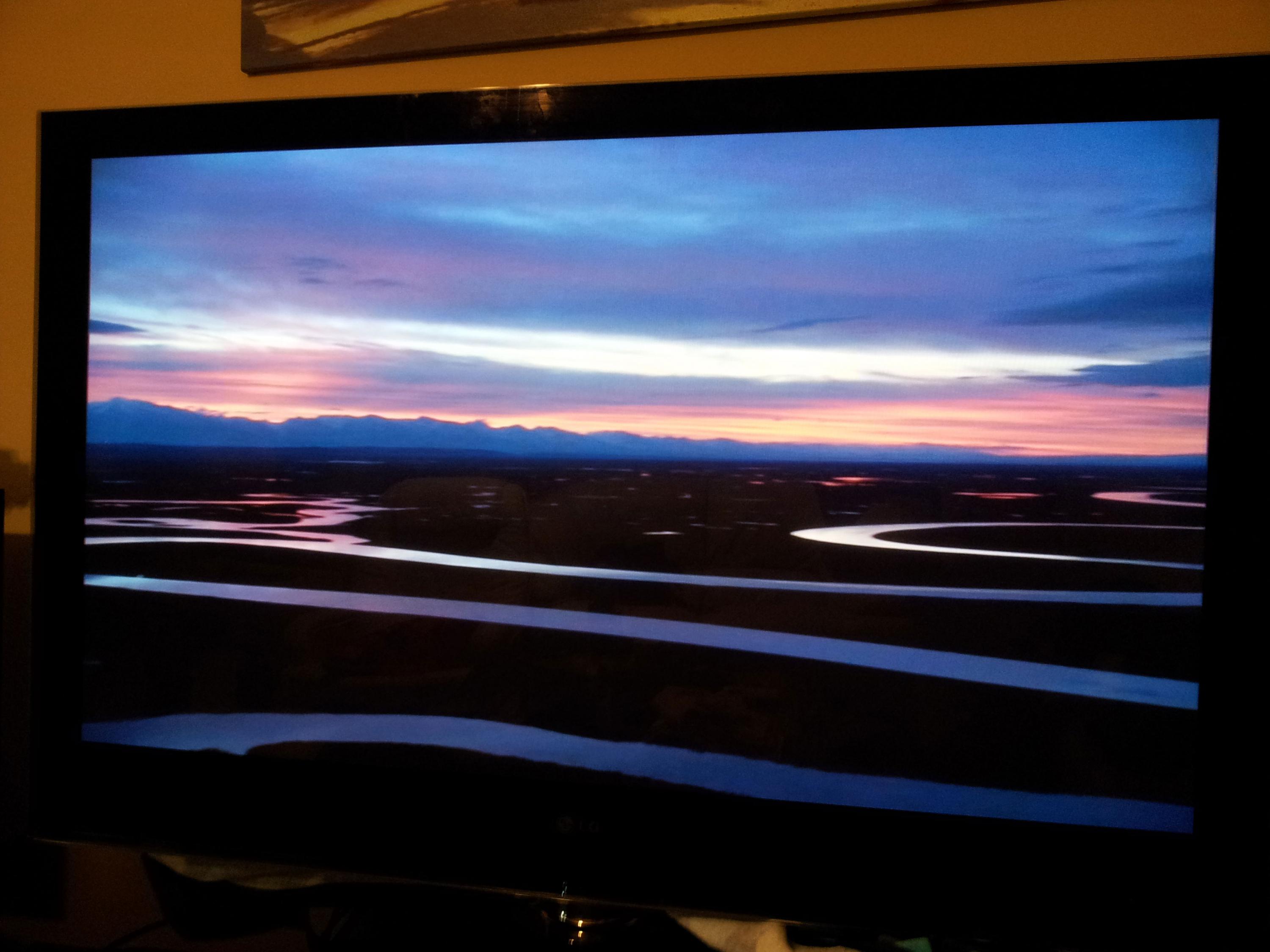

                              Well the new board arrived today, turned out they shipped it priority mail which is awesome. Just installed it. Seems to work fine, I'm in the process of testing all of the inputs, LAN connection, etc. Here are some Photos. There are no more green sparkles in the blacks, but now there are blue sparkles in the red areas if you are a few inches from the screen. Still it's a 100% improvement over the trippy blue dot mess I had in the beginning of this post. As you can see the blacks are very deep black and colors are vibrant. Please let me know if you notice any issues with the panel and/or new mainboard from the photos. The video is from the TVs built in Netflix so it's not Blu-ray quality, but still looks pretty good. Thanks again for your help. I Probably would have gone out and purchased a new LED-LCD tv without this forum and your input. Sadly it would have been a Samsung 7000 or 8000 series, but after reading your other posts It looks like I would have regretted that purchase based on the failures in under 4 years with Samsung LEDs. So your help was appreciated.
                                Slight "dithering" in solid colours is to be expected with all plasmas, it's due to how they work, however, you should not be able to see them at ordinary viewing distance. If you can't see it from ordinary viewing distance then it's OK.
