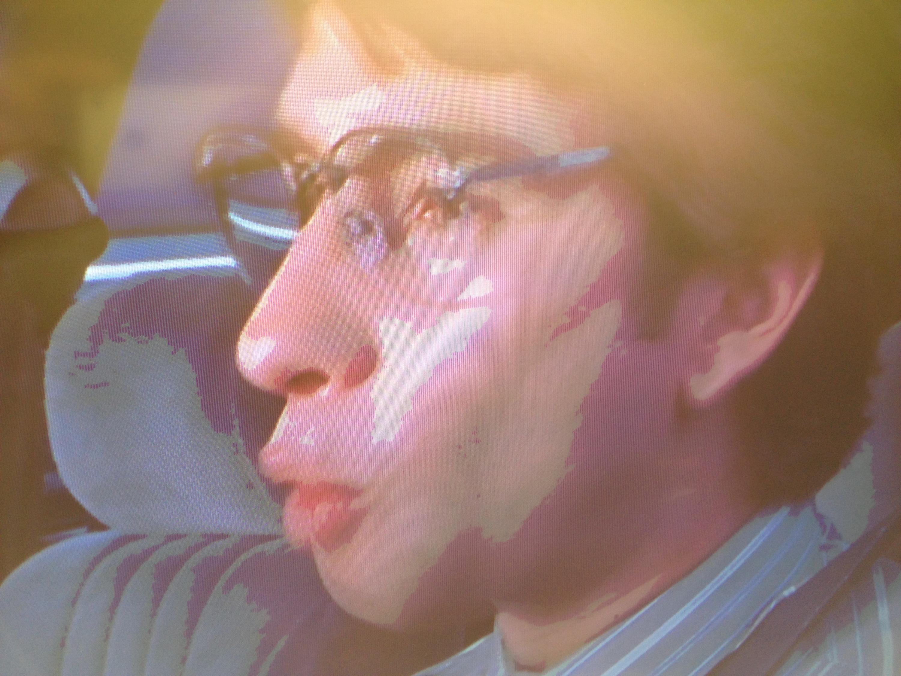

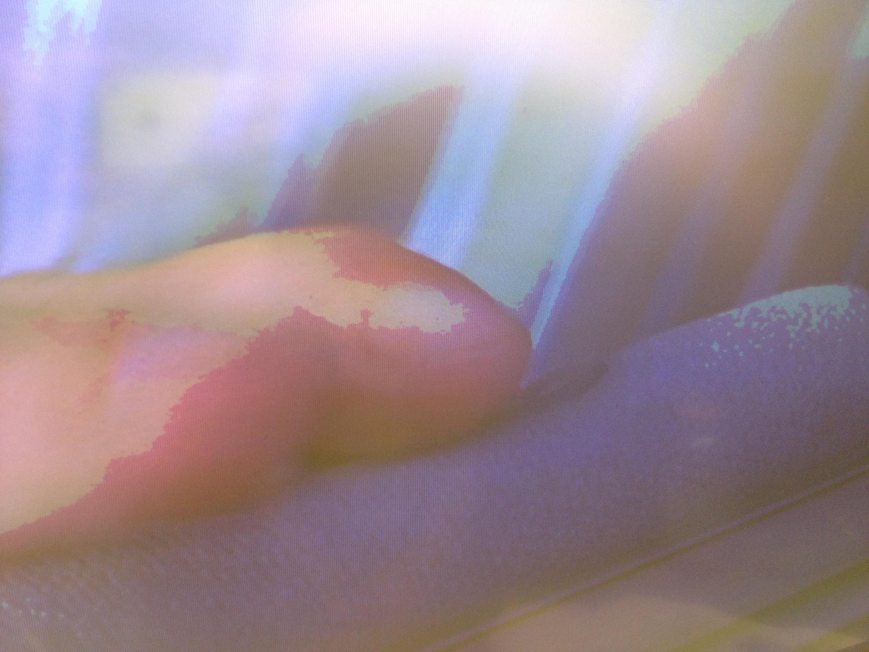

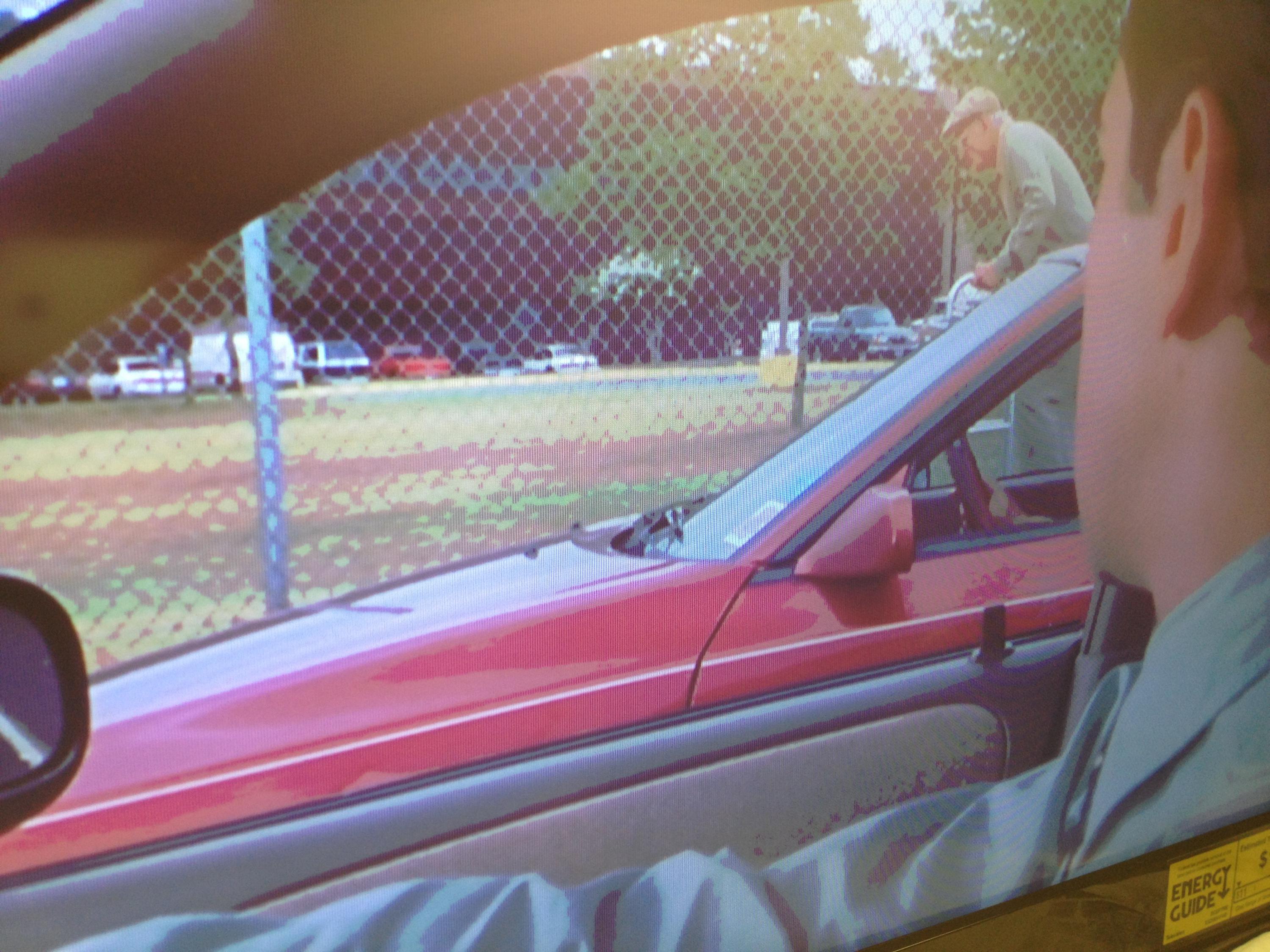

    Picked this set up with a bunch of others. Mostly broken screens but I bought them as a lot and got a couple that are fixable. This one was brand new and still has the stickers on it. Anyway, I'm pretty sure this looks like a T-con problem but thought I'd ask for a few more opinions. I wouldn't normally even buy one of these but it cost less than $10 so I figure I may as well try to repair it.
    As you can see in the pictures the colors get this kind of white, almost ghosting in the images. Especially lighter colors.
    Thanks as always,
    Aaron

    Oh, and if it makes any difference it's an AUO panel.
      Re: 32" Spectre -- T-con issue?
      Looks like solarisation - main board problem usually.
        Ah, ok. New term for me. I'll see how much the main board runs. Don't want to put much in to it but again for the price I paid its hard to go wrong.
        Thanks Tom
          Can just be wrong panel setting, see if you can get into a service menu.

            I guess : GAMMA IC on T-CON is NG.
            Check all the gamma voltages .
              It is unlikely to be gamma voltages because of how sharp the transitions are, when the gamma chip goes bad the transitions are still smooth.
                    So, turns out after trying a tcon and main that the problem was a bad ldvs cable. However, on to my next issue. After watching the TV for a few minutes I went to reconnect the ground cable from the power supply to the Tcon with the screw that goes into the power supply and managed to slip (tv was unplugged of course). Stored charge I suppose and the ground clip his a transitor and let out the magic smoke. Part number JCS2N60F. I only see them in China and was wondering if anyone knows where I can get one stateside. Feel like a real dumbass right now.
