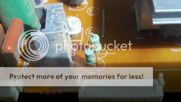

      Ok, I pulled all the boards. I checked all the transistors & diodes. I'm not sure what exact readings I'm looking for but they all read about the same, .500 in one or two directions & open on the others, with a few exceptions. The only thing that seemed usual is Q5304 the first transistor on the top right heat sink of the Y main read OL in all directions. Q5501 also from the Y main read (pin count from the top of the board, first number positive, second negative)1-2 OL, 1-3 1.8, 2-1 OL, 2-3 OL, 3-2 .580, 3-1.937. These readings were above everything else.
      This is on the Y main, it looks like it has been warm ( board is discolored on the top) but seemed to read ok.
      I cleaned some dirt of the back of the boards. and put it back together

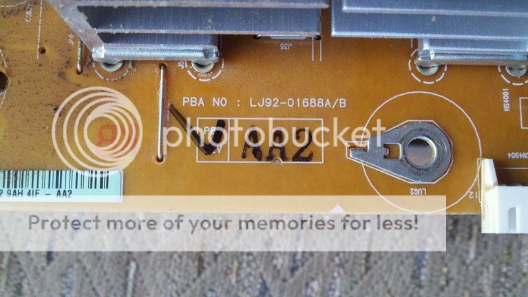

                              I've got new X & Y mains today. The X main numbers match exactly, the Y-main matches except for the PBA Rev. The old one is AA2, the new one is AA3. The Rev No matches R1.3. Will the new one work?
                                #35
                                Re: PN50B400P3D 50" Samsung Plasma Won't Turn On.
                                  #36
                                  That should be fine.
