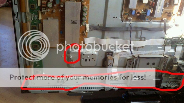

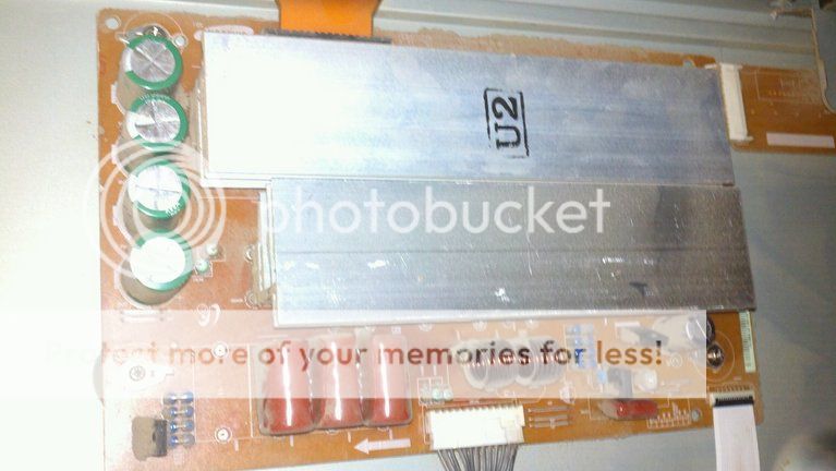

    Hello, This is my first tv repair project. I've done some research but nothing seems to match up with this issue. I bought this TV with the information that "It was working fine and then the picture went black but it has great sound". It came with no remote. I plugged it in, it goes "click click....*3secondpause* click click" with a constant red power light. I've tried tapping, "pushing", & "pushing" and holding the power button, no change. I've disconnected the power supply from the X main, Y Main, & both and and tried to turn it on & no change. I had a live RCA video and audio input while testing. No sound or video, just a solid red light. There looks to be no obvious bad, bulged capacitors. Here are pictures of the back of the tv, X, Y, power boards & my voltmeter. Whats the next step? If I need to get a reading, please tell me where to put the leads & what setting my meter should be on. Thanks.

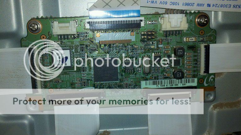

      Thanks capkid, I believe this is my control board (see below) I've identified the 4 pin connector & the pin's are labeled, I however do not know which cable is the LVDS cable? Mine does not appear to be the same as shown in that thread & the cables looks similar to my untrained eye.

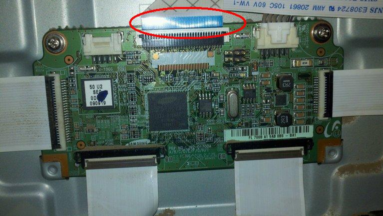

        Re: PN50B400P3D 50" Samsung Plasma Won't Turn On.
        The LVDS cable is the one at the top of the control board.
          Thanks! Below is how I tested it, with a live video feed & no change.

                  It's possible, but I highly doubt you have bad caps in this TV. A lot of these newer Samsungs are not known for having cap problems, since Samsungs were notorious for having bad caps in earlier models; they've since corrected a lot of those issues.
                  Did you try disconnecting the Y-buffer from the Y-main, leaving the Y-main and X-main connected to the power supply? Warning: When you go to reconnect the Y-main to the Y-buffer after this test, you need to monitor the voltages at the Y-main connector or you'll see a spark if the voltage is too high when you try to reconnect the two. I usually wait for the voltage to drop below 1V, or I discharge the caps on the Y-main. You can potentially cause damage if you don't wait for the voltage to drop.

                          Just to be certain, which one is the Y-buffer? There seems to be a buffer boar on the left side & on the bottom. The board on the bottom was un plugged when I got the tv, I plugged it in but no change. I unplugged it for the rest of my testing.
                          • capkid
                            • Oct 2010
                            • 1339
                            The Y-buffer is the long, vertical board on the far left when you're looking at the TV from the back. Which board specifically has been unplugged while you've been testing?
                              This is the board that has been unplugged. it runs the entire length of the TV on the bottom.
                                Ok, I don't think it will make much of a difference, but I'd plug it back in anyway.
