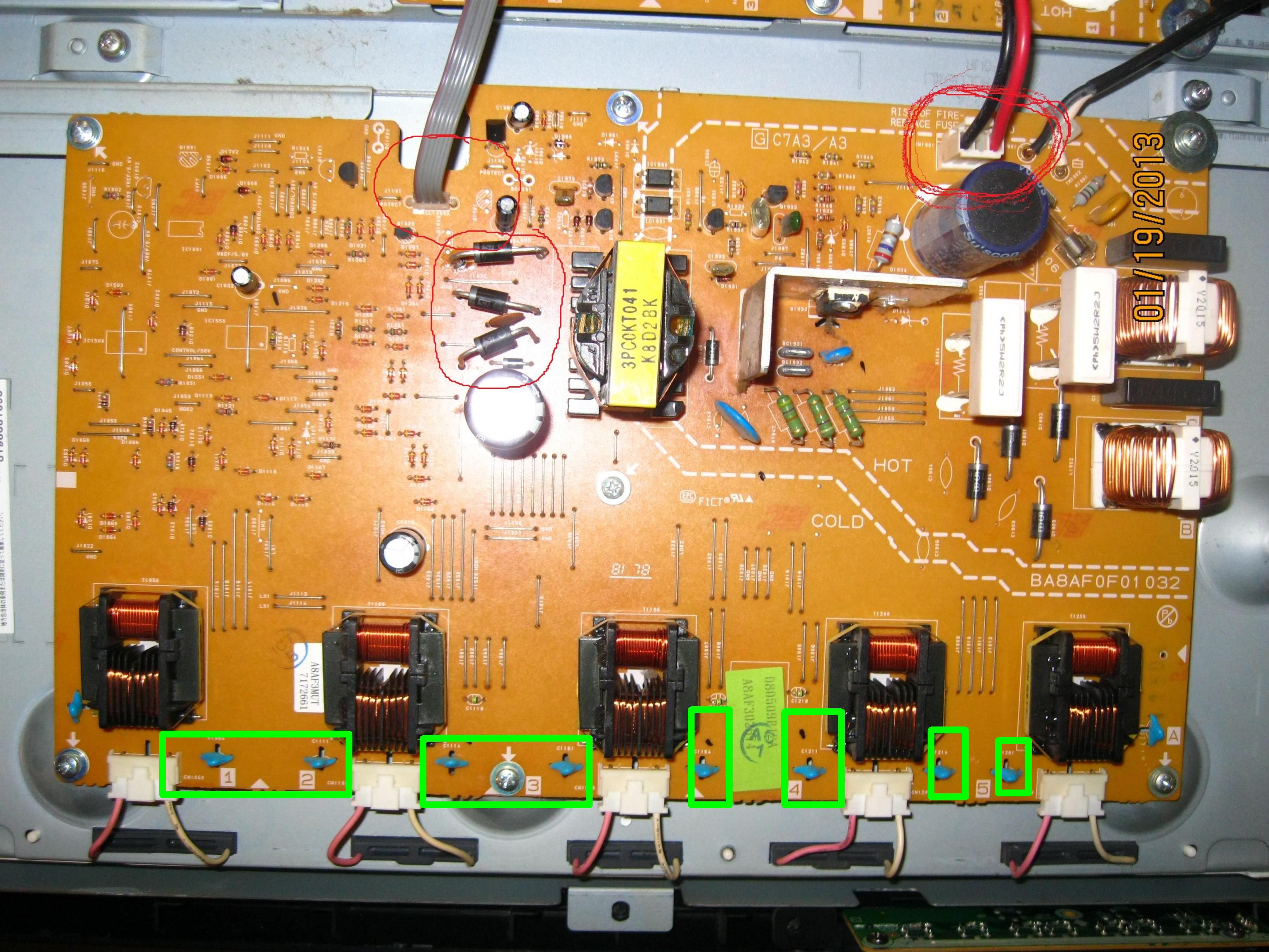

    Thanks to this forum I managed to fix this tv and thought I would share some info.
    This Tv would turn on for the 2 second to black syndrome which I have read
    on here several times. It would turn on the light would go on and I could see
    the screen say something like digital tv and then go black.
    After opening it up I found most everything was fine then I noticed a fine crack in a blue disc capacitor on the inverter part going to the light
    I replaced 15pf 6kv cap and now it works fine. I am including a borrowed pic from this forum and highlighted the caps in green the red circles are from a previous thread. I included the pic as a reminder not to skip the disc caps in diagnosing a problem because normally I assume that they are fine
  • alexanderz
    • Jan 2014
    Re: Emerson LC320EM8A 2 Sec to Black
    After reading this forum I took out the pcb and checked the blue caps across inverter trfr with a magnifying lens to find a hairline crack . I replaced the cap and is working fine. Thank you .This forum is very helpful . Thanks for all the good hearts. Keep it up
