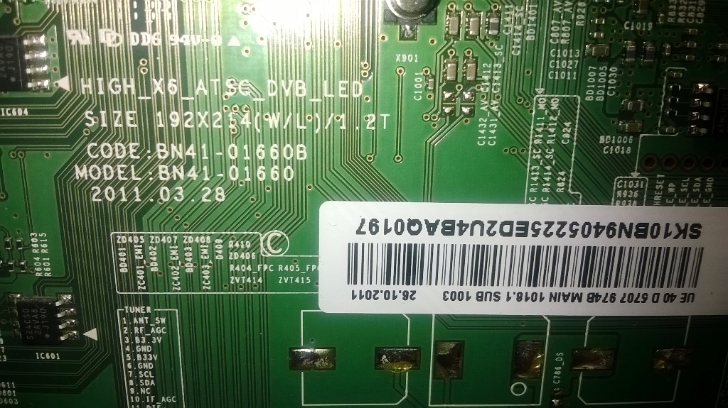

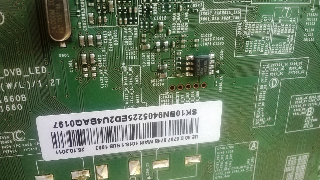

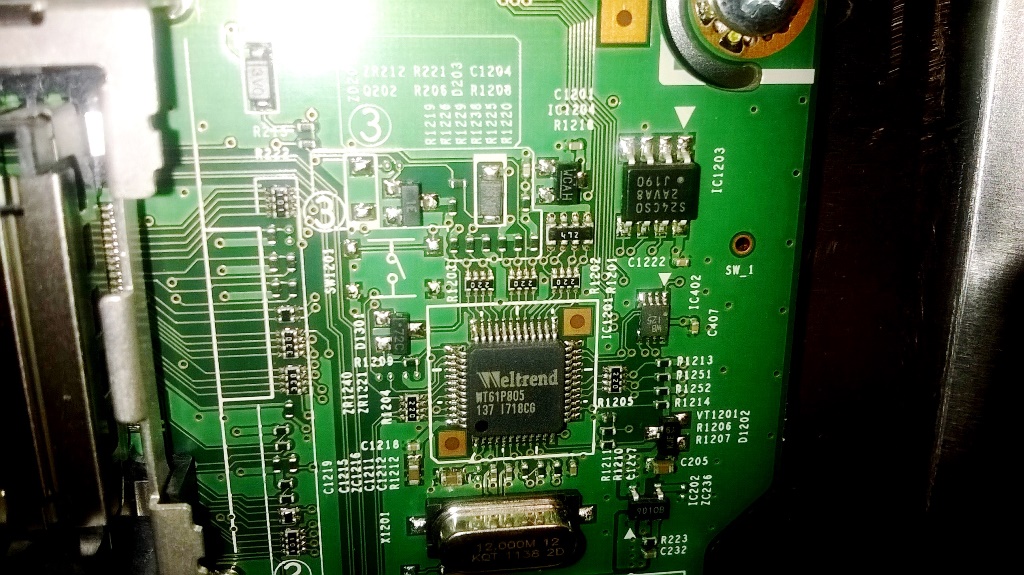

                            I think i have this case with my Samsun LED TV, long story. Anyway please some help needed what I have to check or do next..
                            Rear panel paper sticker
                            Model code: UE40D5707RKXXE
                            Version No: 06
                            S / N: Z8WA3SGBA00379W
                            Mainboard paper label and markings on the motherboard:
                            UE 40 D 5707 974B MAIN 1018.1 SUB1003
                            SK10BN9405225ED2U4BAQ0197
                            HIGH_X6_ATSC_DVB_LED
                            Code: BN41-01660B
                            Model: BN41-01660
                            I am a 60 years old unemployed electrician (radio amateur) and very interested in electronics and all kinds of gadgets repairing learning and hobby. Now I'm trying to familiarize themselves with LCD and LED
                            repair televisions. Catalysts exchanges PSU unit is a familiar thing to do and the same T-con controller bad connections, I even changed one AS15 district successfully T-con card.
                            Now came the Samsung 40 "LED TV on a more challenging problem when the TV went crazy for manual USB update After. I pressed Micom upgrade and thereafter became the wait .. I pulled the plug out, because nothing happened even though I waited for approx. 5-10 minutes. After this trick the TV is completely silent and not even the red LED on the front panel no longer shine. I can not get service menu any more info + menu + Mute + power combination. All voltage is OK, backlights are OK (tested by disconnect the motherboard to PSU cable). All hardware is ok but eeprom routines not.
                            I googled that wonderful measure would not be in any case got to do, because it violates the TV. One of the familiar TV-serviceman told that the same problem occur when PSU is broken then the eeprom can go haywire and the motherboard needs to be replaced. This has happened in at least some often some Samsung models.
                            1. Is there any possibility to get the TV back to life without replacing the entire motherboard? SamyGo site has a lot of story that Micom eeprom
                            can be restored back to life using a some procedure with Arduino
                            Ethernet Shield W5100 Network Expansion Board is.
                            This is very complicated to understand, especially when I do not know with certainty what EEPROM is it correct one to trying to revive and not necessarily even enough skills such a thing. I have any service manual is available. I suppose, however, that the correct IC circuit is IC901: ATMLH136 2ECL which adjoins the main logic board is ready for pads HRESET, WP, SCL, SDA, and GND, Am I any right track? Another possible the IC circuit is IC1203 S24CSO which is close to the picture Weltrend circuit and it can also be mixed or then those two.
                            2. Is there available service manual or some shematics for my case any sites?
                            4. What is the significance of the SW 1201 switches on the motherboard near the Weltrend IC circuit? The switch interval is now open. Can I try too close this pads manually?
                            5. Is it good idea to replace both ATMLH136 2ECL and S24CSO eeproms by new ones?
                            6. How to reset these eeproms right way? There is two different method in the SamyGo sites. Close to at start pins 5 and 6 and another is some grounding same pins one by one or connect 3.3v same pins.
                            7. I measure both eeproms voltages and they are similar result. Pins 1,2,3 and 4 are 0,0V and pins 5,6,7,8 are 3,3V at both eeproms when I plug AC ON. Is that marking somthing good or bad?
                            I would be very grateful if you could somehow help in this matter
