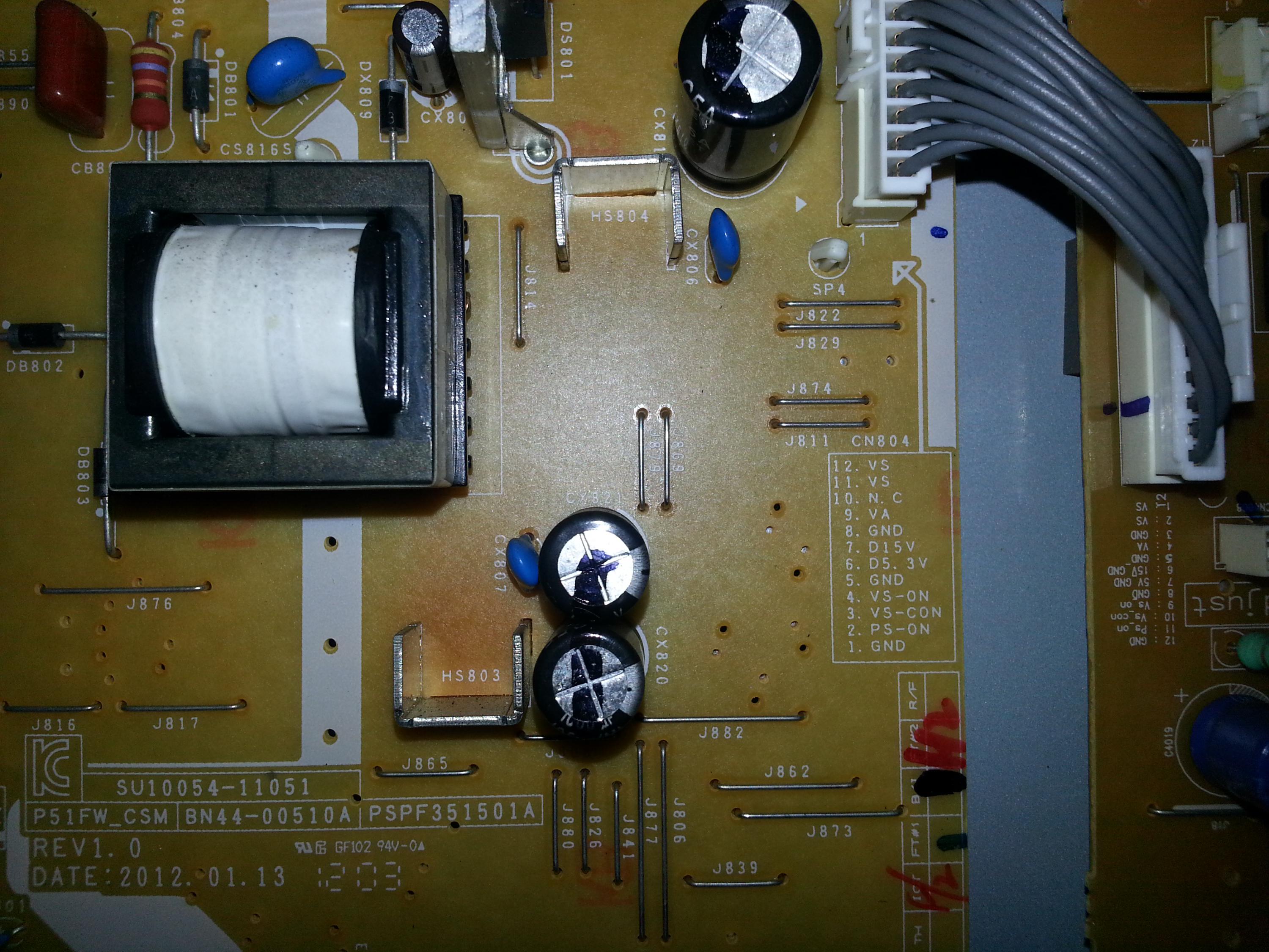

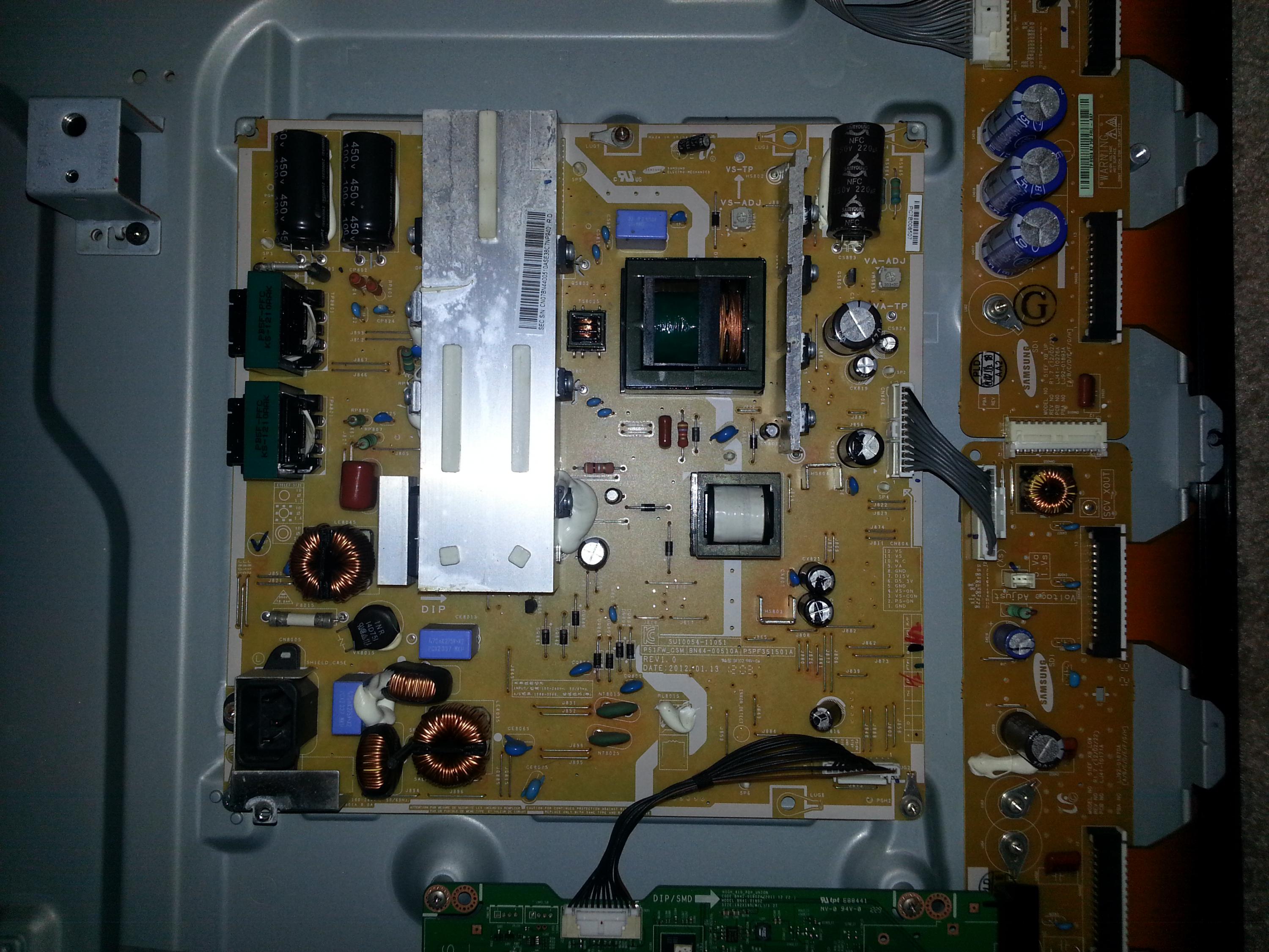

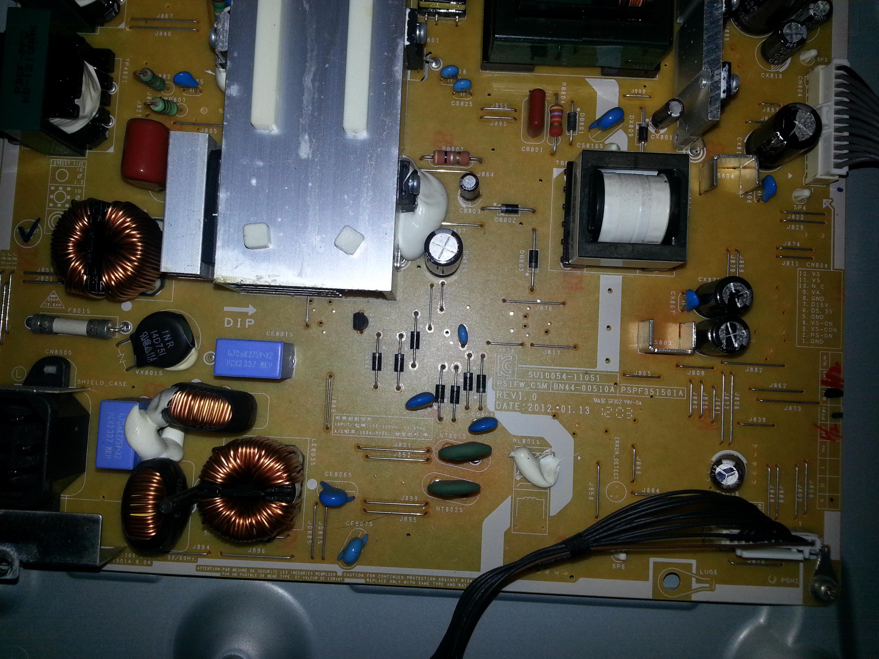

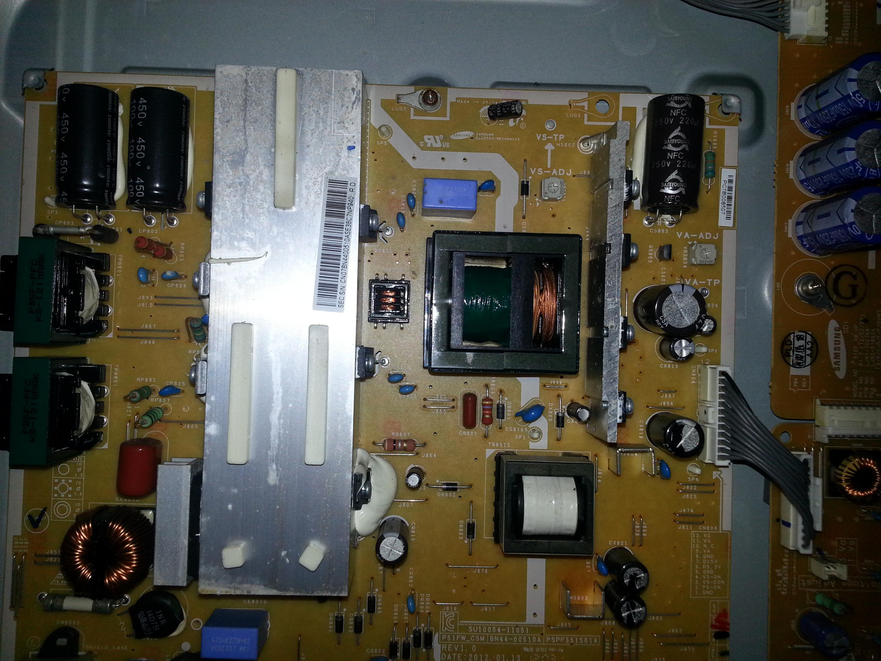

              Re: PN51E550 dark cloud, poor image and flickering brightness (with videos)
              Thanks for all the suggestions
              I dont know where to test the Volts at. I dont see on the board test spots. Tried doing a google search but nothing is standing out.
              I popped the back off and everything 'look' solid. No smoke res, no blown caps, board looks 90% clean.
              video of the whole tv: https://www.youtube.com/watch?v=IttF...e_gdata_player
              pics of the power board
                VS and VA test points are labeled on the power supply as "VS-TP" and "VA-TP" - see the right-hand side of your second pic. VSC (VSCAN) and VE are highlighted in the attached pic. To test VE, place the negative probe on one lead of the capacitor and the positive probe on the other capacitor lead.
