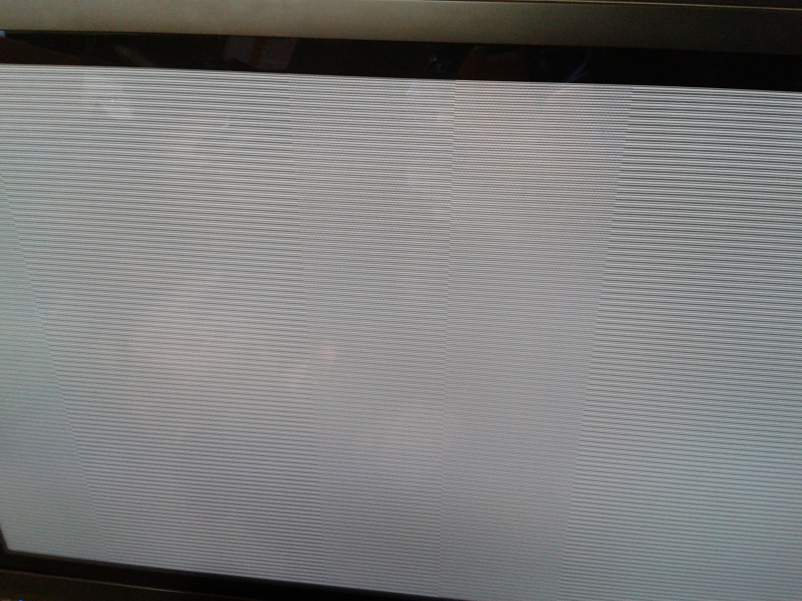

    I purchased this tv off craigslist not working, the guy had already tried to "fix" it so the main board was already out of the tv. I put the board back in and tried the tv. The tv tried to power on but sounded like it was going into protection mode and shutting off, nothing came up on the screen. There was a place on the main board where some of the surface mount IC's looked like they had experienced a failure so I bought another SSB board and plugged it in. Now I am getting the tv to power on and stay on but as it is starting up I hear a loud pop in the speakers and then the screen comes on. The screen only shows this white and black maze of sorts. I attempted the diverstiy code instructions that you are supposed to perform when changing the SSB board and it seemed like it accepted the code as it turned off when I punched in the code and then I tried to turn it back on but it is the same screen. Sometimes that screen even goes on and off from black to white/black maze. I am attaching a picture. Am I just not doing something right or are there other issues I still need to resolve?

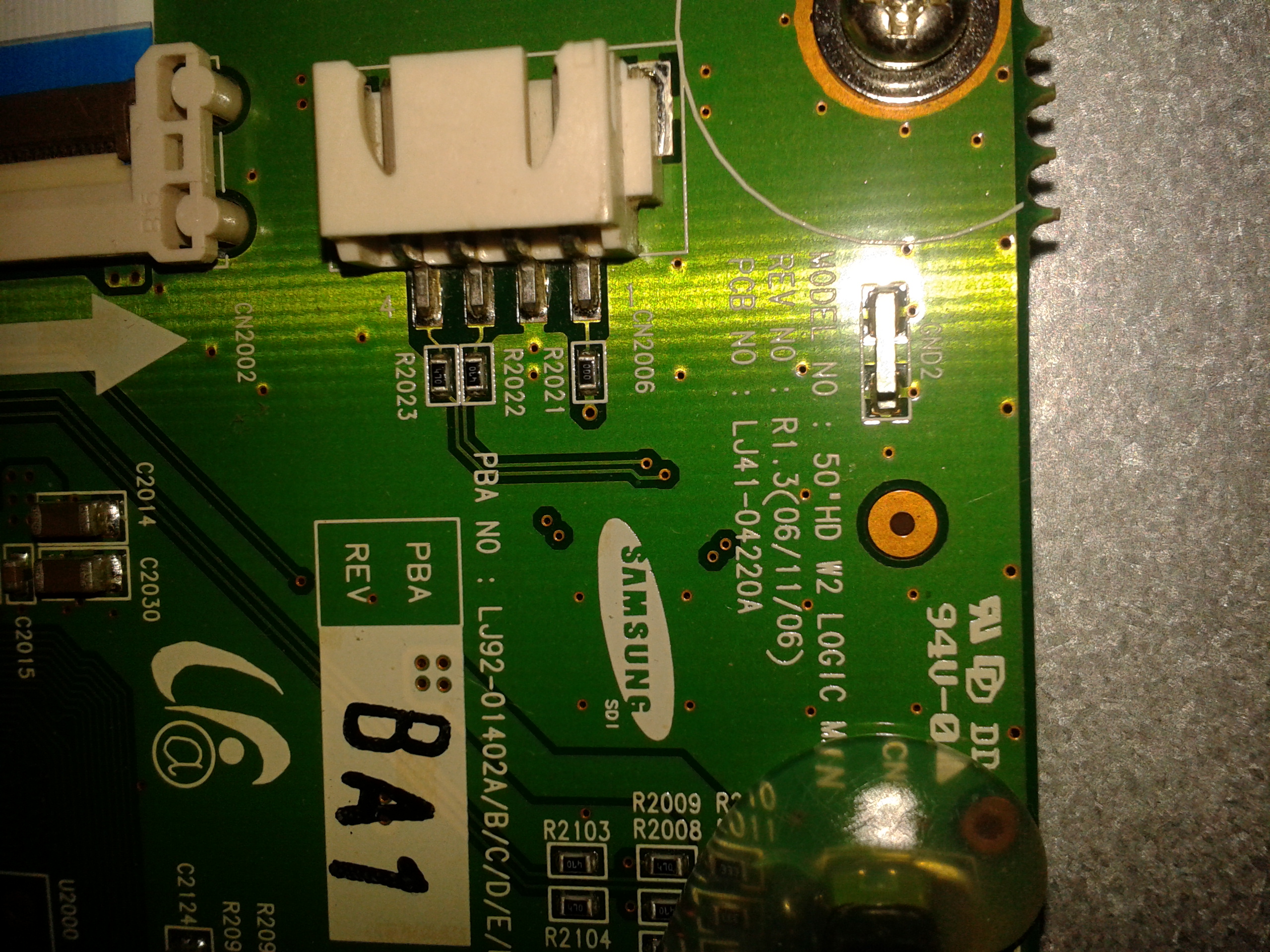

    Does this TV use LG or Samsung plasma module?
    If Samsung follow these instructions to see if your control board is bad:

      Re: 50PFP5332D/37 Phillips Plasma Weird Screen Display
      I believe this is a samsung panel. I will try your instructions to see if I can get the test patterns.

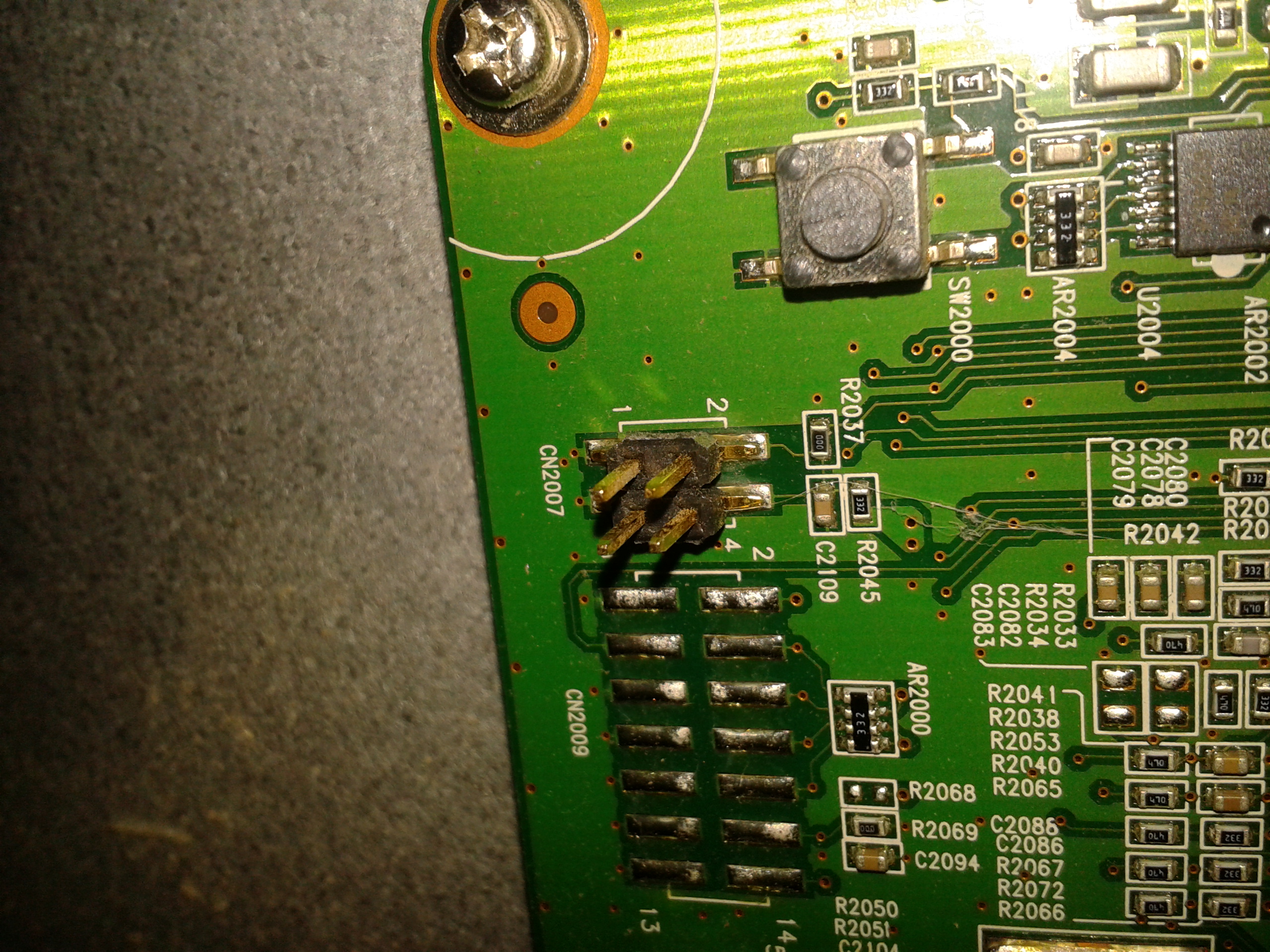

          I took the LVDS cable off and put a jumper on pins 3 and 4 but no test patterns. Is my assumption a bad Tcon board then?
            Not necessarily; this is an older panel, and the test pattern mode may be different. Can I see the connector you did the jumper on?
              See attached pics...put it on 3 and 4
                Any idea what the push button switch next the pins in the picutre does?
                  Does the push button switch modes or anything?
                    I don't know what the button does.
                    That looks like a normal control board test pattern connector. But try all four pin combinations to be sure. Pin 2-4 may do it on this connector.

                      The Y-Sus or X-Sus should play a factor is this should they? Are there any other boards that would cause such a screen? What are the buffer boards on the bottom do? If you look close there are patterns in like different 1/4 sections of the screens.
                        The only boards that could cause this are the main board and the control board, the control board being the most likely.
