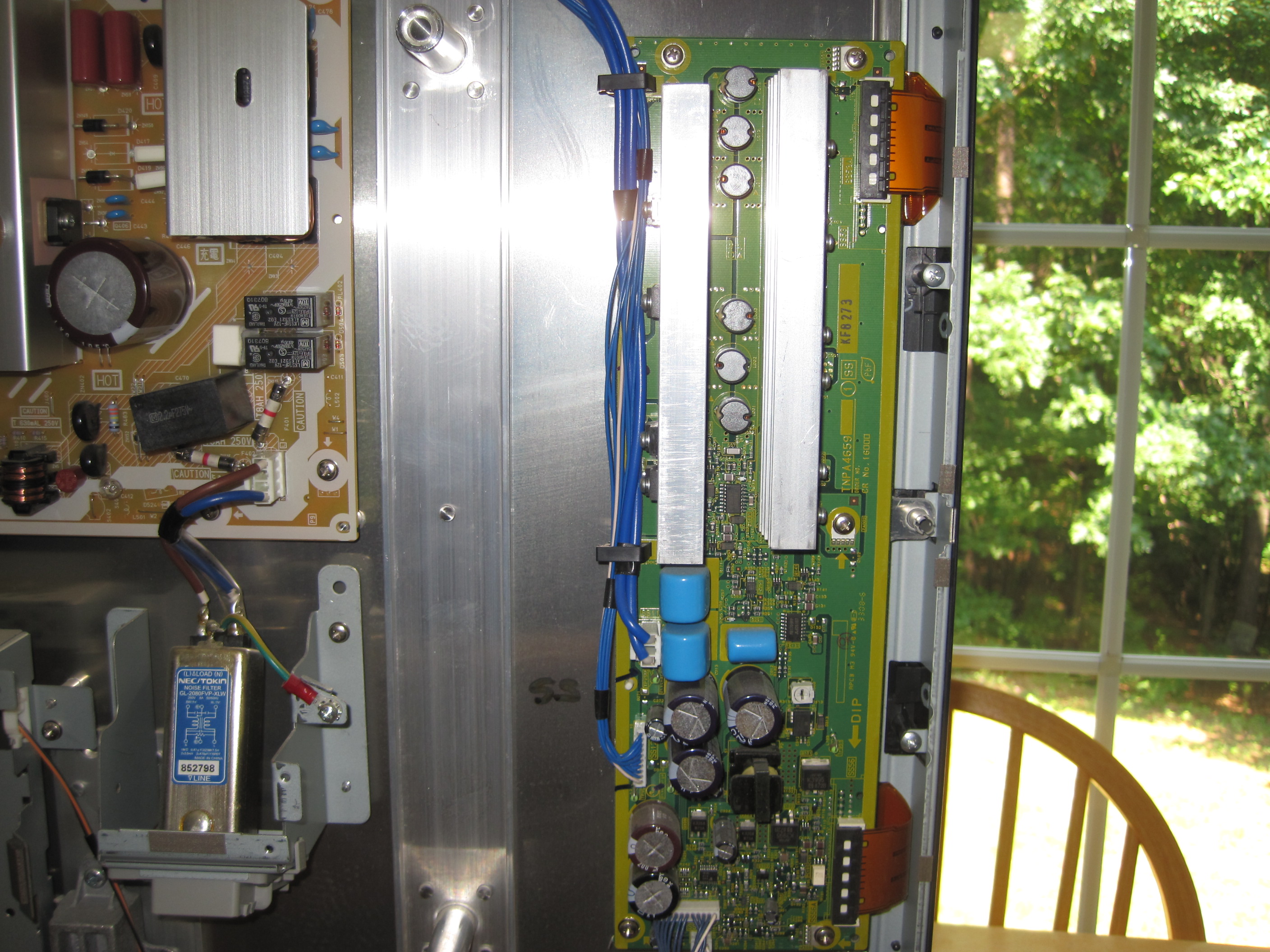

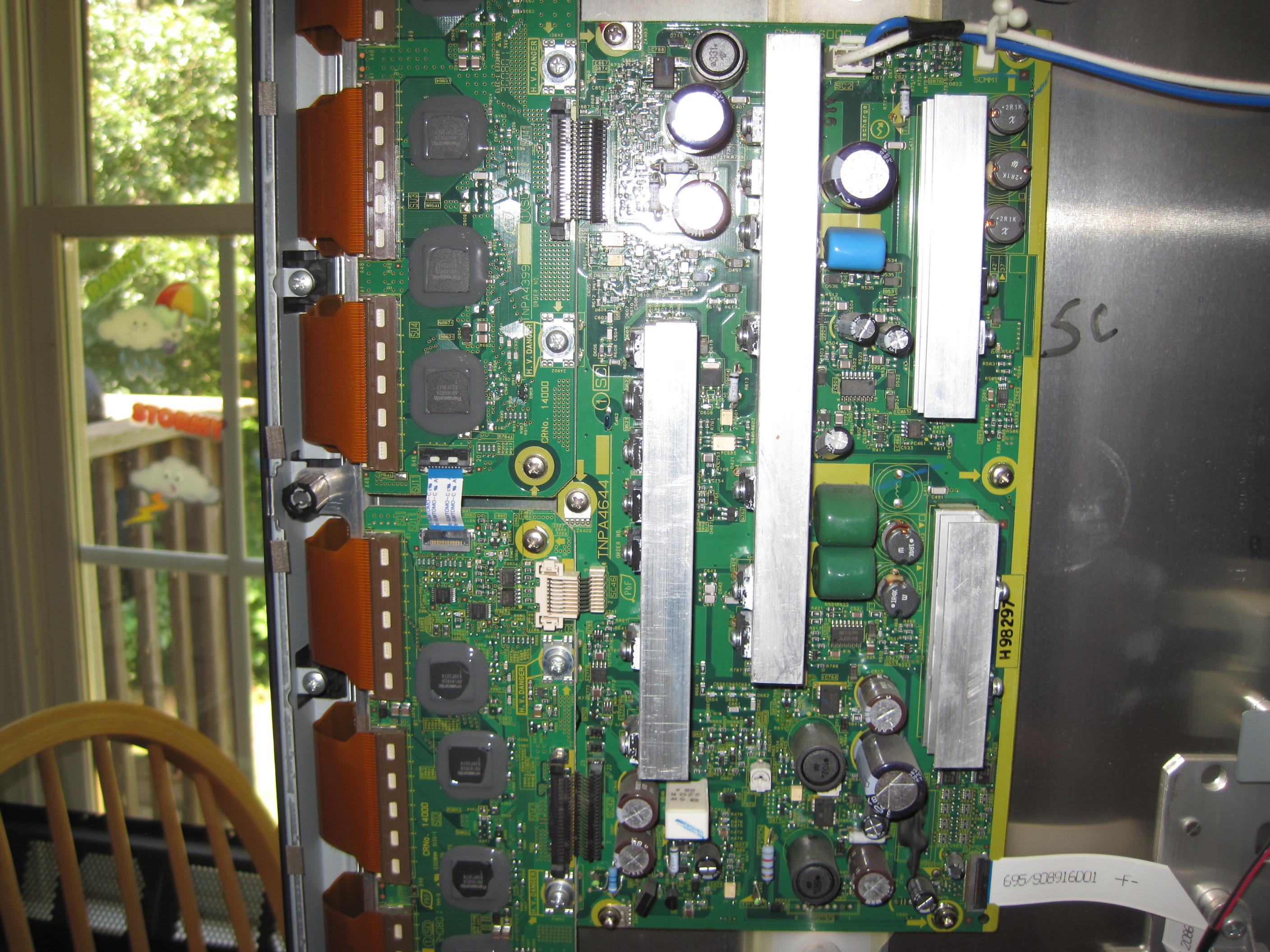

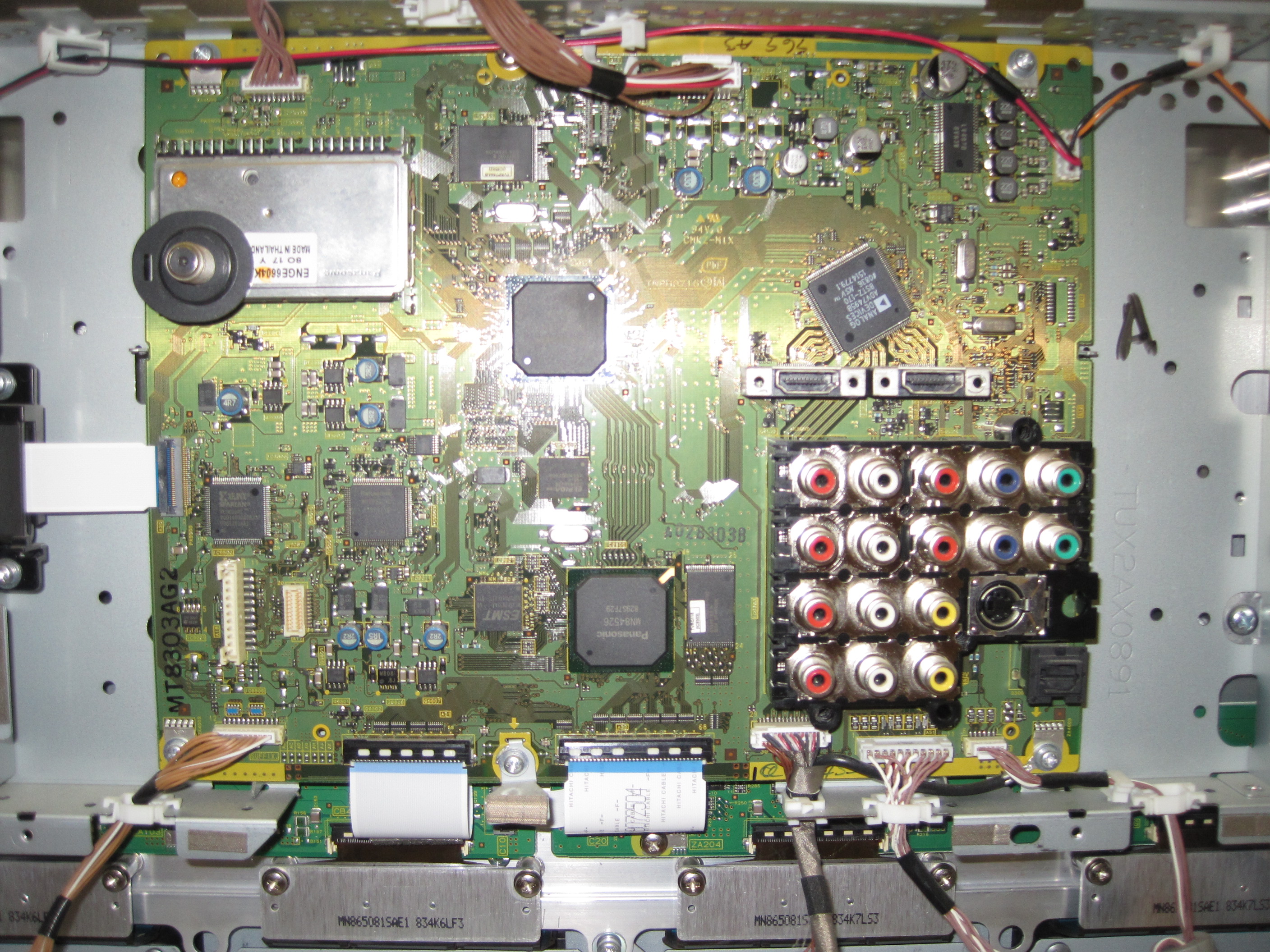

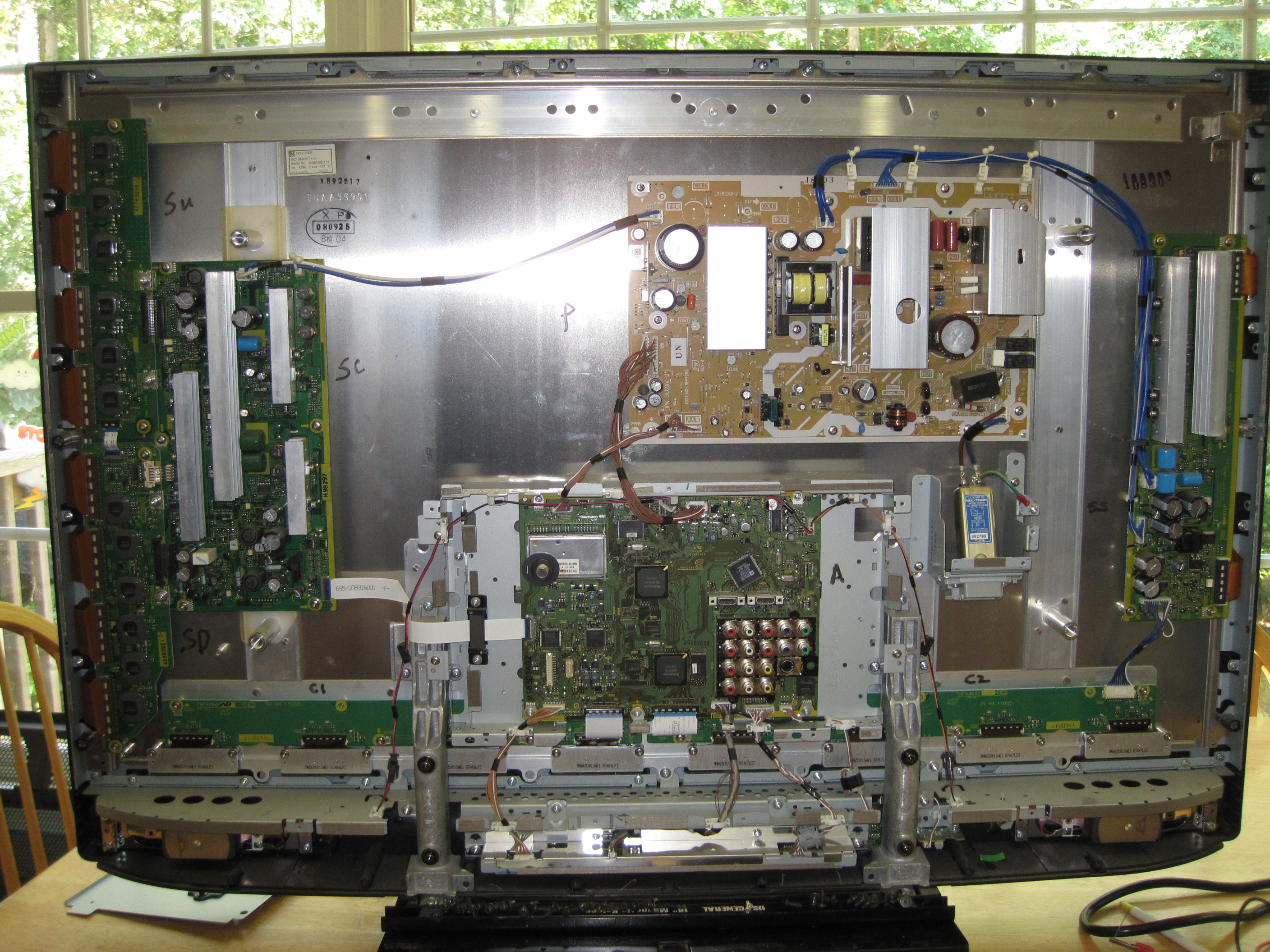

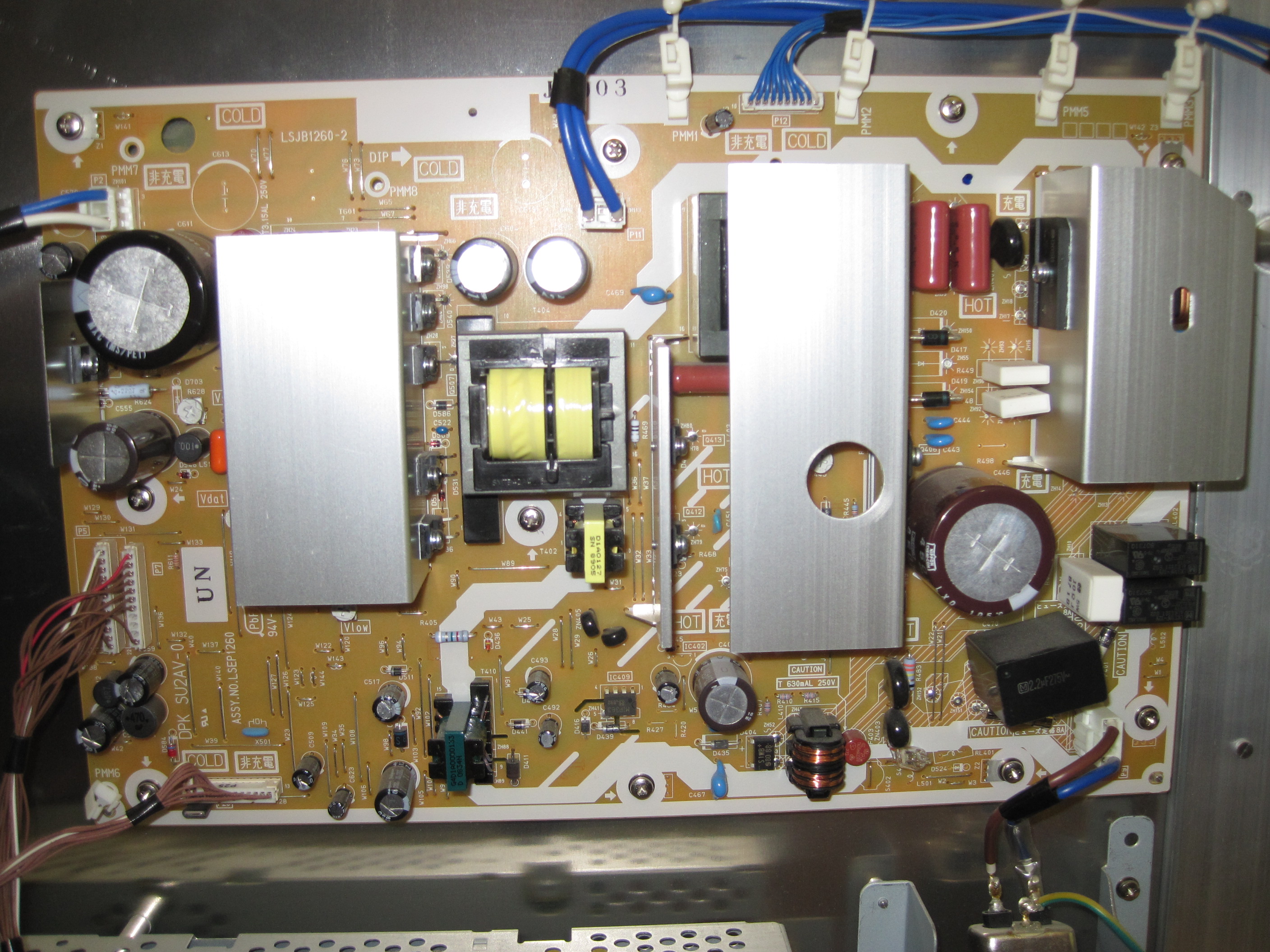

    Panasonic Plasma 42" no audio no video. Dated November 2008, Model#TH42PX80U. When A/C is connected the relays click and the red led on lower right corner of “A” board goes on and after a few seconds relay again clicks and red led goes out. When front on/off button is depressed relays click and green leds on SS and SC boards go on, front screen slightly lightens and and front red led goes on. Front red led does not blink. Afterwords, about every 10 minutes the relays will clink with no change--no audio/video. To stop clinking TV must be unplugged. I downloaded the service manual from http://www.toms-service-manuals.com/index.php. I checked the voltages and all appear good/within +.3 to +.4v except as follows. Page 12 Power Supply Standby P12 pins 8&10, SS12 pins 8&10 and SS34 pins1&3 having 13.34v not 12v. Page 15 Power On Operation all voltages appear good. Page 17 Voltages Distribution A51 pin 2 is 4.1v not 5v. Any ideas?
    If I need to replace a board any ideas how to identify the board to get the correct replacement and any ideas where to go to get a replacement.

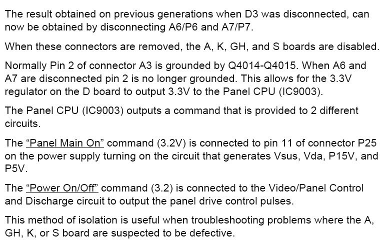

    I think there's a test which shows it by making the screen full white, but I can't remember what that is. Maybe tw2005 knows.

      No i don't off the top of my head. In fact i picked up an old analogue 42PA60A sounds like a similar issue as yours. Turns on , panel primed and that's it. I did play with it a bit and disconnected the LVDS cable from the D board and had full white. Once i did that the remote inputs blanked out the screen with each input change then full white as it would. I'm thinking bad D board. Not sure if this is what Tom's thinking of.

        This set combines D board into A so you can't unhook LVDS unfortunately, but I still think there's a test which can do it, can't remember it though. Something about disconnecting power from the "A" part of the A board, and leaving power for the "D" part of the A board.

                    My A board is a little physically different from the A board in the picture in the downloaded service manual from http://www.toms-service-manuals.com/index.php. If I am to replace the A board what/where are the identifying numbers on my a board that I would need to get the correct replacement. And Do you have any suggestions where to find a replacement board.
                      Re: Panasonic 42 Plasma no audio no video
                      You need to match the TNPA or TNPH number plus the suffix e.g. AH, AJ. Number is printed on the board.

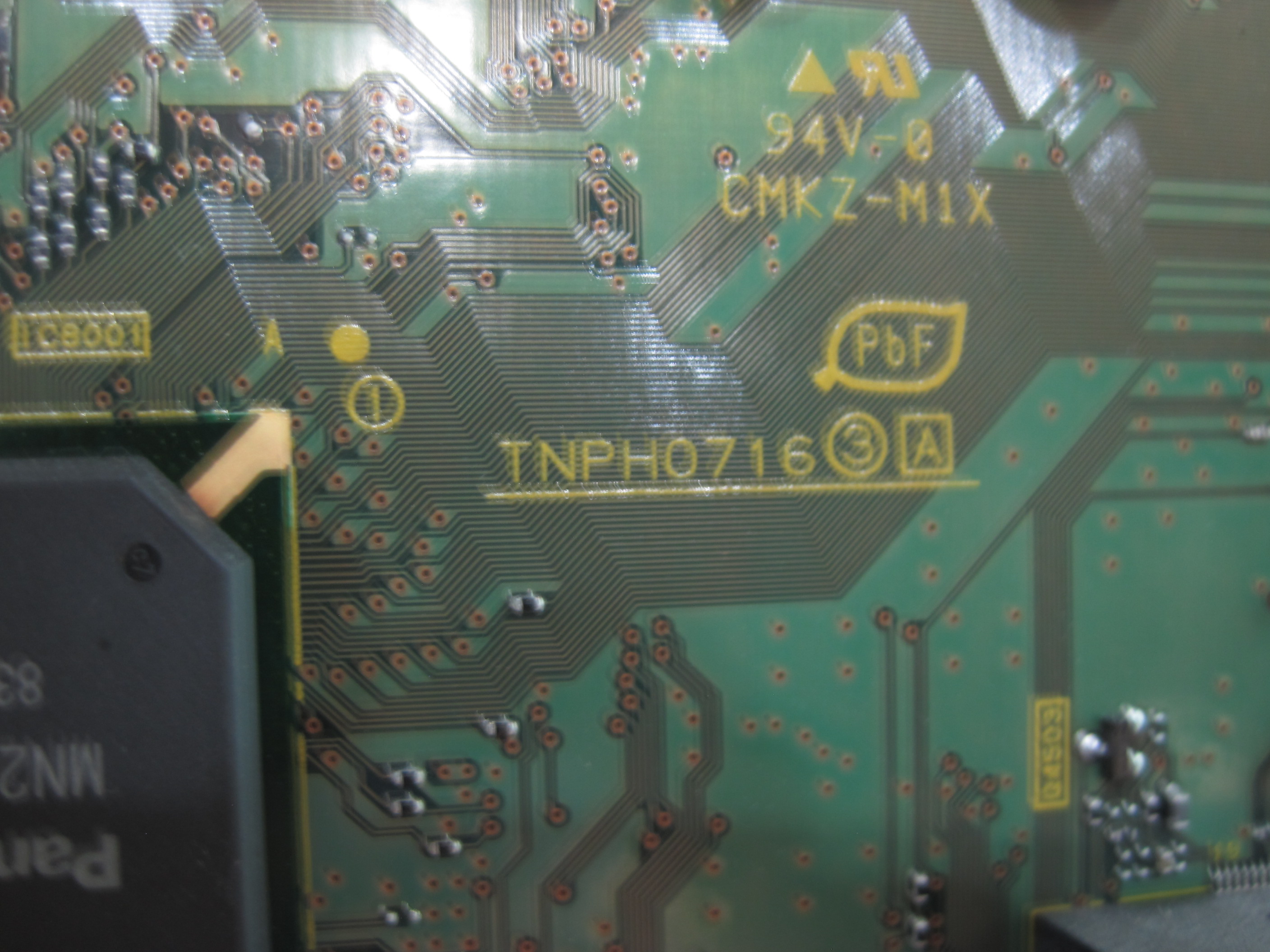

                          Attached is a picture of the A board ID# which is TNPH0716 followed by a "3" in a circle then an "A" in a square with the letters "PbF" in an oval shaped like a lemon above the board ID. DO I need to find a board with the exact numbers/letters?
                            PbF = Lead (=Pb) Free Environmentally Green (allegedly...) That's a leaf, though I can see the resemblance to a lemon...
                            TNPH0716 is the board number, but it only refers to the blank PCB with no components. Such a PCB could have many variations in components which are installed.
                            Try to find a TNPA number and order by that; it may be on the back of the board. If you can't, use the TNPH number but try to order a board which looks identical (i.e. same number of HDMI, same connectors, etc.)

                              Going by your first photo of the board, you can see it's rev (suffix) AG but it's known as TNPH0716 AGS from what I can find out using Shopjimmy as a guide
