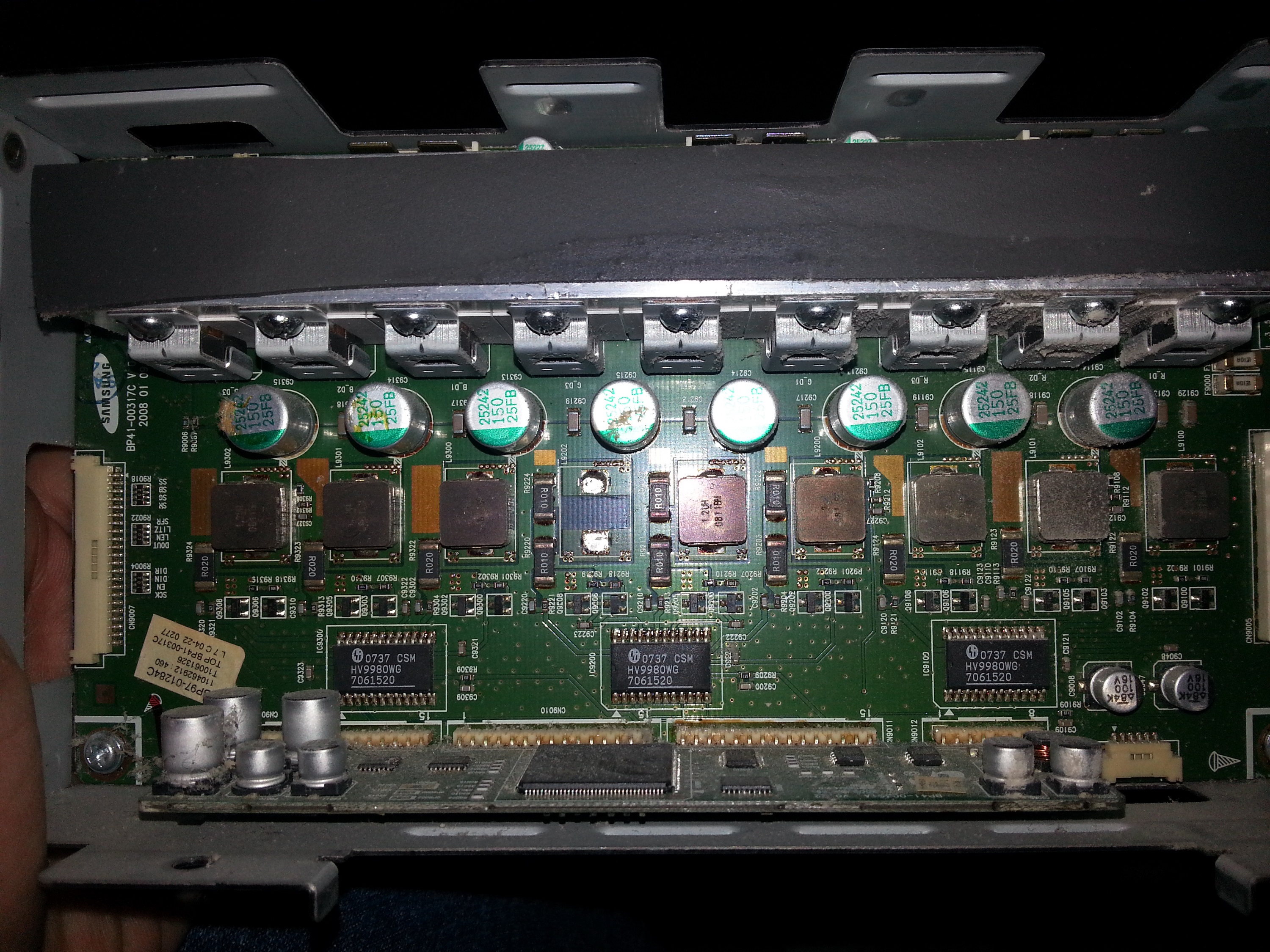

          Here I was, light engine and SMPS pulled out and sitting on my entertainment center, multimeter in hand, testing this and that... I finally finish putting together notes to type up, I pick the light engine up to reconnect a cable.. and I hear a rattling. and somehow, I just knew where it was coming from lol. I pulled the LED driver out and open up the casing around it, and that little black piece dropped out. I know it wasn't something I damaged, so my only guess is that when those caps went, they must have blown that off the board somehow. Someone tell me if that assumption is wrong. More info below.
          The one other thing I noticed, that may or may not have any bearing on this... there is a little green LED on the mainboard... when the system is trying to power up, I could see that light flashing, and hear a clicking sound comign from the mainboard/main power supply area. with power to the DMD board plugged in, it only tries for a second or two to power up, then cycled off for a few, relay clicks, tries to come on for a couple of seconds, cycles off, until it has tried three times to come on. With the power to the DMD unplugged, it tries for 30 seconds or longer to come on. I tried to read the 12V lines on that connector, but they fluctuated so wildly, in time with the light on the board flashing, that I couldn't tell you any one solid reading. I also tried reading the 12V and 5V lines from the DMD to the LED Driver, and saw similar issues. At the same time, while that light was flashing, the output to the P-SMPS was a steady 336V,when it cycled off, it would drop down to 300V. Also, as long as that light was flashing, the output from the P-SMPS was a steady 16V on all three lines.
          Ignore the error when opening the PDF, I chopped relevant pages out of the full Service Manual, because it was too large to post here (13 MB). Here's the real question - do I make the assumption that the issue with the LED Driver board was a result of those bad caps? Or do I still have something else wrong? I know I have to at least replace that board, which is going to be ~$70 if I buy the *one* used one I can find online. What if that's not the only problem? Then I'm looking at potentially either the Main Power Supply, the Mainboard, the DMD board, or some combination of the above.
          This would seem to be the LED Driver board, but this also seems correct. Both have the same board (bp41-00317c) but the other number differs between the two (BP94-02327A on the first link, BP97-01284C on the second), and not one of those 3 numbers is listed in the service manual.

            Solder that component back on and see what happens. It looks like an inductor to me. The solder on it might have cracked, causing it to fall off. When it was rattling around inside there, it could have been shorting something out, causing the cycling power problem.
                Well, it wouldn't really have been rattling around until I moved the light engine, but there is a "daughter board" of sorts that sits underneath it that it might have landed on. I'm nervous about soldering that back on, because it's such a small spot, and I get shaky when I get nervous What are the chances that something like that would simply fall off the board? the only experience I have with components spontaneously removing themselves from a circuit has been when a cap, diode, or resistor actually fails, and blows itself up, but this would be a first for me. If you guys think it's safe, I could certainly try though!

                    PM sent! Do you agree I should try to solder that inductor back on and see what happens?
                      #30
                      Re: Samsung HL67A750 DLP with bad caps!
                      Yep, definitely. It's definitely not going to work without it. Do you remember seeing any flash of image before?

                          Simply use a pair of tweezes to put it on the board steady, then solder to each end. Are the pads exposed? If you have difficulty holding it steady, it may be a good idea to use a dab of glue to hold it on the PCB. Don't use glue on the solder pads though-- do it on the bare board.

                              So, I used the glue suggestion last night, and did the best that I could to re-solder that inductor. tested continuity between the pad and the side of the conductor, it was good. Reinstalled in the TV, and HOLY CRAP IT TURNED ON. once. when I buttoned it back up and moved it back to my entertainment center it was just as dead as before. During one of its attempts to cycle on, I heard a faint fizzle sound from inside the TV, like a component letting the smoke out. TV has the exact same symptoms that it had before now. Going to pull it apart again tonight and check it out, see if it was just my solder joint burning up (admittedly, it was not by best work!).
                              But for one glorious minute, the TV was in good shape.

                                  Well, it took just over two weeks, but I finally got the new LED Driver in today. Pulled the TV apart, replaced the board, put it all back together and.... same thing. TV tries to turn on, cycles three times, and goes into the 3 flashing light mode. So at some point this weekend, I'm going to have to take the time to pull it all apart again, and check the motherboard and main PSU. If both of those check out, that's going to mean it's the DMD board (I just replaced the chip less than 12 months ago) and that's going to mean selling this thing for parts.
