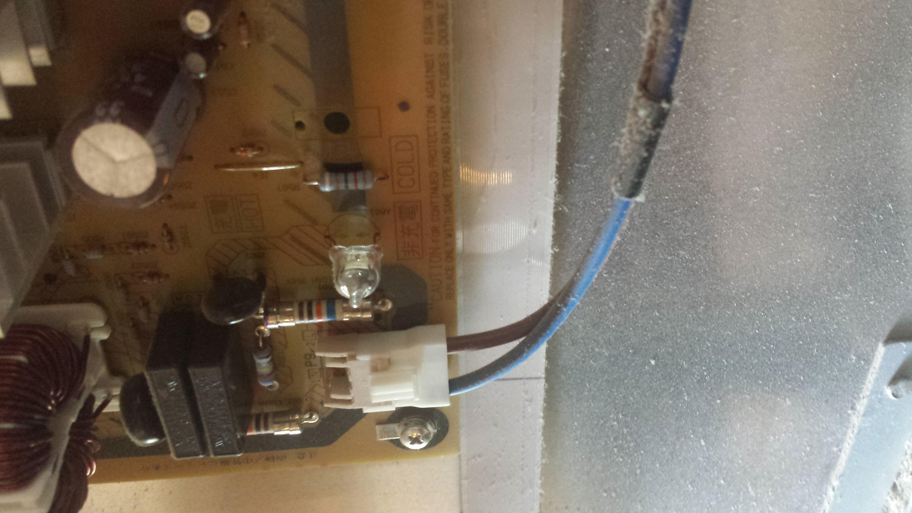

    We had a lightning strike close to our house. (Old house no ground circuit for protector) relay clicks, all fuses good on K board (the light bulb does not come on?), power button seems to work like normal, no flashing of led but when screen powers up there is no display. I dont believe it registers the remote either.
    Please advise!
    oh and this model has heat sinks on all the IC so cannot tell if anything is blown. Everything else looks visually ok.

    What light bulb are you referring to?
      Re: TC-P50G10 No display.. No code?
      K board, just to the right of the 120v in connector. Didnt look too close but appeared to be a light bulb soldered into the board. Due to location seemed like it was a power indicator? Could be wrong

          That is the surge suppressor neon tube - like lightning in a bulb - it's not supposed to light up.
          Do the fans ever spin up?
