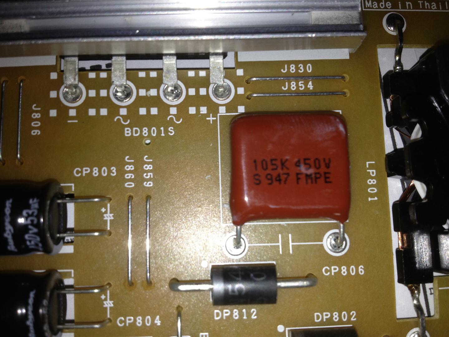

                      #50
                      Re: samsung UN46c5000QF
                      What is the capacitance of CP806? It might be bad.
                      • martino
                        Not so "senior"
                        • Aug 2013
                        • 997
                        • canada

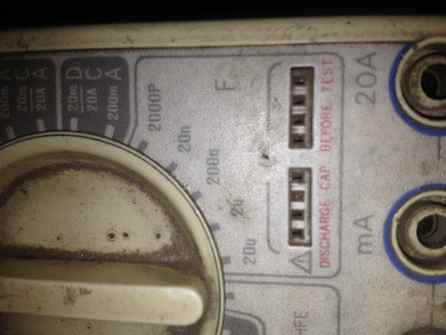

                        #51
                        on schematic it says its a 1000nf minimum 400volt
                        I tested it with my volt meter but not sure if this is how its done (see pic) I don't have a ESP meter
                        My meter on 2uf setting(200nf setting says OL) says it's 0.961 .
                        I assume that's 961nf...
                        excuse the filth on my meter,it get's used on automotive daily...lol

                          #52
                          That is expected for such a capacitor. In standby it has 165V mostly, but when operating it has 0~165V full-wave rectified sine (PFC decoupling capacitor) which averages to approx 165V/sqrt(2) = 116V.
                          • martino
                            Not so "senior"
                            • Aug 2013
                            • 997
                            • canada
                            #53
                            So, we can conclude that cp806 is good?
                            Proud owner of dozens of broken TV's and many,many,many boards.
                            Our website and passion:http://hollenhundshepherds.com/
                              #54
                              Yes.
