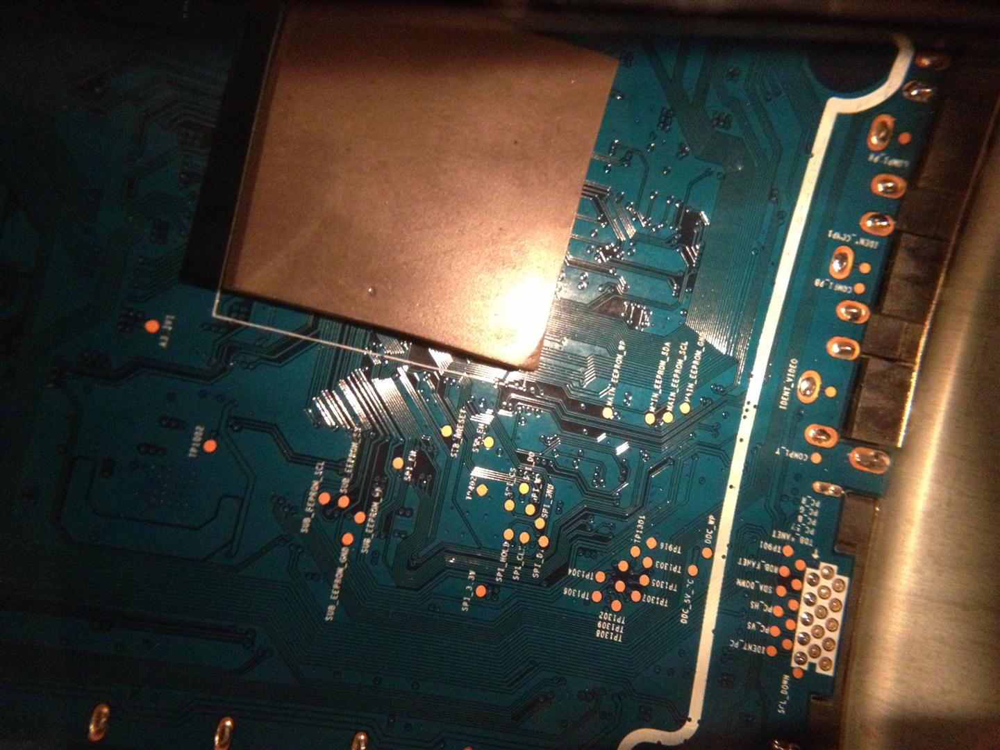

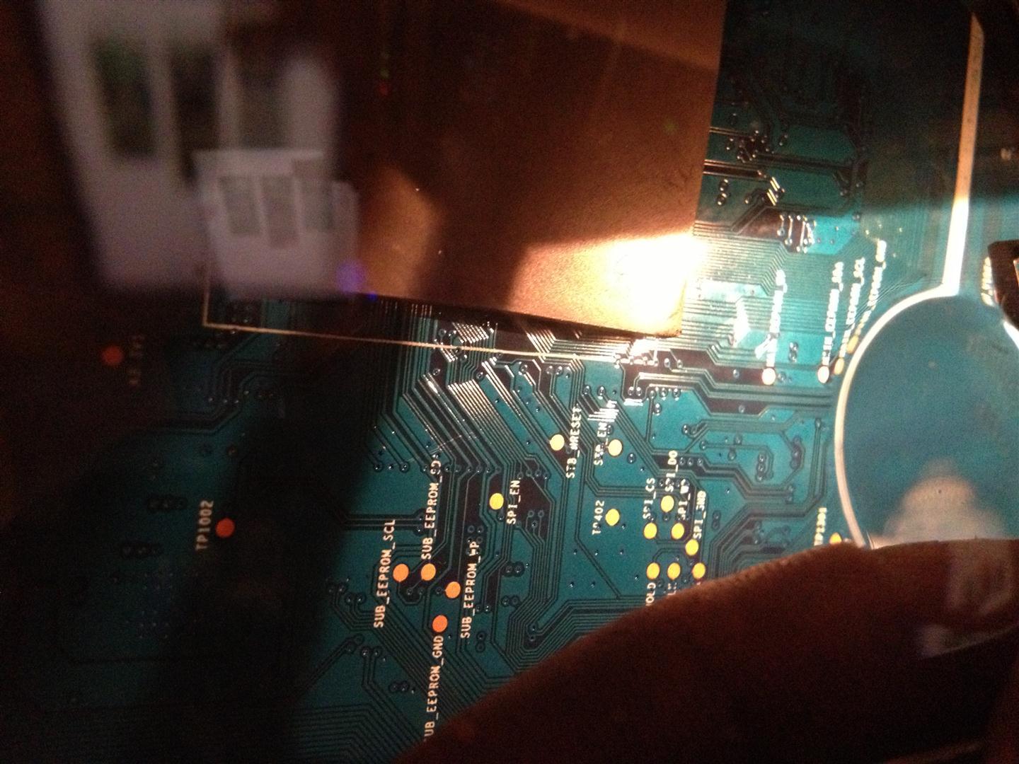

                        Re: samsung UN46c5000QF
                        Took mainboard out and looked at back side..No IC etc but did see some copper colored points that had printings beside it,like main eeprom-wp etc..
                        One point is labeled STB_NRESET...Could any of those be needed for a eeprom reset??
                          Yes, reset can probably be achieved by connecing MAIN EEPROM SDA, SCL and GND all together.
                            ok,connect them all together,then power up tv? does mainboard need to be attached to chassis(ground through screws)??
                            I took it off chassis to look at back side,I'm guessing it would be best to solder wires on those points???
                            So,to be clear,I solder wires to those points,screw it back to chassis,then apply power to tv,do I need to do startup attempt? if i do,just once or multiple times??
                              Yes, TV must be off, then jumper the pins, power up (using button or remote), release after about 10 seconds.
                              If set does not boot up, then it is probably a firmware problem. You can also try with SUB_EEPROM_SDA, SCL, GND...
                                I'm guessing it won't boot up during the reset cycle??
                                So,do the reset cycle,then take jumpers off and try turning on tv?? is that correct??
                                  According to the SAMYGO website, it should boot, with a message asking you to set the default parameters...
                                    tried the reset procedure....
                                    tried with sda,scl and ground in all combo's..
                                    tried to power up for 20 sec with remote,tried with just leaving it in standby for 20 sec etc...
                                    No live whatsoever
                                    I'm guessing I will be buying a mainboard now????
