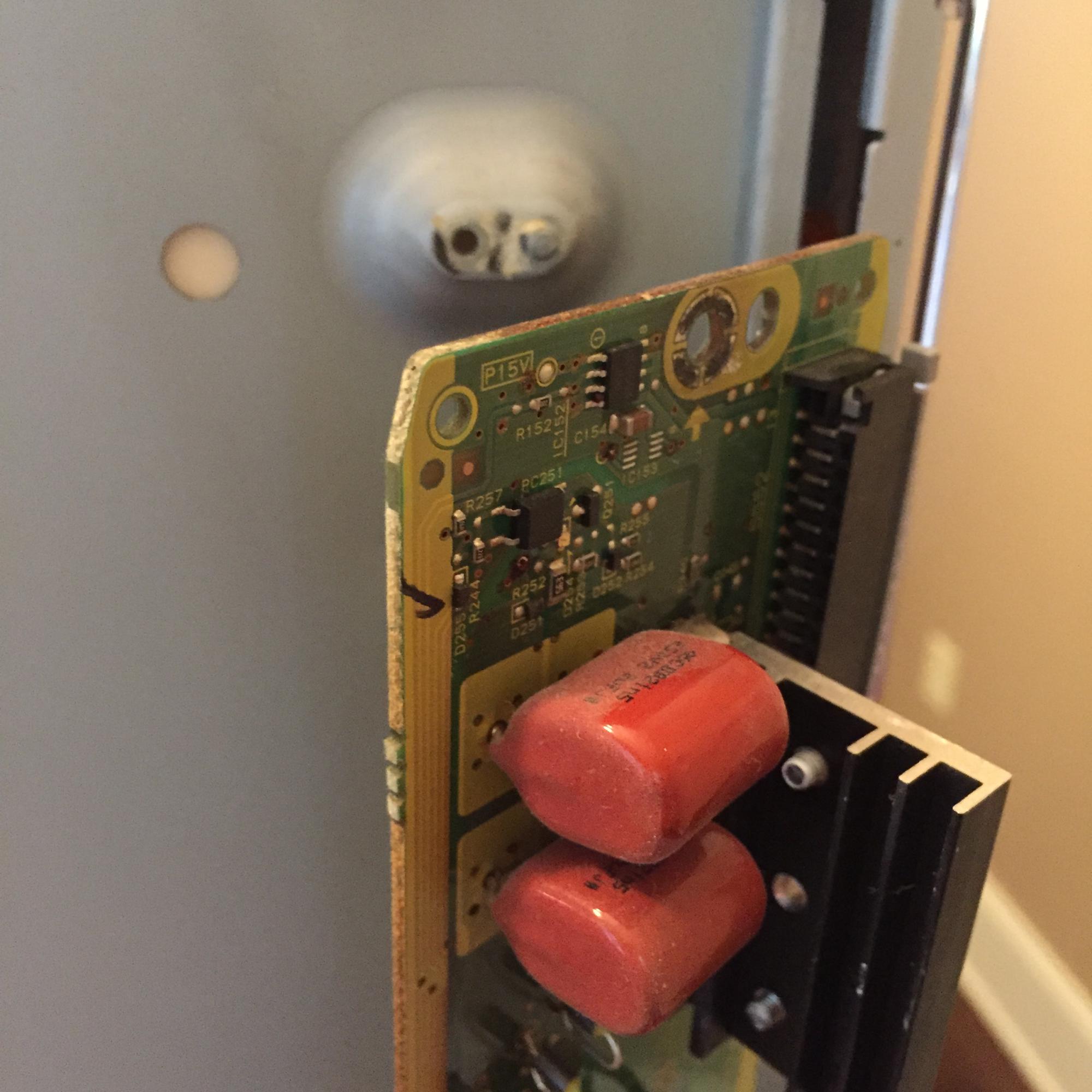

Sorry to intrude on an existing thread I'm not able to open a new thread for some reason. I have the tc-50pu50 with 8 blinks also and replaced the parts on the ss board to correct this and noticed that component PC251 broke off the board and is nowhere to be found, does anyone know what this component is? It is on the TNPA5623 ss board.Comment
Re: Panasonic TC-50PU54 8 blinks picture flashes then dead
optocoupler, PS2701A-1-F3-A. Pretty common on the panasonic boards if you happen to have any old SS or SC boards that are scrap.Sorry to intrude on an existing thread I'm not able to open a new thread for some reason. I have the tc-50pu50 with 8 blinks also and replaced the parts on the ss board to correct this and noticed that component PC251 broke off the board and is nowhere to be found, does anyone know what this component is? It is on the TNPA5623 ss board.
Broken off implies the pads are torn off too. could make it had to fix
clean break, that's handy then. does look like someone has been soldering in there. Did you replace the Driver IC? Someone found after their new parts were installed it shorted agian needing the driver IC replaced to finish the job.
https://www.badcaps.net/forum/showthread.php?t=49048Last edited by tw2005; 10-13-2015, 06:02 PM.Comment

OK I've pulled the SS board off and found that the top screw had scorch marks on it. Is it safe to assume that this board had grounding issues and is fried? I'm going to see the board off for repair, what screws should I get to prevent this from happening again?Comment
looks just like all the others we often read about. Pretty much any panasonic Plasma 2011-2012 had issues with these bolts working loose on both sustain boards,
The seller gives suggestions on what you need to do after you get the repaired board back to complete the job properly,
Two options is to reuse those blts and put some loctite or threadlock on the threads or use the correct bolts which were in every Tv before 2011.
http://www.shopjimmy.com/panasonic-x...-screw-kit.htm
I would go with the new ones simply because if the solder lands compress at least the spring washer will expand but clean up all the scorch marks and check out the SC board too.Comment
