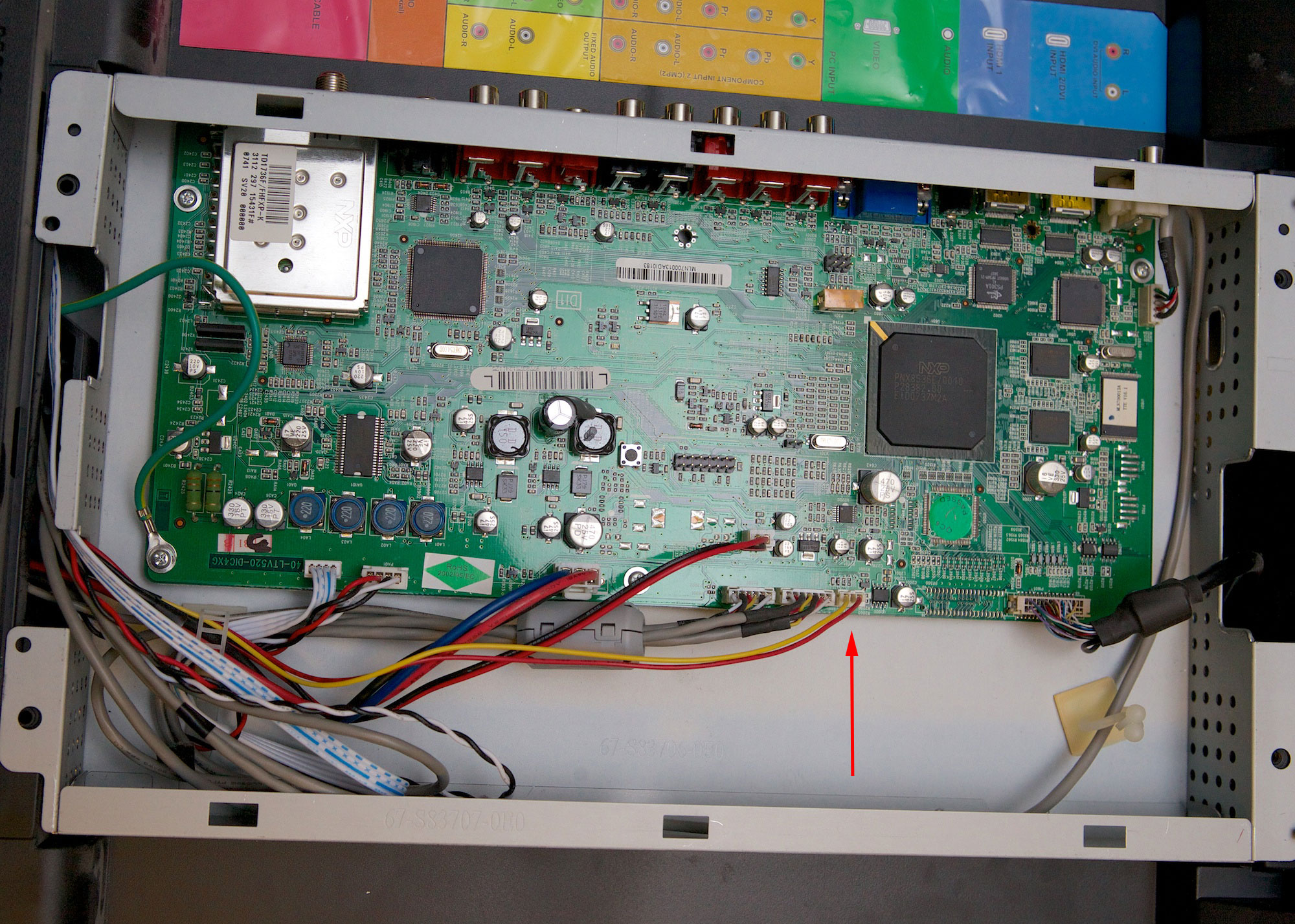

    Originally posted by tom66
    Can you trace where the red and yellow wires on the power connector on this board go?
    https://www.badcaps.net/forum/attach...2&d=1375300973
    Attached.

      Re: RCA 42 inch LCD L42WD22
      OK, can you measure the voltage on each of those pins? Measure both in standby and after power button pressed. Same procedure as before with the power supply connector.
        Red standby: 0.0 On: 0.0
        Yellow standby: 0.0 On: 3.0
        Never trouble trouble until trouble troubles you.
          The red never changes? They would usually change at the same time or not at all (if a fault occurs.) Please double check.

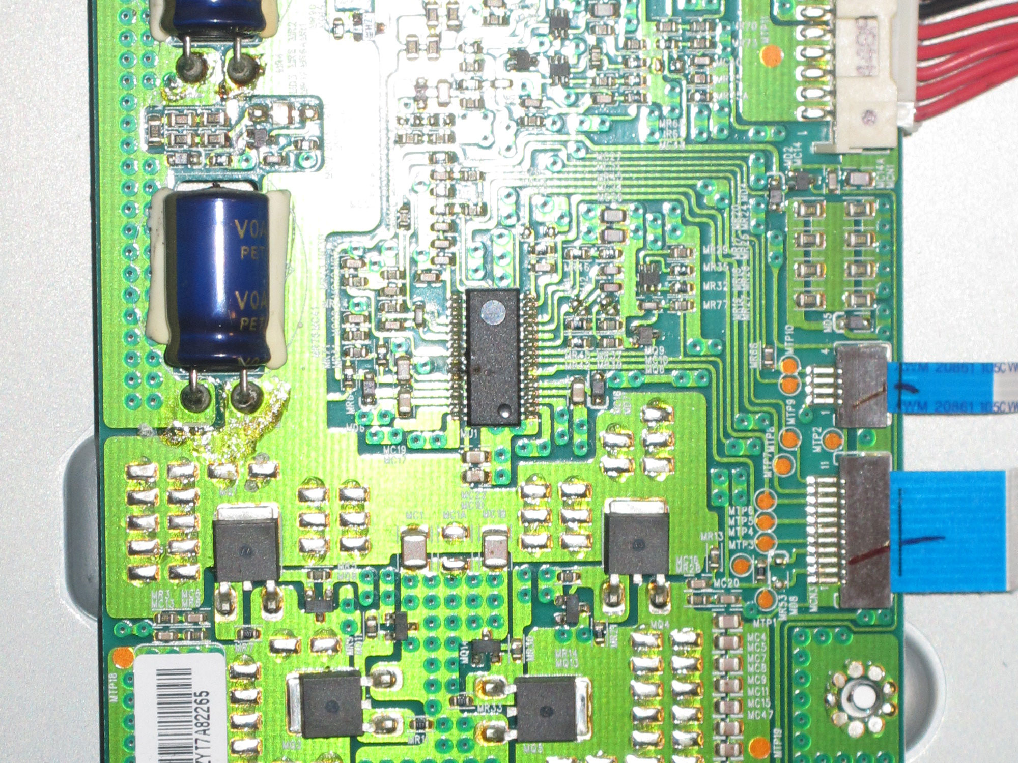

            I have looked at your inverter pictures and the second picture looks like the ic is blown, can you check the fuse on that board and see it it is ok. I have seen a lot of these inverters and when the ic shorts it burns the pin on the ic.
            look at the pictures on this site: http://www.avsforum.com/t/842732/phi...l7432d-37/6720
            does your inverter chip have a burn mark on it?
              I didn't notice that, definitely looks bad to me.
                That might be a burn mark. VERY small.
                Attached is a close up.
                Is this even fixable?
                  Definitely bad. The chip can be replaced, but you will need a good soldering iron and ideally a hot air gun. You can also replace the whole board if you want.
                    I have both a soldering iron and a hot air gun. Can you give me any suggestions on how I go about finding a replacement chip? Thanks for all your help.
                      #30
                      Read the part # off it and order it on eBay, if I remember correct they're only a couple of bucks each. After doing this do the Inverter Modification II recommended by Philips to prevent repeat failures:
                        Well, ordered the board off ebay. Should be here in a week or 2.
                          If the replacement board you get does not have the modification performed, it is highly recommended to do so to prevent future failures.
                            YAAAAAAAAAY!! Tom66 and R_J you guys rock. My TV is working again.
