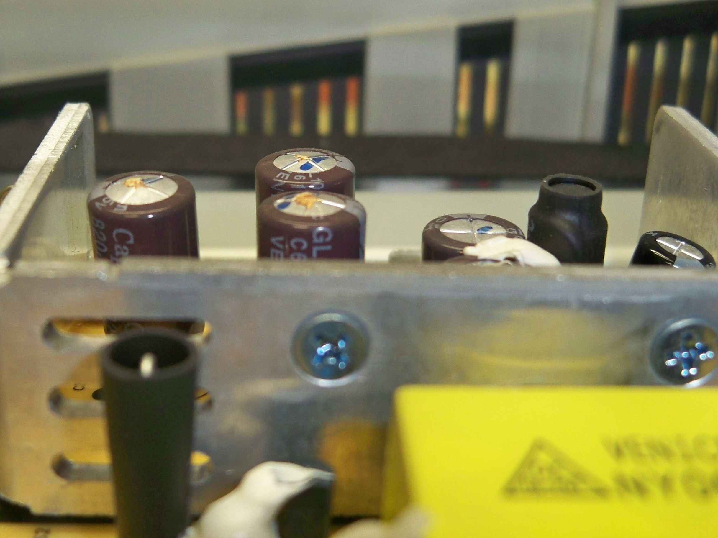

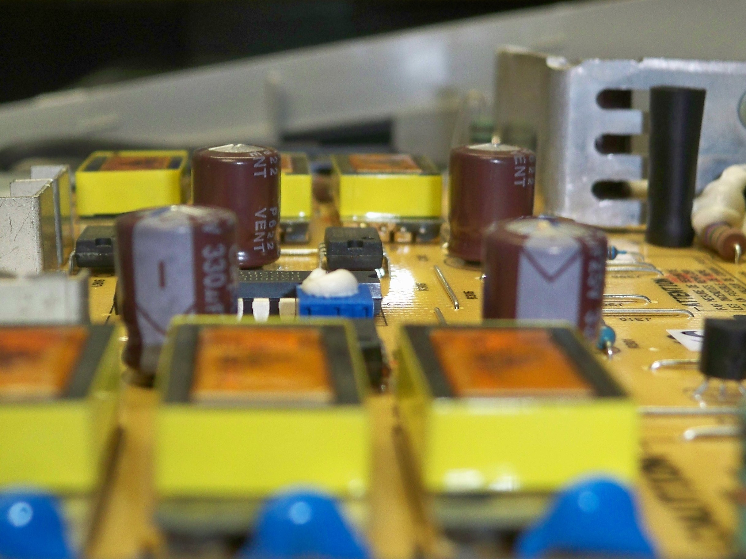

    Got this little 20" given to me today. When powered on, it would stay on 5-10 seconds then seem to shut off... but on further inspection it was staying on but the backlight was shutting off.
    I pulled the cover off...wow. Looks like all 4 inverter caps are shot, and i see several caps vented in the power supply section also. I have no idea how this thing even partially functions.
    Im not sure if im going to recap it tonight or not. but i couldnt find this model listed here so i figured i better make a post with some pics.

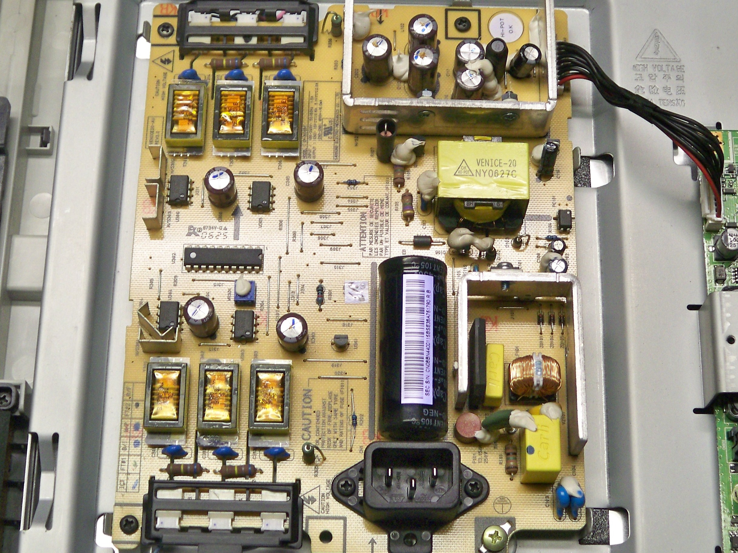

    Success!
    replaced
    4x 330uf 25v inverter capacitors
    3x 820uf 25v power supply capacitors
    and heres what i got. A proper job would be to replace all the caps but for this cheapie tv this fix will work just fine.
