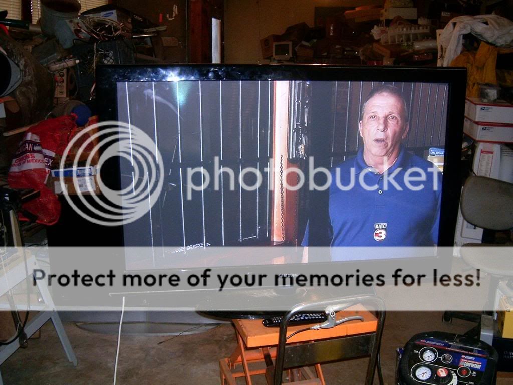

    Have Samsung TV with with good picture, good sound, and approximately 2 inch wide vertical black line about 2/3rds way from left. Is this a buffer board or should I suspect the cable connections first? Any and all advice is appreciated.

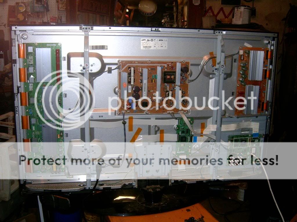

    Check the cable connection below or closest to the black bar, but most likely is the panel, there will be a i.c. on the ribbon cable between the panel and the board that may be bad and is part of the ribbon/panel
      Re: Samsung PN50A460S4DXZA, VERSION#SQ11
      It is most likely to be a bad plasma panel, not repairable, we've seen a run on these Samsungs here recently dying with the same fault.
