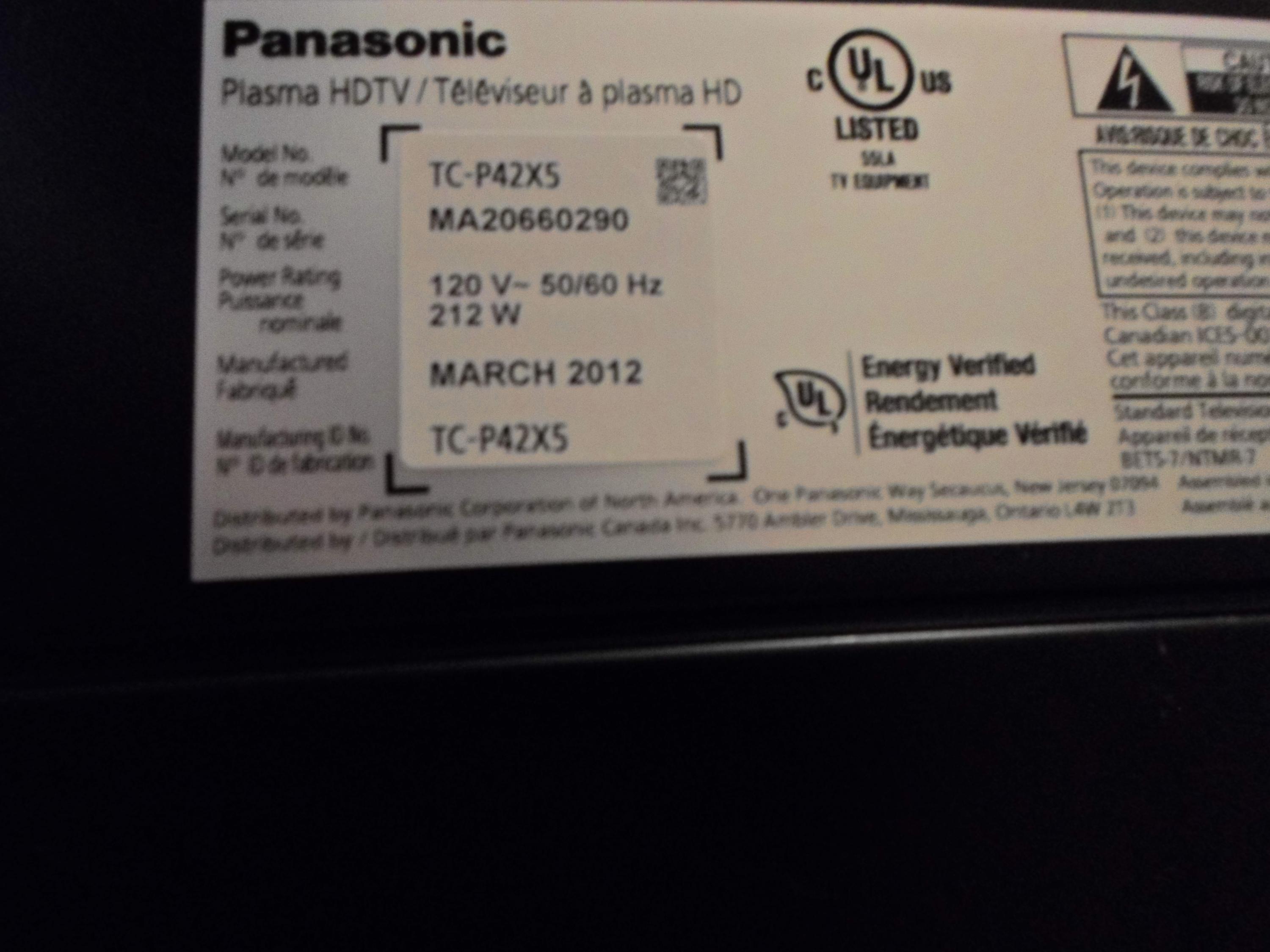

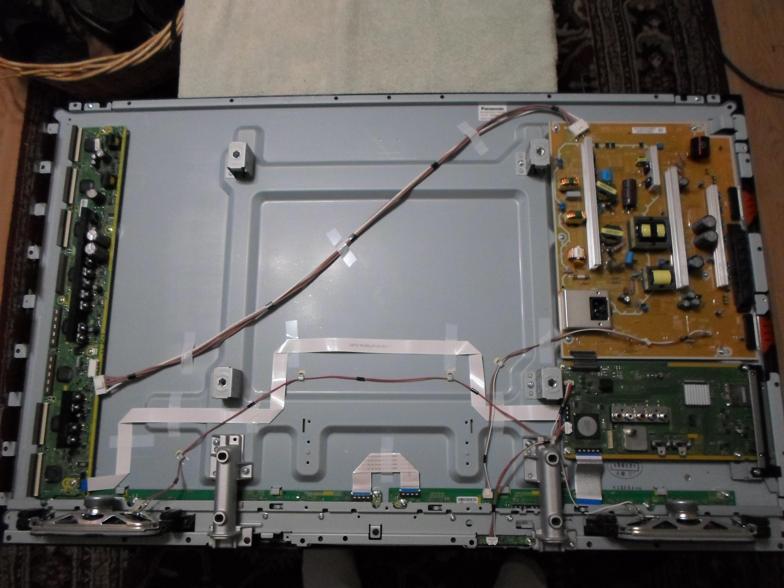

    Acquired TV with broken screen, had 7 blinks. Disconnected all panel connections has 8 blinks. Trying to determine what parts are good. Is there a service manual for this one, or buffer board bypass? Thanks!

    Looking at the layout, combined sc/sd/su so there won't be a bypass like the traditional setup where you could at least determine if the Sc was still good by jumping SC50. Chances are the SN board is bad with a cracked/shorted panel.
    Maybe a quick check between gnd and the buffer outputs and see if any shorts there. SOS8 most likely because no SN or SS connected, was it just the panel ribbons disconnected from the SN/SS boards or power and SC20 also?

      No shorts to ground on buffer outputs. Tried different combinations of removing connections still cant get TV to stay on. I figured with this setup removing panel connections would do it.

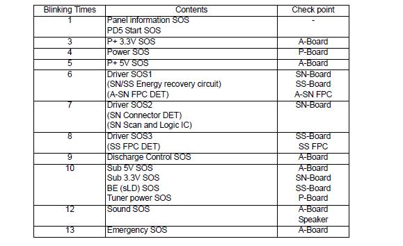

        This blink chart for a X3 might be close, I'd prefer to find a training guide, no joy though. Most of what I have is for the traditional SC/SD/SU setups.

          Panel usually kills SN on this though I've never conclusively found bad buffer ICs. SS/PSU (combined) and A are usually OK. I got one of these with a smashed screen which had no power at all, I am thinking the user smashed the screen in frustration.
