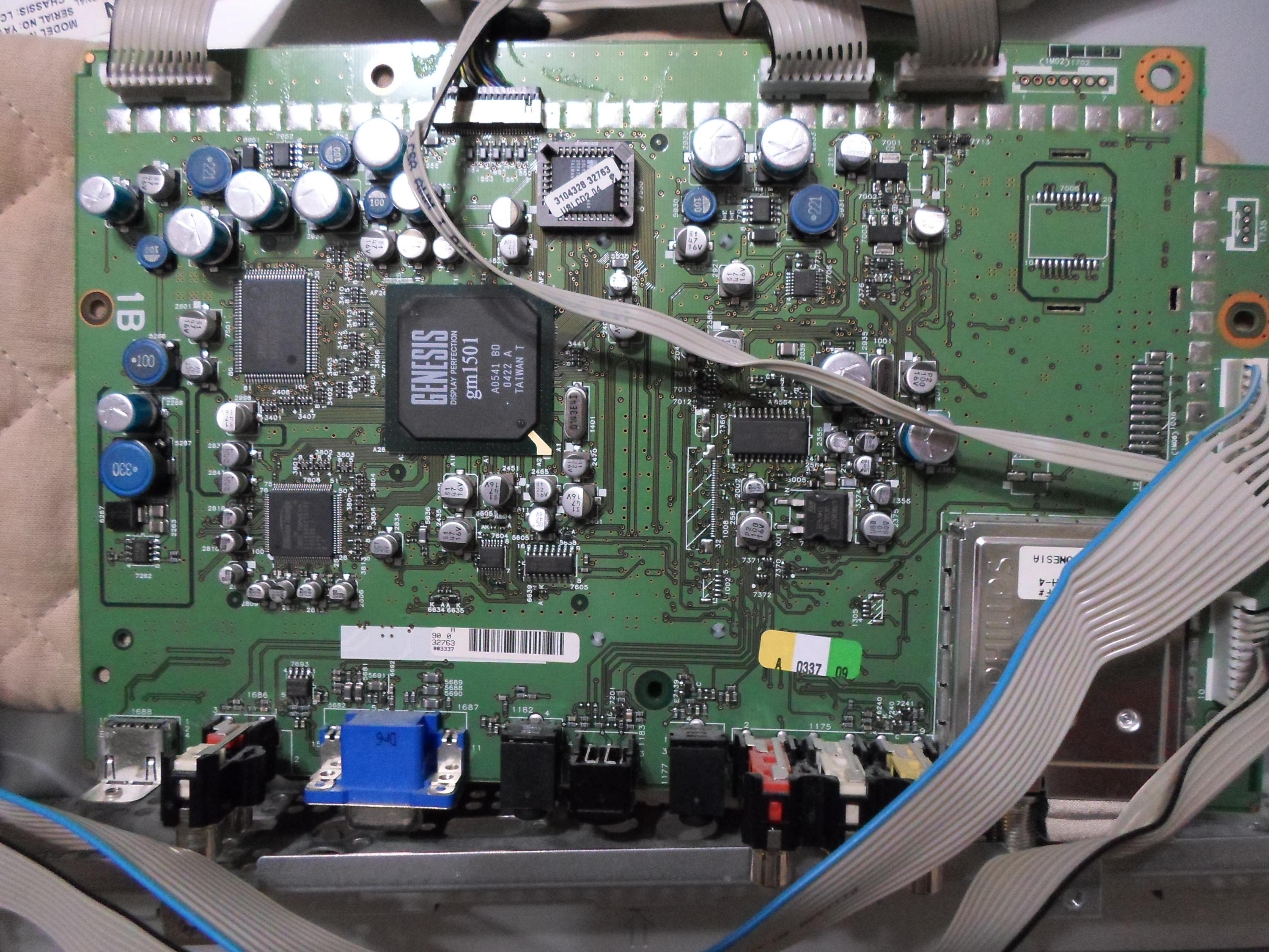

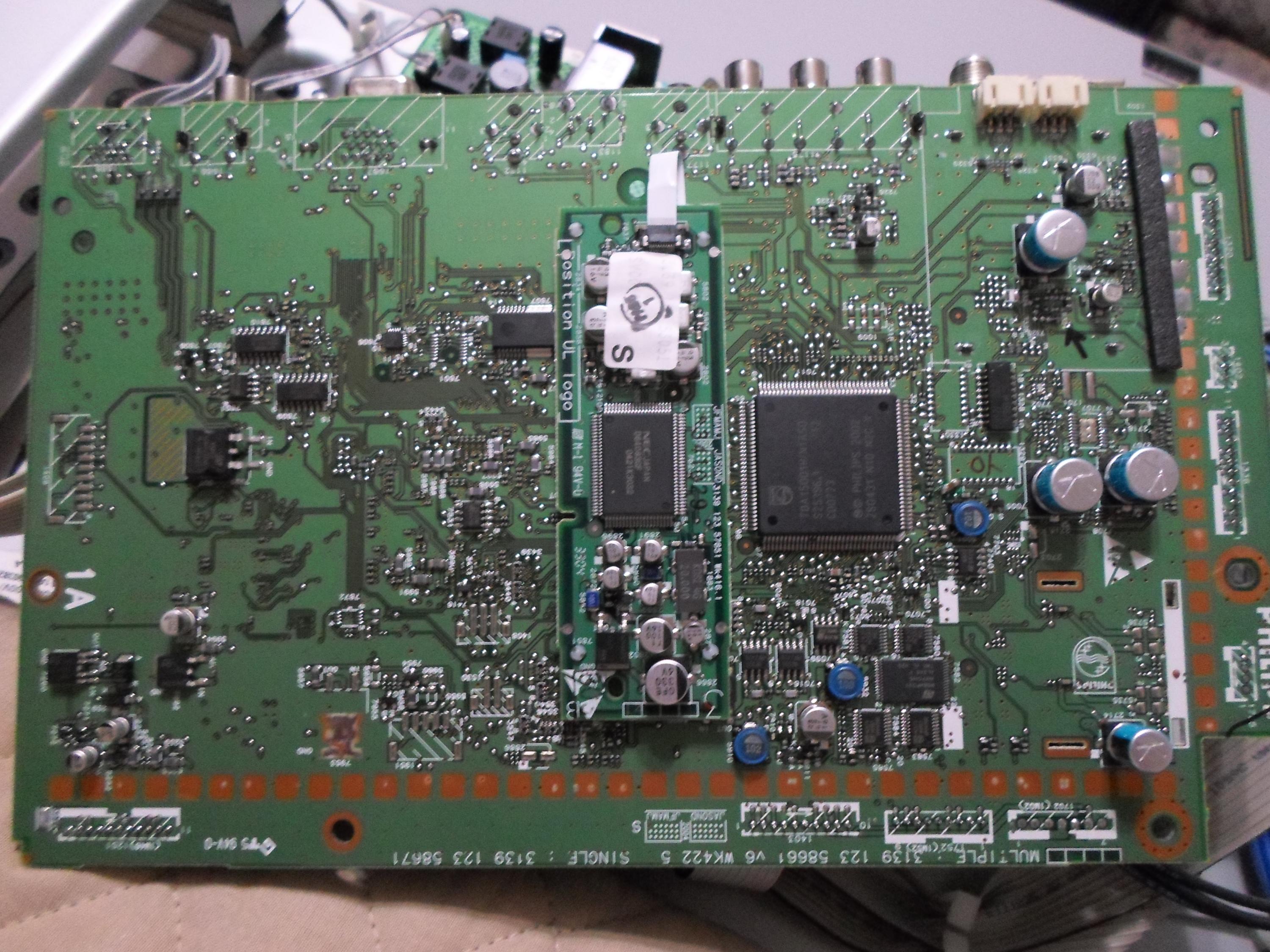

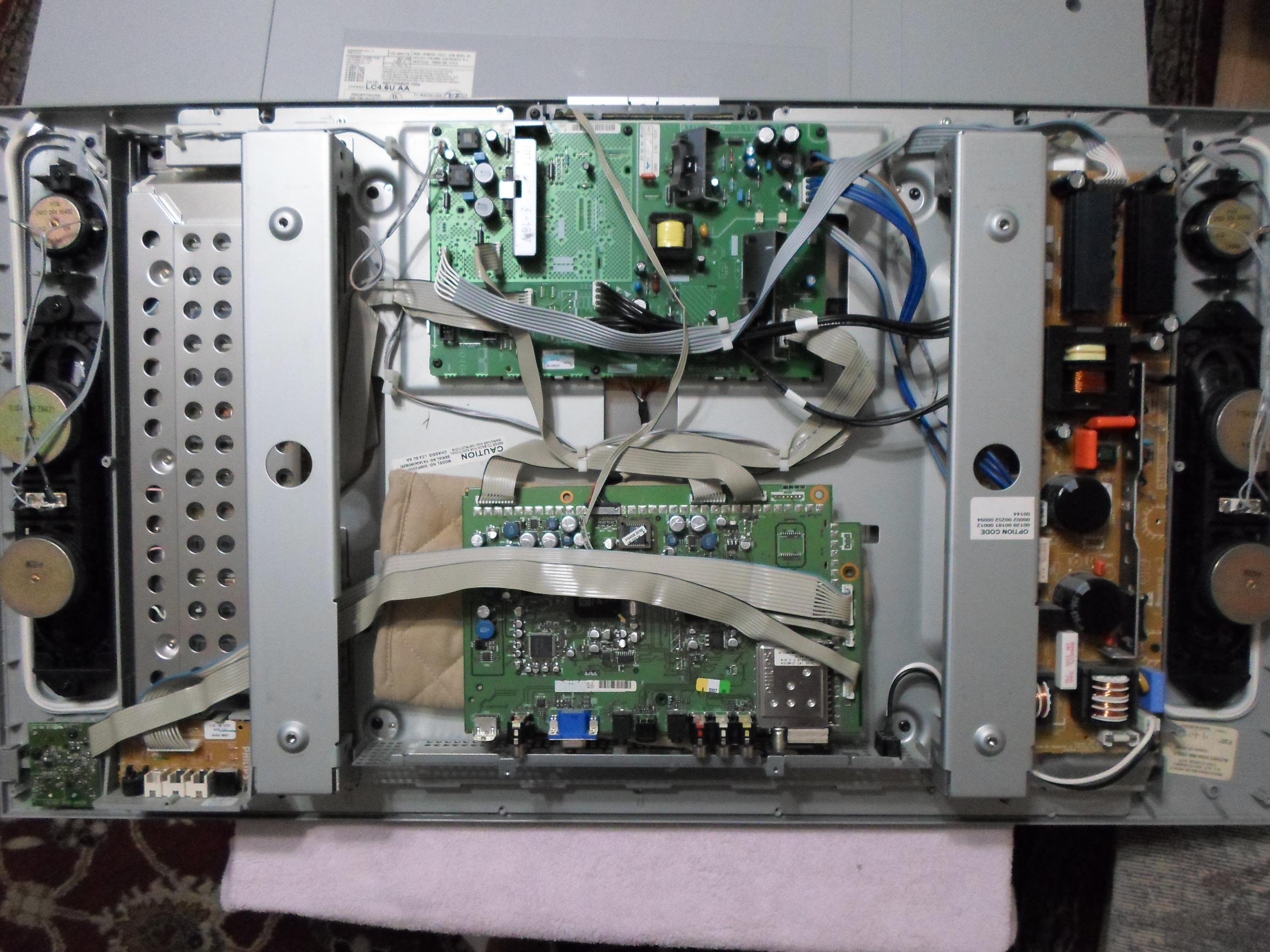

    This TV is an oldie (Sept. 2004), have had sitting here for a bit.. Thought for sure it would just be bad caps for once..
    Full info: 30MF200V/17, Chassis LC4.6U AA, Serial YA1A
    Symptom: Power LED goes RED GREEN ORANGE RED - Won't power on.

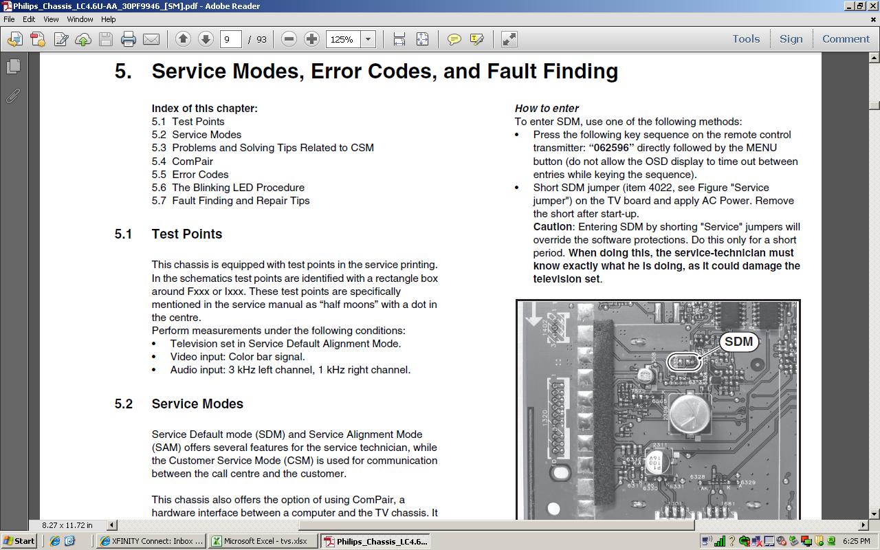

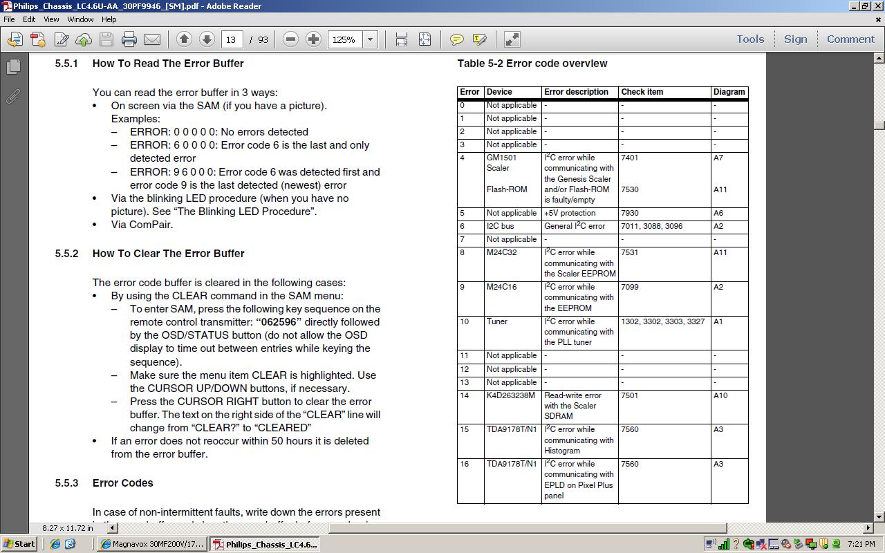

    I got the service manual for this chassis, and it says to jump 2 pads on the main board which I did, to get error codes. This did not work. So I'm not sure what the problem is.
    I checked the voltage regulators on the main board and they all were good, I beleive the 12V is the one that drops out the rest stay up, Ill have to double check it.
    There is no backlight, but a brief flash of light when you shut it off.
    Since I can't get any error codes and there is no obvious problems, I don't know what to think.
    Im wondering if the LED pattern means anything though.
    How did you jumper it? Maybe you didn't jumper it long enough?

      I dragged solder across the pads so it's permanently jumpered for now..
        Re: Magnavox 30MF200V/17 Won't Power Up
        It may need to be removed as it is powered up per the instructions, as a two step process.

          I can try that, wasn't sure if that was meant just not to damage anything since it disables protection..
          Here are the codes, it looks like most of the codes are main board/software related doesn't it?
            That would not have been my interpretation of the instructions.

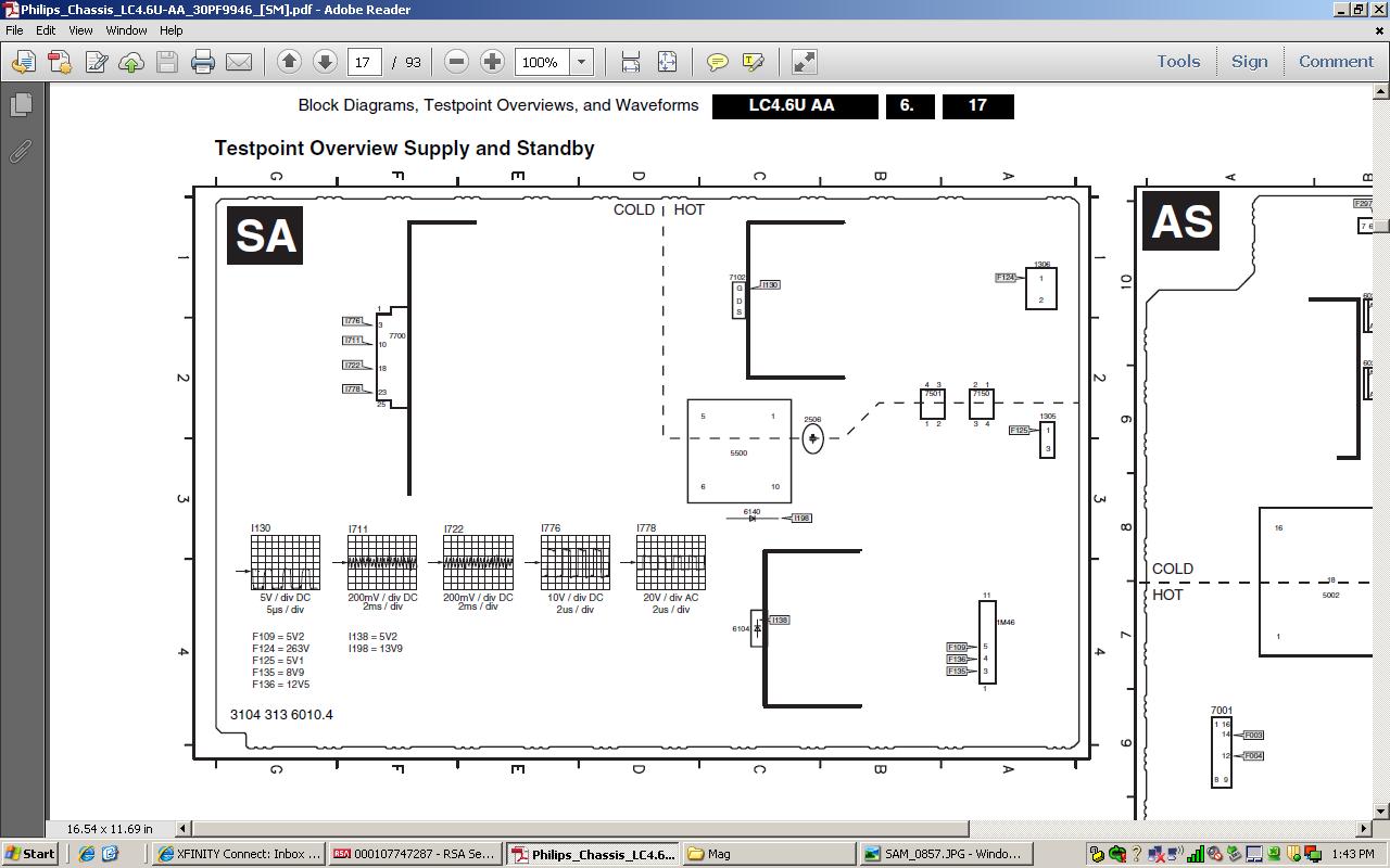

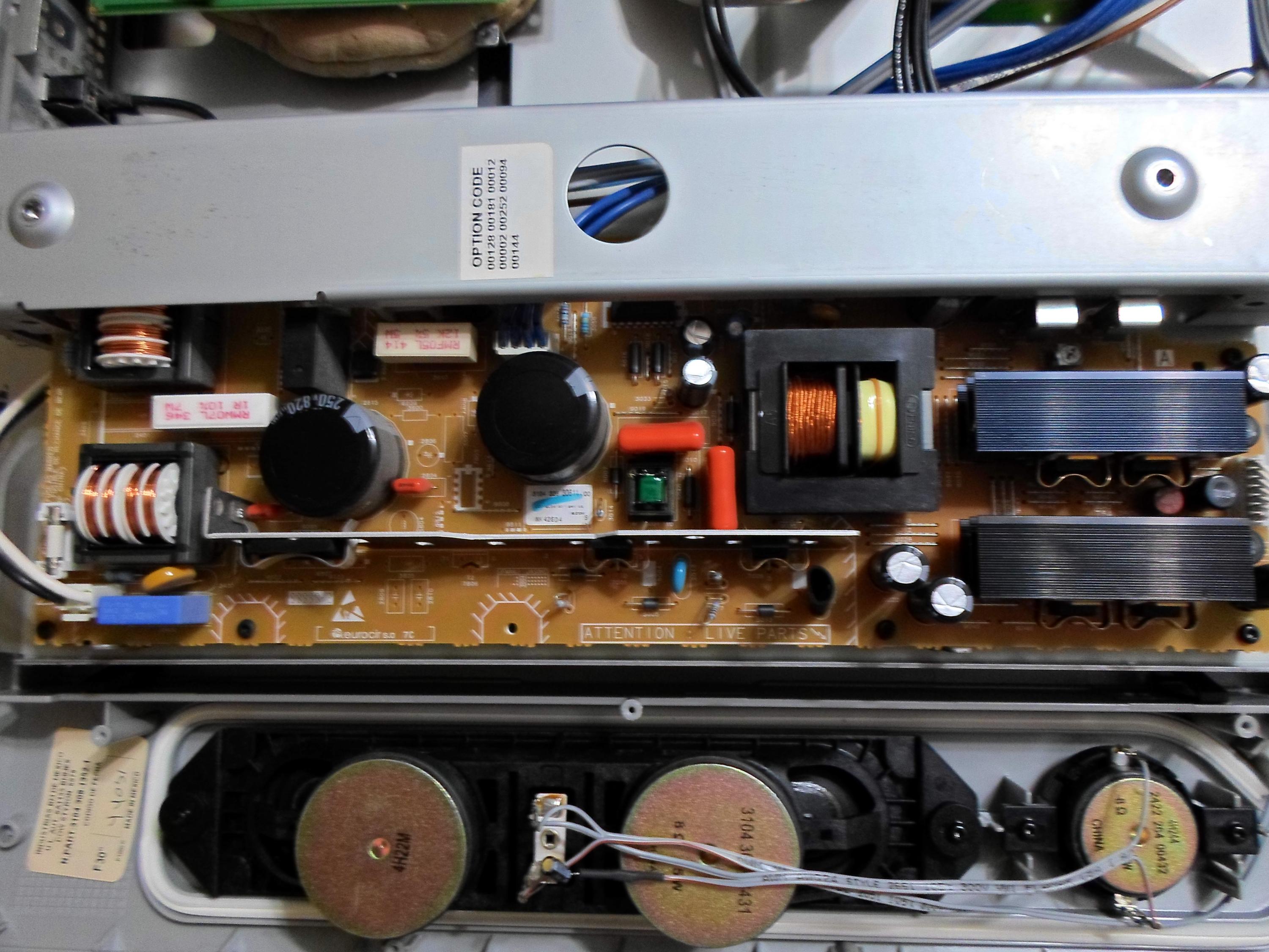

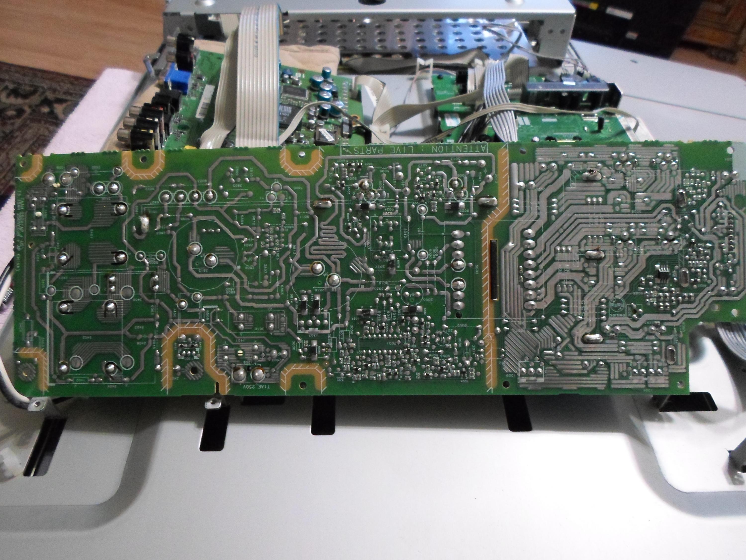

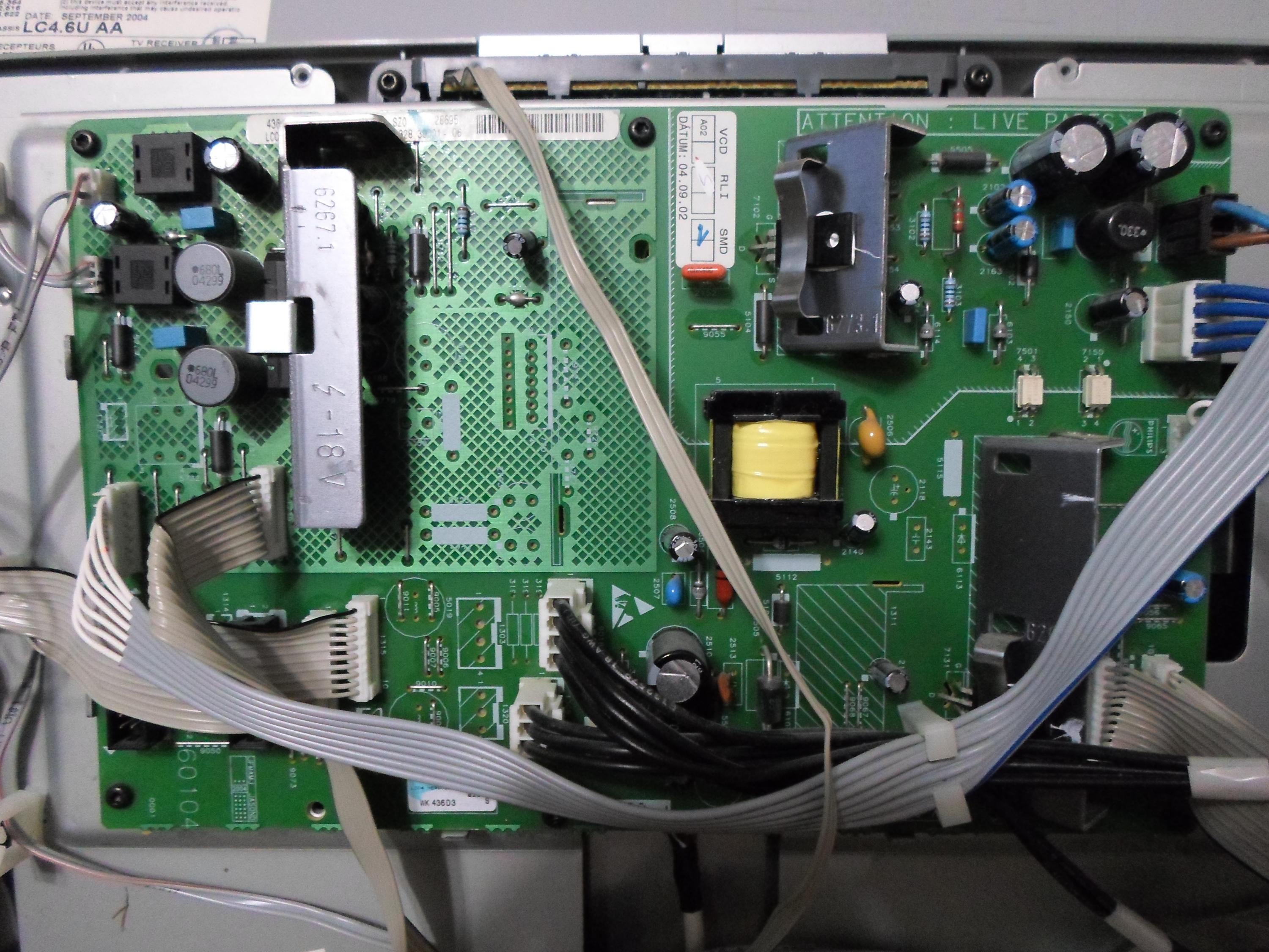

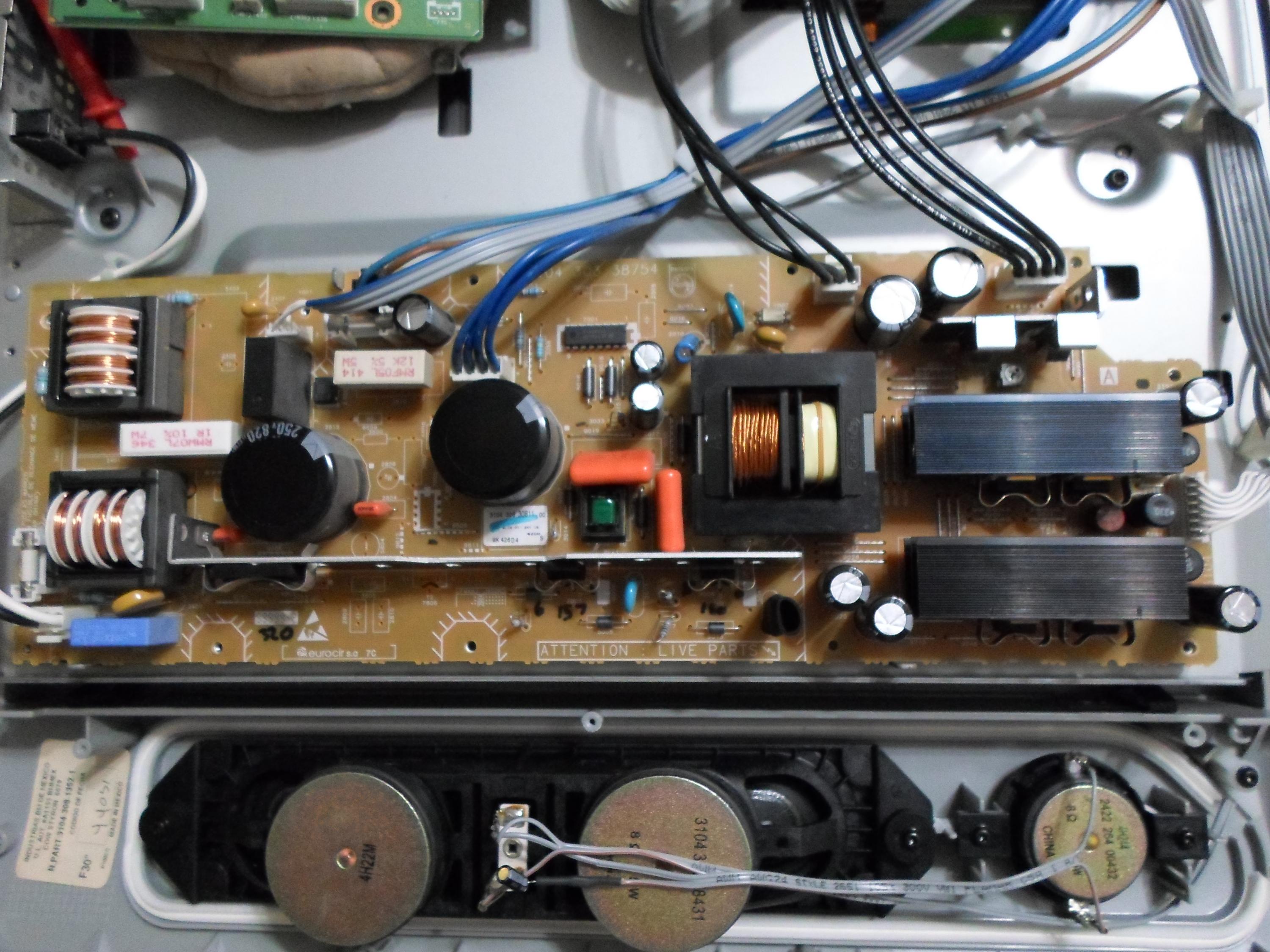

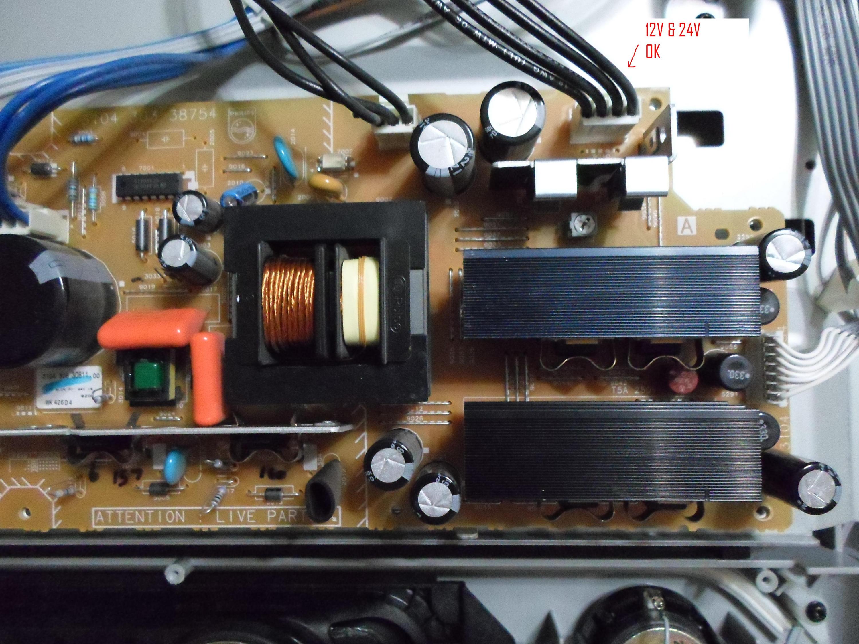

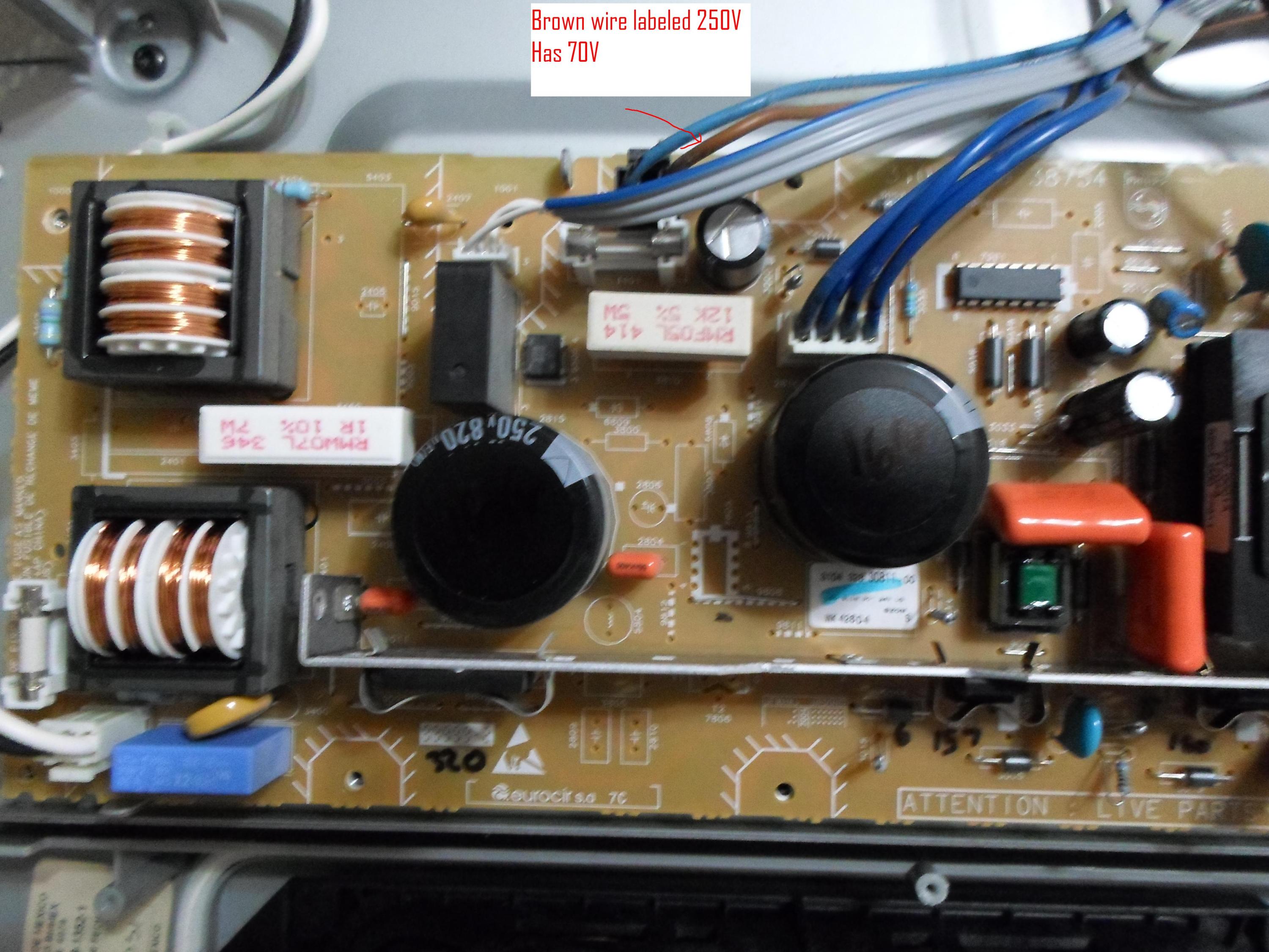

              Well started from strach with the power supply board. It looks like the section for the 12/24V is OK as those voltages come up breifly, and then go down after TV shuts down.
              But there is a high voltage line going from power board to sub power board/standby&audio board. It says it should be 263V but I only have 70V.
              I have 161VDC across each of the large caps. 320VDC at bridge rectifier.
              Was wondering if you guys can help determine why the voltage is low. Thanks!

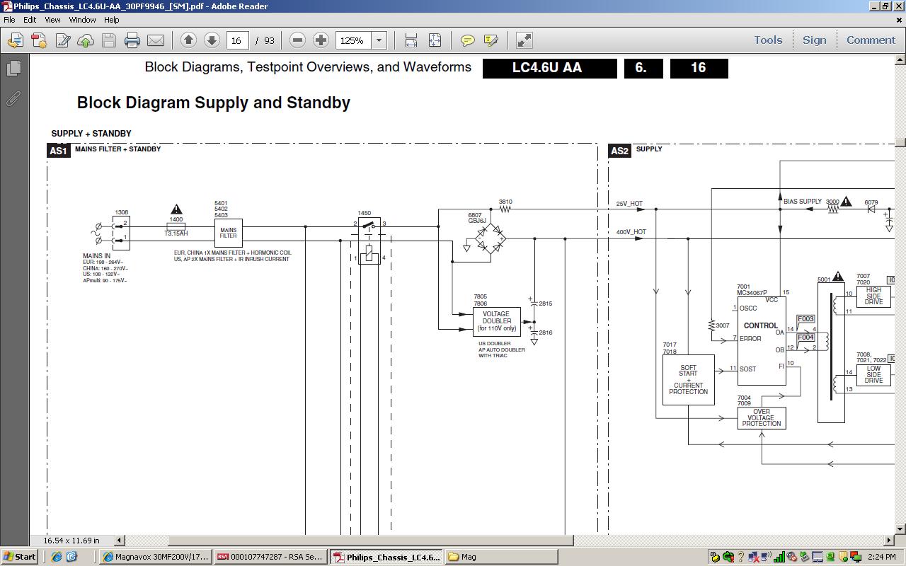

                320VDC at bridge? In USA? You sure?

                  Yea, I am confused by this setup with the second board that has the standby circuit and audio amp..
                  I saw this voltage doubler thought that was the reason.
                    Ah OK -- that makes sense. 320V is fine.
                    What connector # has the 70V on it which should be 263V?

                      It's connector 1306 brown and blue wire from main PS to AS board as seen in post 7
                        70V is definitely bad then. What is the voltage across capacitor 2503?

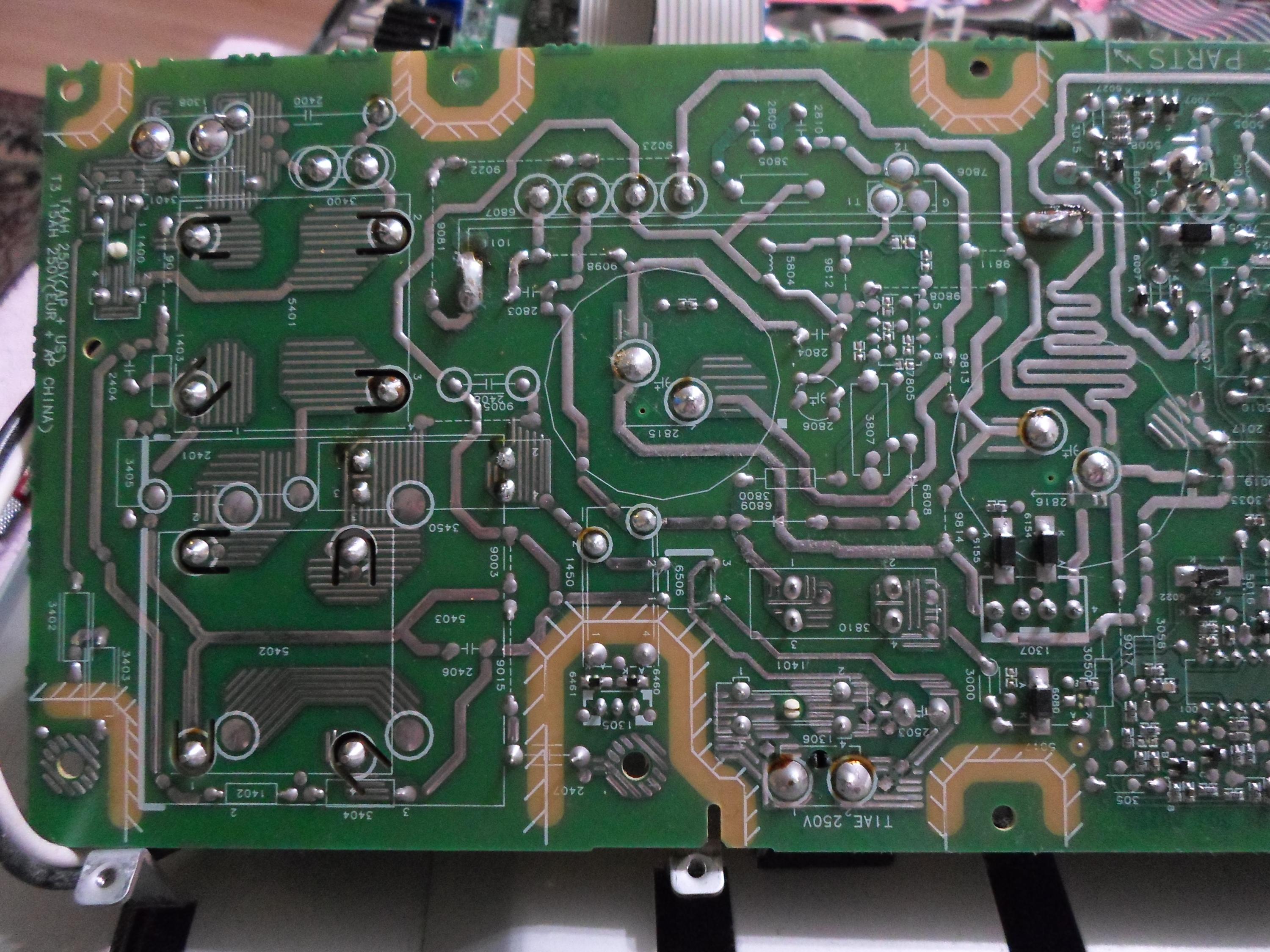

                                    I found 6506, which is a 4 pin IC, pins 1 and 2 which are the AC pins have 120V, the DC pins 3 and 4 have 159V.
                                      Well, this doesn't make sense: you've got 160V across the cap, 70V after the fuse, and yet the fuse has 0V drop. Are you using cold ground or hot ground for your ground point? Pin 2 of 1306 is your hot ground.

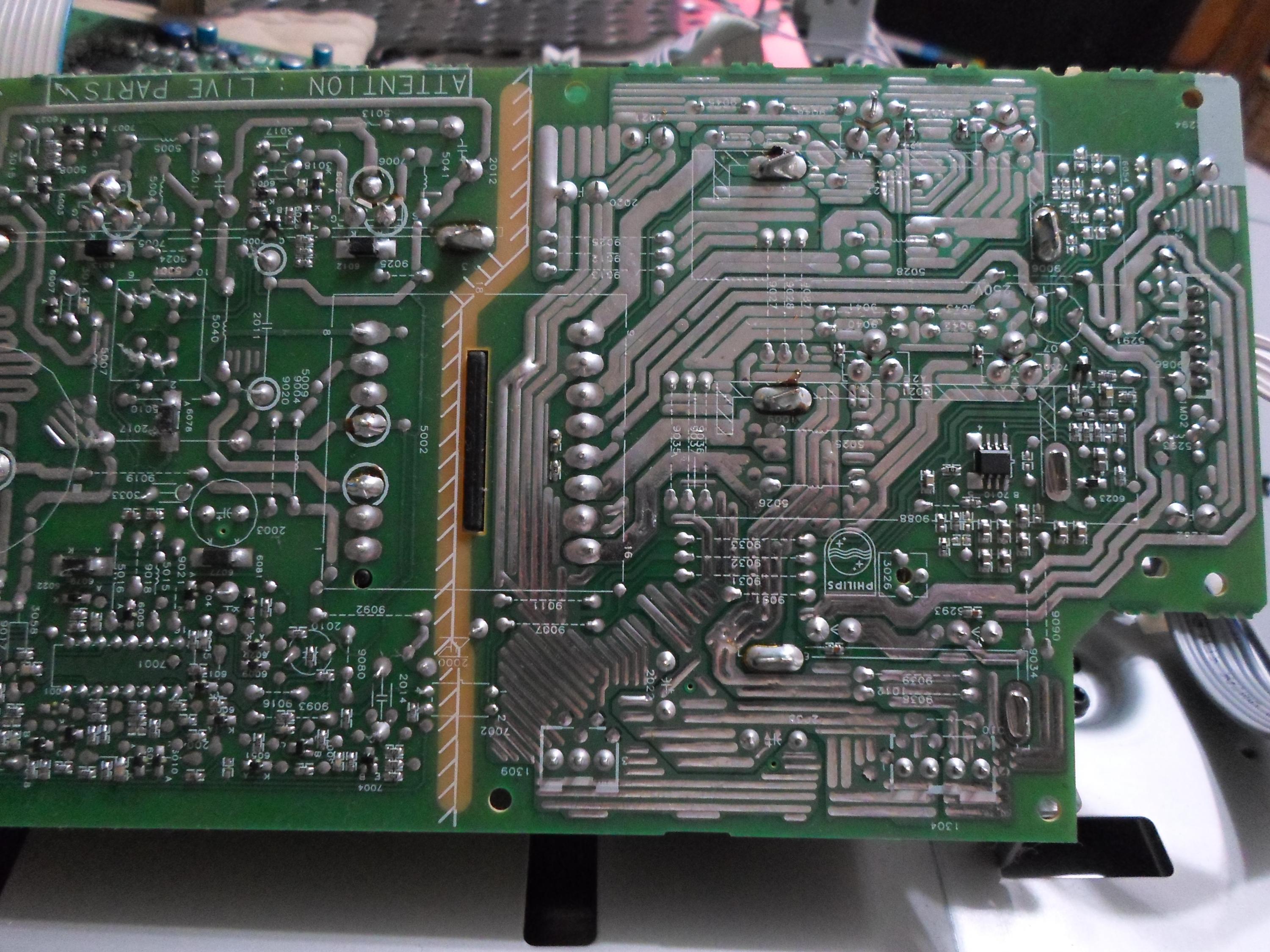

                                        It would make sense if it is a bad solder joint...
