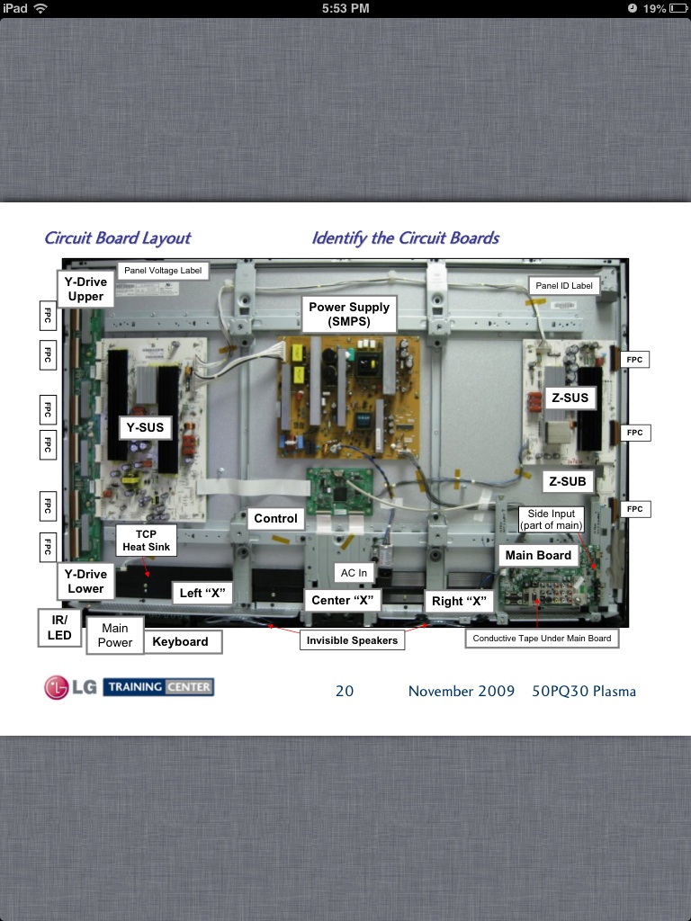

    I kno I've seen a few threads on here but I just wanted first hand feed back from the experts or anyone who also encountered this problem. First off I bought this tv used with this existing problem the screen when tv is on shows a darker than usual picture then there is some type of rainbow inverted effect, don't know if that would describe it. I have a video I just put up on YouTube so you guys can see what I'm talking about.... Im thinking its the y-sus then I think it's the z-sus, not really sure because I'm no expert. I've fixed some lcd tvs that's why I bought this cheap thinking I can fix it.... Please help people... Here is the link to the YouTube video
    http://m.youtube.com/watch?v=NKupTBP9WWg
    Also when I first got the tv there was a lot of moving red dots on the screen so I opened up the back and tweaked with those Philips head knobs and that reduced them a little bit

    It is likely control board or main board, not y-sus/z-sus fault.

      Check the caps in the power supply, also the decoupler caps around the regulators on the main video board. A can of freeze spray may help.

        Thanks tom66, so it's likely the control board or the main board, any idea which one would most likely be the culprit? tvbob thanks for your input but am not that advanced in repair usually I just buy and replace a board if I know it's defective.. I took some pictures of the control board and of the main board the main board looks like sum of the plastic on there was melting due to heat not sure if it might be the culprit any more input is well appreciated!

          There are two points marked EXT AUTO GEN on most LG plasma control boards. Unplug the LVDS cable between the main and control boards and jumper EXT AUTO GEN with a piece of wire. When the TV is turned on test patterns should appear. There should be some smooth gradients there, if there are then post a picture so we can see what they look like.

            Ok I did that and made a video of it..
            Here's the video
            http://m.youtube.com/watch?v=KOqGm_z0eLs
              Re: LG PLASMA 50PQ30 rainbow effect + dark screen
              Your control board is the fault then, as the gradients should appear smooth but they do not.

                    OK I replaced the logic board but still no difference. Also tried the self test mode using the EXT AUTO GEN on the control board and the gradient still looked the same as before.

                        That's strange. Did you match the logic board panel model to the sticker? (e.g. panel shows PDP50T1#####, install a logic board from a 50T1 panel.)

                          To tell you the truth to picture got a tiny bit better but the posterization is still there along with the darker than usual display. Yea I matched it up to the sticker.

                                  I'm not certain. In the EXT AUTO GEN tests, the main board was completely disconnected, except for power? Therefore, the only problem can be on the control board or driver boards. A driver board failure should only lead to regional faults though (i.e. half or a 2-3 inch portion of the screen.) Can you try reseating all the cables going from the control board to the bottom of the plasma panel?

                                    Correct, it was disconnected except for the power. I took all cables off periodically b4 a few times and still had the same problem. Would the control or the main board also affect the darkness issue? There is also another issue I didn't mention, when the tv is first powered on I get like a blue flash that's bright then it fades away real quick, don't know if that would help diagnose the issue!
                                      I think the blue flash is normal on these panels, it is due to how the screen is initialised. Some panels, like ones from Panasonic, manage to make this nearly invisible. But it's not really a big deal at all.
                                      I am beginning to suspect your new control board is bad or that there is some consistent connection problem near it.
