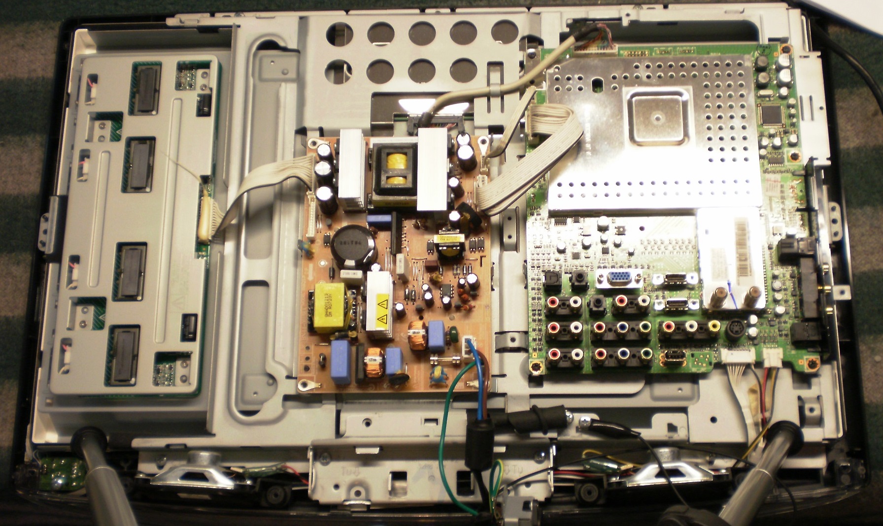

    I have picked up this small TV which won't turn on.
    The LED is on, which means that there is a STBY voltage.
    If I keep pressing a couple of times the touch buttons, eventually the LED will turn off and the Samsung logo will blink a bit, but nothing happens with the screen.Then the LED will turn back on.
    I have opened it up, no obvious bulging capacitors.
    It's very familiar power supply, I think it's very similar to the 245 or 226, not sure which one.
    It has those three 76 OHm resistors next to each other it has the F9222L chip.
    Some of the voltages are missing.
    I don't have the 24V, 9V and 12V.
    The PS-ON is high, at 4.12V, 5.3V is there and the STBY 5V as well.
    387V is there as well.
    I'm not sure what should I be doing next, replace all the capacitors?

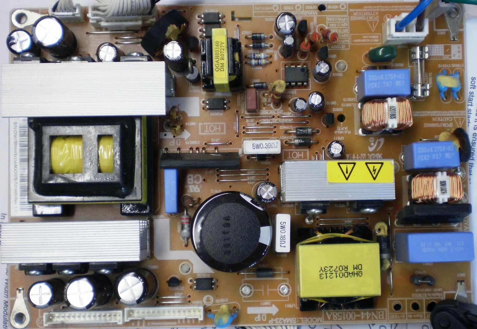

                        Re: Samsung LN-T2353H won't turn on
                        Diodes check out OK, at least the three pin ones.
                        It must be something common to all the voltages and that has to be in the primary side. I may have noticed something.
                        Check out the circled parts, the resistor has a blown side and the blue capacitor shows 0.9 Ohm.
                        These two components feed the transformer.
                        If I remember, one of these 245 or 226 monitors suffered of some 18 nF capacitor no?
                          If the cap shorted it's quite understandable for that resistor to open. It is quite/very rare for those caps to fail short though.
                          Unfortunately, I don't (yet?) have a schematic of this PSU... but Elektrotanya looks to have one.
                          • tibimakai
                            • Jan 2012
                            • 3680
                            Tom, what do you think about the IC, it could be damaged too?
                              I believe that is the fusible resistor for the B+ for feeding the switching power supply section of that big power transformer..
                              • tibimakai
                                • Jan 2012
                                • 3680
                                These bad components are 0.22 Ohm 1W fusible resistor and the capacitor is 0.018 uf/630V capacitor?
                                I had some 0.1 Ohm/2W resistors and put them in series and I had a 0.018uf capacitor and I gave it a try.
                                I haven't measured anything, but at least one of the resistors blew up.
                                  The cap is actually shorted out? The cap is part of the Bridge drive circuit for that transformer,it is for the DC blocking. The FLAT PACK MOSFET module may be shorted out, you can check the resistance between S and D pins.
                                  Remove the cap and check the resistance on those two pad of the removed cap, more likely that it will still show shorted circuit.
                                  Check the resistance between PIN 23 and PIN 19 (MOSFET 2), PIN 19 and PIN 4 (MOSFET 1) of that Flat pack module for short.
                                  • tibimakai
                                    • Jan 2012
                                    • 3680
                                    I have tested in circuit only and it showed 0.9 Ohm.
                                    The resistors that I have soldered in in series were fusibles also.
                                    Most likely the F9222L has a short if it blew the resistor. I may still have one of these ICs from a previous repair.
                                    I will check it out tomorrow.
                                    Bud if I understand the codes, I need a 0.22 OHM 1W fusible resister and a 0.018 UF/630 V capacitor, right?
                                    I wold like to place a Digikey order for these parts and that MUR360 diode.
                                      Yes. I doubt that the cap shorted out, very rare for it to happen, if it is bad, get higher voltage rating if you can.
                                      • tibimakai
                                        • Jan 2012
                                        • 3680
                                        You were right about everything, as usual.
                                        F9222L shorted, cap it was good(at the pads was showing 0.2 Ohm with cap removed).
                                        I have replaced the IC and put back the original cap and waiting for the resistor to arrive on Monday.
