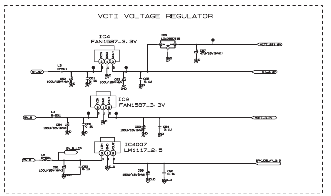

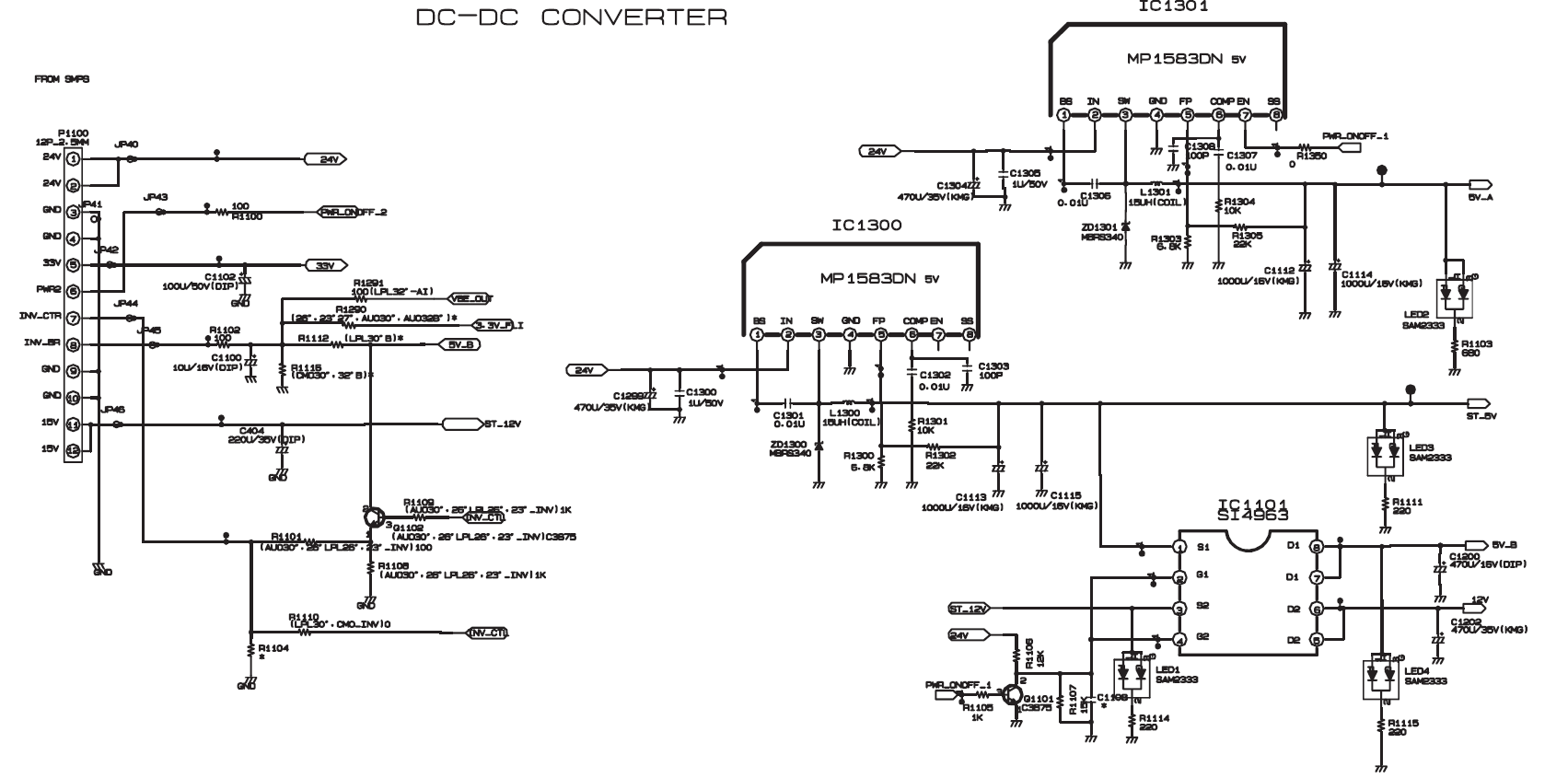

                    there is another problem now. it won`t come out of standby. the voltages from psu are okay i think. I measured some voltages on mainboard : VCTI_ST_1.8 , ST-5v , st-3.3v are there. I am not sure this are all the voltages i should have. The rest are generated when turning tv on?
                    i made some screenshots from the service manual
                    dc-dc converter
                    i have st_5v so ic1300 is working. ic1301 and ic1101 are 'turned on' after the pwr_onoff_1 signal comes, right? I measured the pwr_onoff_1 signal and it's not coming

                    i measured vcti_st1-1.8v and st-3.3v , ic2 and ic4007 no voltages at IN pin, the 5v_b is switched by ic1101 (FET). but this fet is not driven i think (only when onoff singal comes)
