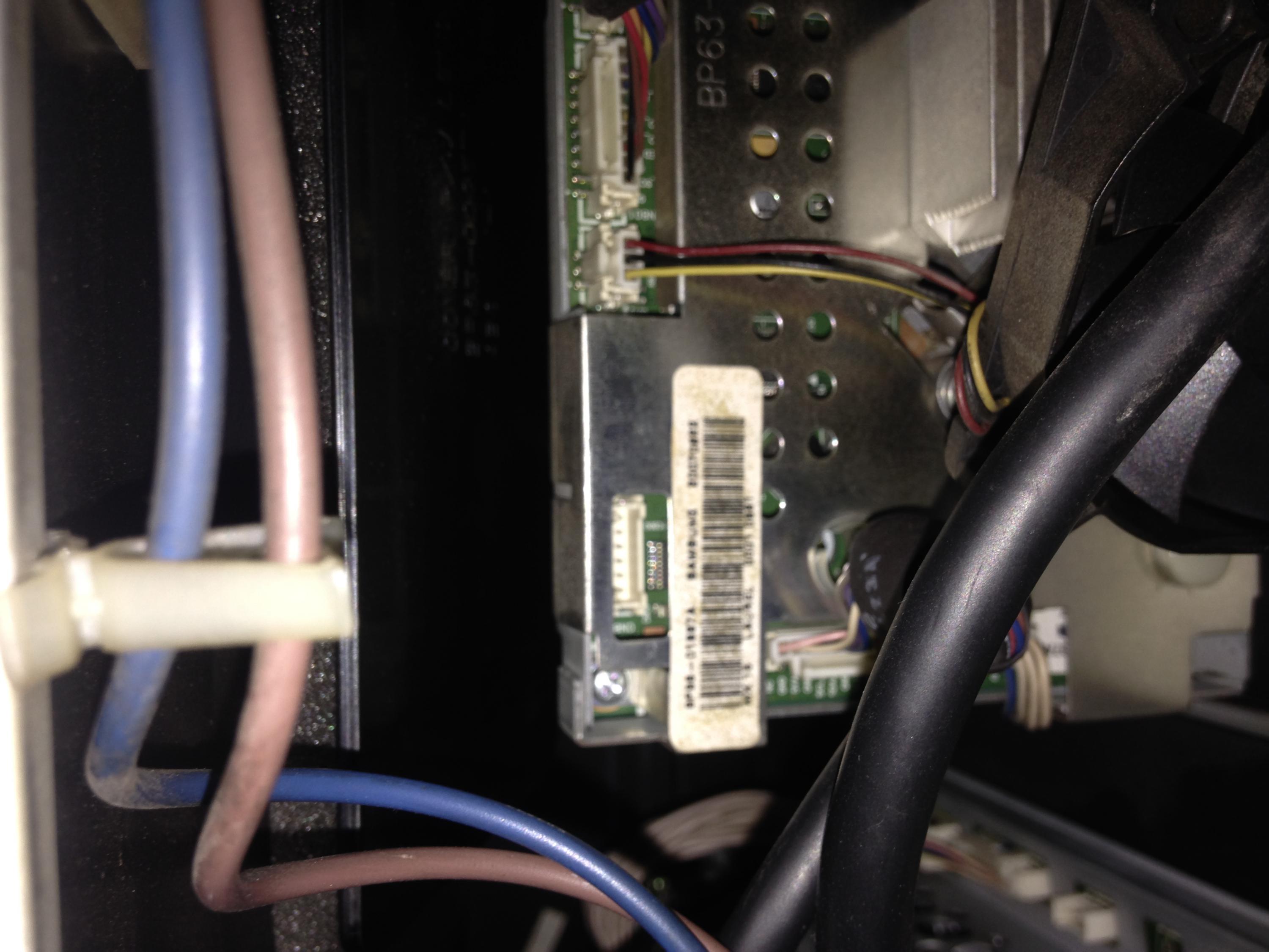

    Also this is my first pictures and all those puffy caps have been replaced. Both psbs. It was taking longer and longer to start up so just left it on til it shut self off. Now wont come on unless apply heat.

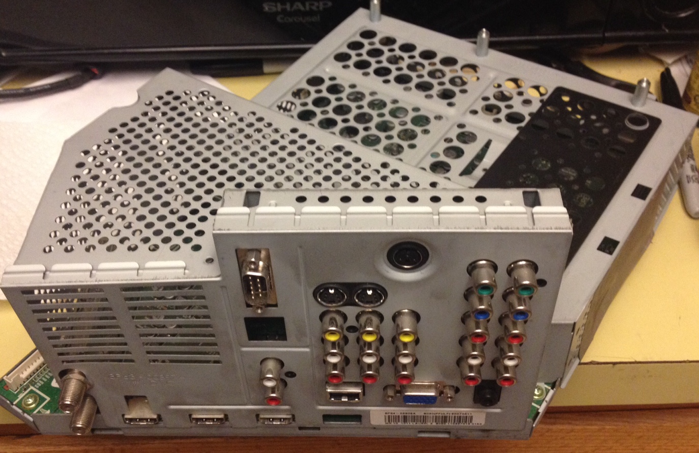

          Re: hacking Dlp hlt6187s Motherboard bypass or fix
          I can tell you right now, you have puffy capacitors in your sub LED pws.
          These pics are of the HLT5689SAX board.
            looks the same. That is pics from couple years ago before I replaced caps

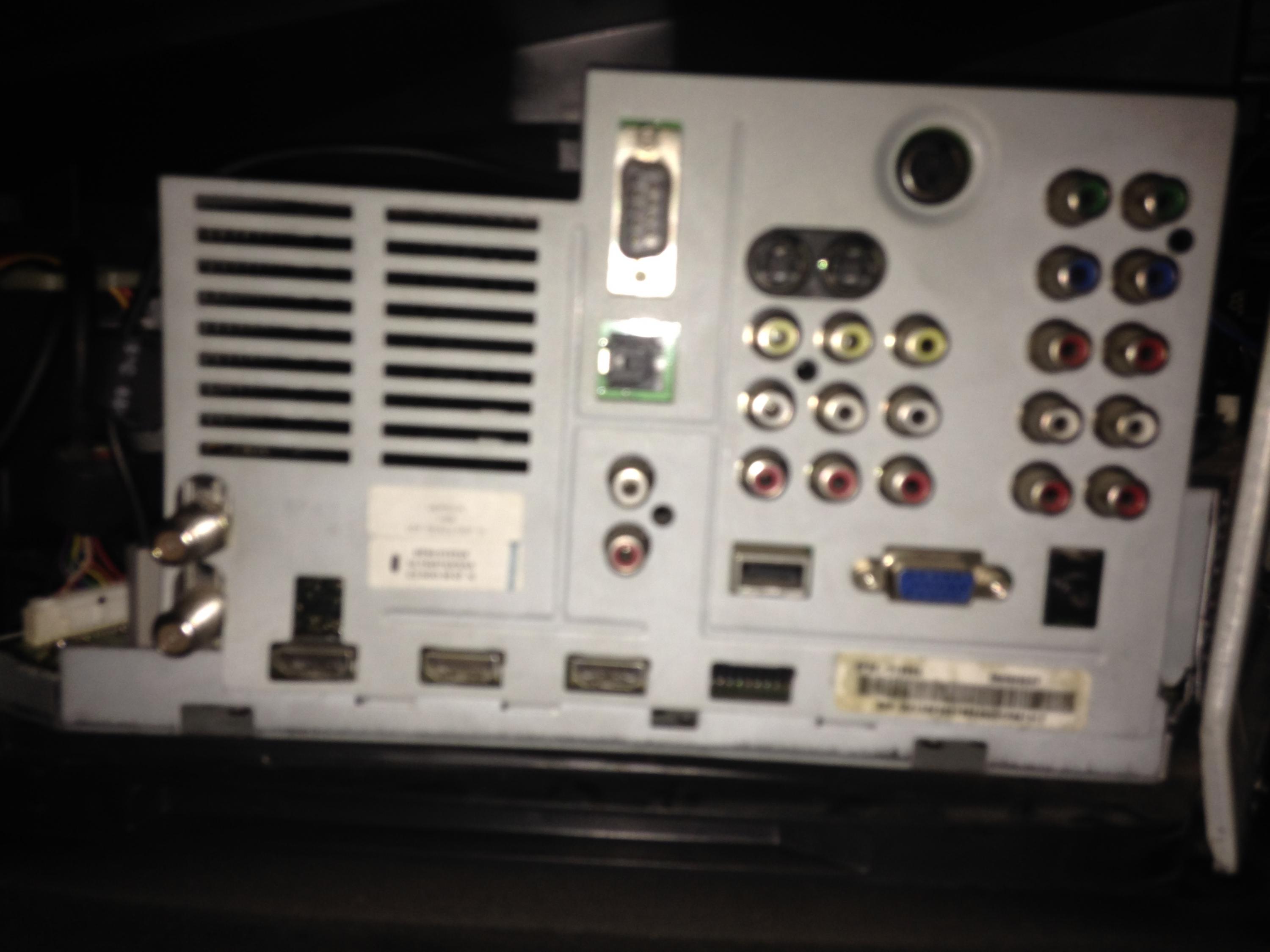

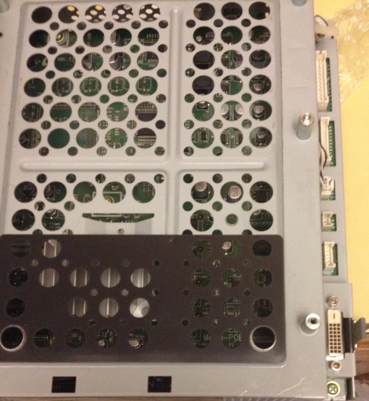

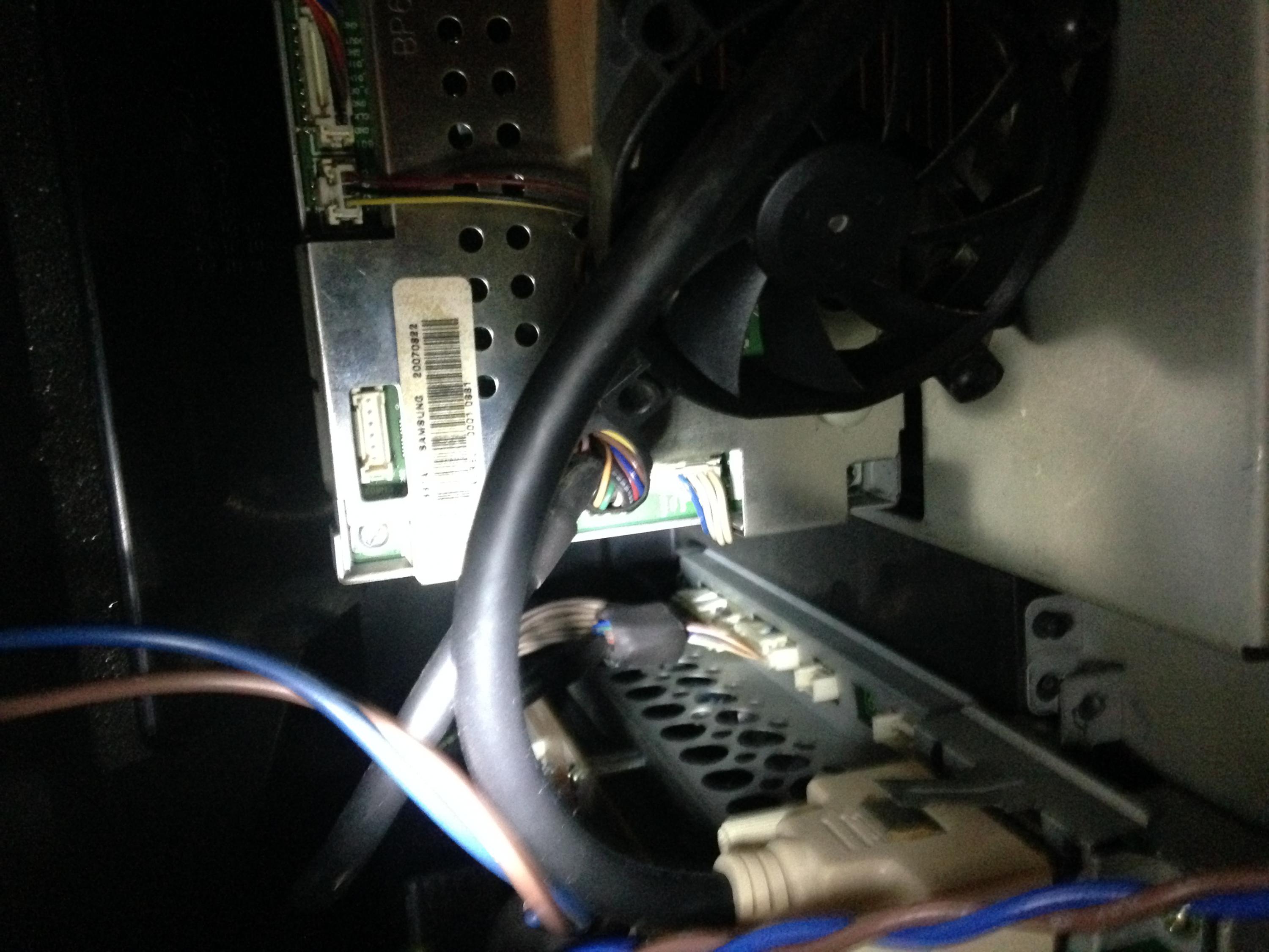

                  As u can see I do not have the two smaller connections on side where DVI cable goes that your board has. Don't have the brown and white wire with plug either. This is only thing I can see different Where does that brown and white wire go?
                    This is the one im talking about
