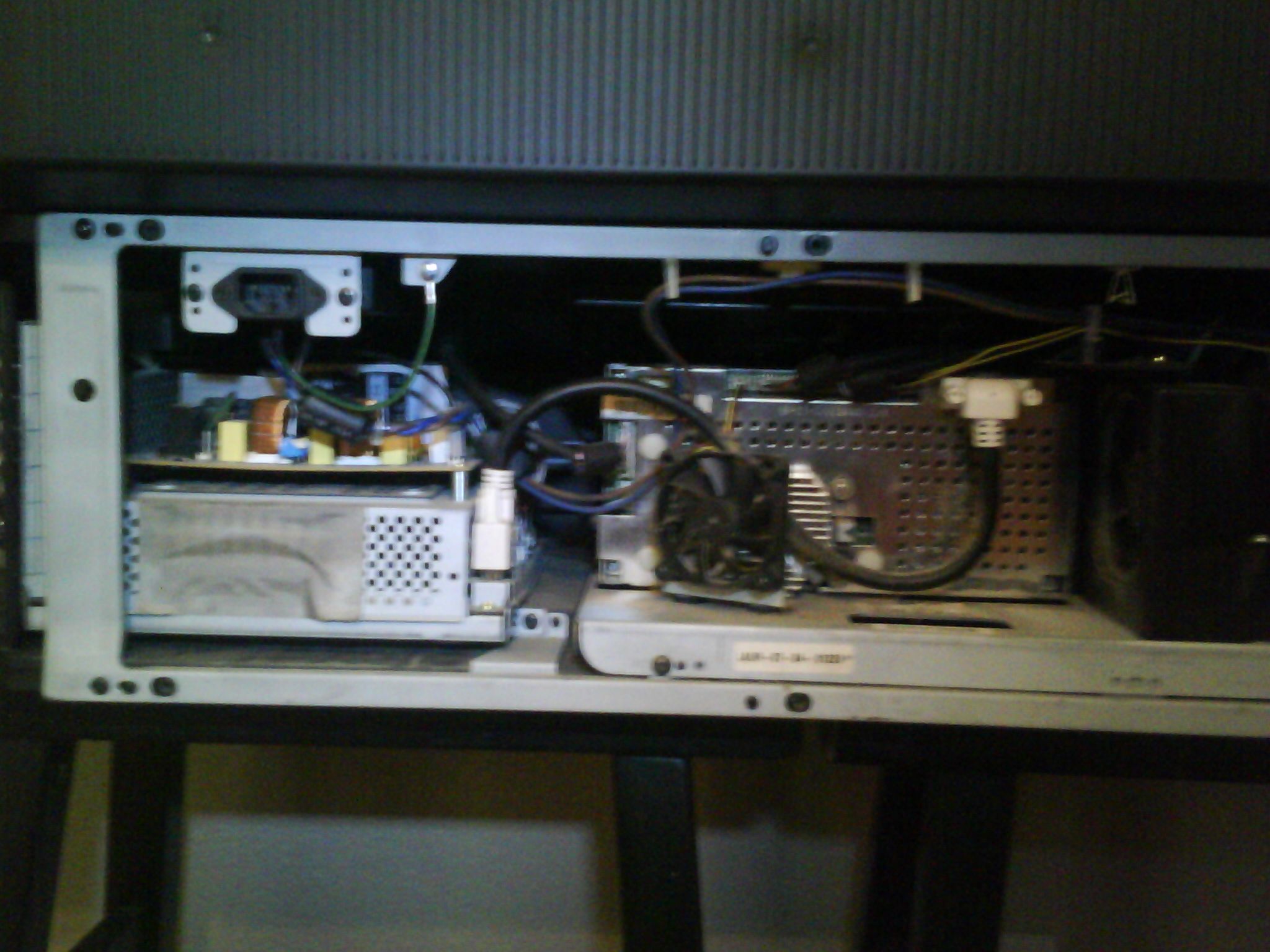

                            Re: hacking Dlp hlt6187s Motherboard bypass or fix
                            will the ribbon cable plug into the dmd board from the c board? I also have a HLT6187sx. There are more parts for HL61A750 & HL67A750. This model is almost identical to the HLT6187sx. HL only has one coax connection, fan for board, and ribbon cable to DMD. HLT has two coax connections, no fan on main board, and regular DVI cable going to DMD. HLT also has more components on main board but I think its just cause it has analog and HL is only Digital. The plug connections on main board are in different locations but I think the same otherwise. Im wondering if I order the c board if it would work if could get it connected to DMD?
                            • stanman2242
                              • Dec 2015
                              • 9
                              • US
                              If you have the HLT5087SX it uses a DVI type cable to DMD board.
                              The HLT5087SAX uses the flat ribbon cable.
                              Even though the SAX uses the ribbon cable it will not interchange with the HL61A750 & HL67A750 parts.
                              The HLT5089SX main board is interchangeable with the HLT5087SX board, the 89SX just
                              has some advanced features on menu.
                              I have a HLT5689SX (BP94-02308A) board.
                              Yes my house is full of samsung parts
                              Yes I live alone

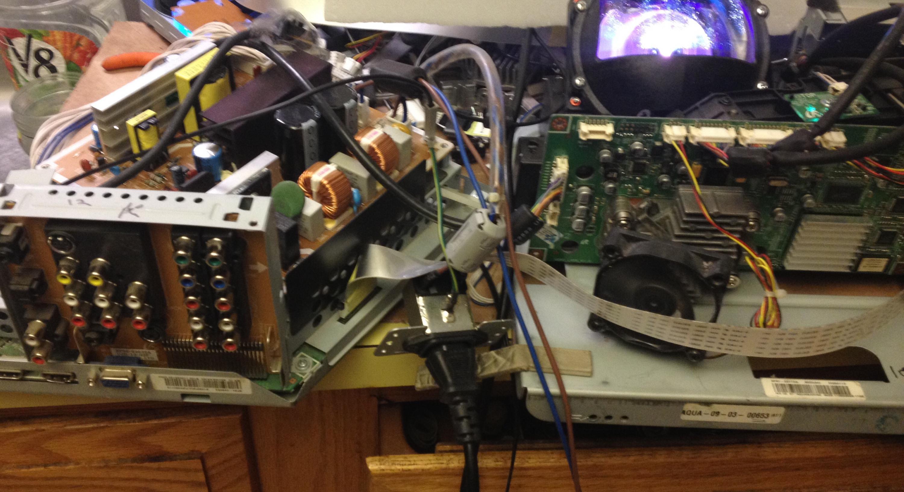

                                  Originally posted by MEM1971
                                  I have the HLT6187sx and was hoping I could use the HL61A750 main board but noticed it has ribbon cable and I have DVI.
                                  Well, just to put an end once and for all to all the people wondering,
                                  I put together a HLTxx87/SAX light engine to see if a HL61A750
                                  main board would work with it The first problem is the location of the connector for the ribbon cable on the DMD board is on the left side of the
                                  HL61A750 and on the right side of the HLTxx87/SAX DMD.
                                  It is close to the DMD on the HLTxx87/SAX main board and farther away on the HL61A750.
                                  The end result is the cable is a good 5" too short.
                                  There is no "stock" ribbon cable long enough to work.
                                  I tested it on the bench and had to turn the main board around at a right angle so the cable worked and it worked fine.
                                  So to sum it up, yes it works but you would have to find a longer cable.
                                  As far as the SX in no way would it ever work.
                                  The only substitute is the HLTxx89/SX main board BP94-02308A.
                                  Yes I live alone
                                      Idk why Samsung made the numbers on theses models confusing. Which one is in the picture? Is HL61A750 closer to the HLT6187SX , which is what I have with no fan blowing on main board, or the HLT6187SAX? When I say confusing I know the main psb and led psb are the same. Sounds like you are saying the SAX models are different than SX. When I type in my model number searching in manual and only find the HL61A750. After reading this again it looks like the HL61A750 and the HLT6187SAX are the same main boards with ribbon cable. I have The HLT6187SX with DVI cable and main board number BP96-01833A which I can not find at reasonable price. I can buy the whole cage with mainboard and main psb out of a HL61A750 than just the main board but itself out of the HLT6187SX. IM sorry I may be the one confused but are you saying the SX models will work in the HL or only the SAX.
                                      What I have in the picture is a HLT5687/SAX light engine with a HL61A750
                                      main board.
                                      I just put it together to see if the basic signal from the main board work or
                                      if the picture would be a mess.
                                      The SX has the DVI type cable and in no way would work with the 750 stuff.
                                      How much were you trying to get a main board for?
                                      I do have the HLT5689SX main board which would work with your stuff.
                                      Yes I live alone

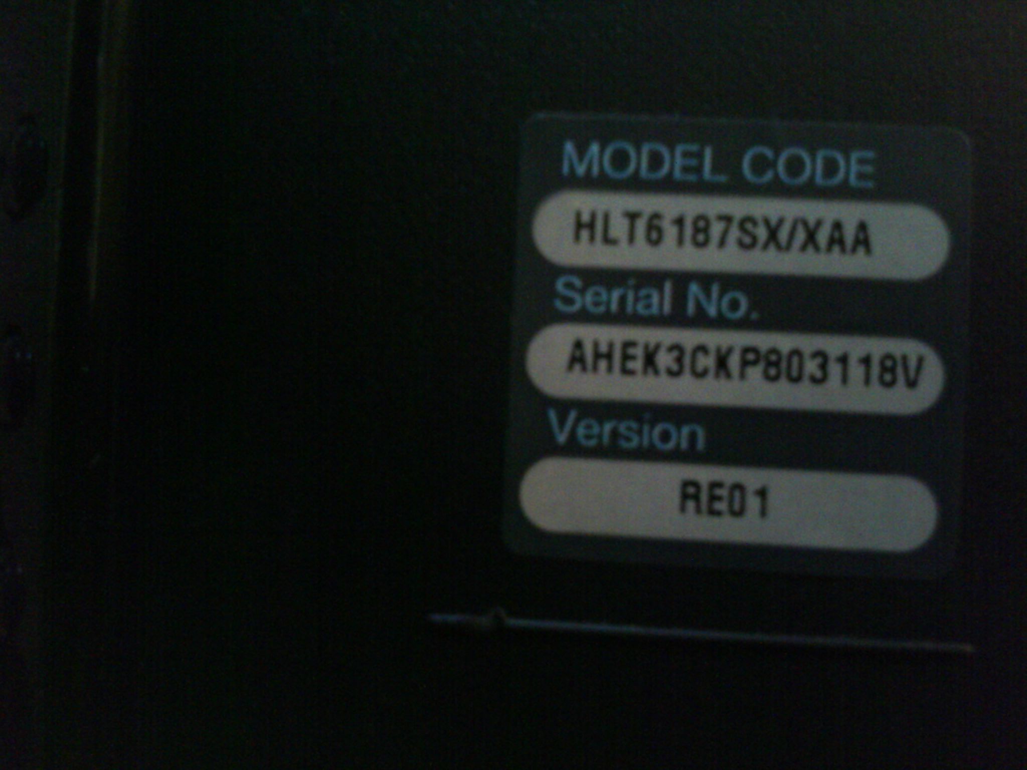

                                        This is my HLT6187SX. Will the main board you have work in this one and how much do u want?
