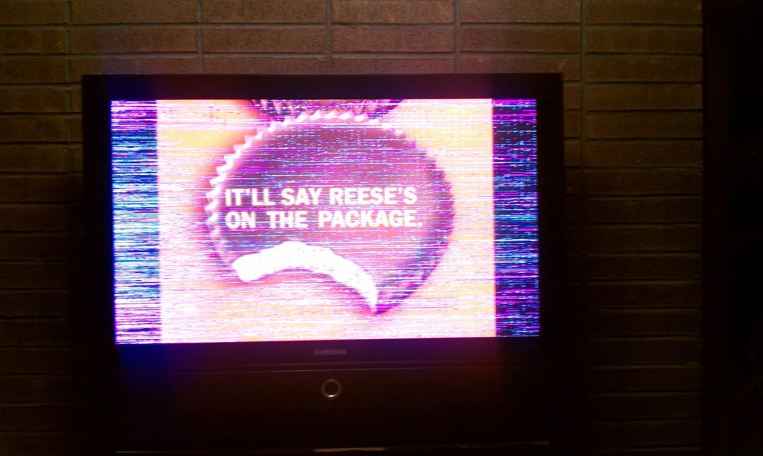

        This is not my tv but this is very similar to what happens my screen,this is what I called the
        plasma squares.When this is on my tv the tv will not respond to the remote
        control or buttons on the tv itself.But if I unplug the tv from the mains and replug back to mains while
        the tv is like that picture then the tv will be perfect again with no issues at all.
          Re: 50 inch lg plasma issue
          This would appear to be a main board fault.
            Thanks tom but the tv starts up perfect in the morning and after a few moments the screen
            goes black and stays black for another while then that pinky screen comes on
            and then the tv wont respond to remote or the tv buttons
            and then by unplugging the mains and replugging the tv is perfect again???
            Once the tv has been unplugged and replugged after the pinky screen stage,then the tv can be turned on and off
            as many times as I like with no issues.
            While the tv is in the black screen stage there is a couple of very thin horizontal white lines flickering
            at the very top of the screen and the remote works with this black screen.
            Remote will only not work when the tv is in the pinky screen stage.
              The lack of ability to control the TV with a moving image tells me it is most likely a main board fault. There's a small chance the PSU is faulty -- bad capacitors may cause this -- but the symptoms don't quite match.
