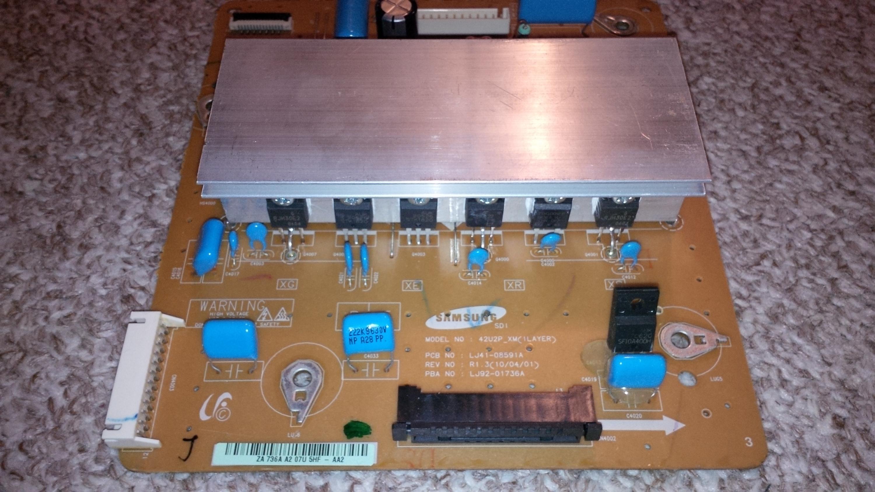

                          Does you version of X-main have a large heatsink (almost as big as the board itself) with 6 devices bolted to it, or is it a smaller heatsink with just 2 devices?
                          • sergio2013
                            • Mar 2013
                            • 97
                            #53
                            Re: Samsung PN42C430 Plasma no picture please HELP
                            Its a big heatsink with 6 mosfets to it, I attached a picture.
                              #54
                              I happen to recently have sold this board -- bummer -- could have tested it and compared it.
                              Anyhow, two transistors (3 leg devices) are IGBTs, the other two are FETs, you just need to test between each combination of pins (1-2, 2-3 and 1-3) both ways for shorts. Post your results along with the device name. The two lead devices (diodes) only need a test both ways, 1-2 and 2-1.

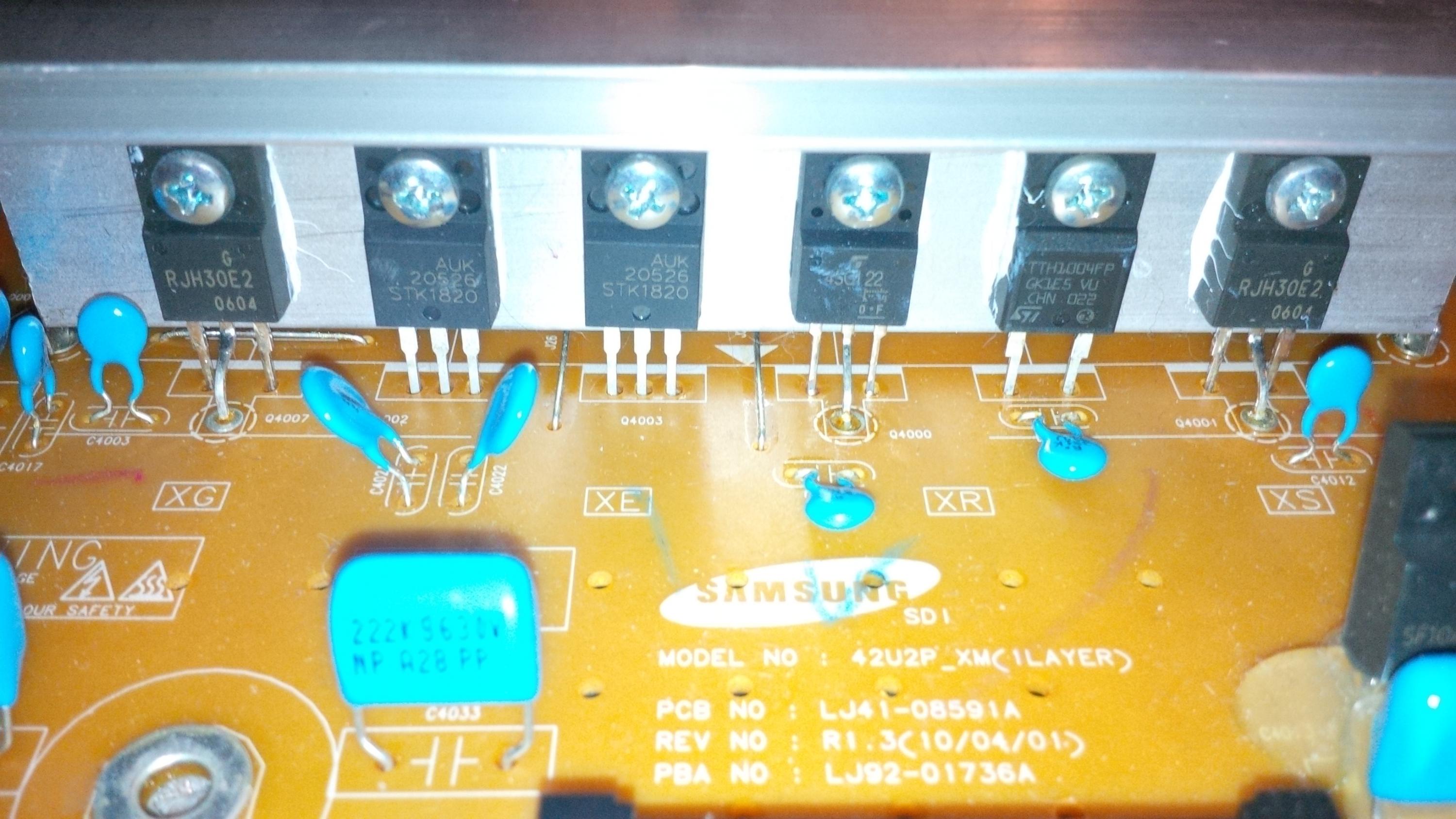

                                I'm still confused how to test them, so I have included 2 clear pictures so its easier for you to explain, I even uploaded a picture of my meter because I don't know where to set it at for testing these?
                                  #56
                                  Your meter needs to be set to DIODE mode.
                                  Number the pins in your head 1-3 for the three legged ones, and 1-2 for the two legged ones. Start from left, going to right as in your photo.
                                  For the three legged ones: Place your meter's red probe on pin 1, black probe on pin 2. Record reading. Move to 2-3. Record reading. Move to 1-3. Record reading. Swap probes, black on pin 1, red on pin 2. Record reading. And repeat the previous tests so all combinations are handled.
                                  For the two legged one: Place your meter's red probe on pin 1, black probe on pin 2. Record reading. Swap the probes around. Record reading.
                                  Post the results, along with the lettering on the device, and the part designator (Q993, D238, etc.)

                                    First 3 leg device
                                    First device is always 0 with continuous beep on all test positions
                                    Second 3 leg Device
                                    red pin 1 with black on pin 2 = 1.901
                                    red pin 2 with black on pin 3 = just says OL
                                    red on pin 1 black on pin 3 = 1.681
                                    black on pin 1 red on pin 2 = OL
                                    black on pin 2 red on pin 3 = 0.543
                                    black on pin 1 and red on pin 3 = 0.786
                                    3rd Device 3 legs
                                    red on pin 1 black on pin 2 = 1.901
                                    red on pin 2 black on pin 3 = OL
                                    black on pin 2 red on pin 3 = 0.542
                                    black on pin 1 red on pin 3 = 0.785
                                    4th Device 3 legs
                                    red on pin 1 black on pin 2 = 1.961
                                    red on pin 2 black on pin 3 = 0.441
                                    red on pin 1 black on pin 3 = 1.615
                                    black on pin 1 red on pin 2 = 1.005
                                    black on pin 2 red on pin 3 = 0.427
                                    black on pin 1 and red on pin 3 = 0.585
                                    5th device 2 legs
                                    red on pin 1 black on pin 2 = 0.442
                                    black on pin 1 red on pin 2 = 0.426
                                    6th device 3 legs
                                    red on pin 1 black on pin 2 = 0.031 with constant beeping
                                    red on pin 2 black on pin 3 = 0 with constant beeping
                                    red on pin 1 black on pin 3 = 0.031 with constant beeping
                                    black on pin 1 red on pin 2 = 0.031 with constant beeping
                                    black on pin 2 red on pin 3 = 0 with constant beeping
                                    black on pin 1 red on pin 3 = 0.031 with constant beeping

                                      Are they faulty?
                                      • 1997eclipsegst
                                        • Feb 2013
                                        • 99
                                        • US
                                        #59
                                        It looks like these are shorted
                                        Q4007 - RJH30E2
                                        Q4001 - RJH30E2
                                        It is common problem with these boards. I have 3 of these boards with the same 2 on each shorted as well.
                                        Another way to test this board to see if it is shorted is to take a meter on diode setting and put one lead on VS and the other on ground in the main power plug. If it beeps it is shorted.
