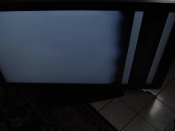

    Found this TV with this screen issue.
    What do you guys think it's worth picking up?
    I see that dark area, which I know that it's a tab issue, but how about those two white strips?
    Re: Samsung 46A530P1FXZA possible purchase
    It's probably a bad panel, and not tab bonds. Seeing an increasing number of these with the tabs actually burning themselves.
