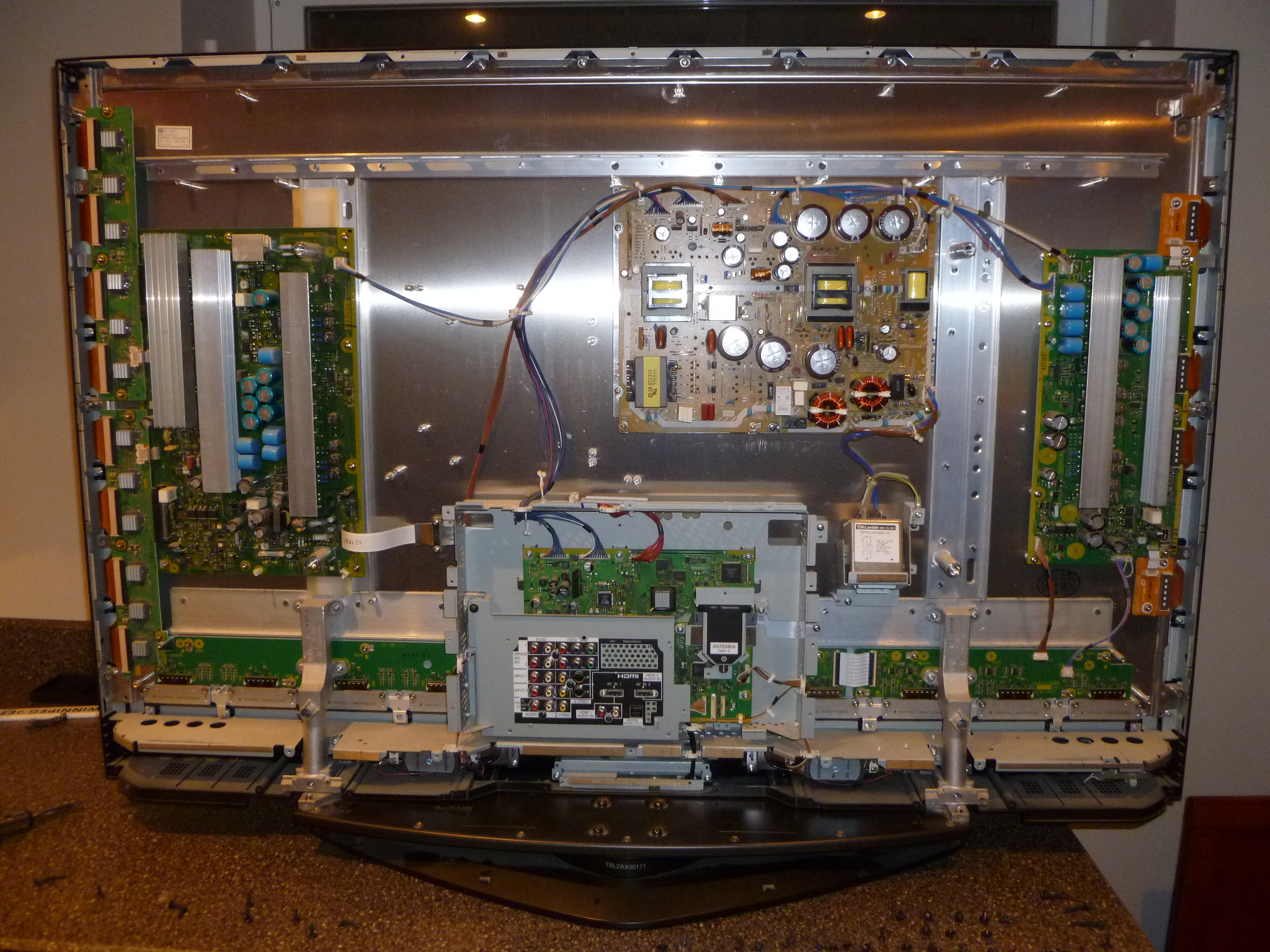

    Hello all,
    I was hoping to get some input as to what might be wrong with my plasma TV.
    So a few days ago I turned the TV on immediately noticed that the top half of the screen was blank. I turned the TV off and back on, same thing - top half blank.
    I unplugged the TV for a full 24 hours or so and tried it again. The screen was back to normal - full picture.
    Last night I turned the TV on again and now the top half of the screen is flickering - (pro-dominantly blank screen with the top portion of the screen flickering in and out).
    The red LED power light on the front of the TV doesn't flash at all. Its solid red.
    Any ways if anyone has any ideas that would be great. Obviously I don't want to spend a bunch of $ on a 720p TV that is approaching 6 years old.
    Thanks in advance.
    Brad.

      Will do that.
      How many pictures of the back will you need? Just one or will you need close ups in each corner of the unit?
      If the problem is with the upper portion of the screen does that automatically mean that the possible connector issue is with the SU Board?

        Re: Display issue with 50" Panasonic Plasma TH-50PX75U - issues with top half of scre
        SU is where I would focus. This is one of the boards on the left-hand side, when looking from the back of the set. Pictures of that and of the overall layout would be useful.
          Bump for pictures update.
          Thanks again for any assistance.
          Couple questions. Do I have to leave the TV unplugged for any time frame before touching those ribbon cables in side? Also if I adjust the cables, can I turn the TV on without the back cover on?
          Brad.

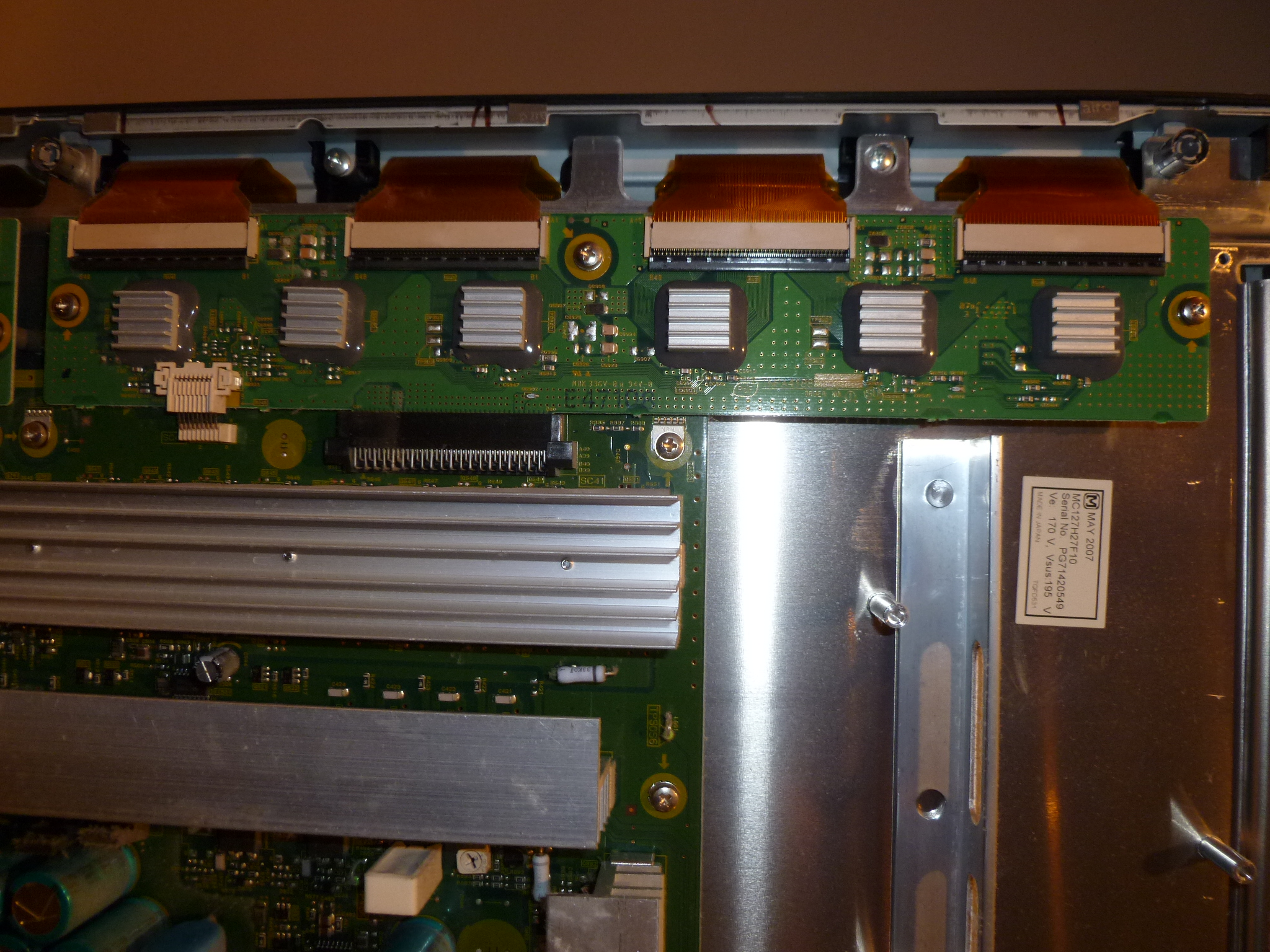

            I would get an insulated screwdriver and press down (insulated end) on the lefthand white connector which goes from the SC to the SU board.
            https://www.badcaps.net/forum/attach...2&d=1363316484
            The ribbons themselves are probably OK.
                Well, one missing ribbon would cause just one part that it controls to go out.
                Try unplugging the connector and plugging it in again (do this with power off.)
                Also try looking at the right hand side: the Z-electrode, which connects to the SS board.
