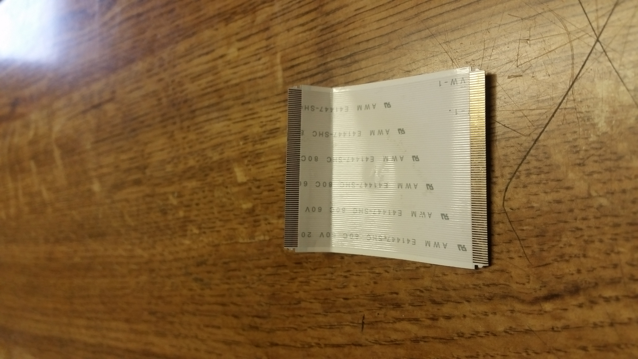

    will the numbers off of it help at all ?
      Re: Sanyo DP50749 Plasma No picture
      one inch three sixteenths wide 1"3/16"
      one inch nine sixteenths long 1"9/16
      my wife is gonna have to count them when she gets home
        I counted 56
              much better picture

                  Agreed. The chip on film technology incorporated into plasmas for the vertical gate drivers are very finicky and you could easily short them out
                  Did you get the message I sent you ? with the picture of the ribbon ?
                  You were right when you said it will be hard to find
                  55 pin 1.316". x 1.516"

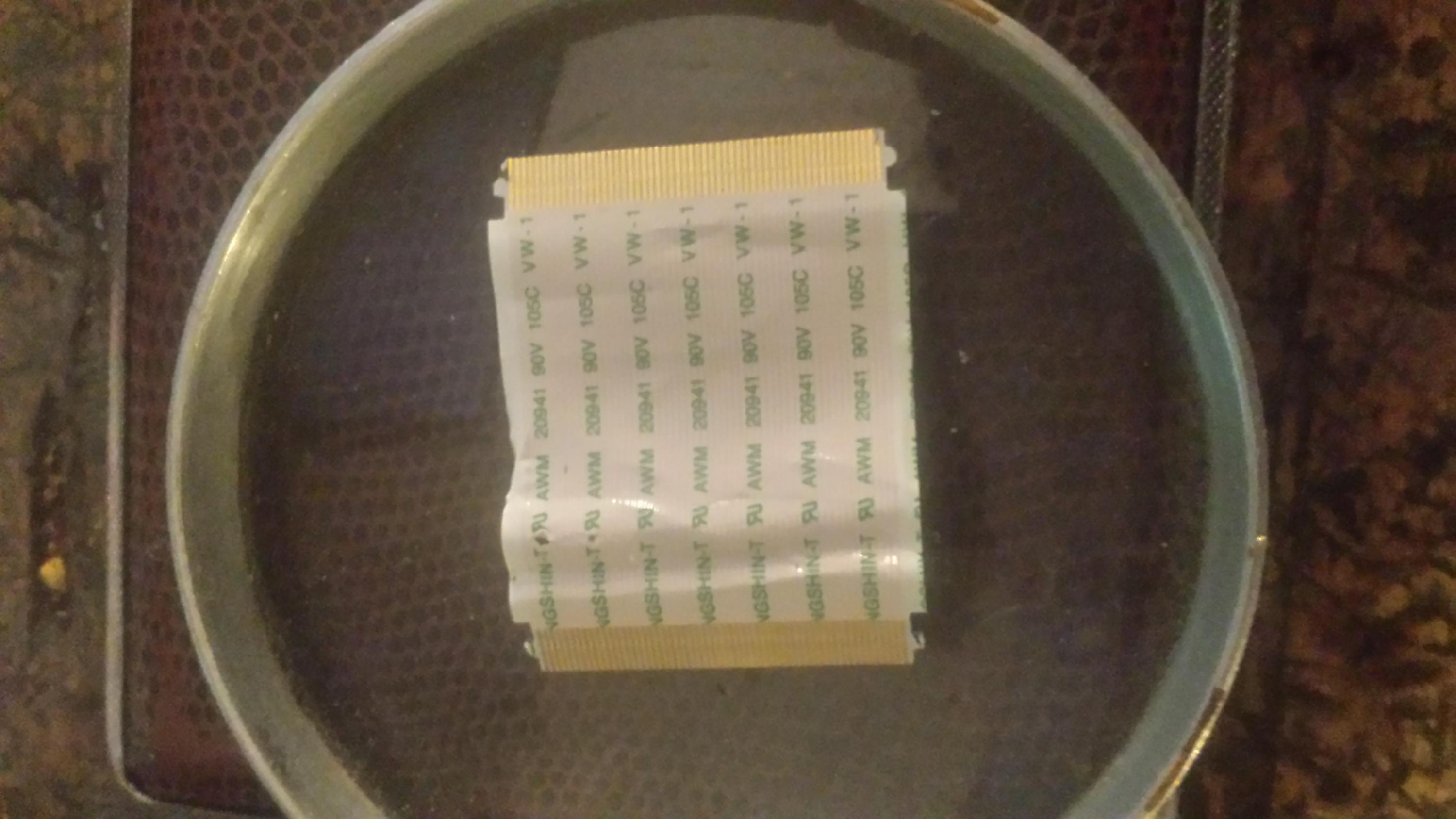

                    Here's the one I have. Hope it could work
                      #30
                      Wow thanks man, but i don't think it will bro I stopped counting at 65 pins and still had a ΒΌ of it to go.
                      Thanks for the valiant effort my friend!
                      Greatly appreciated
                      ~Rick

                          #32
                          80 pin
                            #33
                            Crap! I'm sorry. Think I grabbed the wrong one. I'll look again
