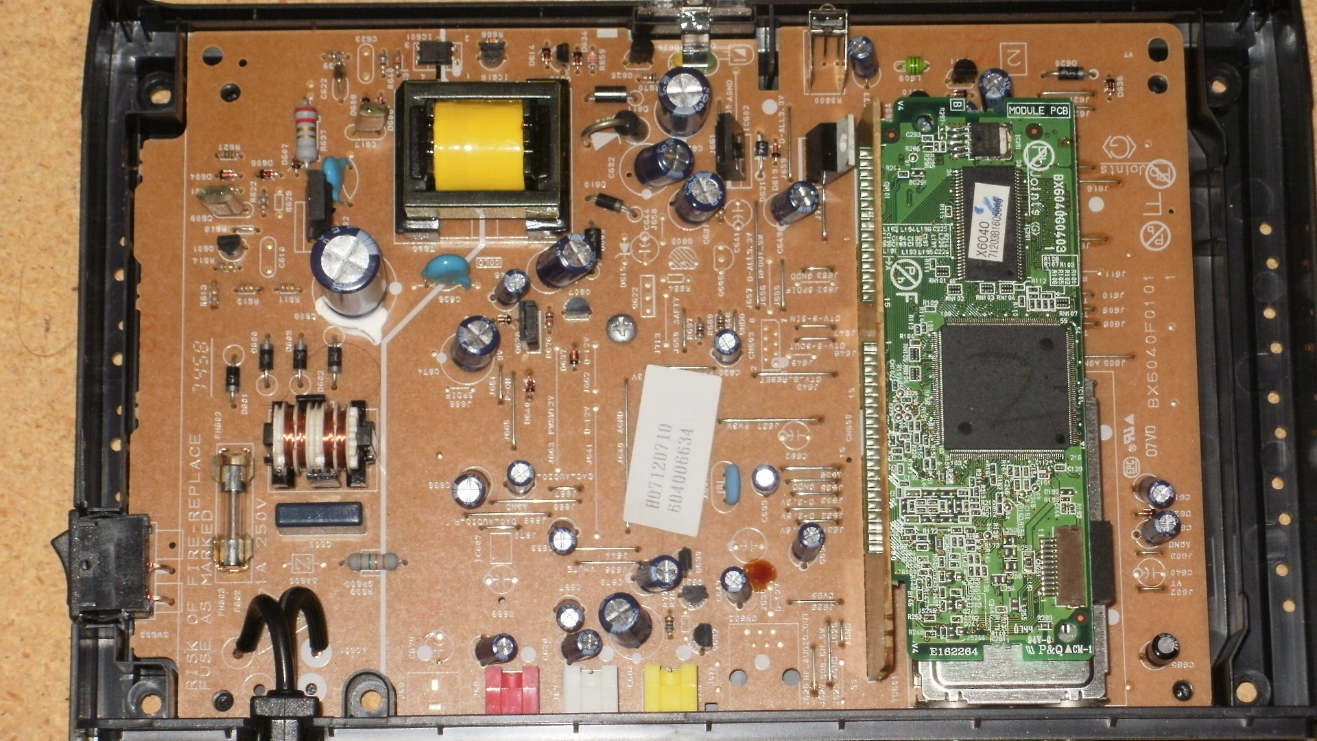

    Hi all:
    DTV converter is a Magnavox TB100MW9, manufactured by Funai.
    It got very light use for about two years, and then it started powering off by itself.
    This appears to be a common problem, as I've seen posts in other forums, but no solutions offered.
    Typically, one would first suspect the power supply, but there is none.
    110v leads are soldered directly to the board.
    I visually examined all caps; there are no apparent signs of failure.
    So my question is:
    Has anyone else encountered this problem, and if so, are there any solutions?
    Thanks.

      Re: Magnavox(Funai) DTV converter won't stay on
      OK, thanks; I see what you mean.
      Part of the board is labeled "HOT" and contains (among other things) a 200v cap and what appears to be a transformer.
      I also need to clarify my initial post:
      It shuts down to standby mode, not completely.
      The power switch needs to be turned off for complete shutdown.
      Next question(s):
      Is there any specific component on the board that's most likely to cause this shutdown problem, and is it necessarily limited to the "HOT" side?

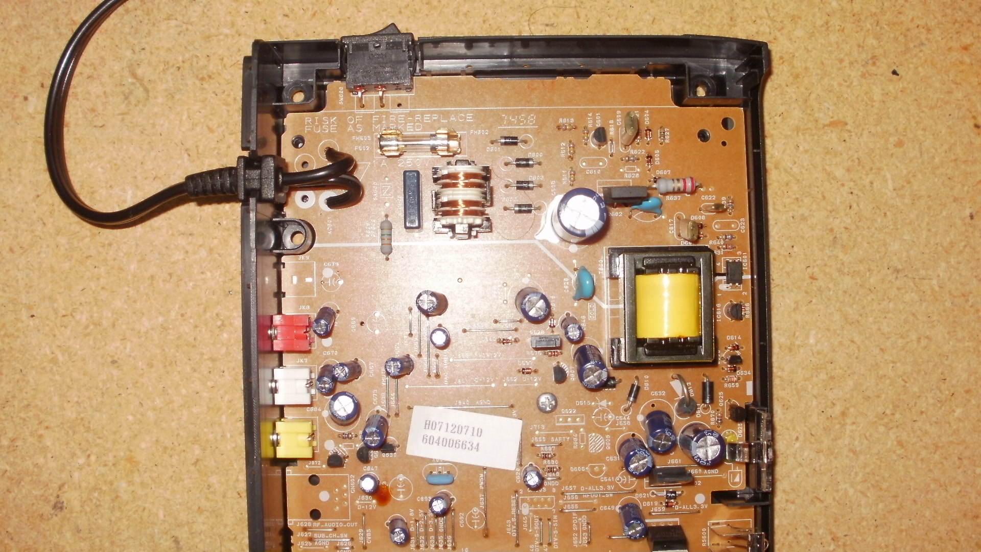

          Re: Magnavox DTV converter won't stay on
          OK, this is the closest I can get without losing focus.
          • MagnumOpus
            • Mar 2013
            • 13
            Also, the brown substance next to that cap doesn't appear to be from it.
            (It's actually next to it.)
            I noticed that right away, the first time I opened the unit.
            I believe it's some sort of glue or sealer.
              Take a good look at all the components and look for anything that looks like it got hot or looks slightly burnt. Look at the tops of all of the capacitors for any signs of bulging or leakage at the bottom. You might also look on the opposite side of the board for bad solder joints. If everything looks good, I would probably start to check for bad caps. If you don't have a capacitor checker, then you may just have to shotgun replacements. The 7 caps around the yellow transformer are for the secondary side of the power supply and would be likely suspects. If you are going to replace them, I would also probably bump up the value of the primary filter cap (the one with the white sealer goo) slightly.
                Wow, that's cheap. It's got a self-oscillating power supply. WHY do Funai (make lower end Magnavox stuff) insist on still using these, I do not know.
                  I did that before starting this thread, but went back to double-check and verify that I didn't miss anything.
                  Everything appears OK. I even desoldered the cap next to that aforementioned brown goo to verify that it wasn't coming from that cap; it's not.
                  Shotgunning replacements would be my only option as I don't have a capacitor checker.
