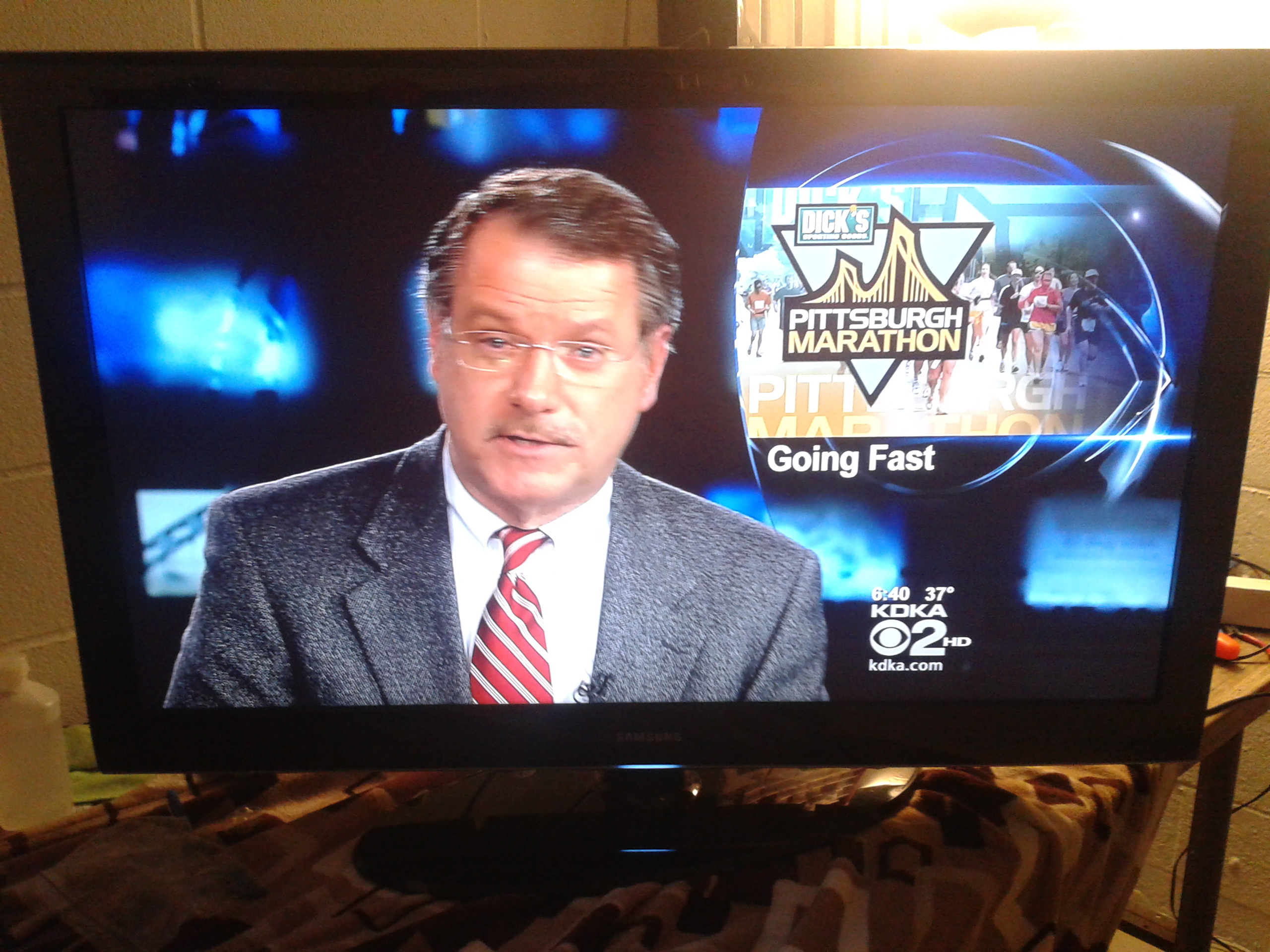

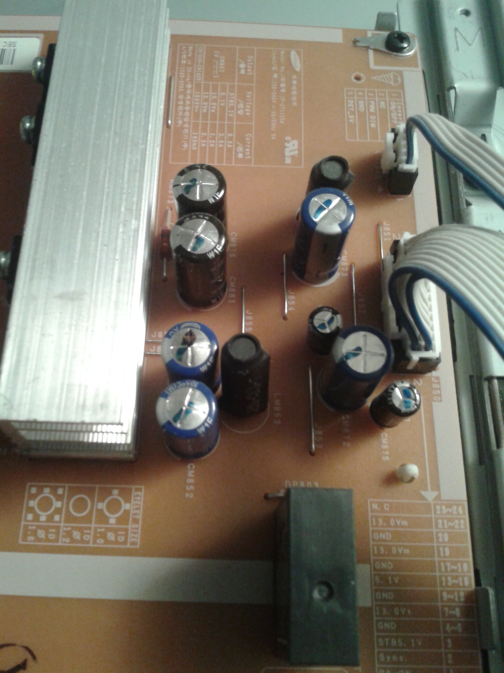

    There was no power at all, no LED, nothing.
    Found four caps bloated on the power board. I changed all six in that area.
    There were:
    2 X 470 25V
    2 X 820 25V
    2 X 1000 10V
    Replaced with a mix of Rubycon & Panasonic caps.Works fine now.
