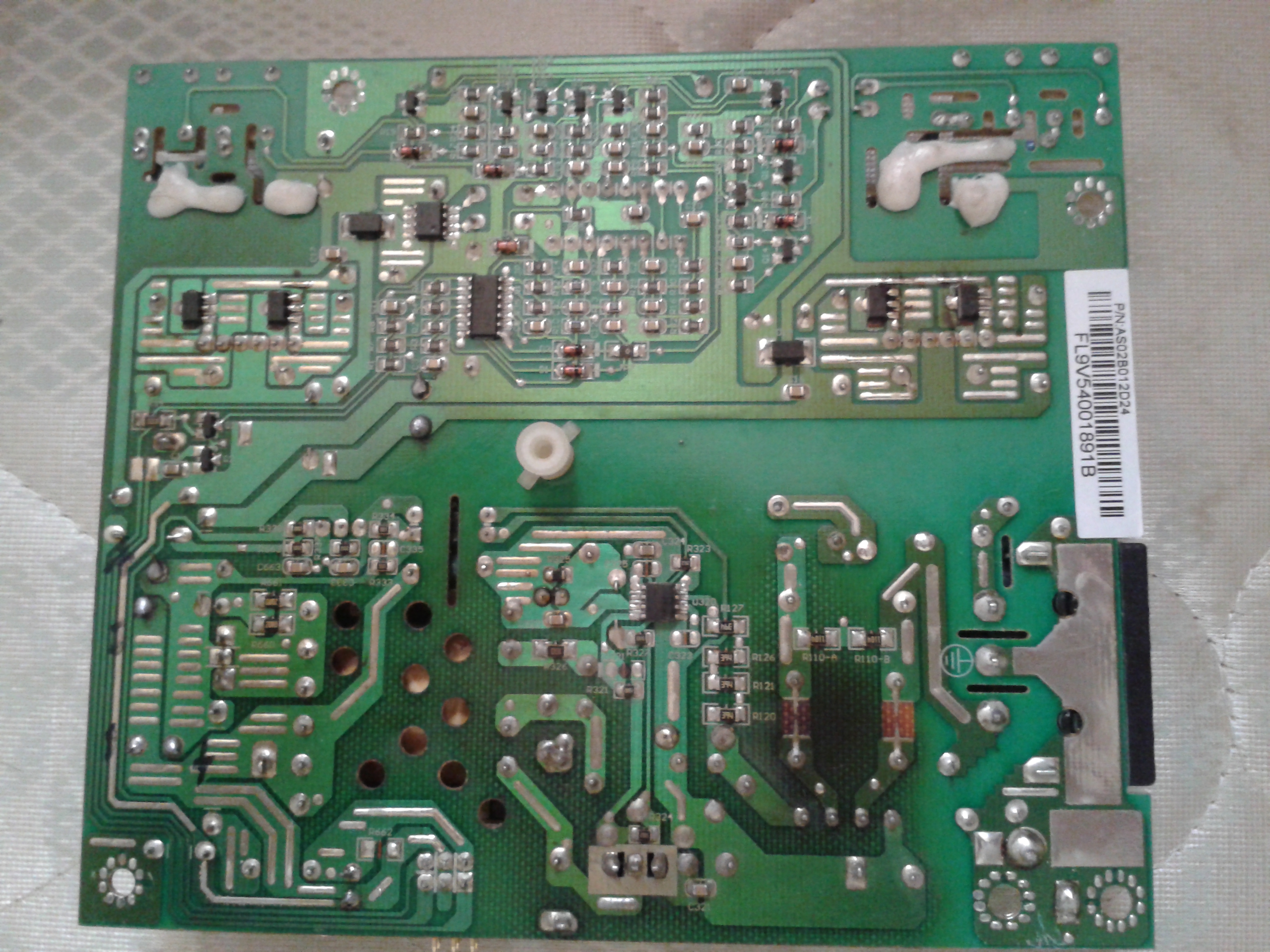

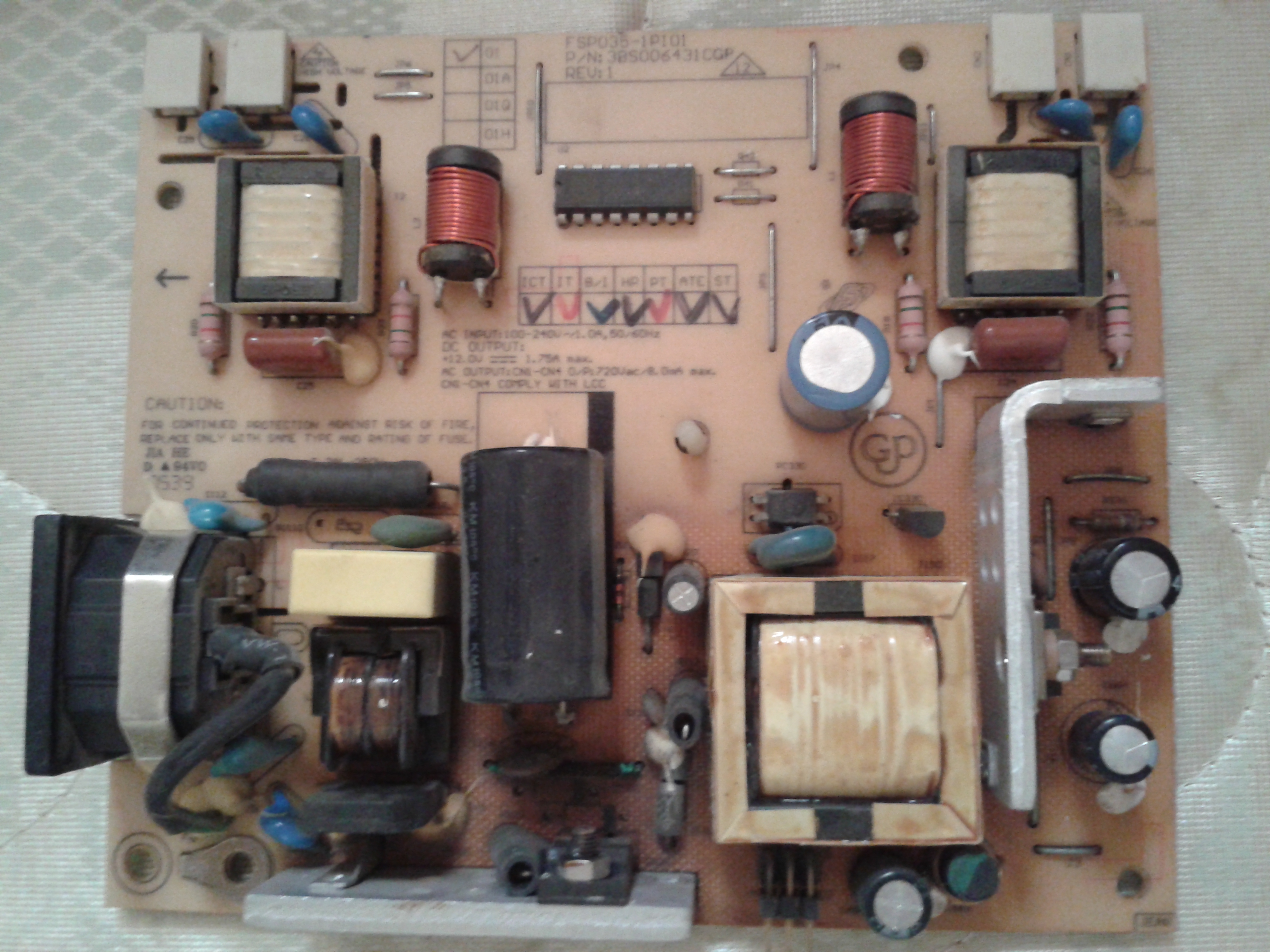

hello everyone
my vx924 is blinking when turning on
and there is a sound in the motherboard like "zzzzzzzzz"
i have change 4 capacitors before and they look fine no bombing or anything
the screen works fine when i unplug the hdmi i can see the "no signal"
but it blinking when i plug the cable again
any advice would be really appreciated
thanks

O.k. then… unplug the power supply from the main board and put in a full size ATX PSU (yeeeesss! Exact that blown Powerman IP that I fixed a while back), plug it in and the old...
