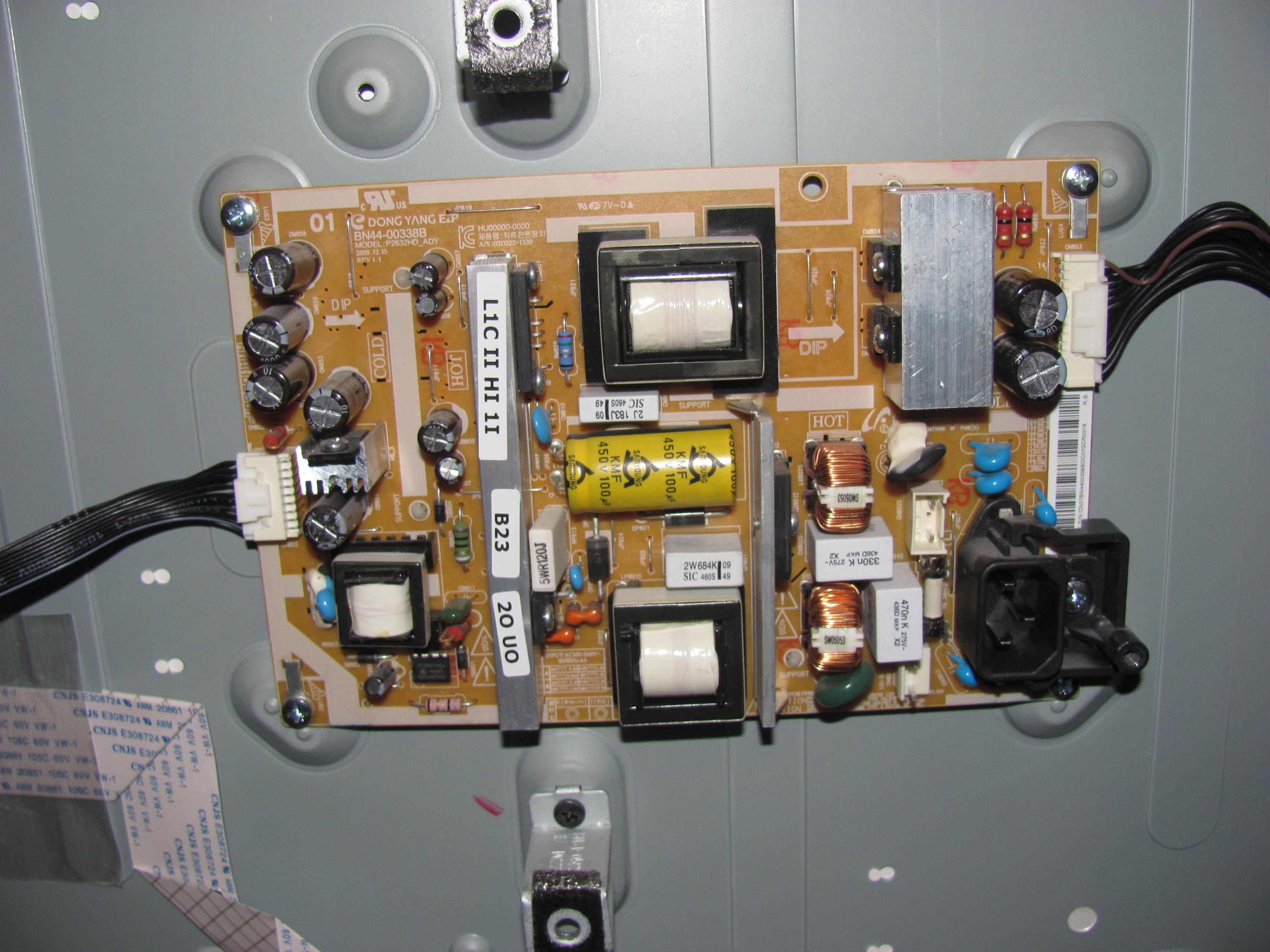

    I know these tvs are notorious for bad caps but I have opened it up and all the caps look normal. When the tv is plugged in there is nothing. No lights, no clicking sound. When I touch the power button on the front nothing happens. Any ideas or experience with this?
    Thanks!

    Are there any output voltages from the power supply? Have you checked the fuse on the power supply?
      Re: Samsung LN32c450E1D troubleshooting
      Any pictures? P/N of the power supply board?, ETC.
        The fuse is good. I'm kind of thinking either I just need a remote to turn the tv on and then troubleshoot from there or I need to just replace the caps because they are bad in spite of not looking like it...
          Do you have test equipment such as Digital meter?
          You need to take the DC readings on the white connector on the left side of the board, there are label close by telling you what each pins are. Black lead to the metal chassis, red probe on each pin of the connector.

                        ok metered it out and have 2 rows of 9 pins each on the top row the pins are labeled b13v b13v b13v gnd gnd b5v b5v b13v b13v
                        row 2 first pin label to small to read second pin to small, 3rd pin e-??? (to small), hsyon (?) too small, gnd, gnd, b5v, a5v, ps_on (?)
                        All the 13v pins read 12.24, the 5v ones read 5.26, row2 pin 1 reads .01v, pin 2 reads 5.13,pin3 the e-??? reads .95v, pin 4 hsyon reads .003v, row 2 pin 9 ps_on reads .74v

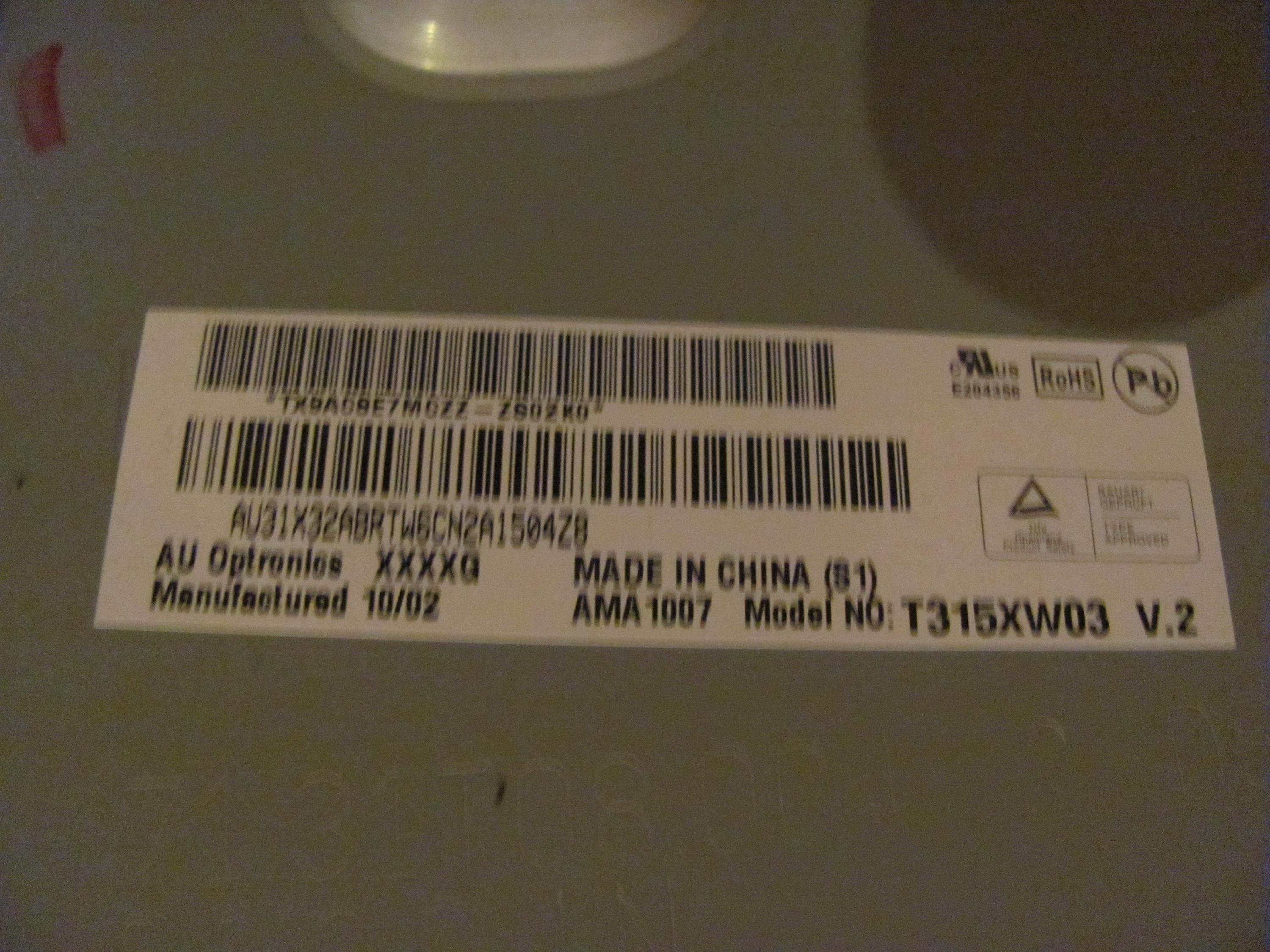

                        One unexpected thing happened- I unplugged the connecting cable from the power supply board to the main board and the screen lit up but when I plugged the connecting cable in the screen went black.! Which showed me that it is cracked :/. Well it was a $10 tv from goodwill. So I'm still going to try to fix it. The power button still doesnt light up or do anything when I touch it...
                          That means the power supply and the backlights inverter circuits are OK, the problem is the main board is not sending the PS_ON signal to turn on the power supply. The main board is keeping the PS_ON from going high (>3V = ON).
                          But since screen is broken, then that will not be worth to get new screen, especially for the 32" TV. You can sell the inverter board and the power supply boards to recover your $10 easily.
