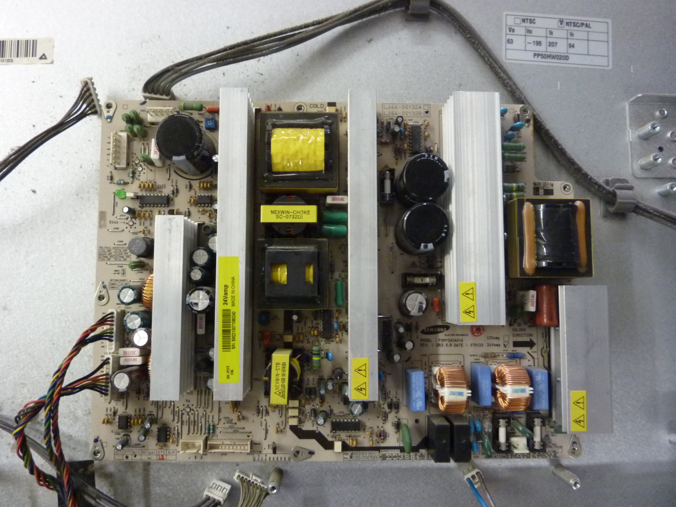

    Hello All,
    My Vizio Plasma TV model P50HDTV20A stop working, no display. TV seem to turn on and off from amber orange to green.
    After taken apart the TV i check for VA and VS when it on (green light) there no voltage on VA or VS. Could it be PSU problem? there no budge caps that i can see.

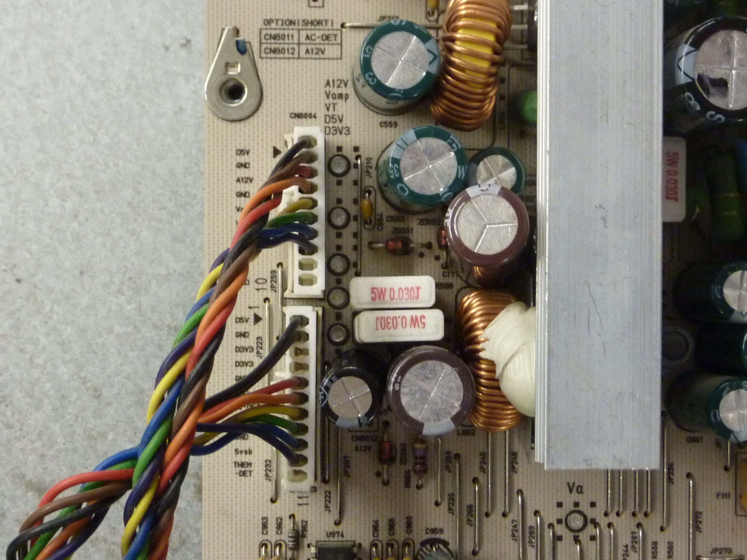

            Can you get pictures of the power supply, and of the connectors on PSU to main board?
              Re: Vizio P50 HDTV20A No VA/VS
              here are the pictures
                All the other voltages good?
                Is there a pin marked VSON?
                  Yes there is a VSON pin, also im only getting 5V weird nothing else
                    Does this change when the power button is pressed?
