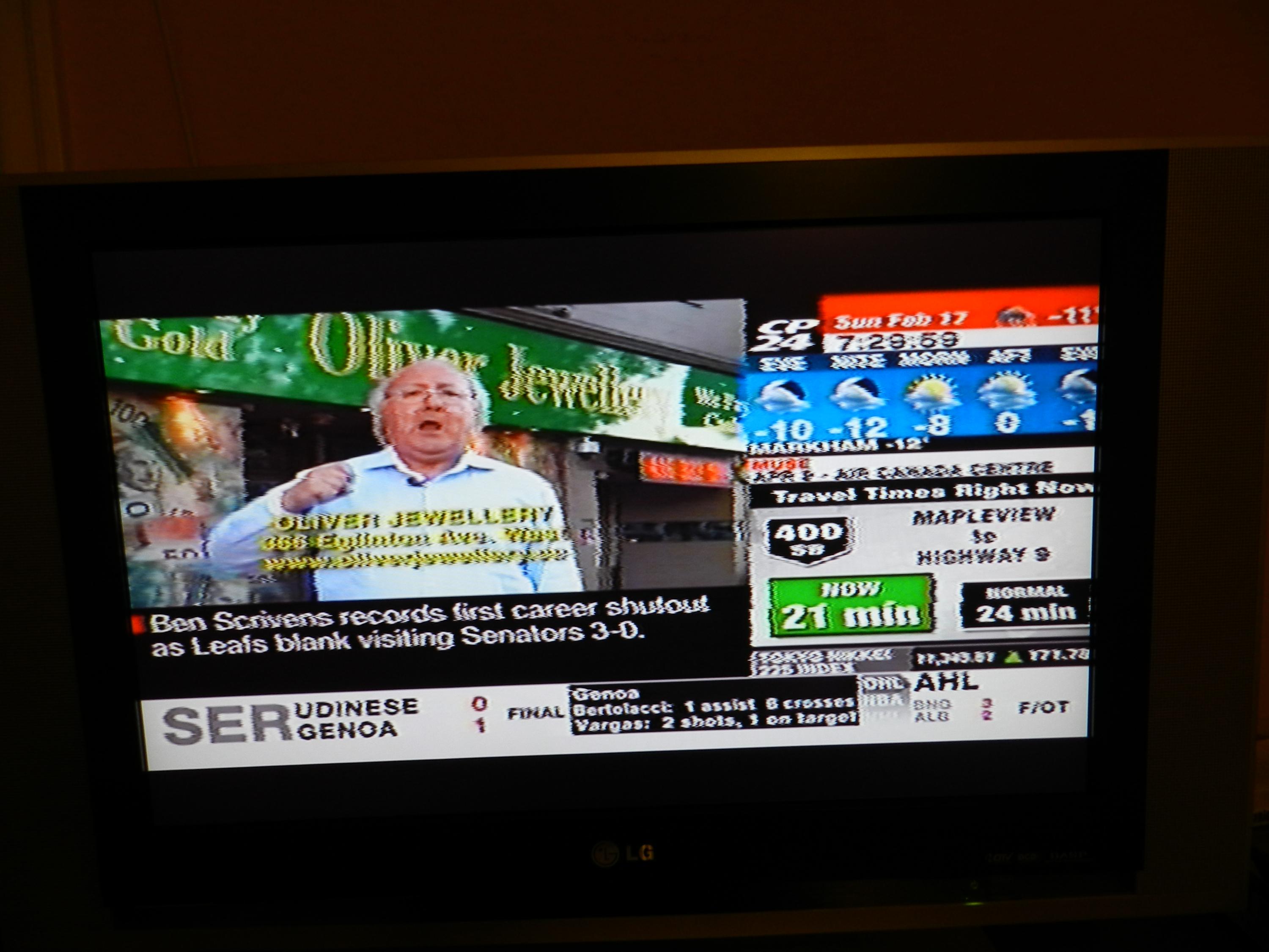

    Need help trouble shooting. I got this tv from a friend and the picture is distorted just a bit. For instance when showing numbers you can make them out but it is not aligned as they should be.
    So far I have tried another cable outlet and also used a DVD player and got the same results. From what I have briefly read here, it might be the Tcon board, but any other insight would be appreciated

    Can we see a picture of the distortion?

        Here is a photo of what the picture looks like
          Re: LG model RM-26LZ50 is slightly blurry
          We have seen this before. Often it is due to a failing voltage regulator on the main board, relatively easy to find and replace. Does this TV have any digital inputs e.g. HDMI/DVI. If so is it different on these compared to analog sources?

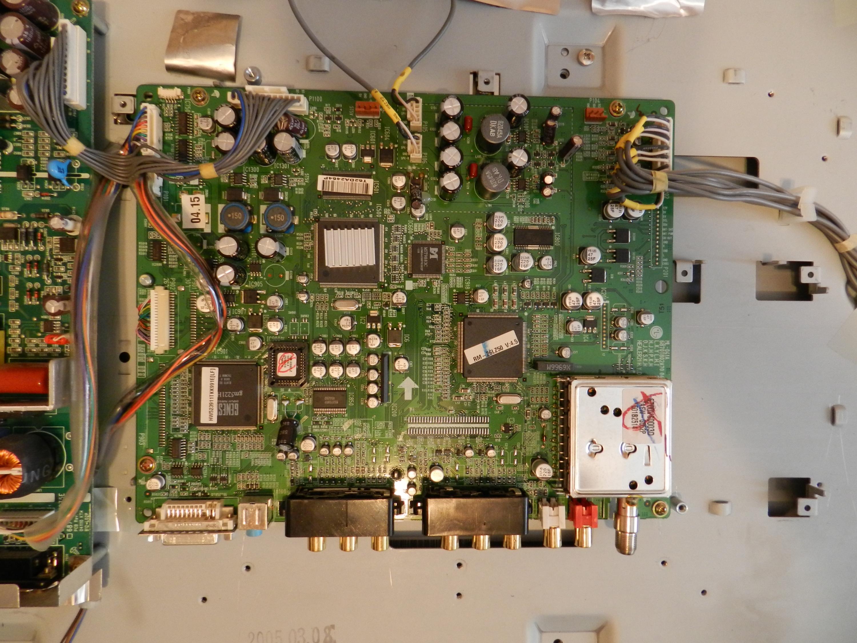

                        I was able to get a dvd player with a HDMI output and used the hdmi to dvi cable to connect to the TV. Picture is perfect!!
                        Do you want the pictures of the main board?
                          Yes, please. This confirms the issue is in the analog processing side and narrows down the fault.

                            Is this picture good enough
                              That's more than good enough. Thanks for supplying a good picture.
                              Read retiredcap's guide on diagnosing faulty regulators:
                              https://www.badcaps.net/forum/showthread.php?t=22231
                              and supply the list in the format suggested.

                                Thanks. It's hard to see the part numbers on the regulators. So I was looking for a parts list fro the board but no luck.
                                What did you mean supply the list in the suggested format?
                                Pin 1
                                Pin 2
                                Pin 3 ?
                                  Suggested format is:-
                                  AS1117-33 -> line 1 of the IC
                                  0506 -> line 2 of the IC
                                  pin 1 = 0.000
                                  pin 2 = 3.301
                                  pin 3 = 5.001
                                  As an example. The readings are taken in volts DC, 20V scale (if not autoranging), with black probe on chassis of TV, red probe on each pin. The larger "tab" pin is physically connected to pin 2; this may be easier to probe than pin 2.

                                      Sorry for the delay but unfortunately not all the chips are marked the way you described.
                                      I was able to get hold of a service manual and part list for that circuit board.
                                      It was from LG with the same chasis...ML-041A
                                      I will use the circuit board number and give you the chip number. here is an example
                                      IC2, IC4, IC601 all used 1117A-33CYTR, but on the chip was B533399GC
                                      Pin 1=5v
                                      pin2= 3.2v
                                      pin3= 0v
                                      Will this be ok
                                      After collecting all the data something did jump out at me it was
                                      IC3...very small and numbers on the chip are not readable according to the parts list it is
                                      KIA7027AF3
                                      pin1 = 3.2
                                      pin2 = 0
                                      pin3 = 3.2
                                      but I am not sure what the readings should be
                                      I can give you the rest of the readings if the format is ok with you
                                        Pin 1=5v
                                        pin2= 3.2v
                                        pin3= 0v
                                        Will this be ok
                                        Unless you have an analog multimeter, report all the digits that the multimeter shows.
