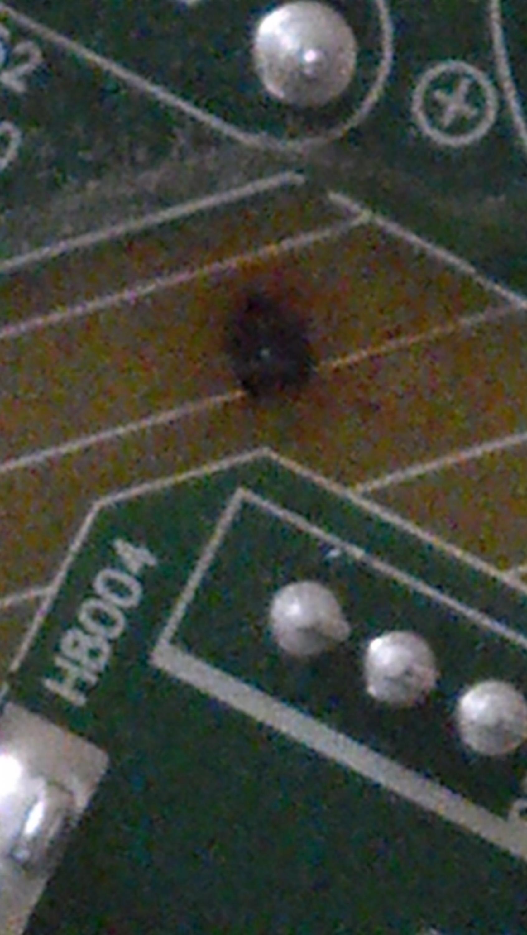

Sorry that should say d37 not d5. I found a tiny burn the size of a pencil tip in the powerboard. I'm told it's not repairable so i'm pricing them out now.Comment

Probably is repairable... How about a picture of the damage?Please do not PM me with questions! Questions via PM will not be answered. Post on the forums instead!

That is nonsense. There aren't even components there. A little bit of isopropyl and the mark will be gone. Who told you that -- a TV repair shop?Please do not PM me with questions! Questions via PM will not be answered. Post on the forums instead!

An electrician i know. It goes pretty deep if that makes a difference. It's hard to see.Comment
Re: Philips Plasma
I would class it as perfectly repairable but I don't know what would cause that. Anything on the top that's burnt?Please do not PM me with questions! Questions via PM will not be answered. Post on the forums instead!

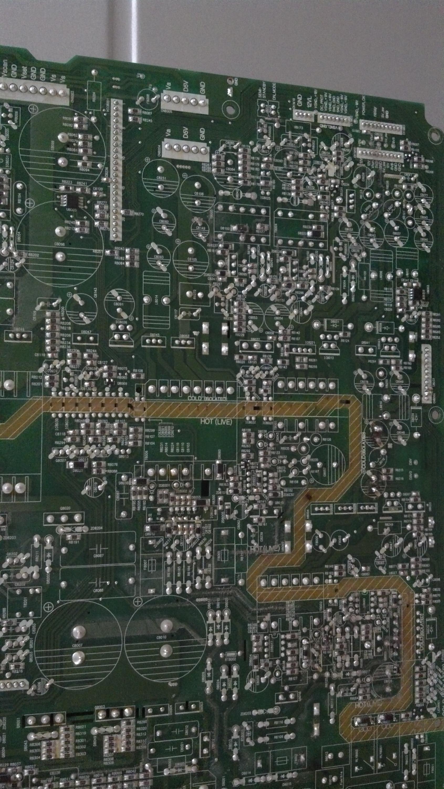

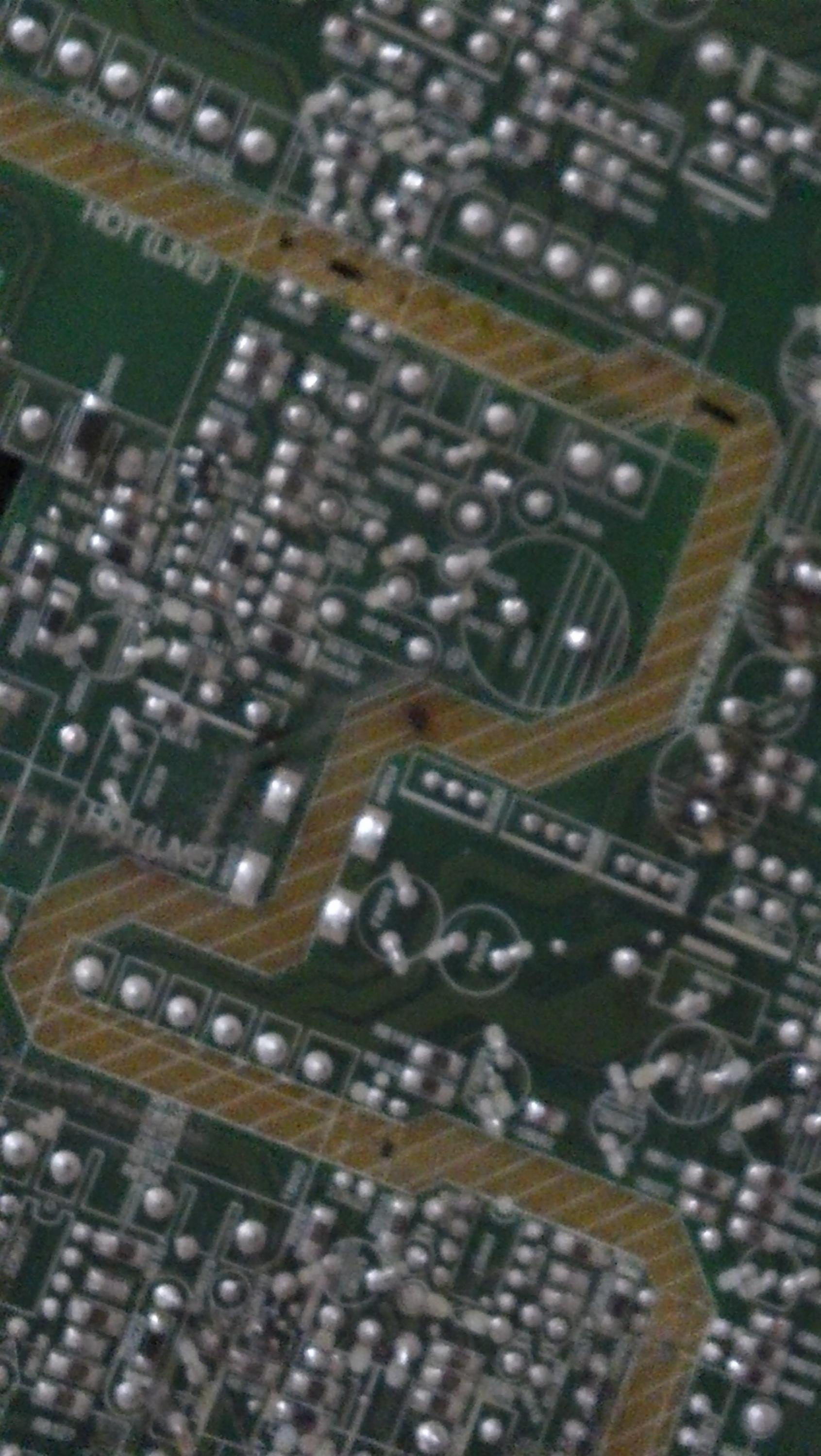

The area where that burn mark is looks to be the seperator line between hot and cold side of a power supply. The only components that cross that area are optocouplers, are you sure there isnt a small square black peice with 2 leads on each side of the box on the other side of that burn / or the signs of it being blow off on the other side.
Edit: looks like there are 2 optocouplers like 1/2" down from the burn mark, so there probably wasnt one where the burn mark is. But after viewing your pictures up close, it looks like your burned the crap out of the board where you replaced the 2 capacitors right next to each other about 1 inch from the burn mark. So it could very well be that you soldered it badly, youll get better with practice. Hopefully you didnt use plumbing solder though and one of those plumbing irons that creates a huge spark between two probes and is like >80w?Last edited by cashkennedy; 02-19-2013, 10:11 PM.Fixed so far 12 lcd's , 1 plasmas, 5 monitors, 0 dlp's (plan to keep the dlps at 0). and 3 atx power supplies, and 2 motherboards.Comment
