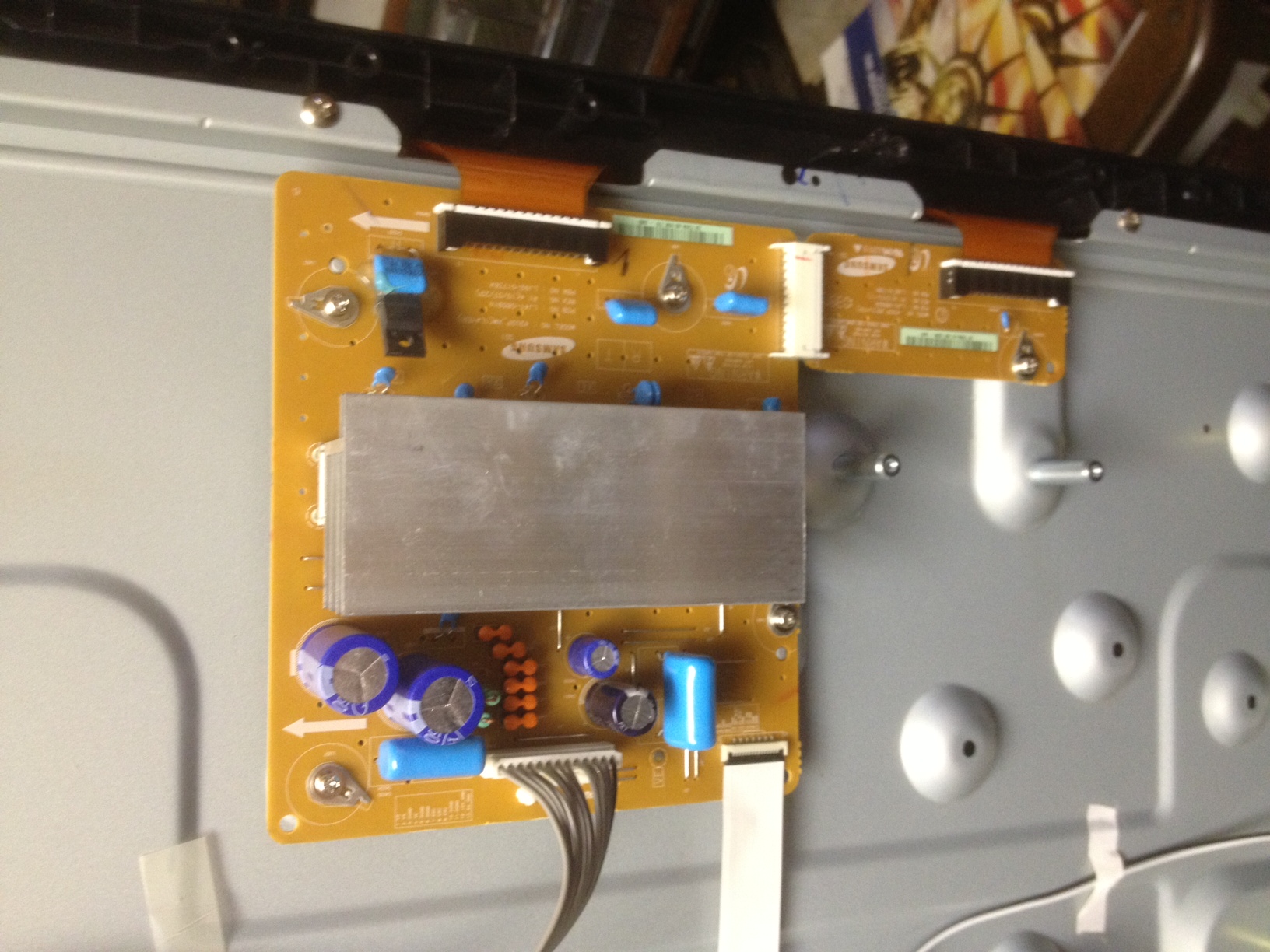

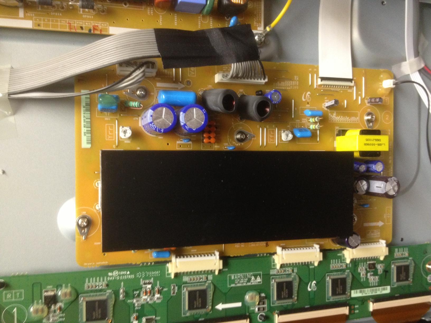

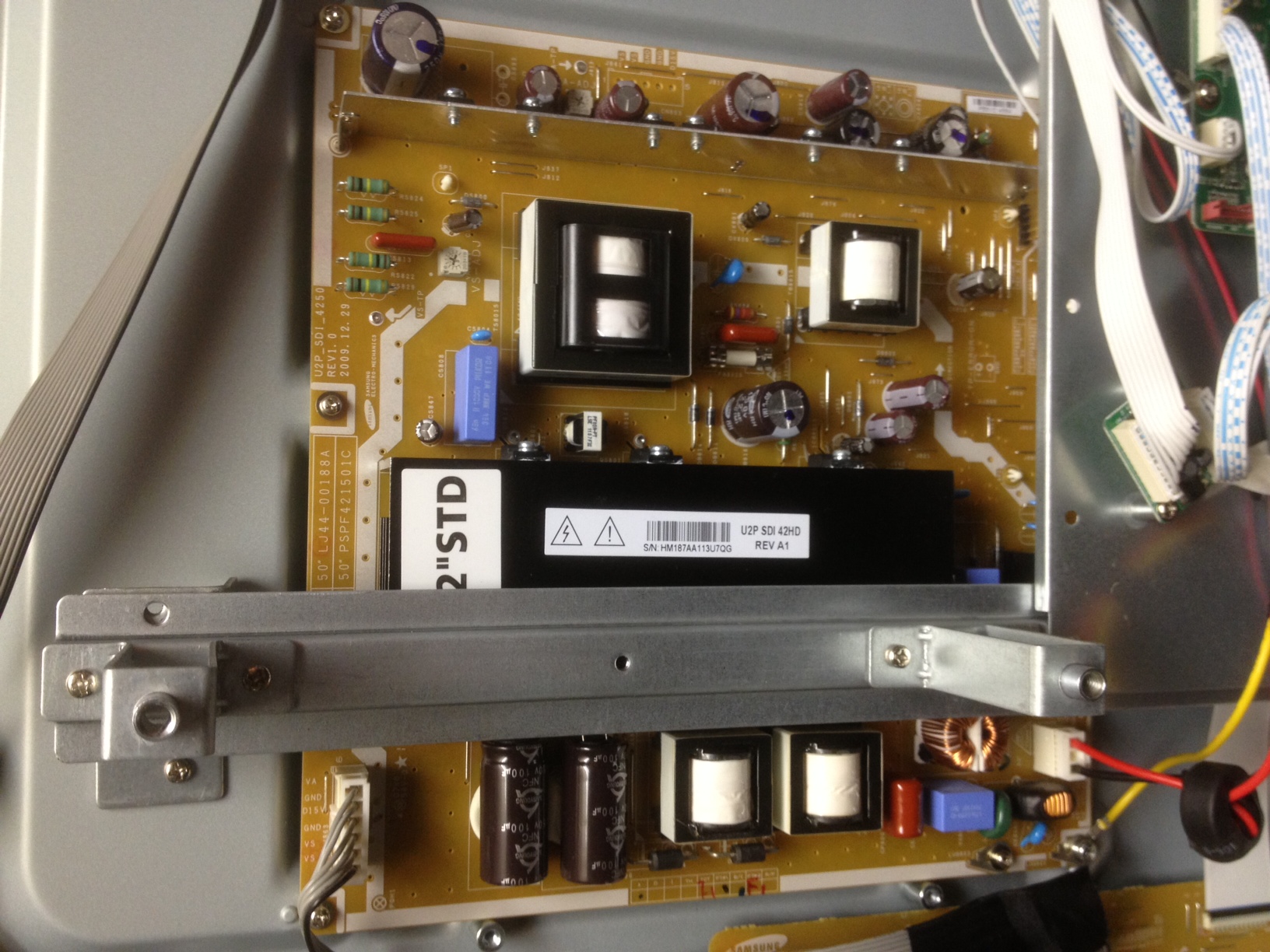

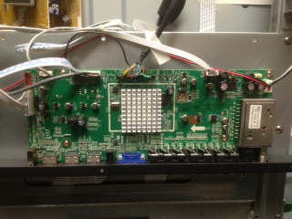

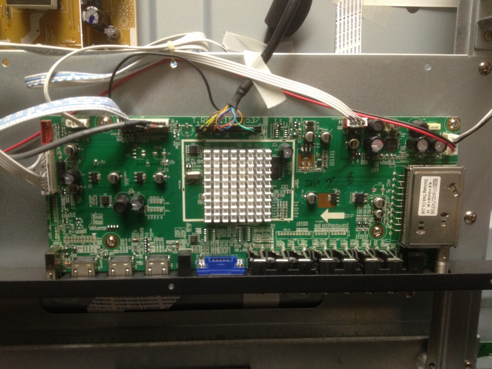

        Here are the pics of the boards in the TV.

              Sorry, I meant can you get bigger pictures -- max 2000x2000 -- will be clearer.

                        Re: 42pa30rq service manual
                        Much better. Thanks.
                        Do you have a digital multimeter?
                        This is your X-main board.
                        https://www.badcaps.net/forum/attach...8&d=1360596727
                        Unplug the power and control connectors (the power connector is grey and the control connector is white.)
                        NOTE: Do this with power disconnected.
                        Do you see a picture? It will be very dim and usually purple tinted but it should be there.
