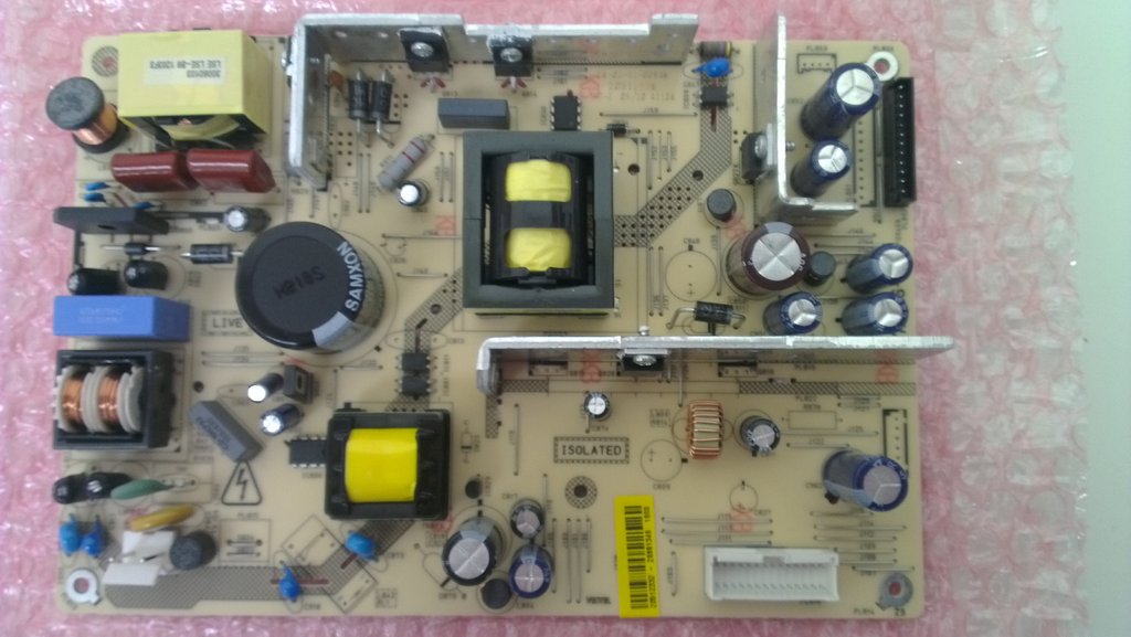

    I have a 'onei' 26 inch LCD,which had developed a fault,it won't switch on ! The only thing it does is flash blue not the screen the standby light ? I did have a similar fault with a alba set,didn't know if this was the same problem for all (blue caps)
  • selldoor
    Slow Learner
    • Dec 2010
    • 7870
    Re: Tv brand onei standby fault
    I cant believe you have put such little effort into a request for help!
    Please read some other posts and come up with a bit more information and pictures.
    Any idea how many different (Blue Caps) there are.
      Most likely Vestel. Flashing blue light is defective PSU. PSUs are available for £20 or you can fix it for £5 in parts usually.
              The vestel board number is 17pw26-4 ?

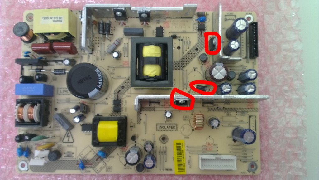

                Flashing power light -- two shorted diodes usually on this model. Check them and replace them if they are shorted. Pictures & I'll even highlight them for you.
                          OK much better, I've highlighted all the diodes.
                          To test the ones on the heatsink: Middle pin to each outer pin should show 150~700 one way and infinite ("1" or "OL") the other way.
                          To test the free standing one: Test it both ways and you should get 150~700 one way and infinite ("1" or "OL") the other way.
                          All tests done on diode mode.

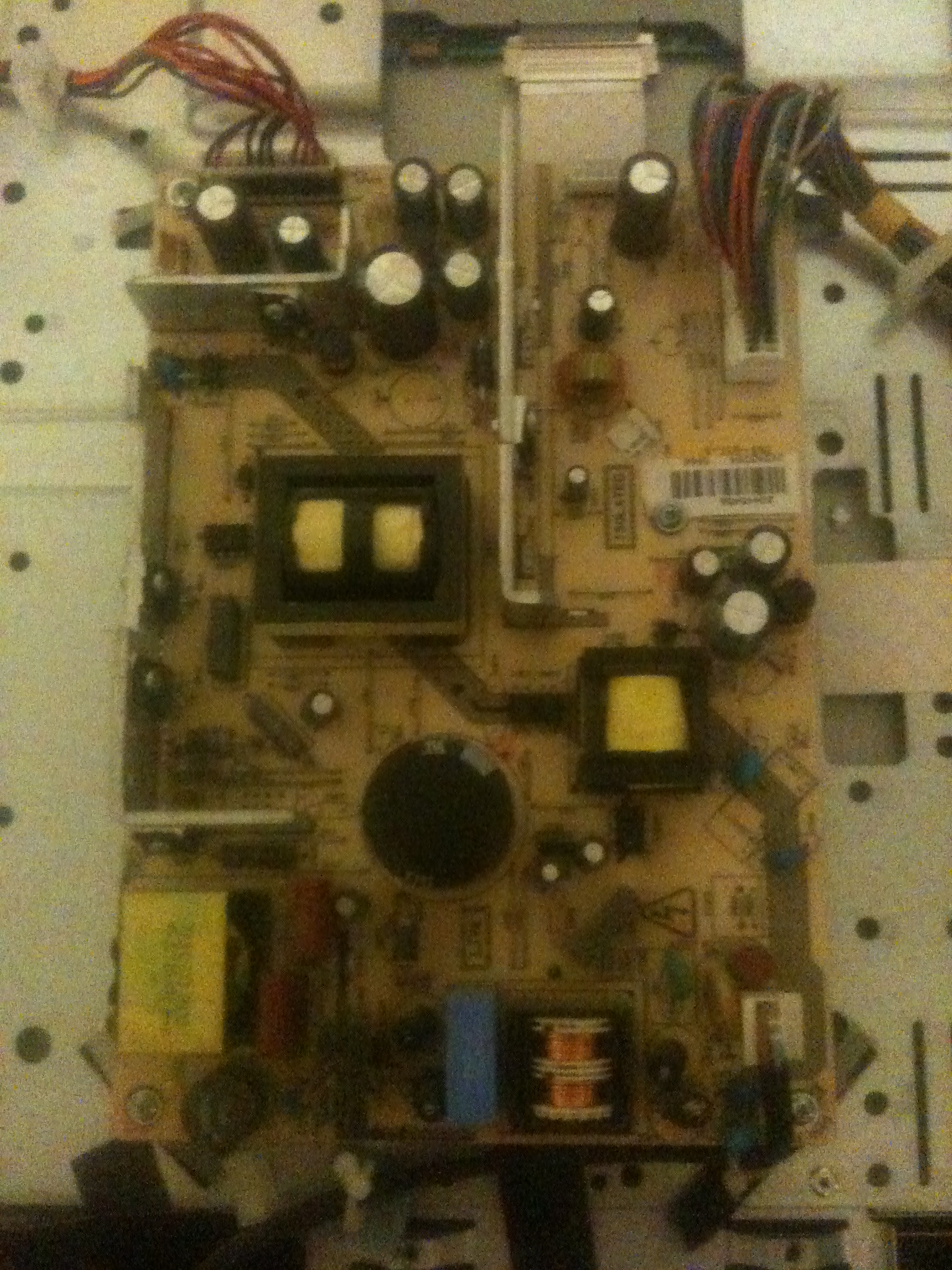

                            That is a picture of a different board?
                            • LEEDASH
                              • Dec 2012
                              • 481
                              • Bedfordshire
                              yeah a clearer one
                              • selldoor
                                Slow Learner
                                • Dec 2010
                                • 7870
                                No - a different board to the one in your first picture
                                • LEEDASH
                                  • Dec 2012
                                  • 481
                                  • Bedfordshire
                                  nothing different ?
                                  • selldoor
                                    Slow Learner
                                    • Dec 2010
                                    • 7870
                                    Perhaps not a problem at the moment but if we are trying to fix your board its not much use looking at this
                                    http://www.ohmsupplies.co.uk/WebRoot...A/IMAG0484.jpg
                                    • LEEDASH
                                      • Dec 2012
                                      • 481
                                      • Bedfordshire
                                      still the same one ?
                                      • LEEDASH
                                        • Dec 2012
                                        • 481
                                        • Bedfordshire
                                        mine has no visable blown caps,i may of thought it might be a case of changing 1 or 2 caps
