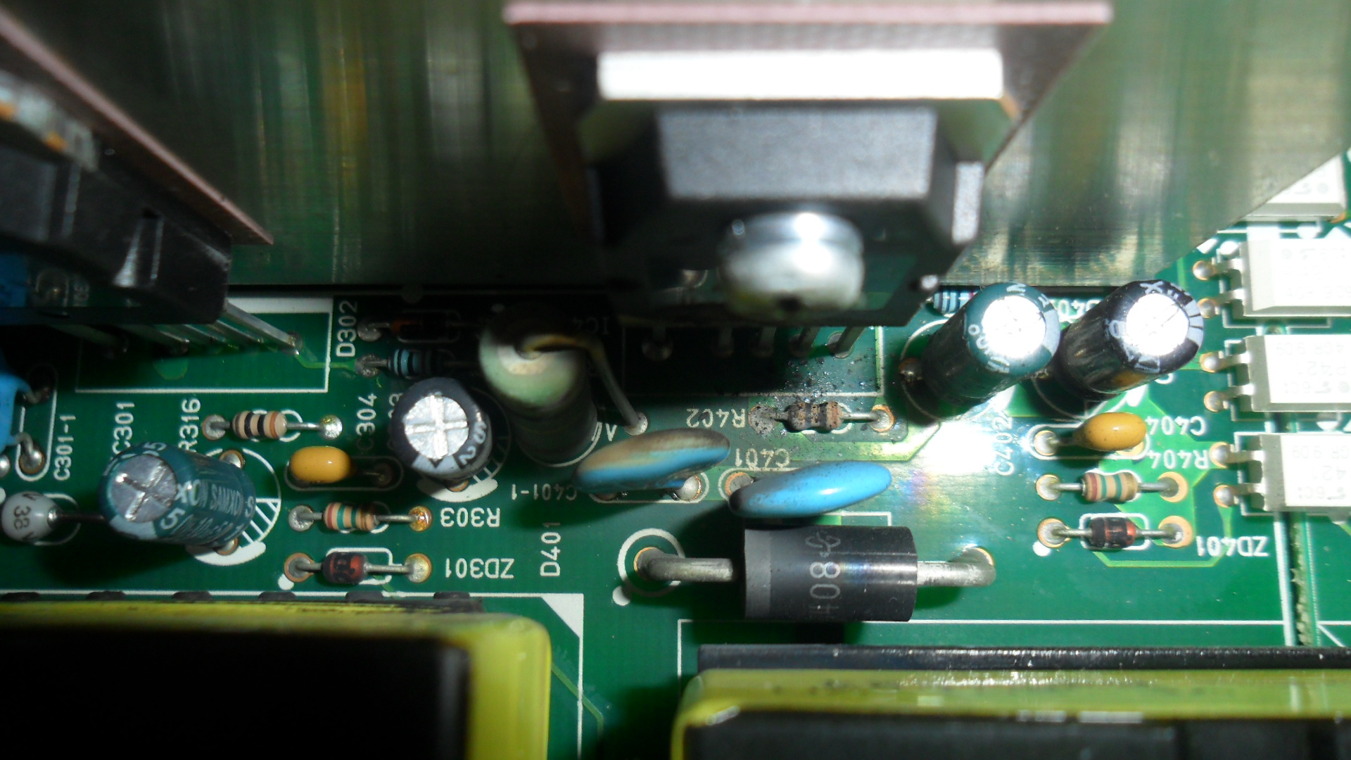

    TV has a Samsung V4C power board. CODE: LJ44-00092E
    Found about 5 fuses so far, one has tested open - F401
    Also found a schematic of the power board that I've attached.
    Re: Norcent plasma PT-4291HD no display, unresponsive
    Where is F401 located?
    Pictures, please...

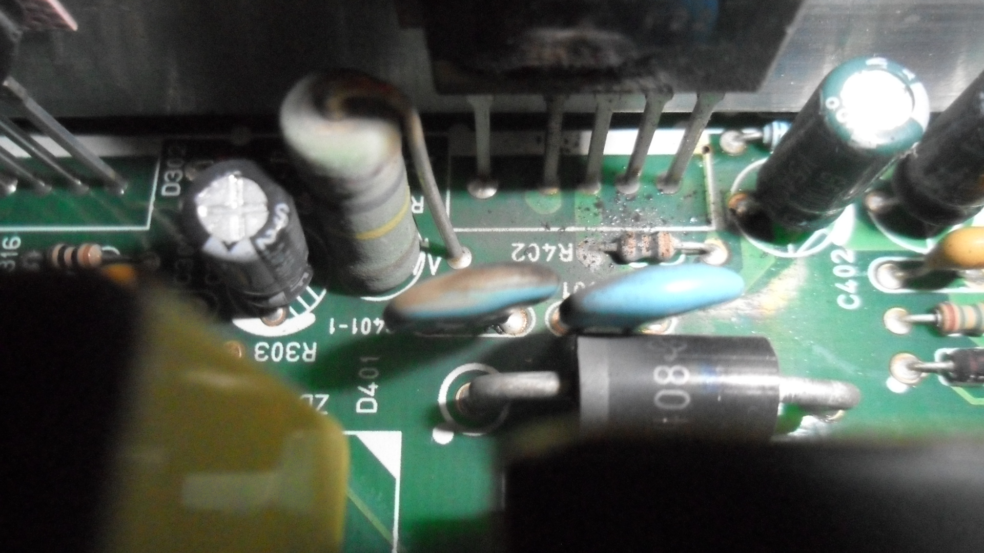

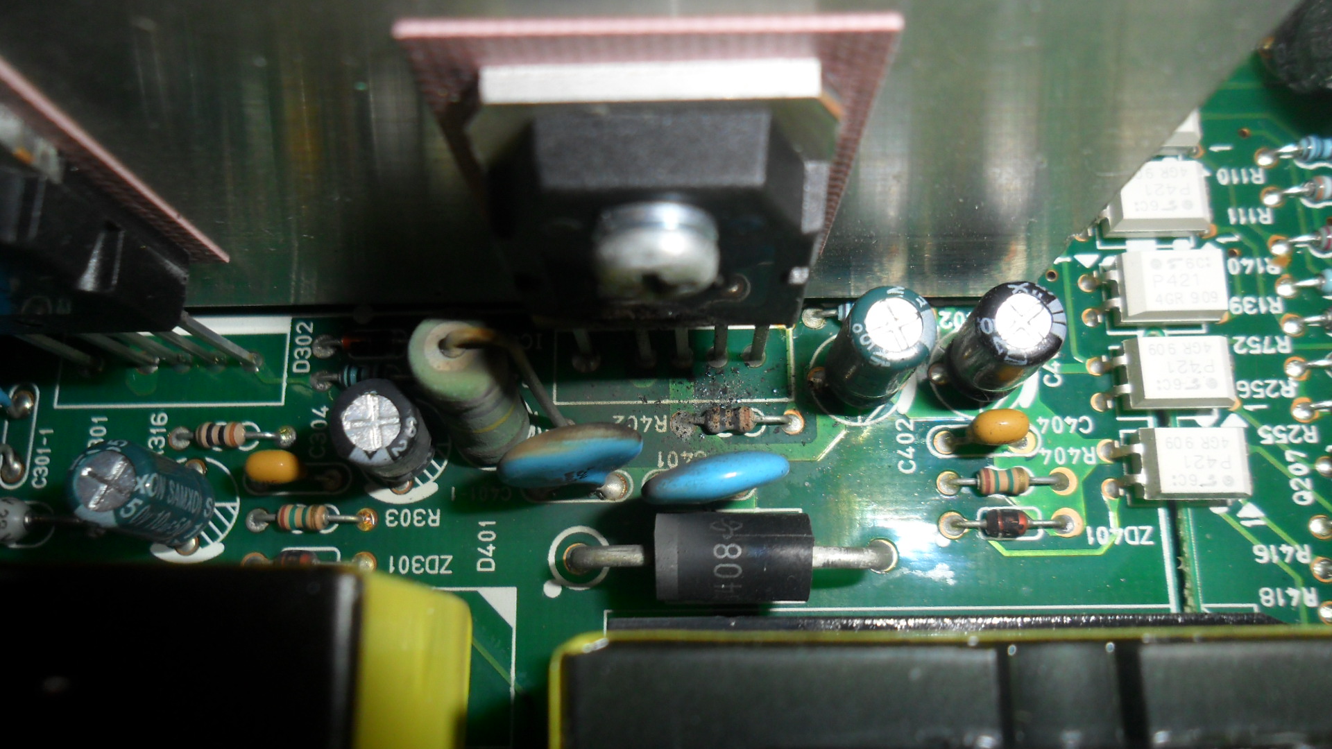

      closeups
        Check the MOSFETs in that area for shorts -- if none found replace fuse & see if it pops. If not you probably just fixed the TV.

              Wow, the schematic says IC401 is directly fed from F401's circuit. After finding IC401, It does appear that something's pulled more of a load than it should have..

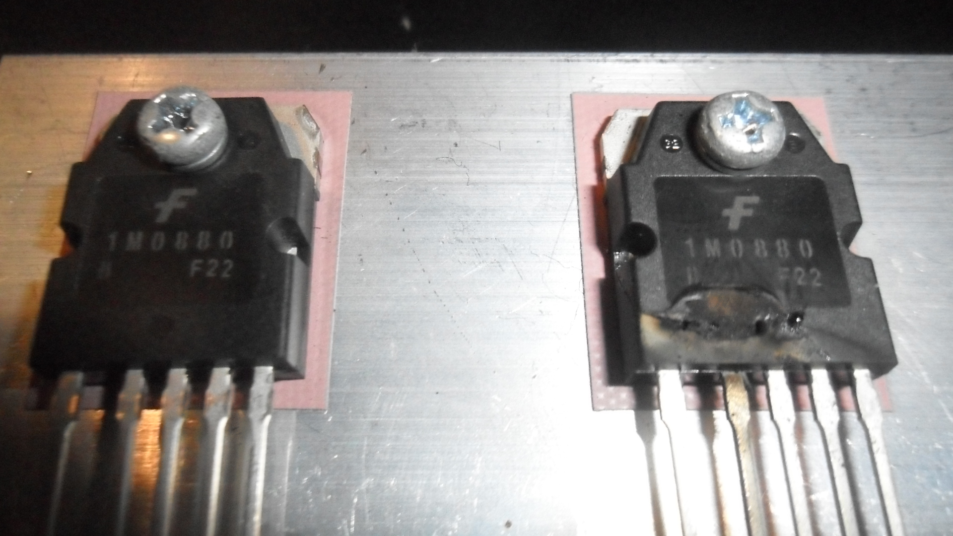

                As far as the IC401 (I assume that's the MOSFET)
                Pins 1 and 2 are dead shorted. I removed the mosfet from the board, and there is another exact one on the heatsink I can compare to. IC401 is definately bad.
                Schematic says it's a KA1M0880B, marking on the component is a 1M0880
                go figure, they're obsolete - unattainable through mouser. Anyone else have a source for this?
                EDIT: the interwebs suggest FS7M0880 as a suitable replacement
                  Umm, yep. There's the problem. The most important characteristics will be the switching frequency and the RDS(on). Switching frequency should be within 5kHz or so. RDS(on) should be the same or lower. This is a MOSFET + controller IC all in one.

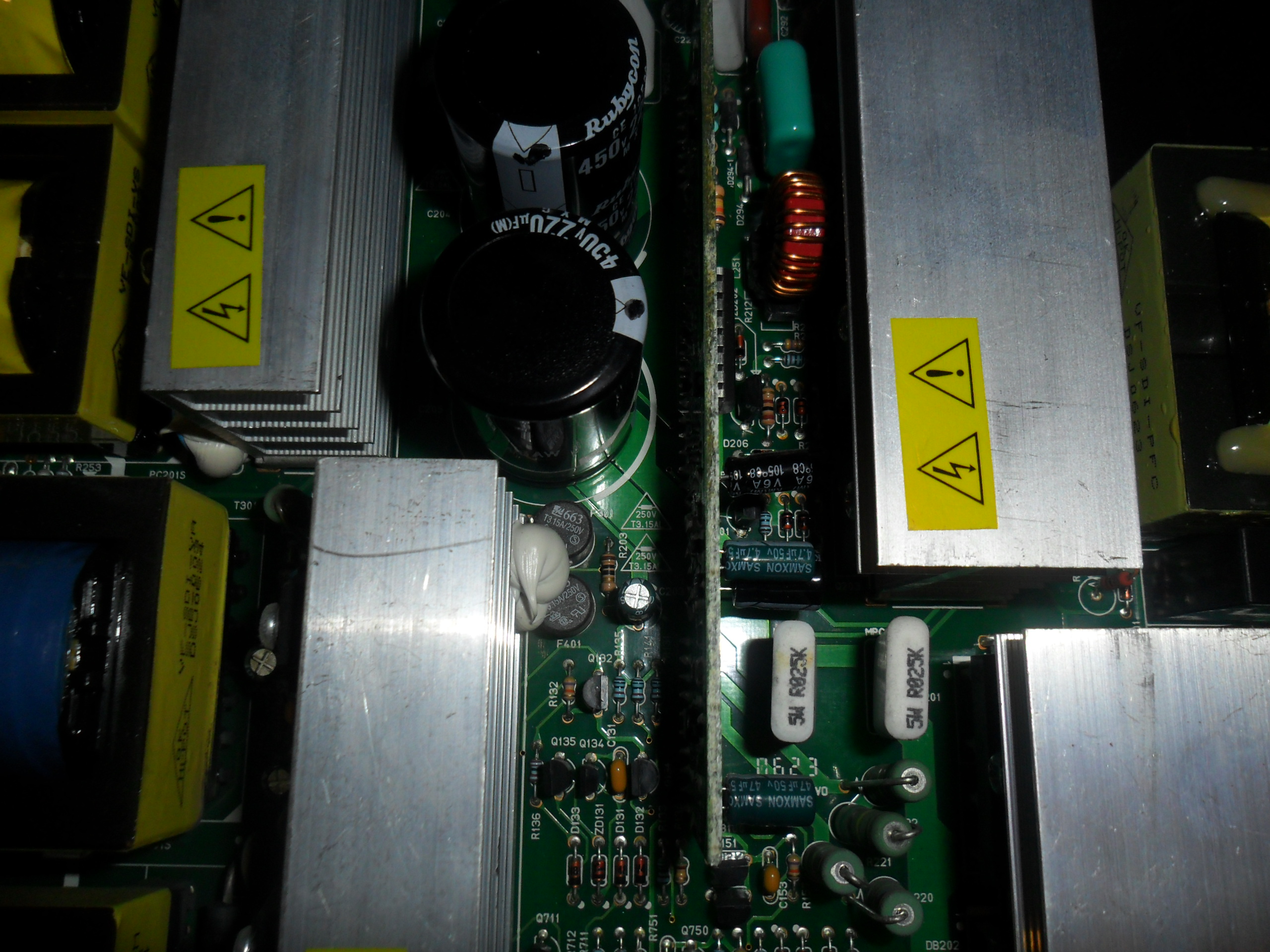

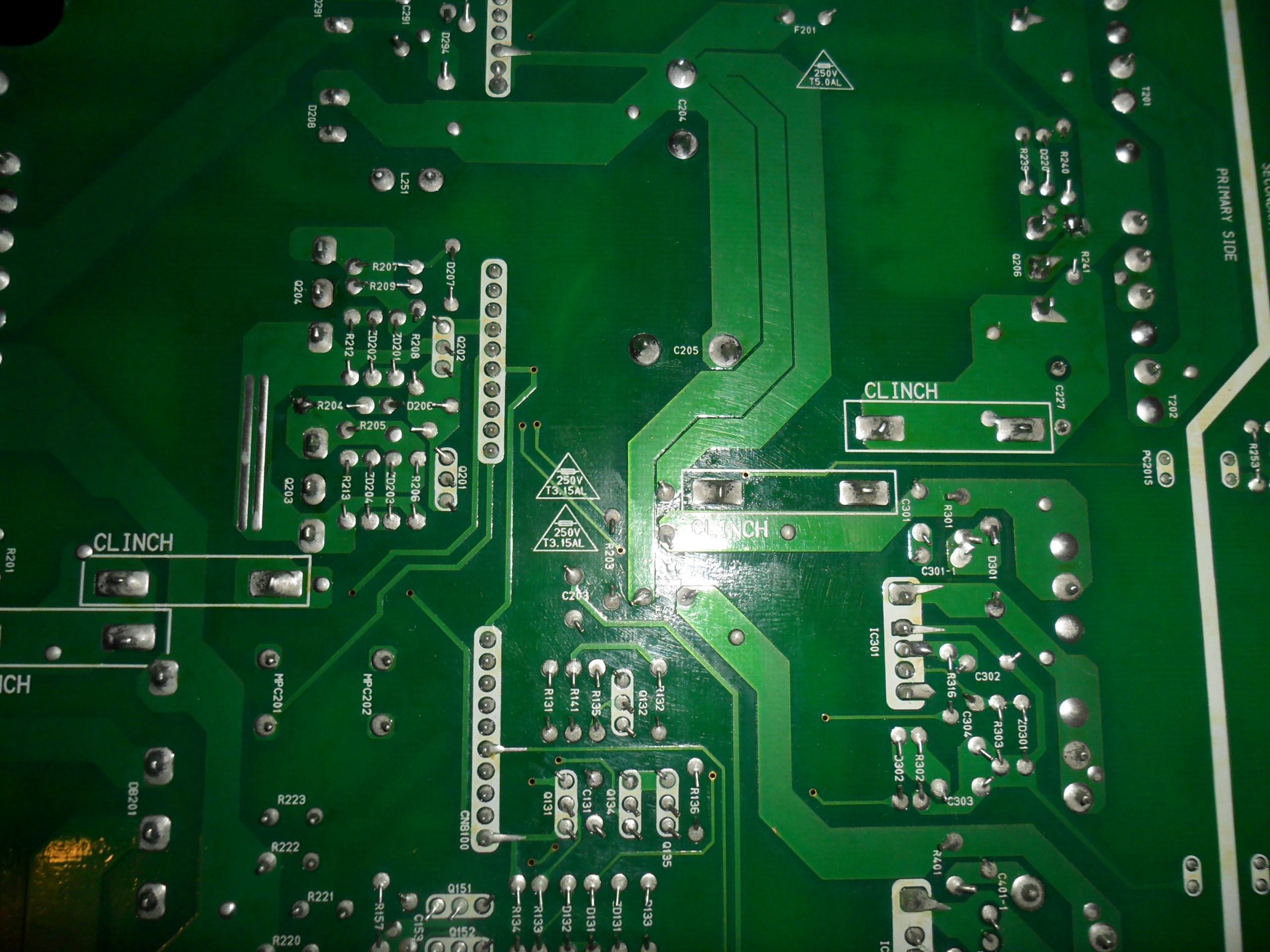

                      I've attached a schematic of the power supply, as well as pictures of the component side.
                      Going to pull the board and check F401 to see if it blew. Anything else I should take a look at?
